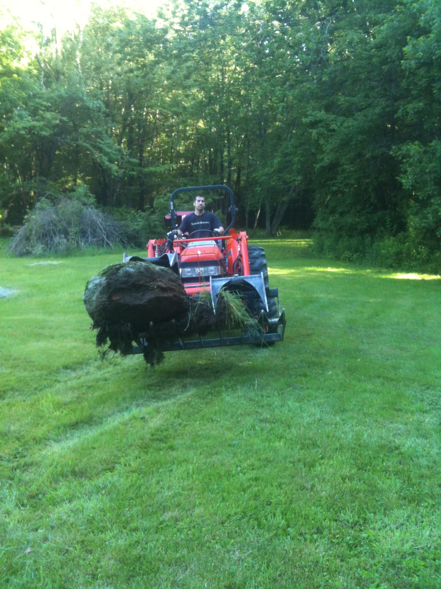

The risk is real but not typically from just lifting an imbalanced load. The problem comes when you travel (load bouncing around) or if you hit an obstacle with a clamped object extended more than a few feet from the grapple (like a tree). Tractor FELs are not particularly well designed or build to resist twisting movements so it behooves us to avoid such forces. No issue with lifting an imbalanced load and then dropping it to reposition. Damage occurs with dynamic forces associated with moving a load. There have been occasional reports here on TBN of folks who have torqued their FEL so it doesn't sit level anymore (until then untorque it) and there are more numerous reports of twisting a grapple itself (even with uber expensive grapples like Anbo). Bottom line is to just keep in mind that a static lift is relatively unlikely to cause damage but moving with either an imbalanced load or having a long load hit an obstruction is what most likely will damage either loader or grapple.
Middle photo is much higher risk activity than the other two even though the total weight is about the same.

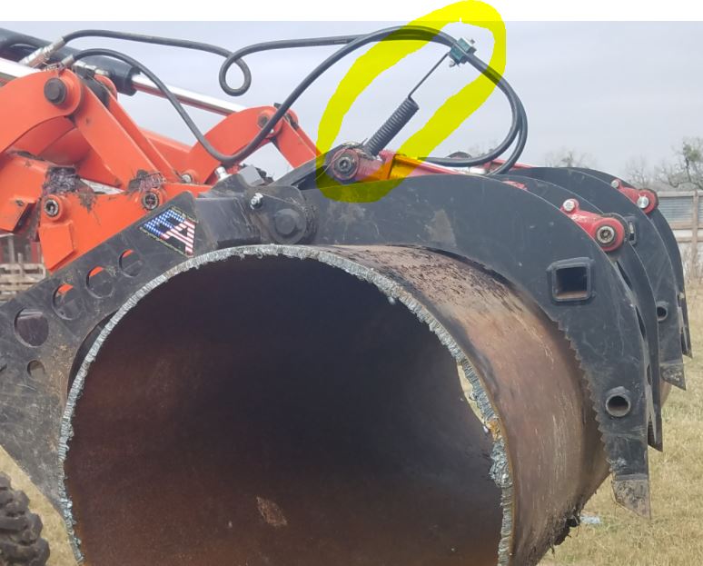

Mutz,
Tell me about this.....
Where did you get it, how did you attach it, and...well...it's a really good idea.
/ Grappling fun - A Picture Thread.... #1,503
The spring hose holder thing comes on EA grapples. That and the swivels in the hoses are nice touches.

As mentioned it comes with the grapple. It is a nice addition. Gives the ability to help keep the hoses out of the way.
That's a really nice touch that they put on there.
/ Grappling fun - A Picture Thread.... #1,509
I think it's standard only on EA's dual lid models, to minimize risk of interference. Optional with single lid, and they might sell it separately as an accessory.
/ Grappling fun - A Picture Thread.... #1,510
I didn't get one with my single lid from EA
