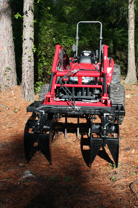

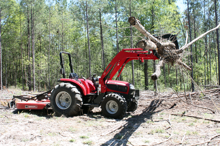

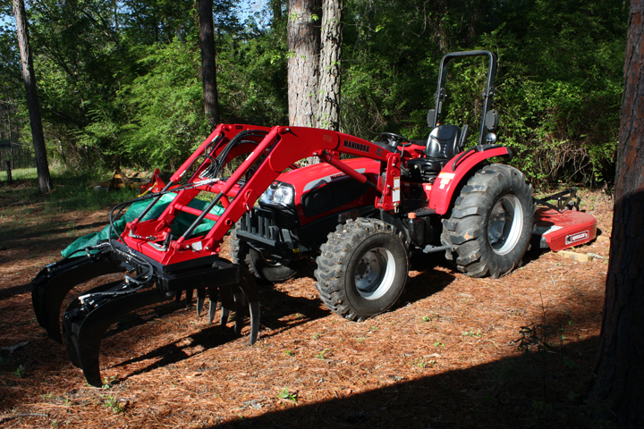

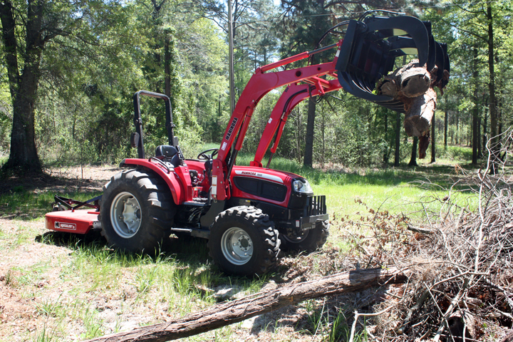

Oh yeah!!! :D:D:D:D:D:D:D:D:D:D
Finally had the time this weekend to get it all hooked up and running.
Had a minor hydro blowout with a loose fitting on start up. Simple fix. The hoses were easy to run and secure.
Sure had some fun today using it! Moved a bunch of brush, some stumps, logs, rooted out some vines/small gum trees and cleaned up part of last year's log deck.
Will change out to my box blade as a counterbalance next time. Had the rotary mower hooked up for some food plot work. Things are definitely greening up here in Georgia!
It's a medium duty, 60", two claw, skid steer QD model from The Rakeshop in Florida. Weight is 700 lbs.
www.TheRakeShop.com // call us @ 352-308-7346
Call Sam for pricing.
FYI, I'm really liking my 5035.:thumbsup: Just over 50 hours on it, now. I'm running a box blade, rotary mower, rotary tiller, chisel plow, chain harrow, bog harrow along with the FEL / factory bucket and now the grapple. Lotsa power! The gear shift is easy to operate. Comfort, controls and ergonomics are good. Pre-op checks are easy to do. I really like the telescoping side links-they sure make things easy to hook up! Took it to my dealer last month for the 50 hour service. All was good.

Nice! Grapples are great equipment. Hope you enjoy yours, I have really been using mine.

Hi Bascom,
nice picts....I am considering a 5035. I have a 72" HD grapple for my SS weighs 870#. I know the higher weight will effect my capacity, but will the 5035 handle this thing and still be useable? Also what size rotary mower do you use?
thanks for any opinions you can share
/ Grapplin' with the 5035
Wire,
870# shouldn't be a problem considering the specs on the 5035 w/ the 130 FEL. Mine at 700 was fine today. Nary a prob, but I haven't tackled anything REALLY heavy yet. Really depends on what you'll be lifting.
I'm running a 6' rotary mower. No worries with 43 hp at the pto.

I like those big, fat front tires!

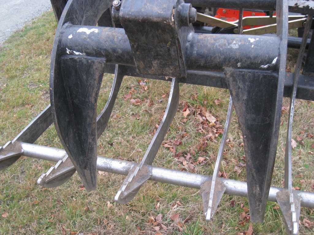

870lbs for a grapple (even 700lbs) on a loader that lifts 2700lbs at the pivot pins will significantly reduce net lift capacity. Given that the grapple weight is forward of the pivot pins, it probably reduces net lift by about 125% of grapple weight. That means roughly a 870lb grapple will leave about 1600-1700lbs of net lift capacity. Compare that to 2200-2300 net lift with a 300-350lb grapple.
The big skidsteer grapples are obviously still of use with CUTs but they are way over built for what a CUT can dish out in punishment. Lightweight grapples in the 300-350lbs range (3/8 inch steel, 48 inch width, one upper jaw) seem to work just fine on tractors up to 50hp at least. I have an even lighter duty 48" Millonzi weighing 280lbs that has served very well over the past five years. My Kioti DK40se/KL401 has identical lift capacity as the ML130 and the tractor is about the same weight too. I've slightly bent the upper jaw tines digging out big rocks (easily fixed and reinforced) but otherwise the grapple has tolerated quite a lot of aggressive work without problems.
If I had access to a SS grapple, even one as heavy as 870lbs, I'd surely use it and it would do fine for many tasks. I do however reach the limit of lift capacity with my grapple with large stumps and logs and rocks and obvioiusly a 870lb grapple would reach limits about 500-600lbs.
Having owned a light duty grapple I can say that I'd certainly never bother paying extra for a heavier duty grapple for use on a CUT. I have never wished my grapple were any stronger than it is and I don't have any trouble picking up large amounts of brush or holding logs in place with a single upper arm either.
Everyone loves whatever type and size grapple they own. My point is just that bigger is not better in this case. I think that grapple salesmen are used to selling and sizing SS grapples and that is just a different kettle of fish. A 40 or 50hp SS has a much more powerful loader and is typically used more aggressively in commercial settings than a CUT is. The assumption that a grapple should be the same width as the primary bucket is just wrong unless your main job is collecting loose debris on the ground. Similar HP CUTs do just fine with lighter smaller grapples. I don't recall anyone with a light duty grapple complain on this forum that they wished they'd gotten a bigger grapple. There are some with big grapples who wish they'd gotten smaller. Sometimes small is beautiful And, the cost of the light duty at about the roughly $1000 plus change cost is a nice bonus.
