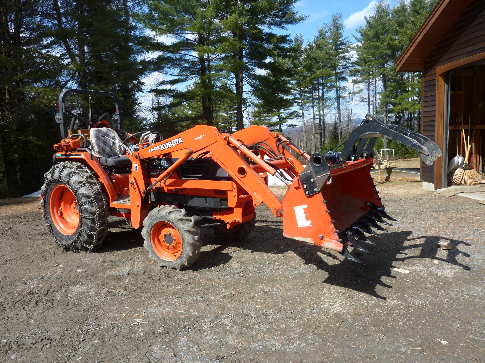

I built my Grapple onto a Bobcat LoPro bucket. Best of both worlds. I rarely put my Kubota bucket on. Still has paint on the apron after 6 years. :)

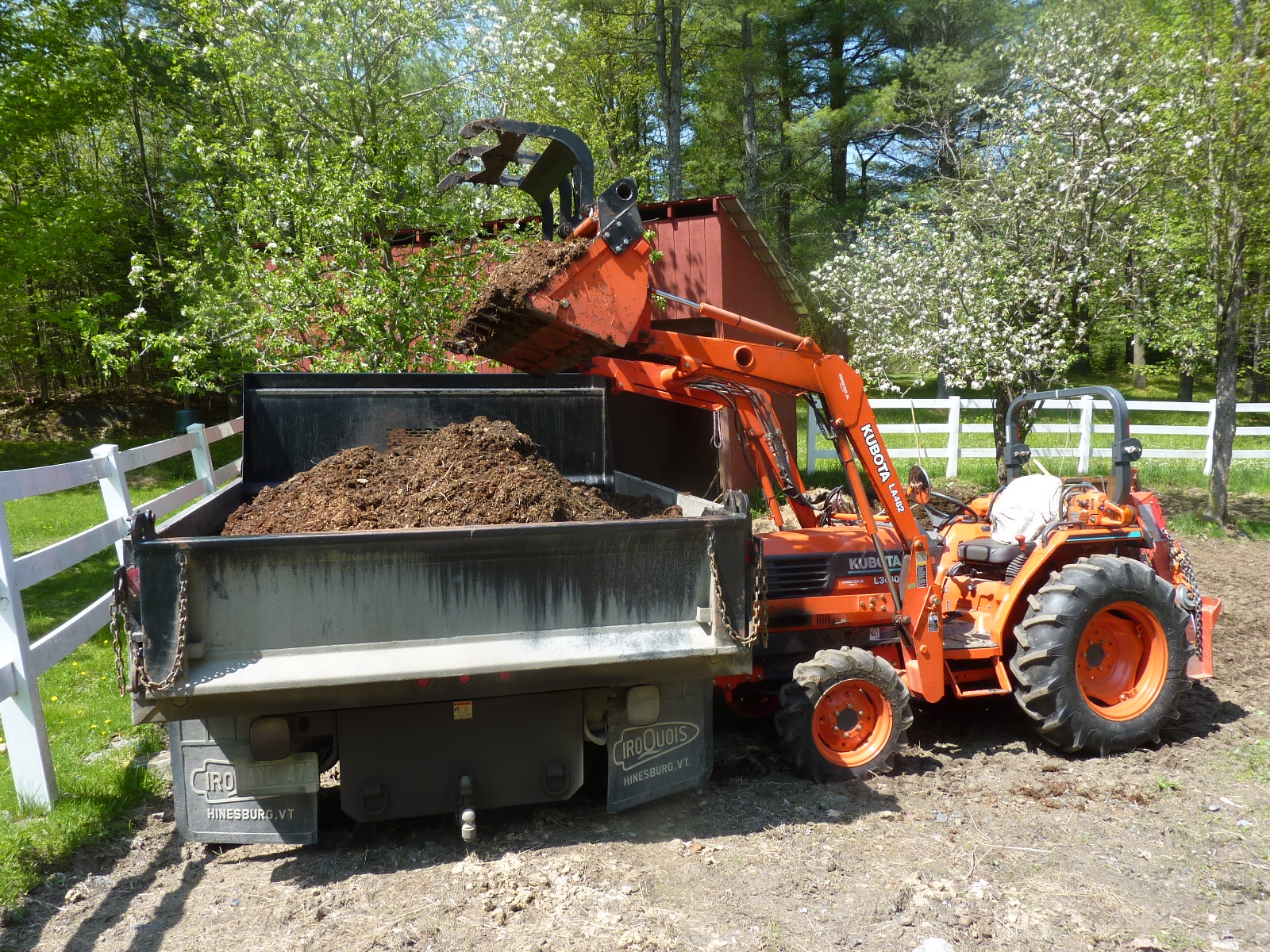

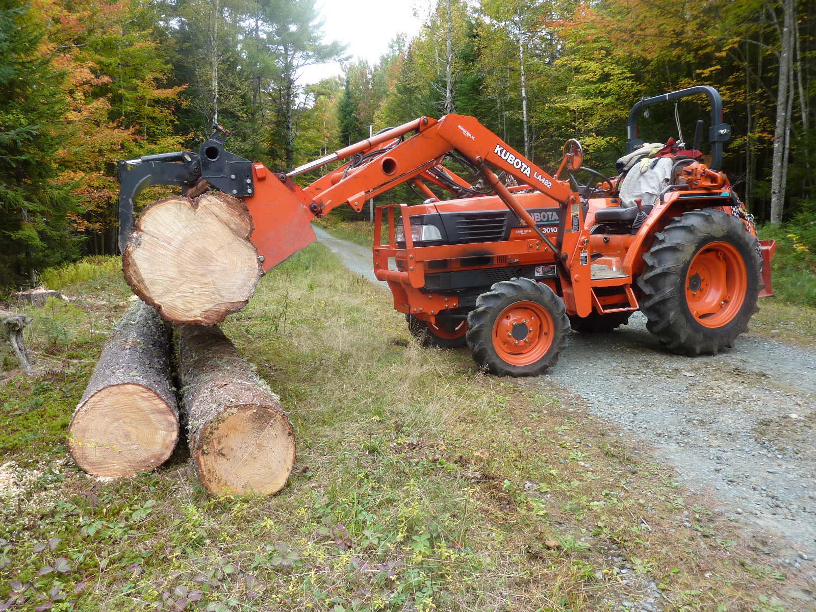

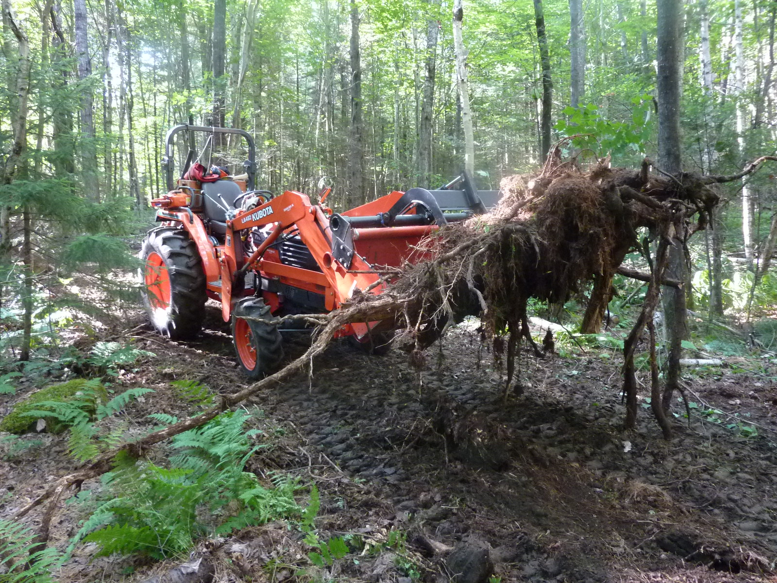

I gotta say this again. Not many listened before but here goes. This is my first grapple. It is still on my other tractor. In many ways I prefer it to a dedicated grapple because I always have both a bucket and grapple.
I could go on and on but that is already to many.
gg
Sure is nice especially if someone needs a new bucket too! Does the grapple ever get in the way?

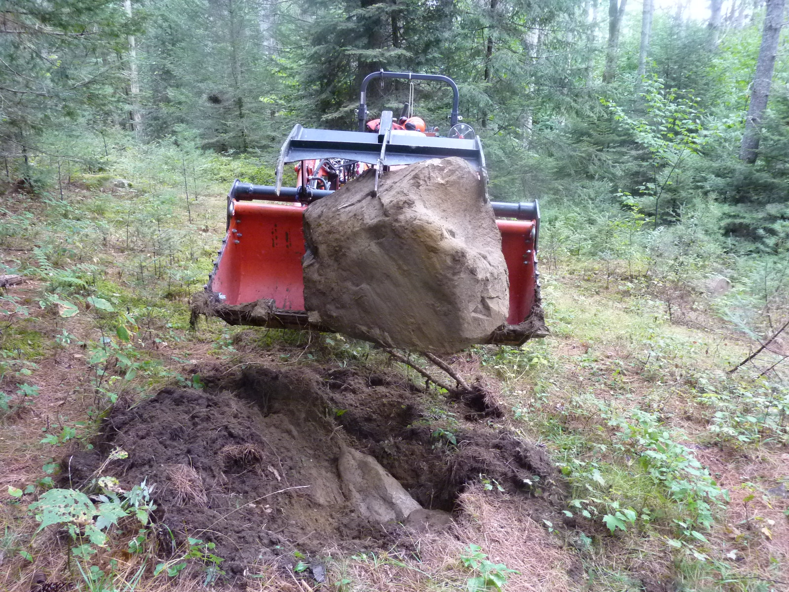

It was easy for me to decide to go that route with the bucket grapple. The tractor is almost 20 yrs old. There were no loader quick attach gizmos back then. The bucket is a pin-on bucket. Takes some work to get the bucket off then you need to buy or build a custom grapple to match the bucket pin geometry and it takes some work to mount it. So the bucket grapple was cheaper and easier. Today is much different with the loader QA plates and implements.
Anyway what I have on that tractor is an ATI grapple kit and a WR Long tooth bar. The bucket is 5' wide. I modified the grapple a little to give some more curvature and move it forward because I thought it closed to flat against the bucket edges. I wanted more room to hold stuff. You can see the welds on the mount to move it forward and the fingers I added on the tine ends.
I have removed the grapple a couple times but basically it is on all the time. If you have to dig against a foundation or barn wall it gets in the way. Working piled material or digging a hole/trench has never been a problem for me. Never have to figure out how to bring the bucket along or wish I had brought it because it is always there.
gg
