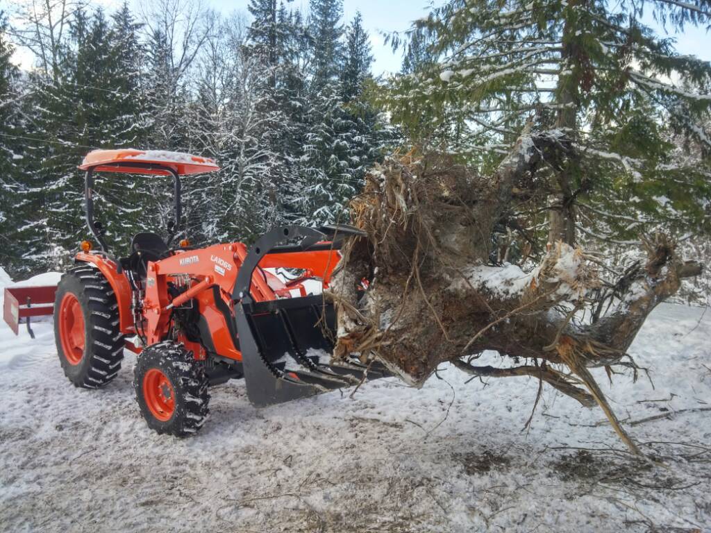

Thanks everyone for the feedback. Sounds like folks have all shapes and sizes. I would have absolutely gone with the EA wicked grapple if our dollar weren't so bad, but oh well. For now the 575 lb 76" wildcat will get the job done I'm sure. I do like the idea of using higher strength steel and cutting weight, and making the most out of the fel. Ideally I would have preferred 60-66" but I can suck it up if I get a good deal. I know EA ships to Canada, but if they had a distributor here it would be even better hint hint 😀

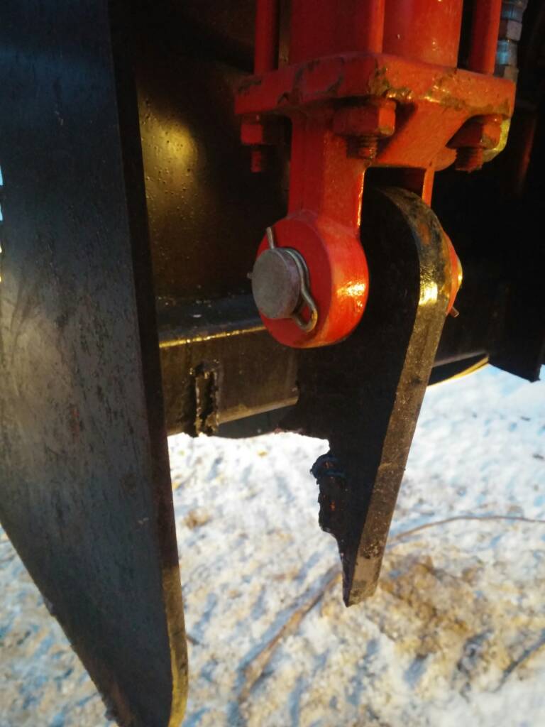

Well, the wildkat lasted about six hours before this happened, and I was being very cautious as it was my first day with my new MX 5800. I wasn't grappling anything particularly awkward or heavy either, just a piece of log about 48" long. You can tell this particular weld wasn't terribly good, and I've read in forums about the odd poor weld in the wildkat e series, so I'm not terribly shocked. A new weld in the morning and I'm sure it will be better than new. Then, it's back to work....or play...I can't tell the difference anymore.
Great grapple otherwise, it handles stumps well and the weight seems fine.

That's not a weld that's solder!

Like you said, that wasn't much of a weld to start with... Grind that bird poop off and get some 7018 at 125 amps and weld it!

You might what to look at the rest of the welds while you have your welder out. Nice tractor BTW.

I have a wildcat grapple and haven't had any weld quality issues. So I expect it is a one-off problem.
