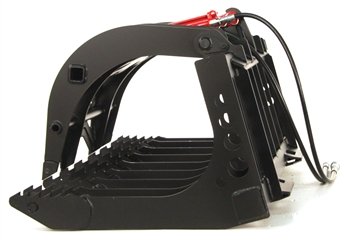

The Anbo UT-S model I was looking at seems like it might work better for that job:
UT-S Utility Grapple for 1-35 horsepower machines
At 440lbs its a little heavier than the EA Wicked but still comparable to a 72" bucket, and the tine spacing is a little wider but probably acceptable at 8". Convince me that the dig in issue when tilting isn't a problem and I might prefer the EA.

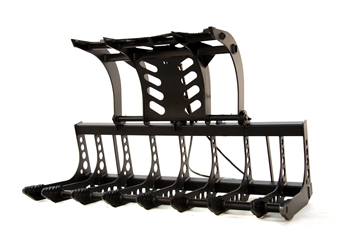

In a perfect world it'd be nice to have something with beefier tines without the cross support like one from TheRakeShop:
www.TheRakeShop.com / Root Rakes Grapples Attachments & Skid Steers
I couldn't get a response from them when I asked for specs and price but it looks like its probably too heavy.
/ Grapple Suggestions #16
I like the weight and tine spacing on that Wicked Grapple, but I'm thinking that if I tilt it up to get the teeth under the manure mat for scraping it will tend to want to dig into the floor. That little 6" flat doesn't seem like it would support the weight without digging in.
-------- Convince me that the dig in issue when tilting isn't a problem and I might prefer the EA.
The 6" flat points don't support any weight, The loader arms support the weight and should not move down as you are going forward.
The angle on the EA Wicked angle looks about the same as my Monster Grapple. I use it a lot with the flat parallel to the ground, pushing under things to pick it up.
