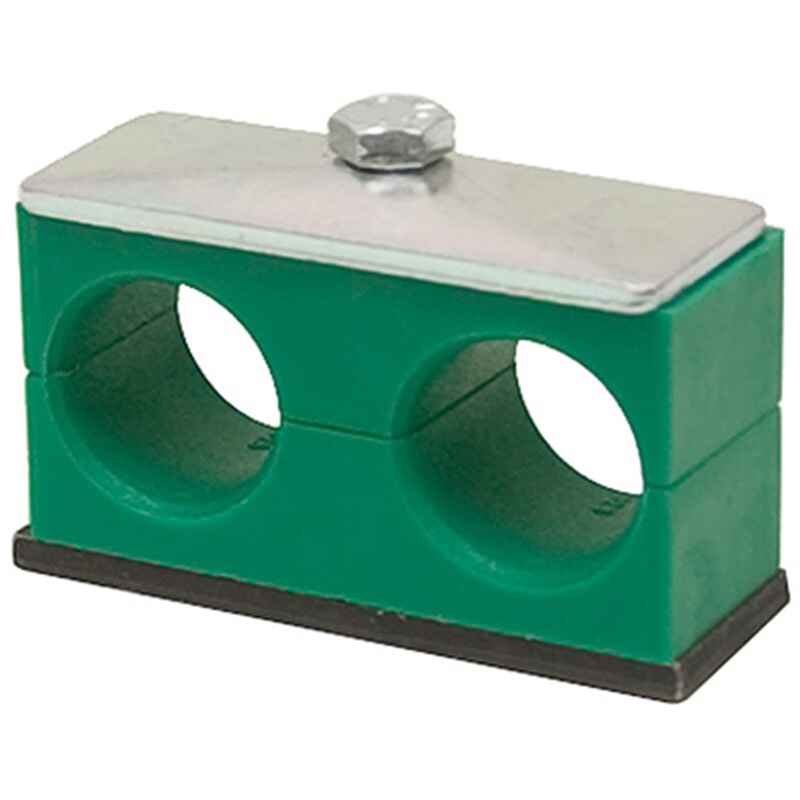

/ Grapple off a rear remote? #15
Something pulling on the lines? I had pull to release QD remotes.
I supported the lines from remotes to the loader 3rd function with clamps from back to the front.
/ Grapple off a rear remote? #16
I've looked at the lines from every angle and can't see any possible way they could be pulling as there is ample slack in them.
That is a good looking support bracket you have there, where did you find them?
/ Grapple off a rear remote? #17
Surplus Center. ZORO or about any hydraulic supply.
