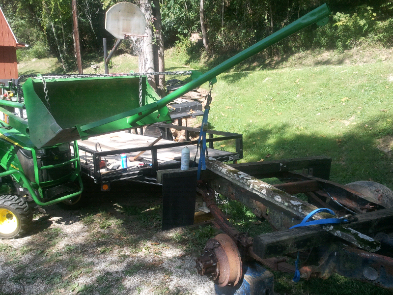

I built it out of scrap metal
3/8 x 4 x 4" angle
1/4 x 1.5 x 24" flat bar
1/8 x 3 x 96" tubing
1/4" mounting and lifting points
1/4" chain to bucket
All welded with 7018
It can safely hold 800-1000 lbs at the lowest lug and 250 at the top lug

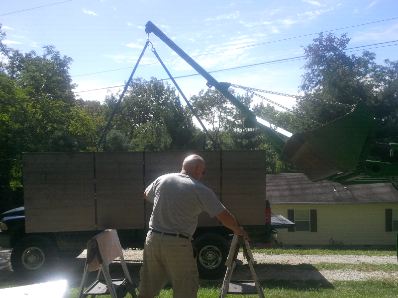

200 lbs of steel rigged at 9.5 ft from bucket pivot with the boom at a 45 degree angle. This is equivalent to 950 lbs at the pivot.
At this height I could not lift, only curl.

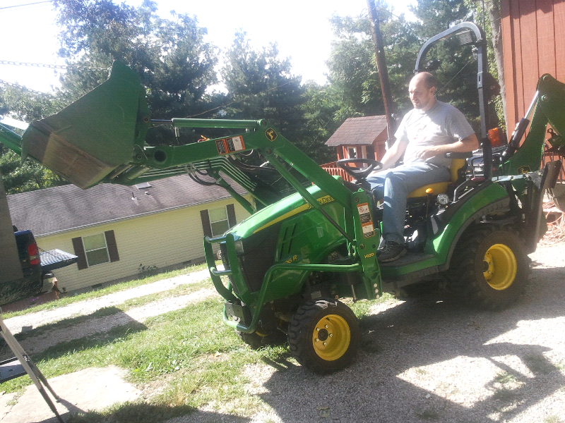

Here's me as the counterweight. The rear end was very light
   / grapple hydraulic setup 1026r #107
Ok from the picture it looked like a lot more weight.
