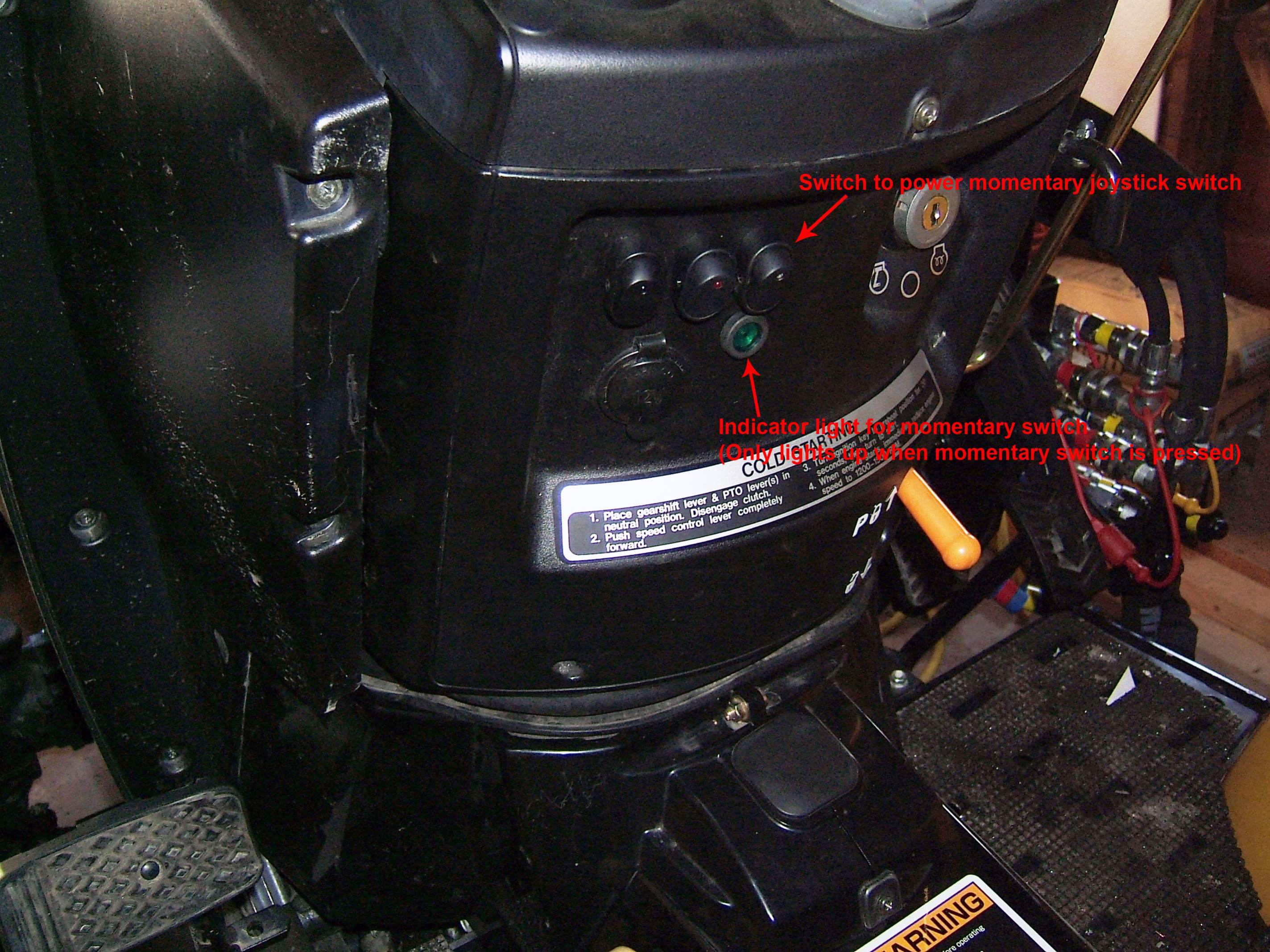

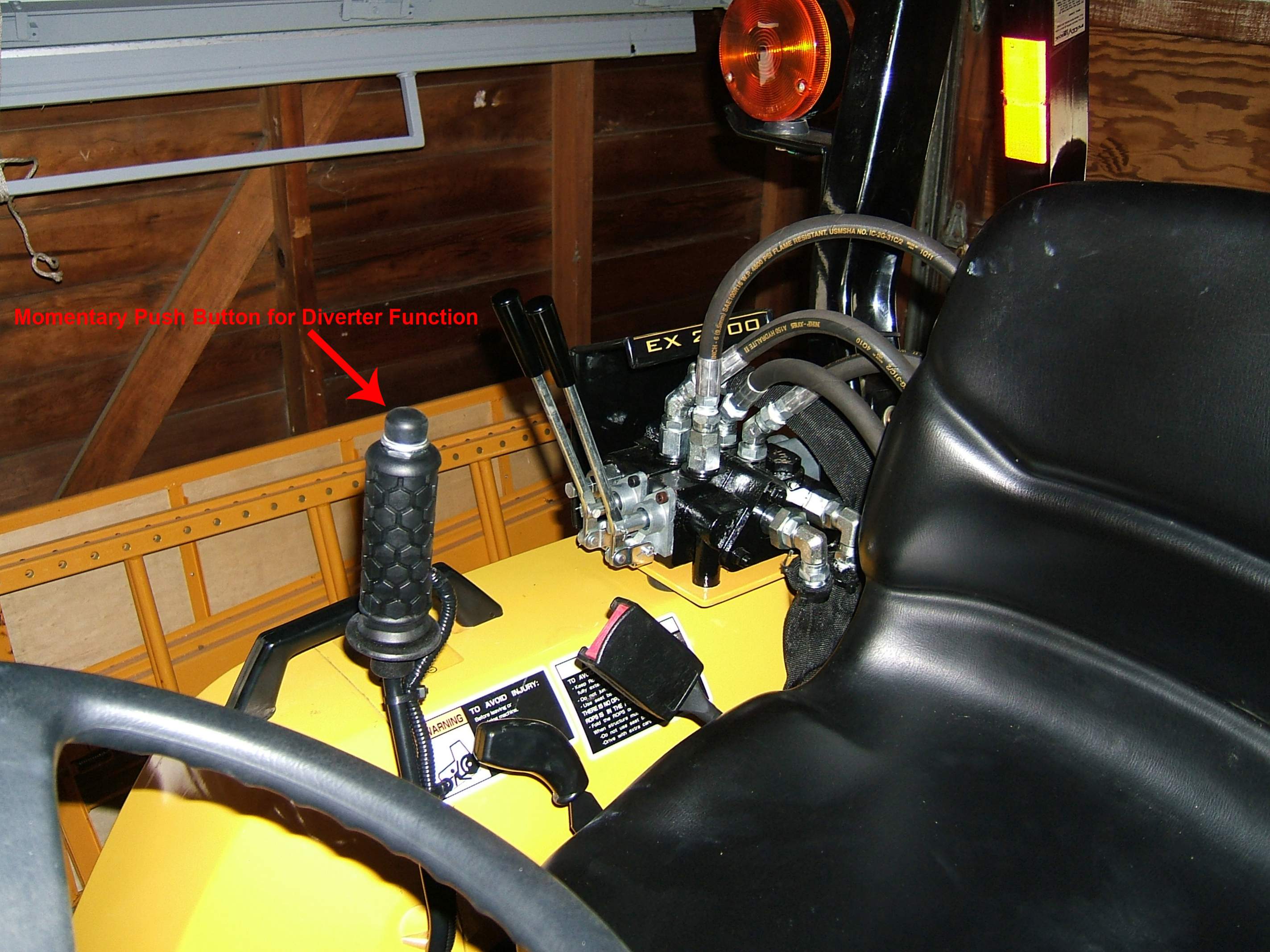

Hey swick1 I have that same valve on my Ex2900, I agree totally with JJ I've found that these valves don't like to switch when under pressure (sometimes they will, sometimes they won't), I plumbed mine through the curl circuit and have found that you must push button first (or in your case step on button first) then work joystick as usuall. I would suggest trying to switch it with the hydraulic lines disconnected. Also I cranked the #hit out of the 1/4" mounting bolts on mine, so I don't think that should be a problem. As far as wiring goes if I remember correctly, I wired mine + positive from battery to fuse, from fuse to a rocker switch on my dash (so I can disable this feature when not needed) then + positive to momentary push button on the joystick then to solenoid and grounded everything to the frame. Here's some pictures if they help.
