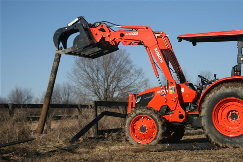

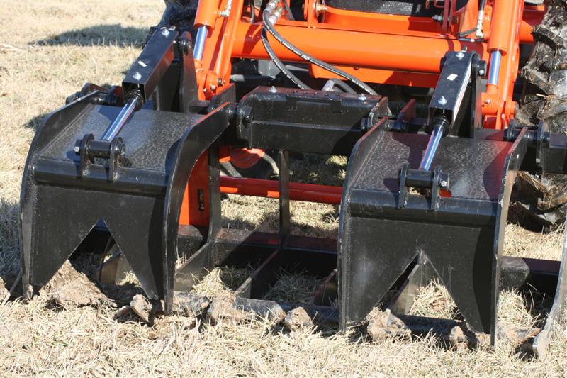

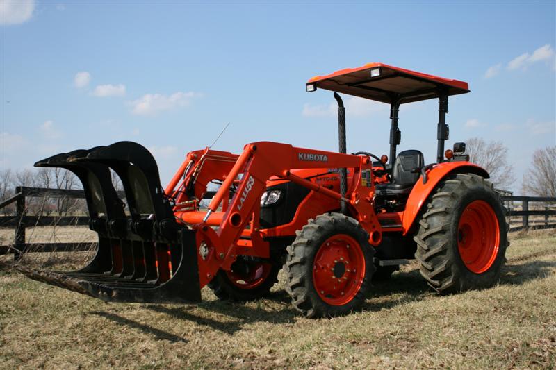

I have been wanting to remove a bunch of 3-plank horse fencing for about 4 years now. Just never got around to it. I have an open jaw type grapple; like the Millonzi type. I absolutely love it for picking up and moving brush. It is great. But it is essentially impossible to pull a fence post out of the ground. I had considered getting a 4-n-1 bucket. That would be the perfect implement! But I would likely not use it much after the fence posts were gone. Then I started thinking, what about an open faced clamshell type grapple? That seems like it would work to move brush AND pull up fence posts! Has anyone had any experience with this? What is the tine spacing on the Borgford BoDozer grapple? And if the consensus is that a clamshell grapple is superior does anyone want to buy a used Markham Welding heavy duty grapple rake?:D

I would figure if you can weld or bolt a C on your bucket, forming a D with the edge of your bucket, you could slide that sucker down the post, tilt the bucket so you have good grip and lift. I've never tried it myself, but might work.
/ Grapple for pulling out fence posts? #4
Maybe bolt some strap or something on the end of your existing top grapple clamp so that it would fit over the post and then be able to wedge it to pull the post out.:confused: Me, I just use chain, a little more work, but much more economical.

Before spending much money on another implement, try temporarily welding or bolting a sturdy piece of angle iron between the 2 tips of one grapple arm. (making the "V" solid) From your picture, it looks like you could pinch a post between the new angle iron and the cross supports that connect the tines of the lower jaw near their tips. And it would be off to the side where you could see it.

Or for a different approach- maybe drive a 3/8 or 1/2 inch diameter lag screw into each post with a cordless drill, leaving about an inch sticking out. Then lift the post with the lip of your bucket catching the bolt? With enough screws, you could stay on the tractor.

A small chain with a hook on one end wrapped around the 2 center lower teeth on the grapple creates a pinch point for pulling posts . I have used this method on my grapple . Go over post with grab tilted down , close clamp , tilt back to jam post and lift . Move tractor forward or back a little which loosens the post if need be .

How about chaining a good sized log or stump into the grapple and then using the upper grapple jaw to press the fence post against the log/stump to grasp it and then lift. Not elegant but it might work.
