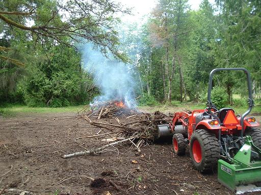

Yes homebrew2, most of my piles are interlocked windrows and piles of smallish slash pushed together by an inexperienced dozer operator (me). If you were chopping up a log into firewood wouldn't you have to keep going back and forth to keep the log balanced on a set of forks?
What about grabbing a big ol stump? I would be afraid of bending the long forks needed to reach all the way under a stump.
There is certainly some geek factor or cool factor that carries some value with a grapple. I won't lie about that.
