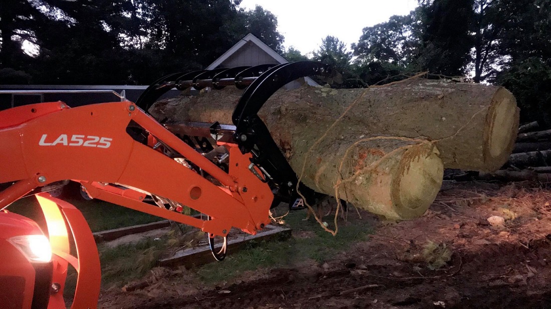

Thanks for all the info and tips. The CK3510SE comes with the third function valve and the grill guard. I will definitely look at adding the mesh to the guard. My plan is to use it to move felled trees, piles of railroad ties and lots of brush. I will occasionally need to dig up stumps and rocks. I also have a few places where trash has been dumped, lots of misc items, plastic pallets, car parts, concrete, bricks, cement blocks, etc... All this was left behind from previous owners. I am leaning toward the root grapple after watching more videos as the wider spacing of the tines seems to be a better all around tool. Is that a correct assumption?
My local dealer has Tiger Attachments grapples. Has anyone had experience with that brand? Cannot find a lot of information about them online.
   / Grapple decisions.... #13

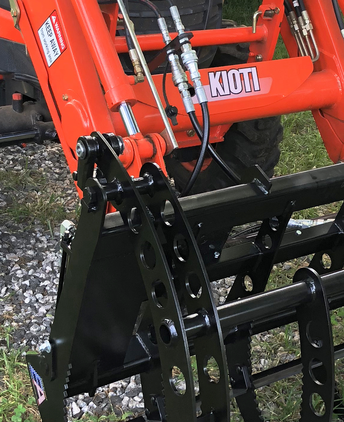

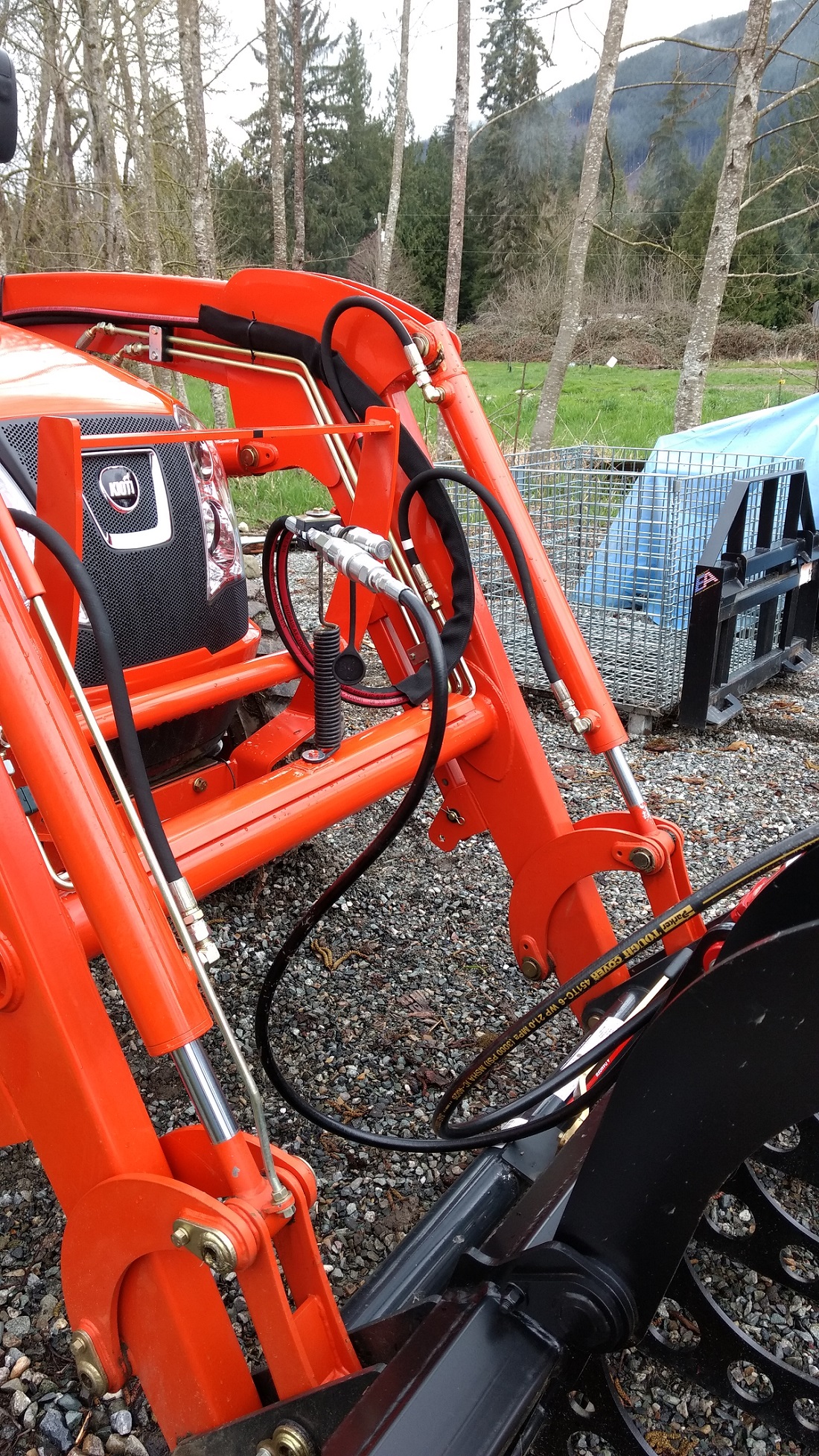

Josh - that's one item where you should have a whole lot of choices - grapples. My grapple & 3rd function valve were installed by the Kubota dealer. I was planning on an ANBO grapple ( company is 70 miles north of me in Colville, WA) but I got a good deal from the Kubota dealer. The tine spacing on mine is 6". If I come straight down - jaws wide open - push down hard - close jaws - I will come up with a huge pile of dirt and not loose much thru the 6" spacing.
People will spend an inordinate amount of time discussing tine spacing. About the only time I would say that tine spacing was critical - moving gravel - and there a grapple falls on its face. Unless you are talking about some unusual design or like the 8900 pound grapple I saw while visiting ANBO - most spacing is - 6" or 9" or 12".
ANBO is unique. They have a whole battery of standard grapples and then they will work with you to design just about anything your little heart desires. As long as it follows acceptable engineering principles and procedures.
I choose the rock & root style because I don't have even a wheelbarrow load of brush on my property. Its all large pine logs, big rocks and back dragging. Rock & root or clam shell tends to have shorter, stouter tines. And at least with the Land Pride - it has significantly more bracing and cross bracing then their "brush grapples".
The costs involved in mine - WR Long 3rd function valve - $1200 installed Land Price SGC 1560 - $3175 installed. This is a very heavy duty grapple - thick, short, heavy tines and welded cross bracing everywhere. Weight - 820 pounds. The weight of the grapple cuts my FEL lifting capacity down to a tad over 3200 pounds.

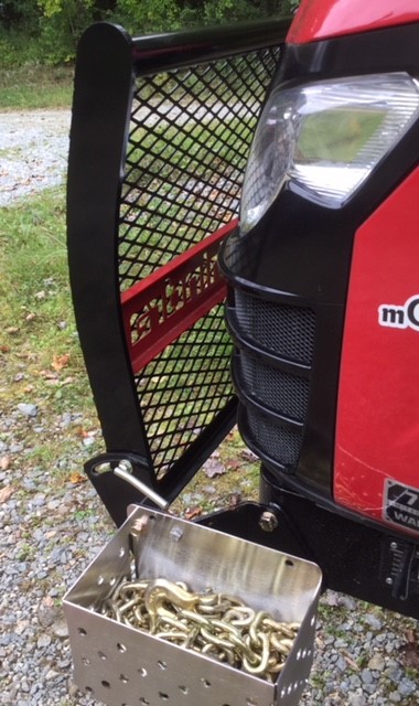

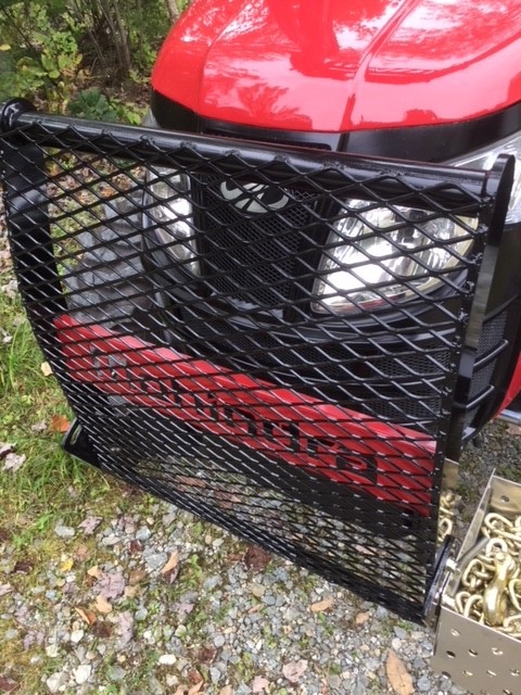

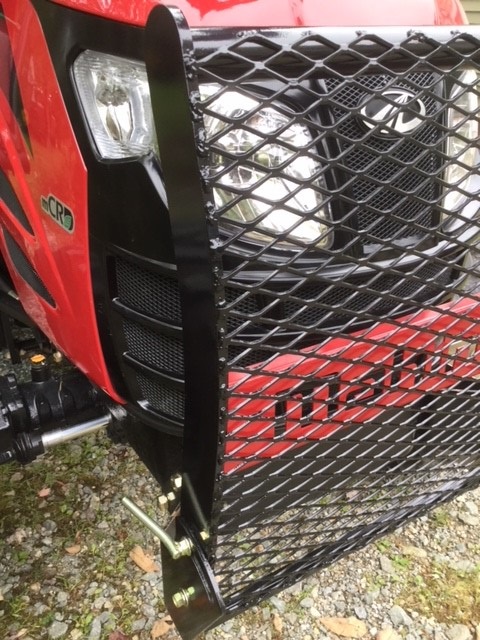

Tractor NH - that's a nice job. Your expanded metal is a heavier gauge than mine. And theKKfan - I have NO idea what gauge or calibre my expanded metal is - - maybe Tractor NH know what he used.
I read a few posts here on TBN where guys had perforated radiators, grills and batteries with limbs, stobs and trash. That mesh was done immediately after the tractor returned with the installed grapple.

Those of you who use expanded metal over your brush guard: Do you ever wish you had not welded it on? I'm debating whether it is worth the trouble to make mine a pin-on frame, rather than welding it on.

John_Mc - - No, I'm VERY glad its welded on. Limbs & associated crap can hit that grill guard and expanded mesh pretty hard. I don't know if a pin on system would stand up to the abuse.

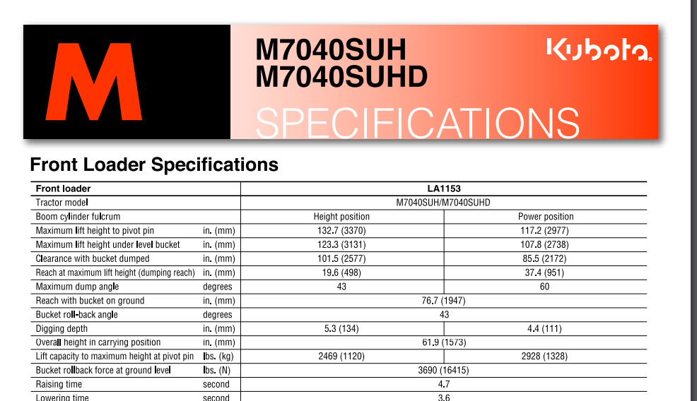

That math seems fuzzy..... Is this your loader or a different one? Numbers look almost identical to my KL6010.
   / Grapple decisions.... #19
theKKfan - this is the current FEL on my M6040 and the info directly out of the Op Manual for that FEL.
I do not know how to answer you - if you can not follow the math - - ??
No matter how anybody looks at it - - - 4300 minus 820 will ALWAYS EQUAL - 3480. At least on this world.
The power lift charts for my FEL are simple charts - easy to read and interpret.
The ability to lift heavy loads with my FEL follows right along with what the charts say it should lift. A fresh - just cut - ten foot chunk of Ponderosa pine with the butts averaging 36" will always weigh right around 3200 pounds.
I'm very happy with the way the system works - - that's what counts for me.
OK - KKfan - look at the data you posted. It says 2928 pounds max when in the heavy lift setting and at MAX HEIGHT... I COULD NOT CARE LESS what the FEL will lift at MAX HEIGHT.
If you will re read my previous post - #16 - you will see I am using a height of 500mm( 20") off the ground. Big difference there fella........

I am now even more curious as to what the M6 manual states.
It would really make these tractors look more attractive and alter some shopper's tractor choices if those numbers were published in the brochures, but the reasons not to must be more important.
