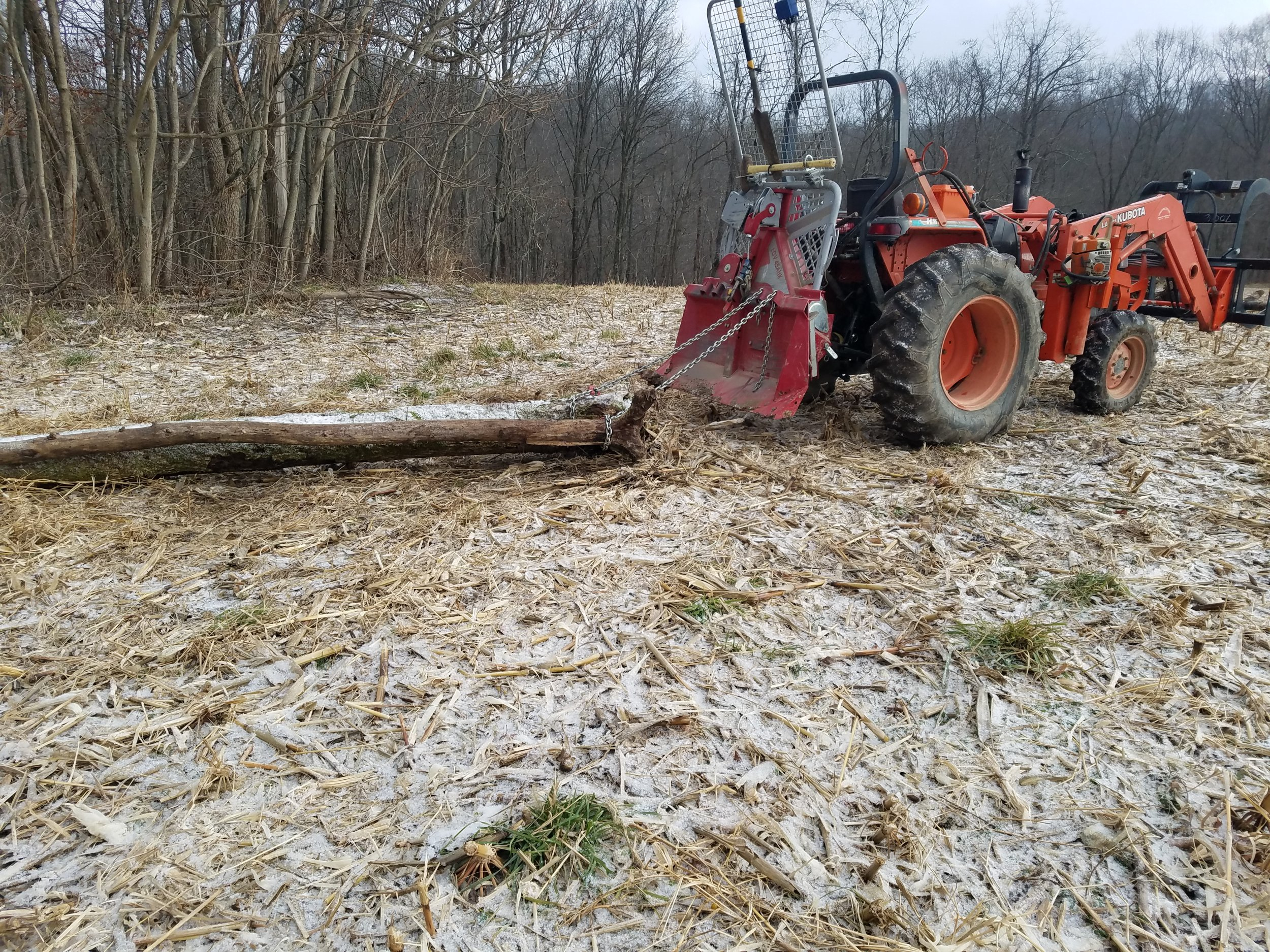

I think about $200 in material including cylinder and hoses , labor wasn't too bad but way more grinding than really needed as I traced a wooden template with the plasma cutter. Of course the material is up now. I now have some CAD drawings so I can have the parts cut on a cnc plasma table which will eliminate a lot of hand work and make it go together much faster. I plan on building them and selling them for sub 35hp tractors. I'll get enough parts cut to build two at a time. Thank you

I built a similar set up on my last tractor, it puts a tremendous amount of stress on the top of the bucket (bent mine and had to install a heavy angle iron to reinforce it) plus you can't see through the bucket. One thing I also did with it was to add some short forks in the corners of the bucket, that helped a lot. After looking at your pic again, I suppose if you set your relief low it might be OK. Shot around for cylinders, ebay has some decent deals for smaller ones.

Built this for a friend of mine.
This one I built out of 3/8 steel, 6" stroke x 2" bore cylinder
even the tubing is 3/8 wall. It should serve him for many years.

You don't attach anything to the center of bucket its
bolted on the top sides of the bucket
