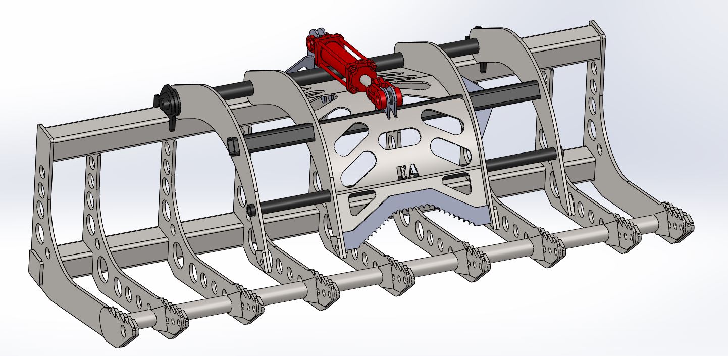

Don't think you need a middle tooth, but agree with IslandTractor about a brace.
Sometimes you need to pull on the end of a log or tree trunk. That is why the "teeth" are in the middle of this one from EA. Maybe you could add something similar.
That middle serrated "tooth" would be helpful in some situations. I can usually manage without but agree that for pulling on the end of a log it would be much easier. I don't run into that situation much though and would typically approach from the side where it would not be an issue.
The twisting of the upper arm would occur not so much with closing on an object that had contact with only one tooth (though that would certainly put some torque on the arm) but rather when carrying a long heavy object that simply has a long lever arm. I put a slight twist in my upper arm once when I lifted a long tree and didn't pay attention to the fact that the root ball was dragging and hit an obstruction. Didn't affect function but clearly showed the power of leverage and that grapples (or FELs) are not engineered to resist such twisting forces.
The new style upper arm that EA uses seems to me to be much better supported against such twisting forces but I'm no engineer.

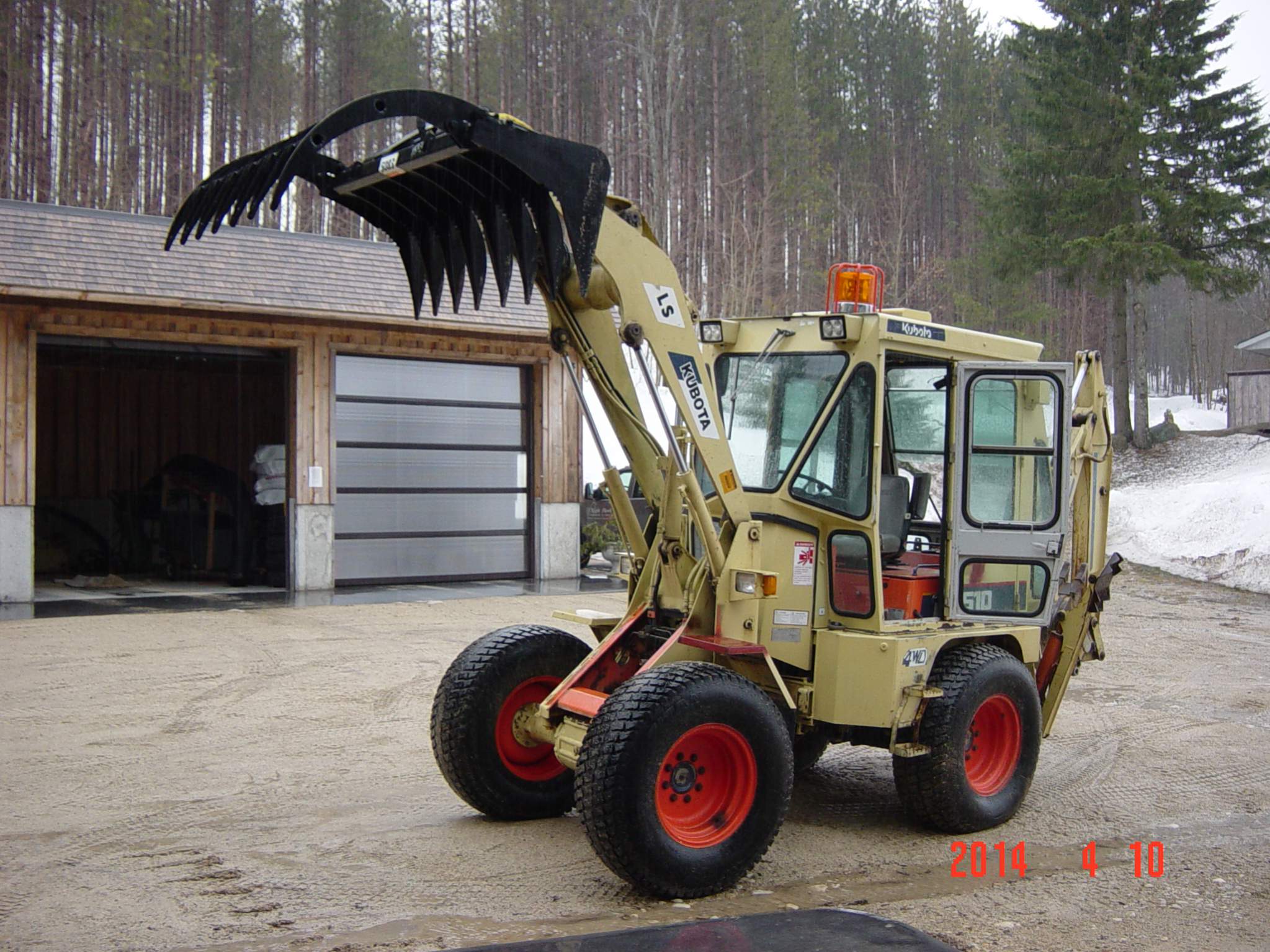

A few days ago I added some more gussets and reinforcing to the grapple. Then used it for a while to see if there were any areas of structural concern. I think I'm ok with it now but I have an issue that I need advise with.
I can't see the grapple tines unless the grapple is tilted vertically. If I am trying to use it to push along the ground, with the tines parallel to the ground, I can't see if the grapple is tilted right or not. Even if I hang may head off the side of the tractor I still can't see the grapple tines. Unless I can find some way of judging the angle I may have to make the grapple wider just so I can see where it sits.
What do you guys do?

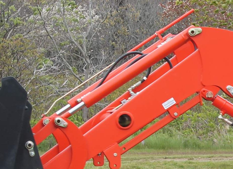

I can see mine fairly well.. Do you have a bucket level indicator rod on your tractor? loader rod.JPG

That is not particularly unusual. I have to move my head around a bit and sometimes stand up to see the very tips of my grapple lower tines. I've often thought that I should install one of those rear view cameras in some armored spot that could give me a clear view of the grapple but I've managed without.

That is an amazing project! I'm impressed. I would offer three suggestions. I would add a "V" shaped plate between the top two teeth to add a center grip and in case you pick up a tree by the trunk parallel to the tractor. I do this very frequently. I have also use it in a similar fashion to pick up a long post and transport it or to stand it up in a pre dug hole ( as in building a pole barn". But my point is, I often pick up things longitudinally, not crosswise.
I would also add a protective plate, or mesh in the rear to keep limbs from poking through to the front of your tractor.
And perhaps spacers midway between the main bottom tines to keep debris from falling out, for instance when picking up smaller stuff or rocks.
But overall, that's a piece of art! Great job.
