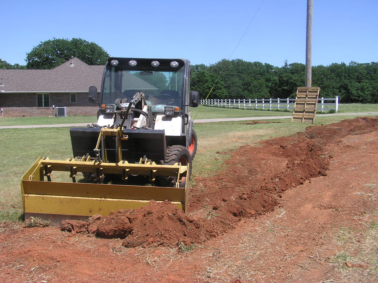

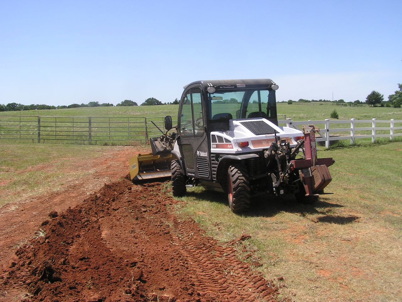

I guess being able to angle like that is a blade's advantage over a box blade. I can just tilt my box front to back and side to side of course.
I can angle my box blade using the crab steer mode of 4 wheel steering:
Notice the dirt windrow ^^^^

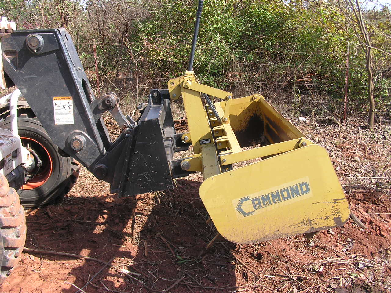

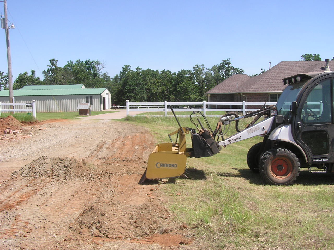

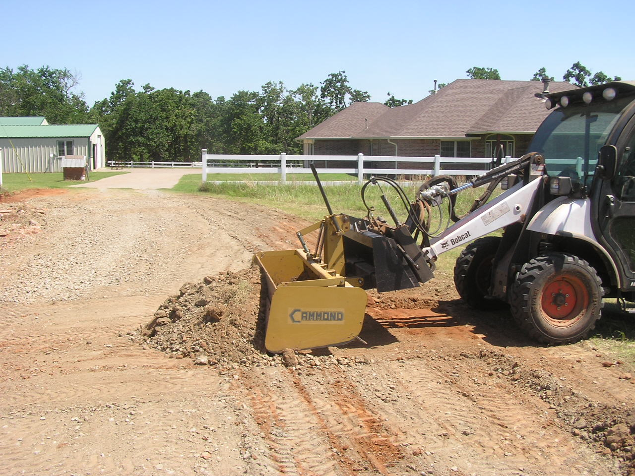

Strange beasts, the box blade is in the front?
The front is Skid Steer Quick Attach (SSQA) and the 3 point box blade is on a SSQA to 3 point adapter:

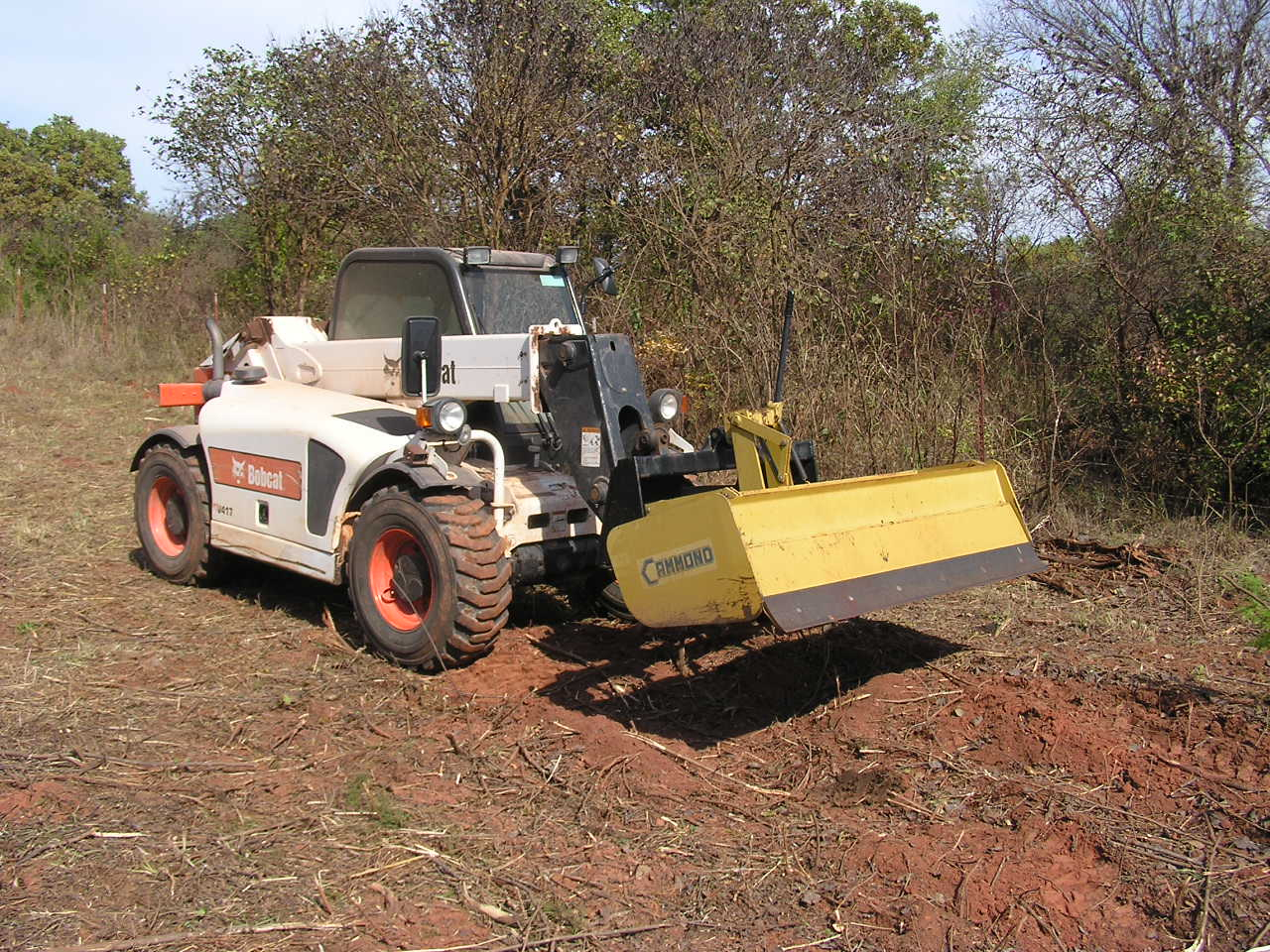

What's relation to the Compact Telehandler?
Totally different machines, but I also can use the box blade on the front of it with the same SSQA to 3 point adapter:
