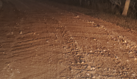

I don't have a lot of experience doing this basic task. See the photo, I've used both a blade and box blade and keep getting these ripples and have no clue why. I've tried it with the lift arm float mechanism in and out and the slow-return lift adjustment loose and nearly off and nothing gets rid of the ripple. The tractor is a Branson 3520 and it doesn't have draft control, not sure if that would help. I'm in cenral Texas hill country, v hard ground, very rocky, I usually try to do any grading when the road is just a bit wet. Anyone have any ideas? Is it something obvious and I'm just too much a noob? Thanks for any suggestions.

I see several problems. 1: tractor only has position control. Front wheels go over a ripple the blade mounted behind the rear wheels go down. Then back wheels hit the ripple and come up causing the blade to exaggerate and go even higher. 2: blade too light 3:blade behind the back axle exaggerates tractor movements.
I had added draft control to my Ford 1320 which helped but not enough. I added a gauge wheel out back so tractor rear axle went over ripples etc the blade only moves up half the distance. Someone mentioned 100lbs per foot of blade width. IMO that is not enough but would depend on soil being graded. For my soil at least 200lbs per ft or down pressure on the 3pt hitch which I don’t have. Using rippers may help. I don’t know.

Add a lot of weight, slow down, put blade parallel with rear axle, don't go fast. You must 'cut' the ripples and valleys off. Scarify if possible several times.

Washboard is usually at intersections where traffic speed changes dramatically and/or on steep inclines where wheel slippage gets them started.
The OP's problem is blade chatter.
Interesting to read all the posts and theories. All must be taken with a grain of salt. My roadbed type isn't like the OP's or like most of the posters. We should always consider that. What works for me might not work for the OP.
I've maintained 16,000 miles of gravel roads in NW Missouri over the past 32 years. But I don't know how to maintain his Texas road. I know theories and can offer suggestions that would work for me.
My first is to do the maintenance when the roadbed is damp. In the pic the roadbed is wayyyy too dry.
