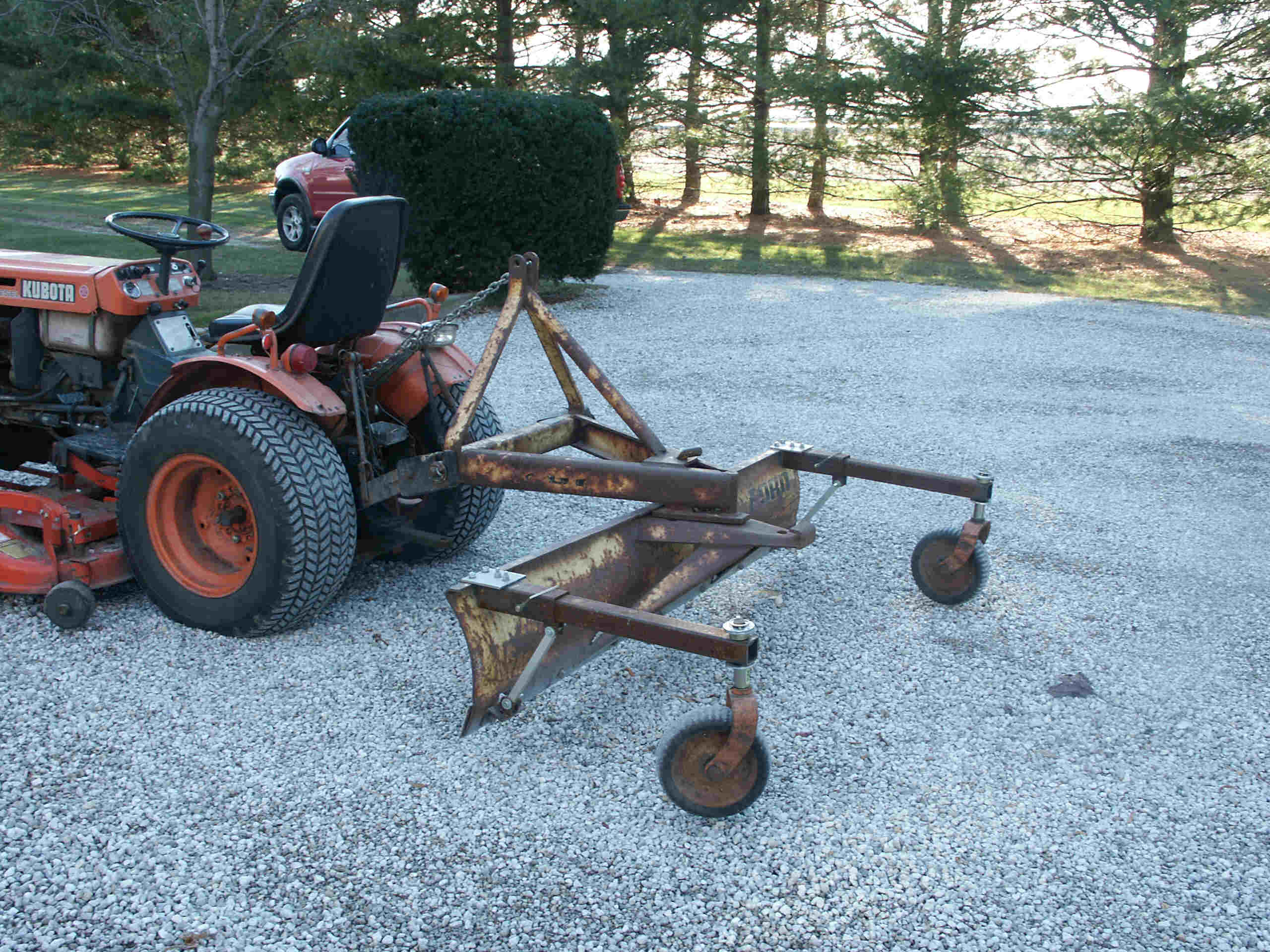

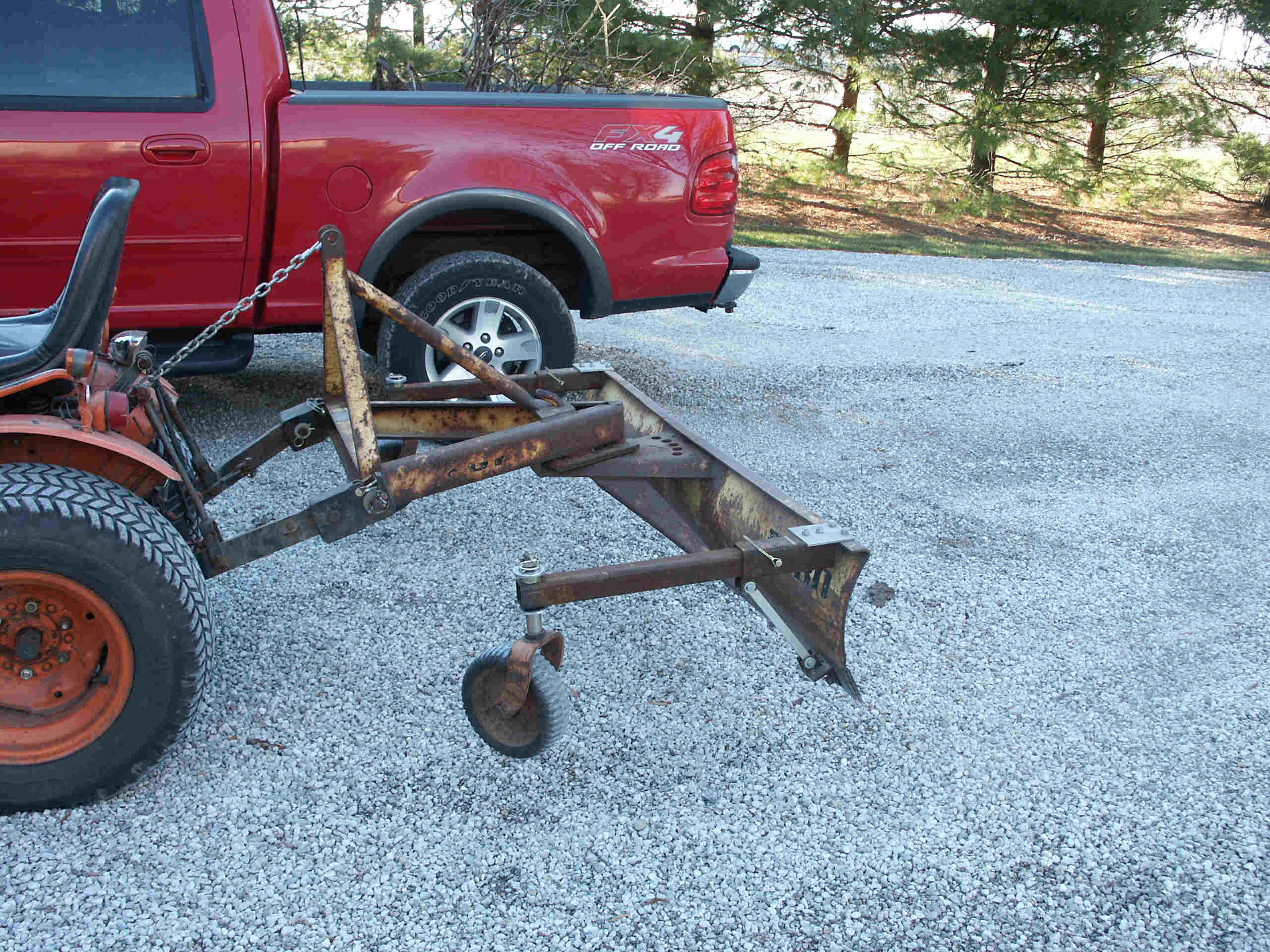

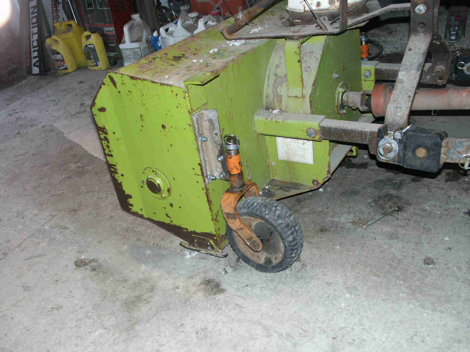

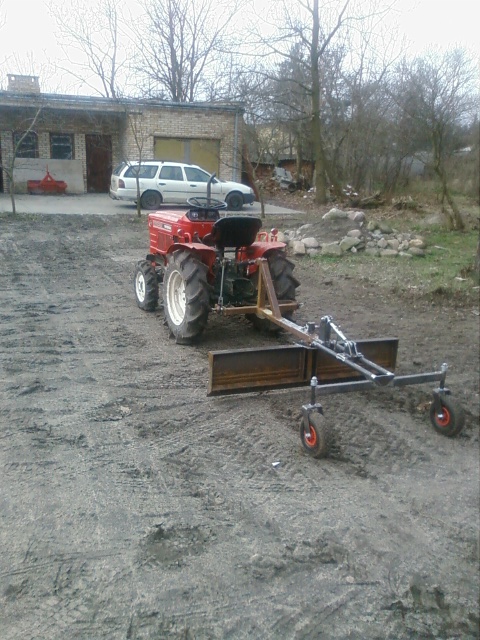

I thought I would post photos of the gauge wheels I put on my grader blade. These wheels came off my old Kubota rear mount mower. I also use them on my snowblower. Not perfect, but the blade sure works better with them. Eliminates the ups and downs as the front wheels go over bumps or in holes. They help keep the snowblower out of the stone as well. For light grading I use a chain in place of the third link for easier height control. PICS included. (Photos out of order)

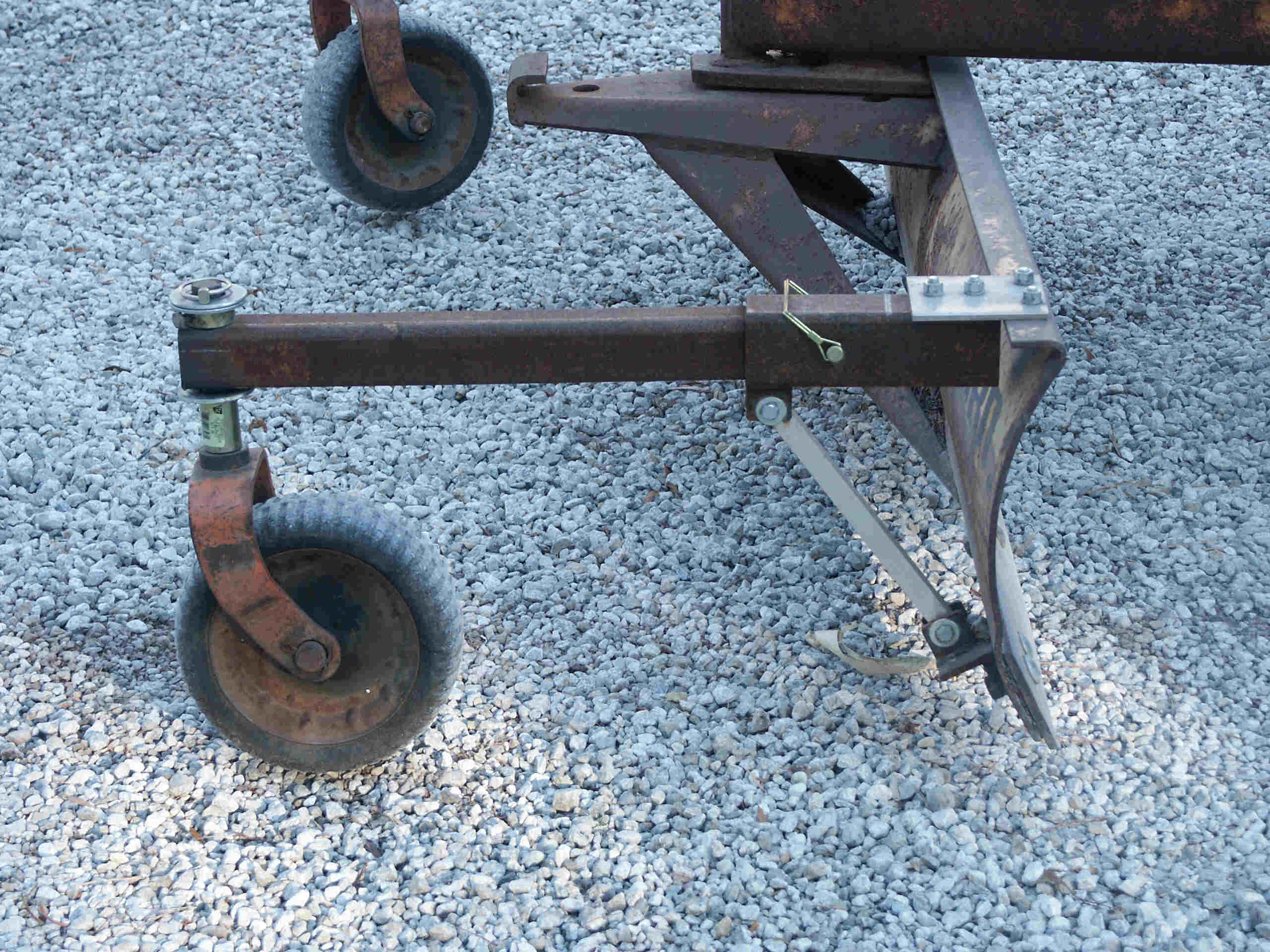

I made a set of guage wheels out of my rotary cutter rear wheels.
Actually I made them FOR my rotary cutter and wanted to have 2 wheels back there instead of one. Then I figured I could swap them over to my boxblade to spread lifts of material or to do some really good smoothing with it. I made receptacles for the implements all the same so I could switch them from implement to implement. I also made them with a hydraulic cylinder so I could set the height on the fly using one of the rear remote valves. I have receptacles for my wife's rake too, but haven't installed those yet.

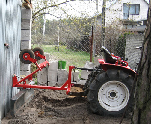

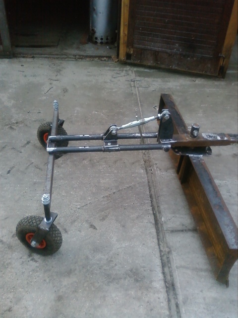

Gauge wheels are a great help to get a great looking finish in a short time. I made mine for the RB that I made. I planned for the wheels at the beginning of the project and believe that they came out well. Rear blade with gauge wheelsl
It would not be too hard to make my wheels a quick attach, but right now I have no motivation as I have nothing else to put them on.:( The adjustment mechanism could be easily replaced with hydraulic if it were available.

Mike, if you were to use a flexible top link (Elsie71 uses a chain) you may find you are able to adjust your 3pth enough to save some of the changes in your wheels you are now making. OK, can not think of what they call if but you could use one of the electric screws (Northern Tool has them in current catalog) to adjust your wheels.

KThompson - You are right. With the chain in place of the third link, I can control the height of the blade by adjusting the 3 pt. The blade, of course, is suspended between the wheels and the hitch. This only works for light grading, however. For heavier material I have to use the third link or the blade will rock forward.
3RRL - Your system if far superior to mine but way beyond my talent level. Mine only involved cutting and drilling with a very limited amount of welding. It still needs a coat of paint.
ahh guys do not do this to me!!:( I thought for sure that I had a perfect REASON for needing to tap into the hydraulics. Do not take that away from me.
Actually the chain idea is great and I had not thought of that. It does make good logical sense as I think through the action with a chain. With a rigid top link the blade height is dependent on the top link adjustment and the adjustment on the wheels. basically if it is set then you can just drop the 3 pt down and go and the blade does the work of taking off the high spots and filling in the low.
With a chain then the adjustment is predominately with the 3 pt. Consistency from pass to pass becomes a bigger challenge, but the biggest problem with a chain that I can see in my mind--not in practice because I have not gone out there today to figure out how to do this.:rolleyes:--would be if you had your blade at an angle. It seems to me that then you would need a rigid toplink to maintain the level of the blade, so that the corners did not dig in.
A very interesting idea that I will have to try. Thanks for posting the suggestion. Now the actuator would work, but I am going to hold out for hyd. Your suggestion of the chain will keep me busy for a while.:D

MJP: I wanted the compliance a chain would offer but I have T&T and my blade angles, too ...so, my solution was to put a swinging bracket between hyd toplink and toplink mtg pt on blade ...in fact, I used the top link adapter that HF sells for their quick hitch ...works great.

Hi David,
Mine are the swiveling type like you thought.
Mine are off the rotary cutter tail wheel. In fact, that's where this set was made for. I made them so I could take them off and use them as gauge wheels on other stuff.
