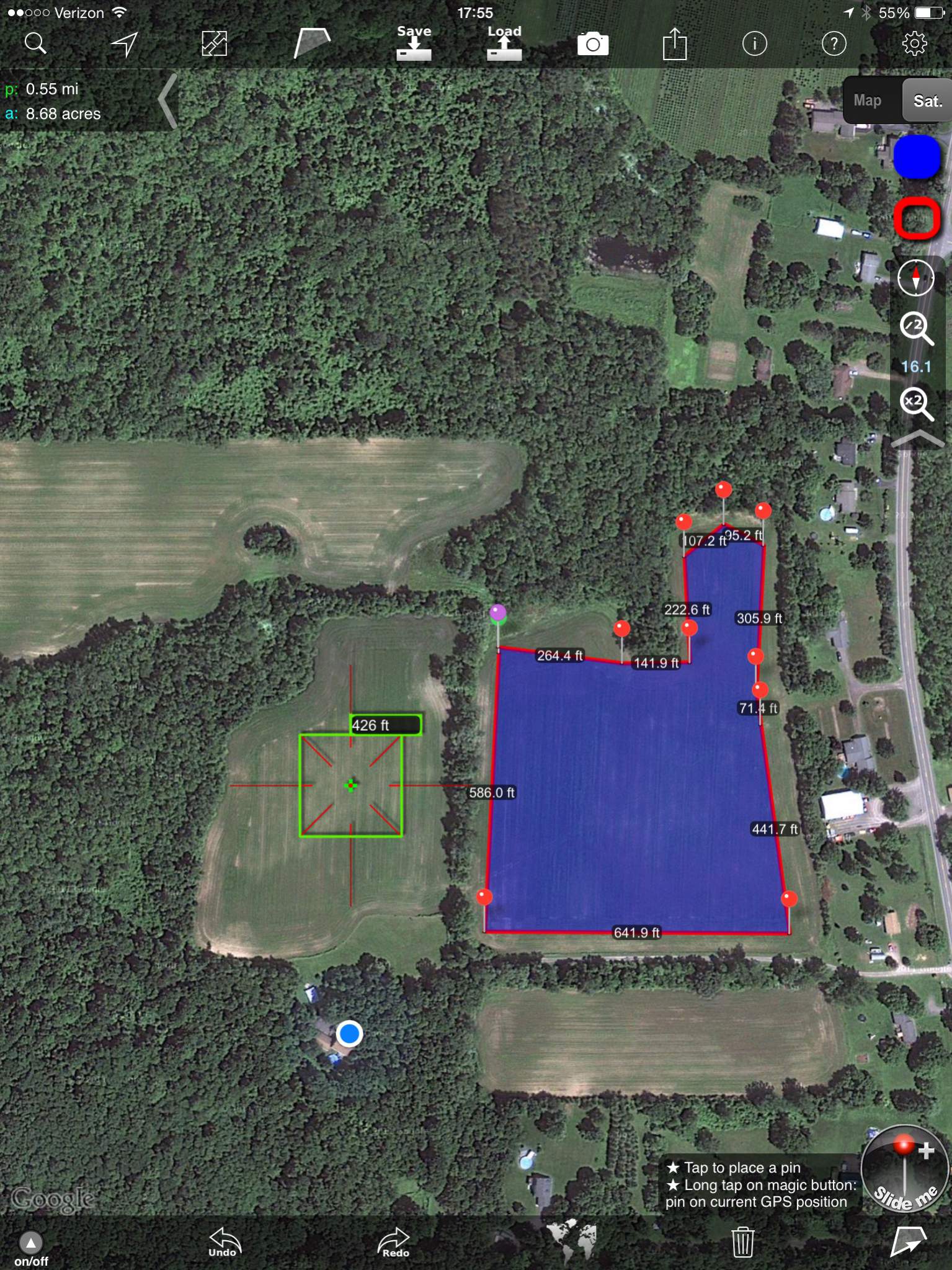

For what you describe, there is an App for that. As long as you aren't trying to locate actual lot lines or crowding a border, these work very well.
The one I use is Measure Map. I have attached a screenshot of a quick outline in a field. A guy who does roofing estimates turned me on to it and it's a great app for any business that needs to estimate areas.
