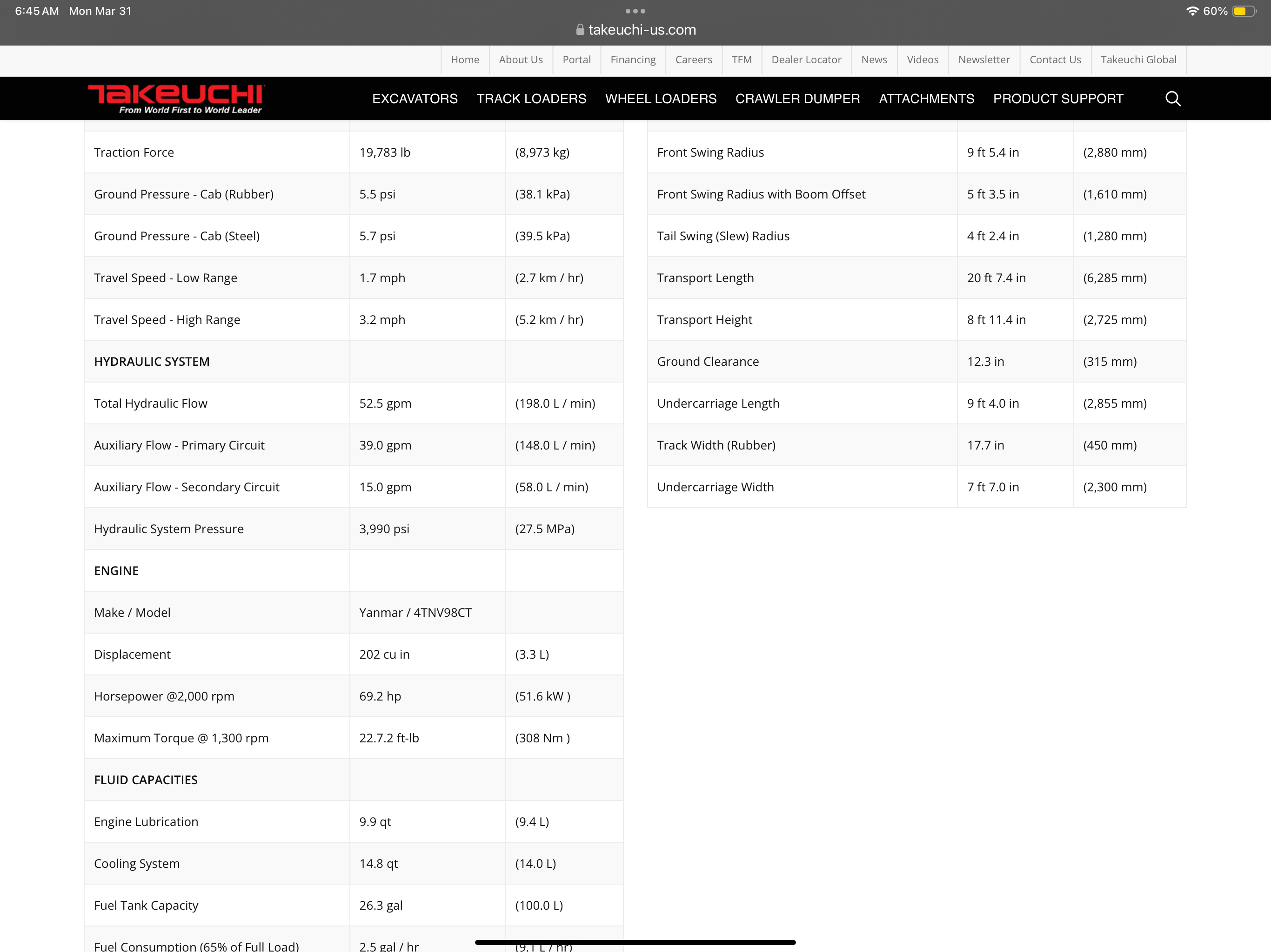

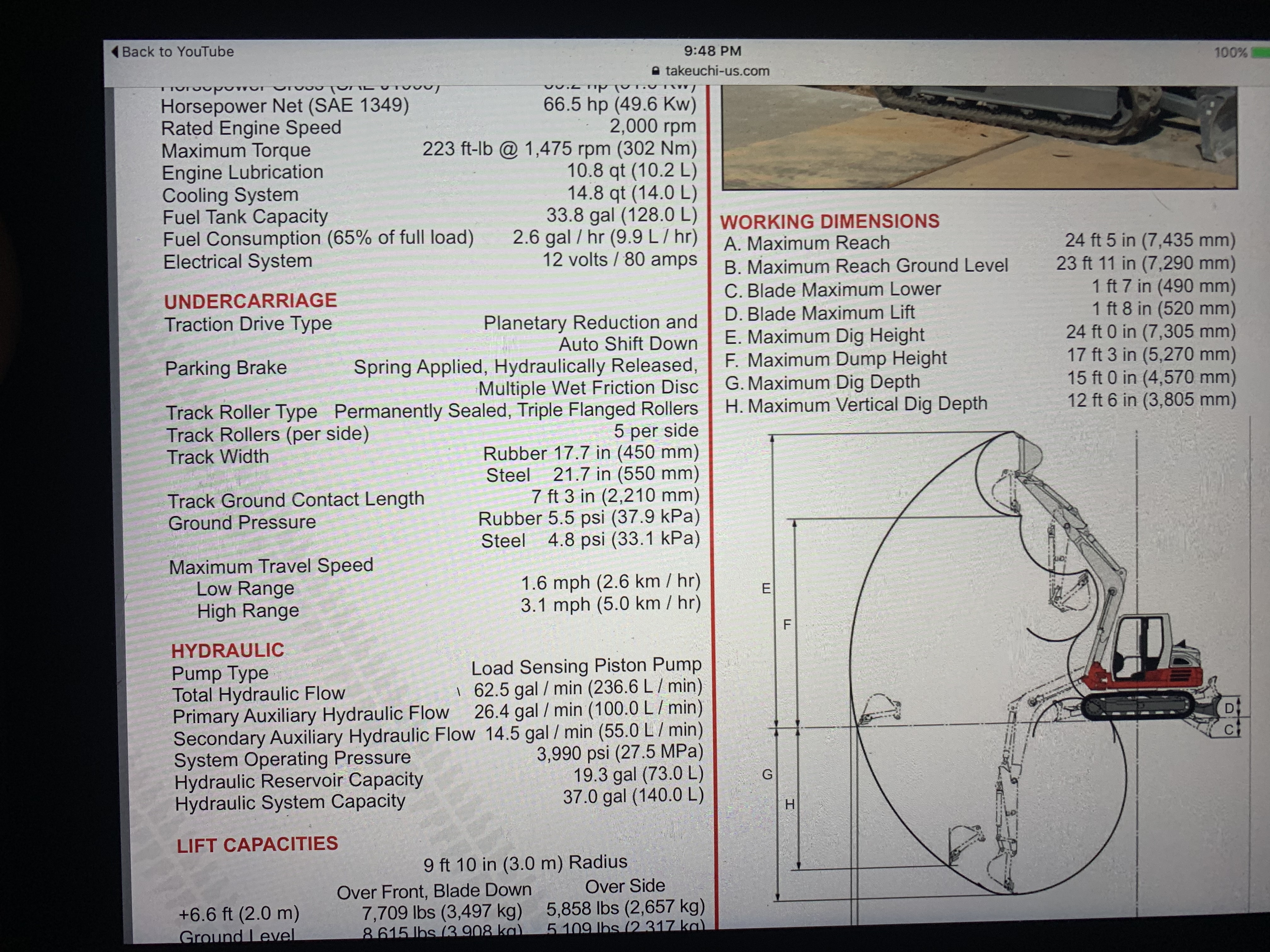

If that machine is a tb 285 or tb 290 your 15gpm is wrong for the primary auxiliary circuit flow. Specs for either of those machines is 26.4gpm/primary auxiliary flow and 14,5gpm/ for Secondary auxiliary flow.

Here’s what I found from the manufacturer. I thought the secondary circuit operated the mulcher head and the primary operated the rest of the machine
/ GPM required to run mini-ex mulcher? #10
You’ve got two sets of auxiliary hydraulics plumbed to your stick. Primary which is always the higher flow set will run any attachments with high flow requirements such as a drum mulcher. Secondary set will run lower flow requirement attachments like the thumb or a rotator.
That 39 gpm primary output spec in your spec sheet is wrong I’m quite certain. It’s very close to the total flow of both auxiliary’s.added together.
Pretty embarrassing that the actual manufacturer of the Takeuchi mini ex published incorrect specs for their own machine. 😣

Good news that the Takeuchi is 26 gpm, because I was going to say that 15 is too low. My Kubota KX080 is a similar size mache (8 metric tons, or 19,000 lbs actual) and has 26 gpm for the main aux. I would expect the two machines to be competitive in all ways. It all sounds the same as the Tak with two aux circuits, one for big stuff like a mulcher, and the other 99% of the time for the thumb.
Anyway, I run an FAE mulcher that is 1m wide and it works well. But I wouldn't want less power, and definitely not a third less power which is around where you would be at 16 gpm.
/ GPM required to run mini-ex mulcher? #13
Yeah, it a matter of understanding that they are talking about with the primary and secondary circuits, and nowhere is it explained well. The only clue is that they list total hydraulic flow as a much bigger number, hinting that the difference is what runs everything else.
I also see the Tak's operating pressure is 4000 psi, which is even better. So I would say it's a really good machine for mulching.
