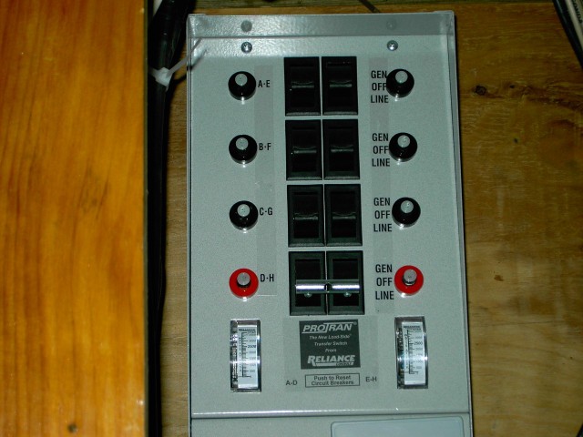

Could someone explain, in general terms, how a transfer switch works, IE how it can isolate the neutral leg from backfeeding and how it's wired in to the box to prevent this ?? Does it go inbetween the meter and the existing box ?? how does your house obtain a satisfactory ground if the leg back to the pole is disconnected?? Its already been stated that an "earth" only ground isn't reliable.............Isn't that all you'd have if you take the neutral out of the loop ?? Am I missing something ??? Thanks............Tom
/ got my pto-generator today. #77
The neutral does not get disconnected in these types of transfer switches. It is a solid connection. Some of them will go between your meter and your panel. Mine is setting beside my panel, or will when I get it in. I am only transferring 10 circuits, not the whole house.
/ got my pto-generator today. #78
If the neutral doesn't get disconnected...........What protects the linemen from the possible back feed of the 120 volt loop when it comes to the neutral buss bar?? I guess this is what I don't see as a difference between turning off the main breaker or using a "transfer switch ?? If you run a big enough pto gen to power your house, Do you have to rewire the whole existing panel of your house to a 2nd set of breakers in the transfer switch panel ?? (IE duplicate breakers for everything ) I just want a safe hook-up for my pto gen............I've lost power for several days before...........It would be nice to have a somewhat "normal" operation of the house rather than just a few basic circuits and extension cords running everywhere for extended periods..............I have the tractor capacity (HP) to run the whole deal so why not use a gen large enough to do everything ??
/ got my pto-generator today. #79
Even if the main is turned off, the neutral is still connected. Nothing wrong there. If you plan on running the whole house, you can install a transfer switch between the meter and panel, but they are expensive, since that now is going to be your "service disconnecting means" and must be listed as such.
/ got my pto-generator today. #80
What is the difference in the way the transfer swithch is wired in that it doesn't send the neutral back feed you would get by just plugging the gen into a 220 volt welder outlet by making up a double male cord from the gen to the outlet ?? You could go as far as putting a extra box in with a knife type switch and hard wiring a cord to the gen ...............I don't want to beat a dead horse here but how does it keep the neutral safe for the lineman if the transfer switch doesn't break the possible flow ?? What does the transfer switch really do that the main breaker switch doesn't for the linemans safety ?? I'll quit now.............Tom
