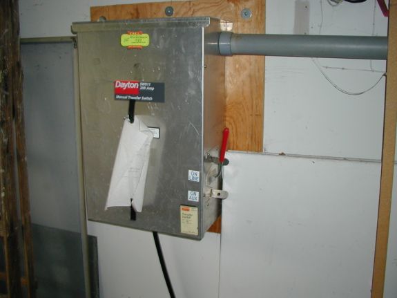

I had mine done professionally for about $900. It consists of a simple transfer switch. See attached photo and second photo in reply. It does not have the capability to select particular circuits. I wanted to retain the flexibility to determine what to power and what not to power during an emergency. For me that could change depending on the time of year and the nature of the emergency outage.
My tractor powered generator is capable of 10 KW peak and 9.5 KW sustained power output. I have a long input cable and plug connector attached to the transfer switch so I can run the tractor either inside the garage with the doors open in case of very bad weather or outside otherwise. All worked well during a checkout run in 1999, but I haven't had to use it in an actual emergency since then.

/ got my pto-generator today. #22
Plug connector on long cable.

I'm not an electrician but as it was explained to me you have to pull the meter or have a switch to physically uncouple the power feed coming into your home if you want to safely backfeed. A 200 amp rated disconnect switch is usually more expensive than a transfer setup.
The main switch/breaker in your service panel only breaks the hot (black wire(s)) and not neutral (white) wire. The neutral wire is not switched and I believe it is unsafe to install a switch on the neutral. When you are backfeeding you are returning flow of electricity back onto the grid via the neutral wire. Neutral is generally considered safe and won't bite hard but lots of strange things can happen to make it dangerous.
You can check most utility company web sites for more specific dangers of backfeeding. I have done it in the past and most of my neighbors still do it, without pulling the meter of disconnecting from the grid.
Best thing to do is buy a transfer switch/transfer panel and install it. I bought all the hardware and did the rough wiring. I paid a licensed electrian to come out for two hours in the evening and do the final hook up to my main panel, load balance the generator and make sure everything looked good and was a least up to code. He made $100 for his trouble and I feel a lot better about using the generator when the power goes out and even the wife can handle switching over to the generator if necessary.

I have a little info to add, not aimed specifically at anyone.
If you can afford a generator large enough to power your house, then you should be able to afford a transfer switch to do it safely.
Safety for you and the linemen working to restore power to you is worth a few dollars more.
Not properly grounding the generator and relying on the neutral to protect you is asking for trouble. If you have never run across a neutral wire that is energized with 120 volts or more, you haven't been working around electricity long enough. I have seen it all too often, even with the neutral grounded to the panel. One bad connection is all it takes.

Here's a pic of the switch I installed.
