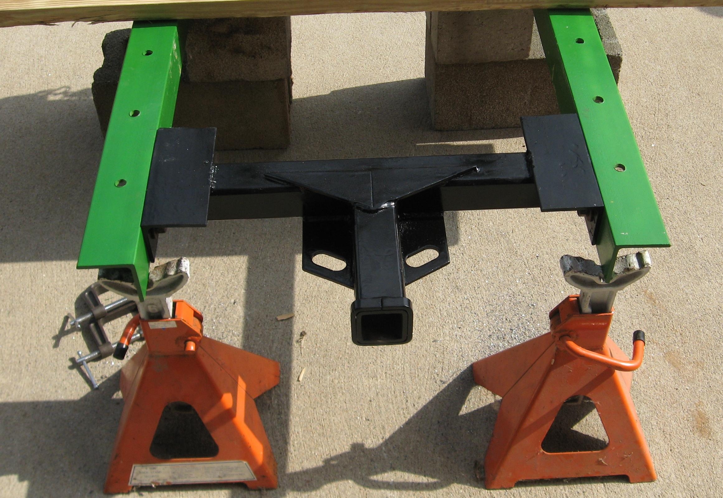

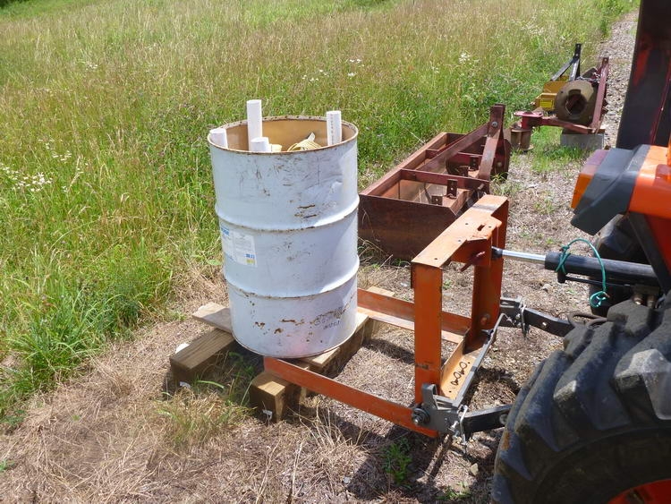

I finished a big project (installed a new septic tank)and as rewards, I got my wife a new frig and got a Carry All. I hope to take measurements off of it soon so I can pick up some steel to reinforce it.

I would be interested to see what reinforcing you do to it.
I added a receiver hitch to mine and use it all the time.

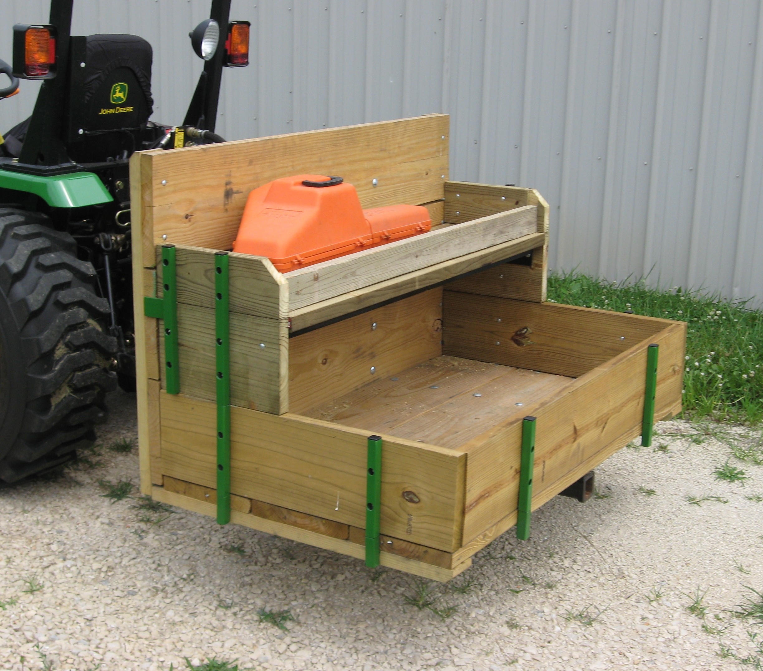

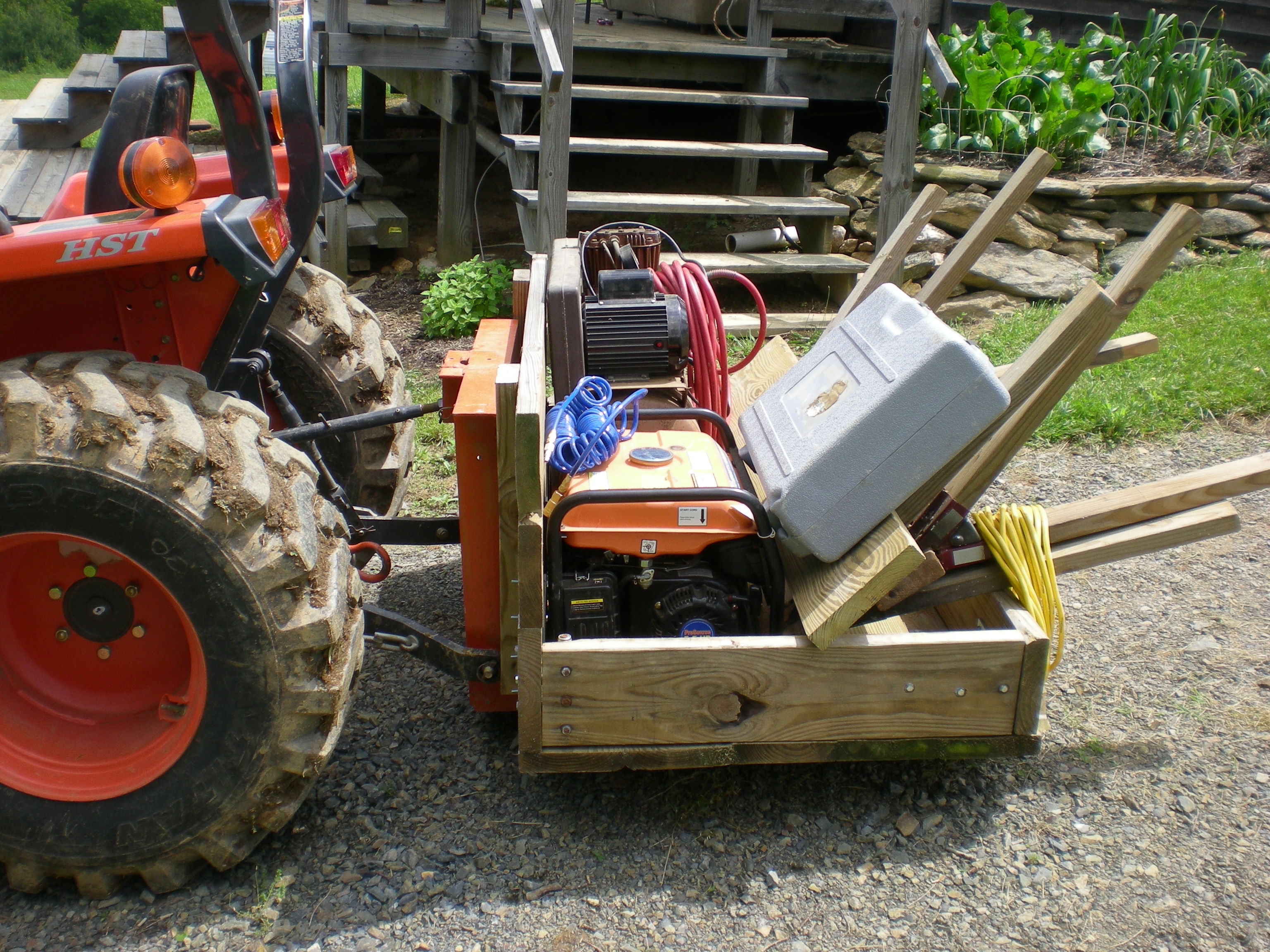

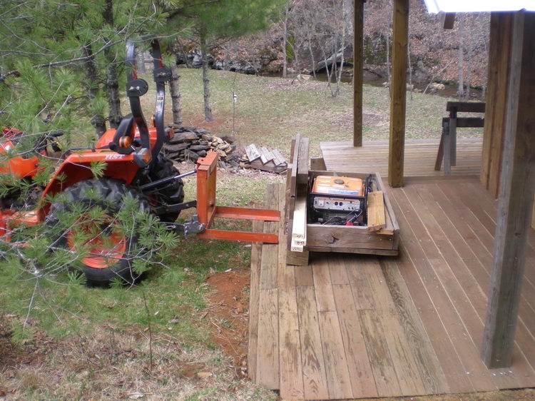

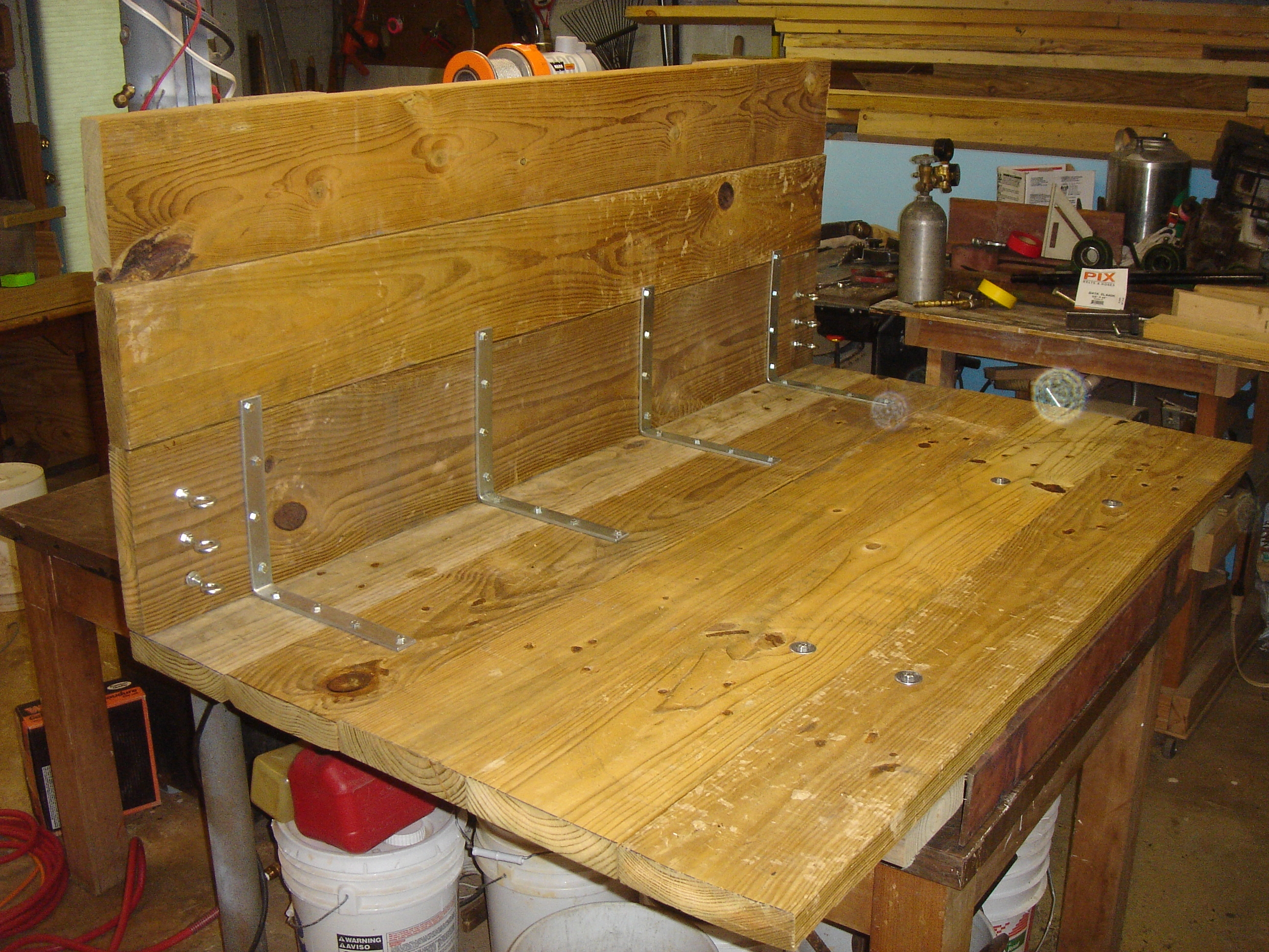

That looks like it puts a lot of force on the welds at the joints between the uprights and the lower arms. Here's what mine looks like:

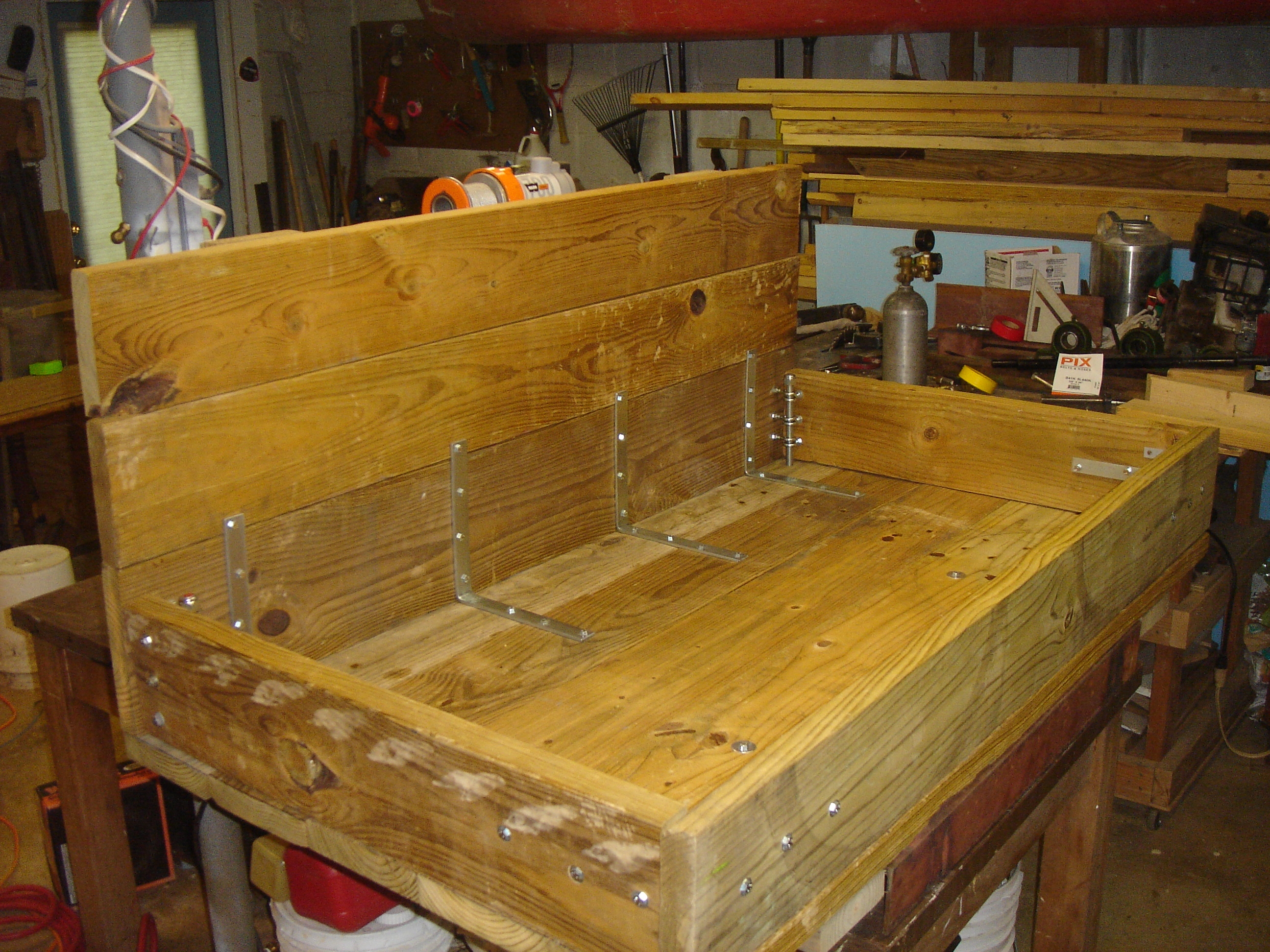

I found this simple deck has worked well for me.
Yes, she does sag a little when heavily loaded. That bracing would definitely help.

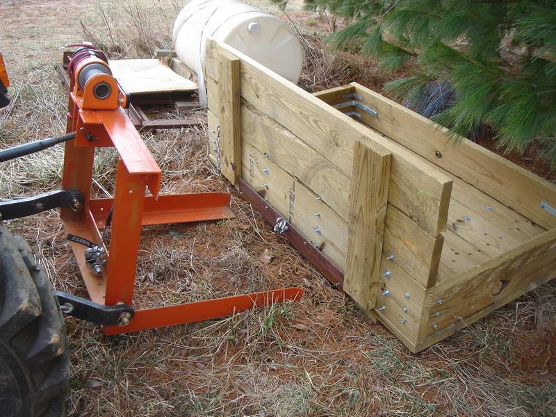

I built mine a little different, When the wood base is loaded, I can drop the deck off and still have my tractor free to use... (4th photo the base sank into the pine needles).
My frame was also used for counter weight... 55 gallon drum sides right in, used a strap to hold it. It also serves as the base of my 15 gallon sprayer... which is modular (boom, water tank and the pto pump connects together on the frame).

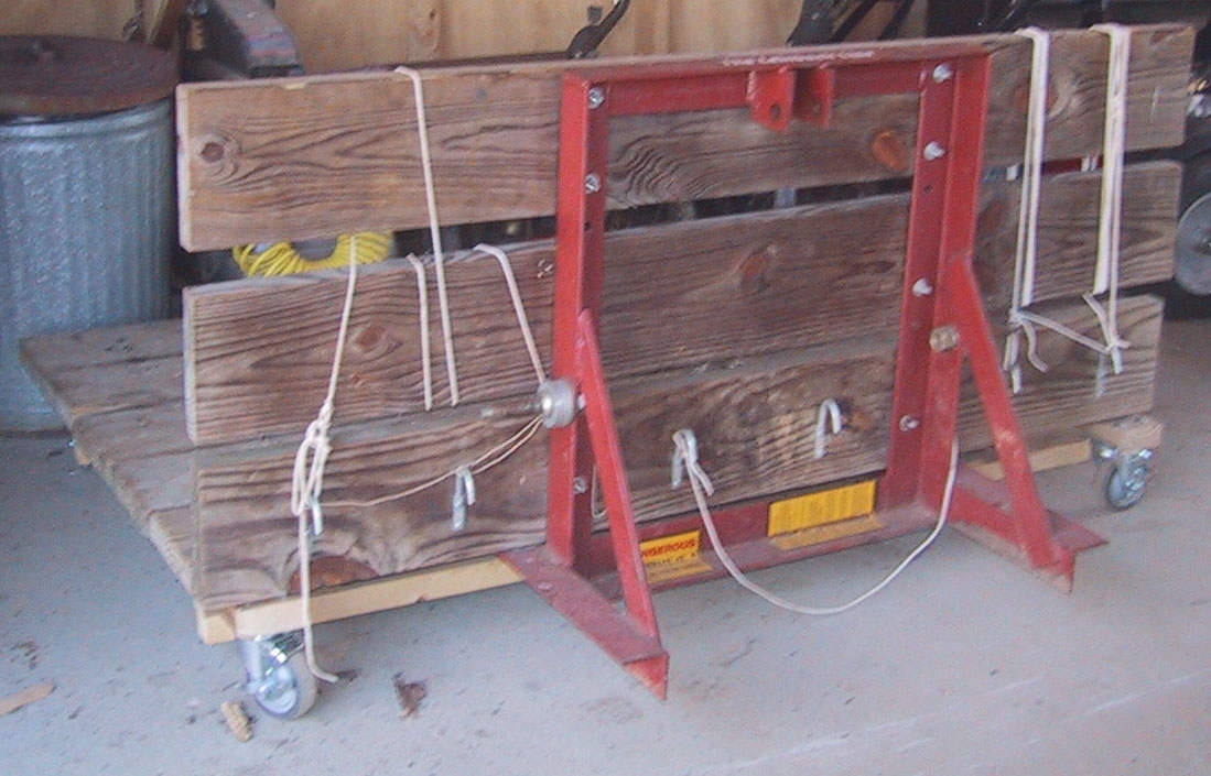

I have one too. I glued a short stack of heavy plywood to make the platform, left the back open, and bolted chains to the upright with multiple grab hooks on each chain, to secure objects on the platform.

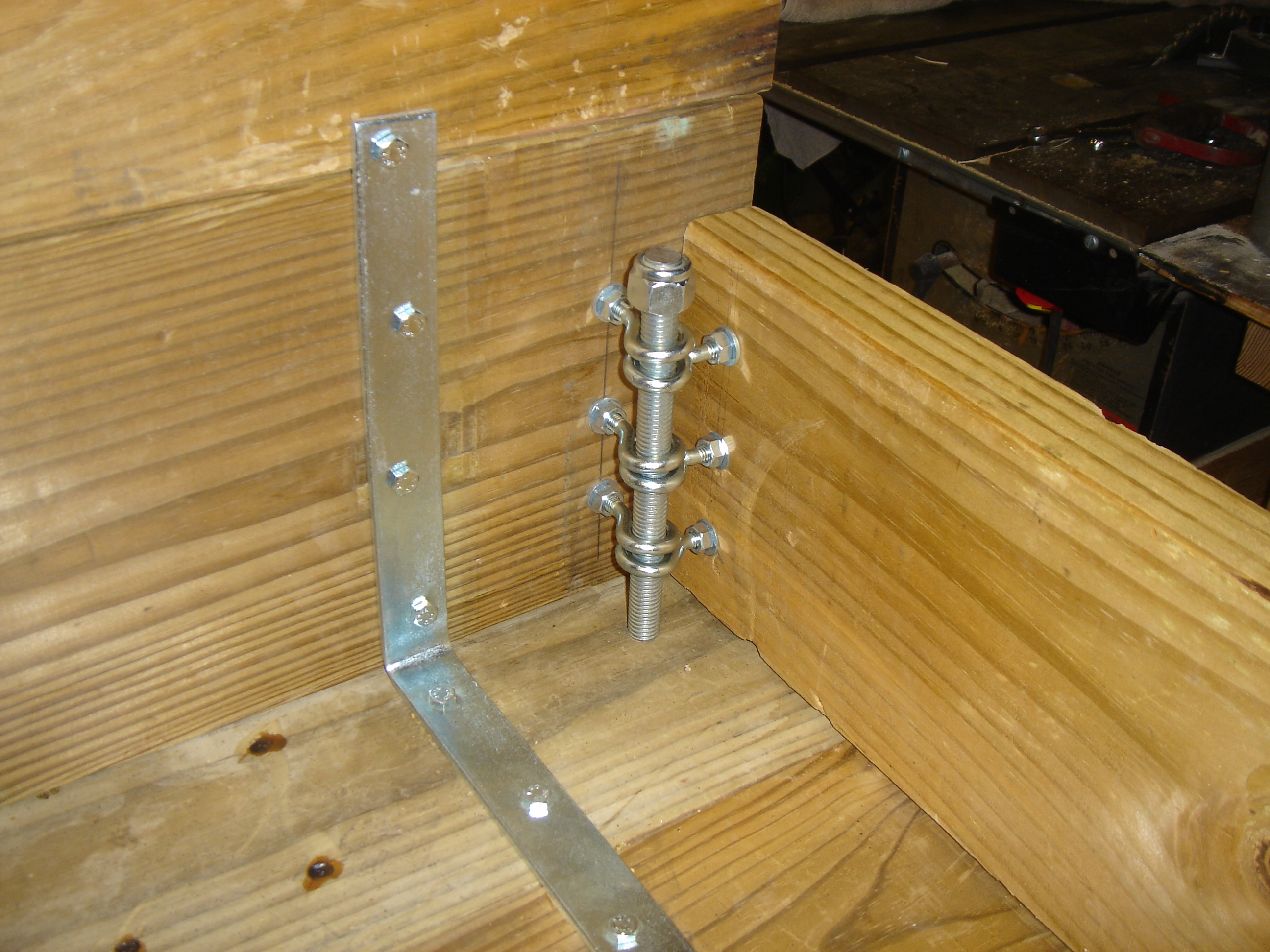

I beefed up the pins on mine after bending the up rights in the pin area going thru a hole to fast. This is what I did but I like Terry's design better - see post #4 above.
Made a gusset bracket.
Drilled thru the base so the pin passed thru double thickness and welded it to the uprights
I have removable stakes on it.
