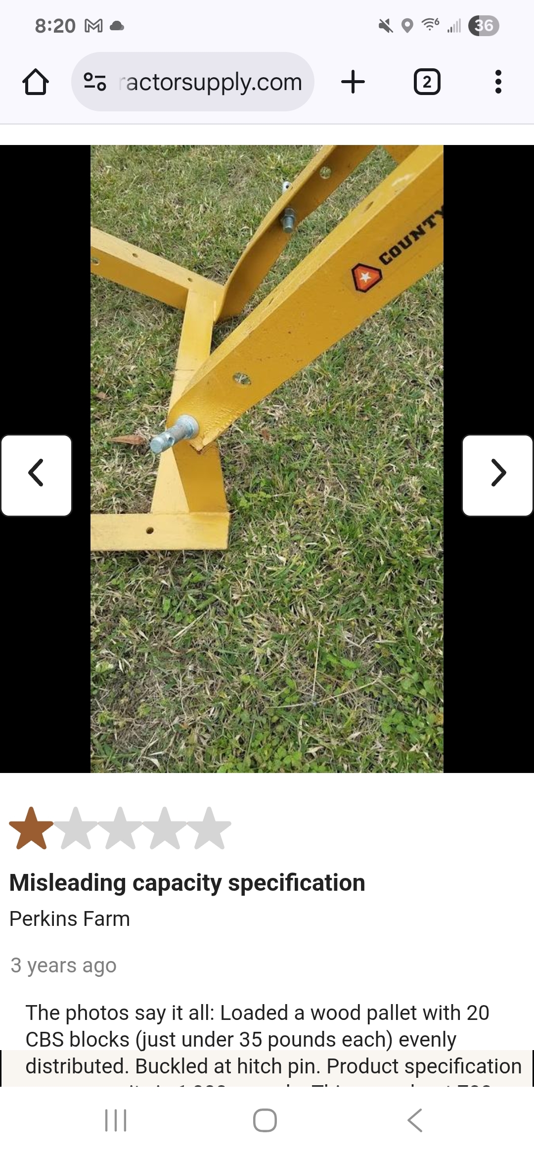

Well, If you are using this carry all on your sub-compact Mahindra 25, the front of the tractor will come off the ground before you over load any part of that carry all.
I've got that same carry all (same color any ways) and when it's fitted to my Kubota B7200, the tractor is a real wheelie machine. At least the steering could be termed "light".

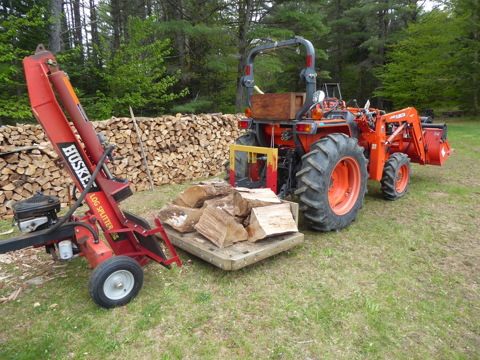

I used 1 inch white cedar decking for bottom and front wall, with only a 6 inch "curb" for side walls as I often carry brush and limbs.
Fitted to the B2601 or the Hurlimann with a filled FEL bucket as ballast, Even a heaped up load of crusher run stone hasn't resulted in any bent parts.
I'm thinking of buying another one just like it!
eta
If you want to counter that buckle at the lift pins failure mode, two 1/2 meter lengths of 6 mm thickness "strapping" welded and match drilled would give a lot of added "strength". No need to go all the way to the top of the vertical members.

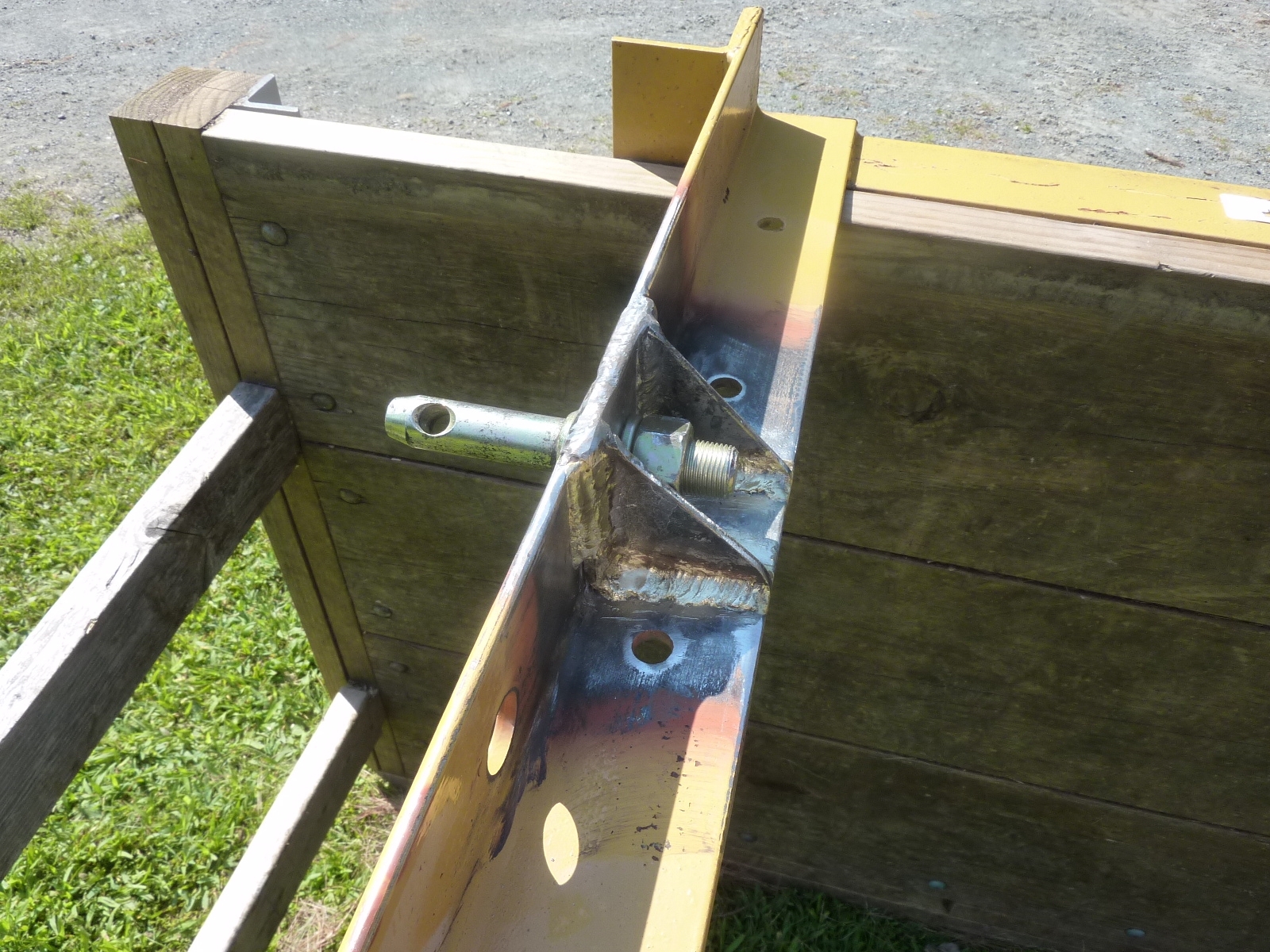

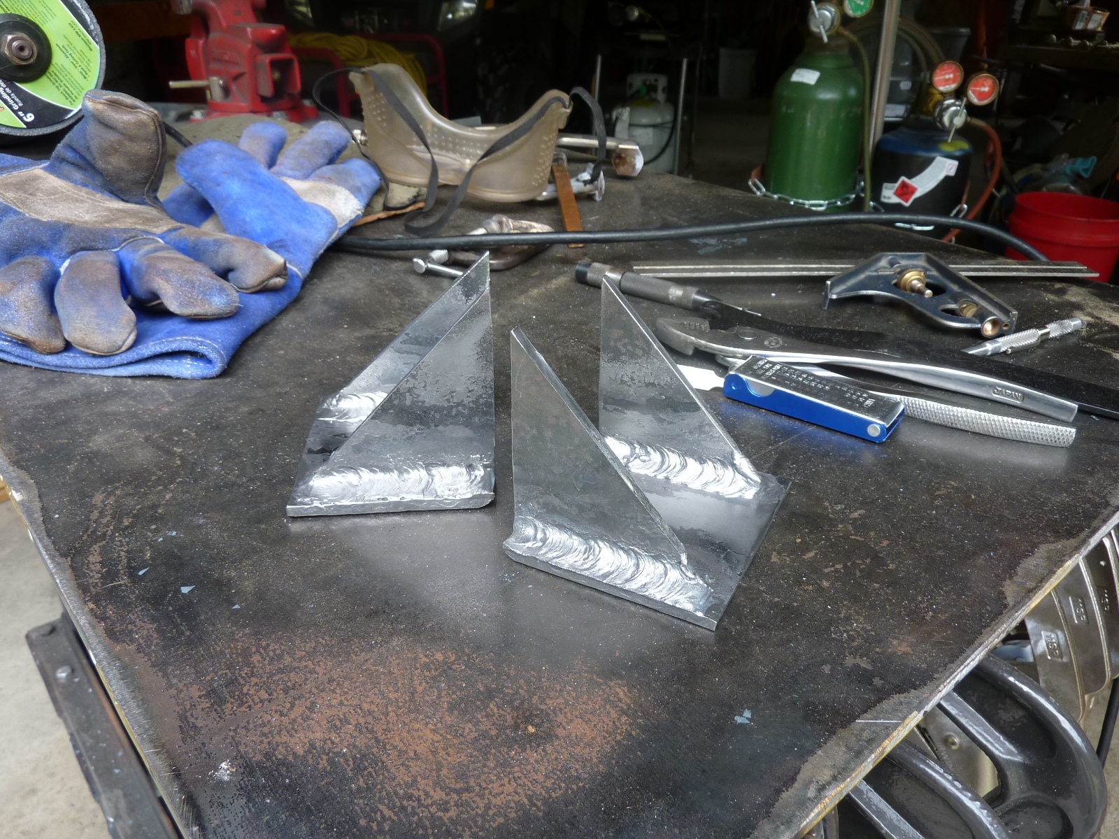

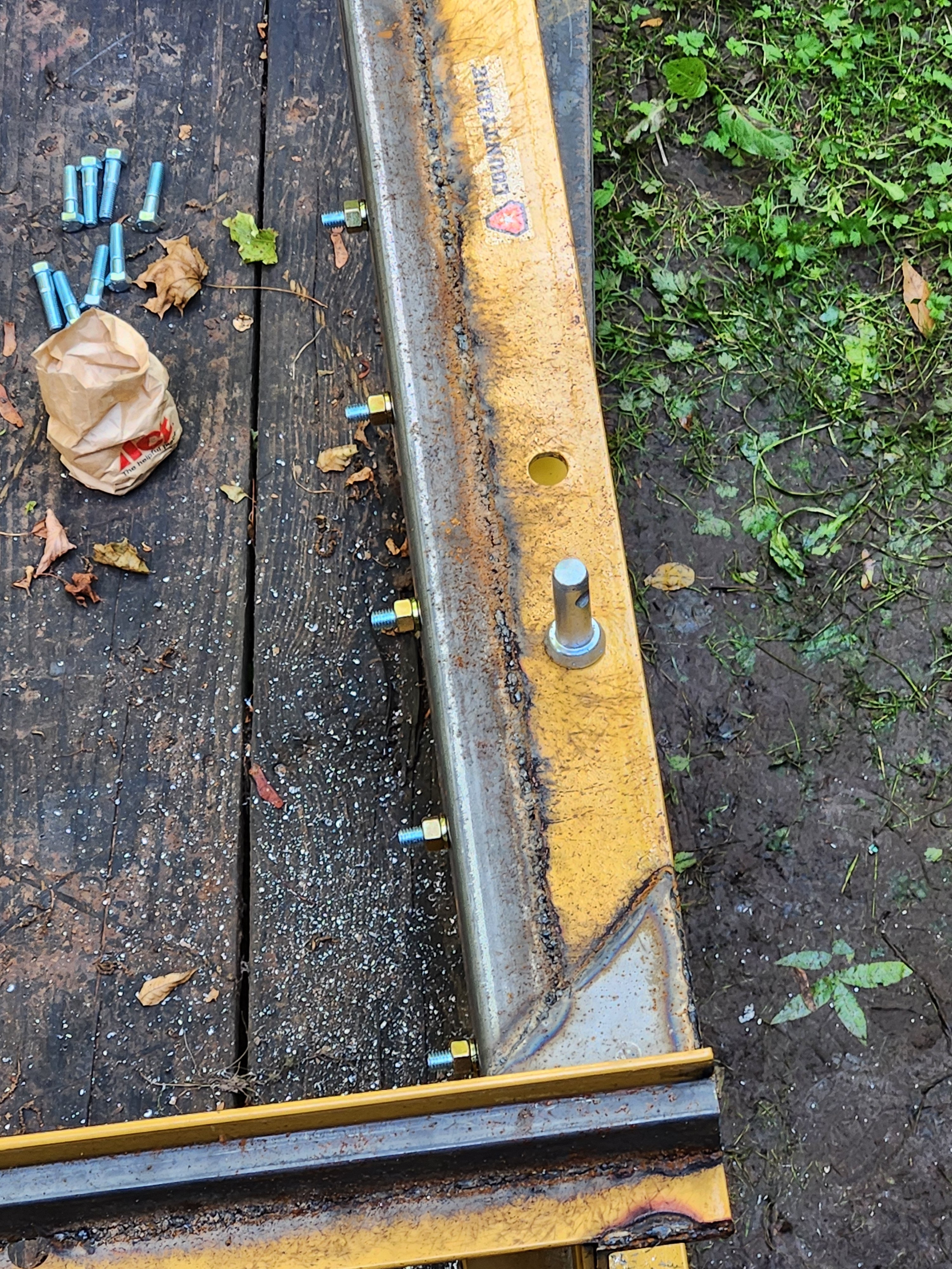

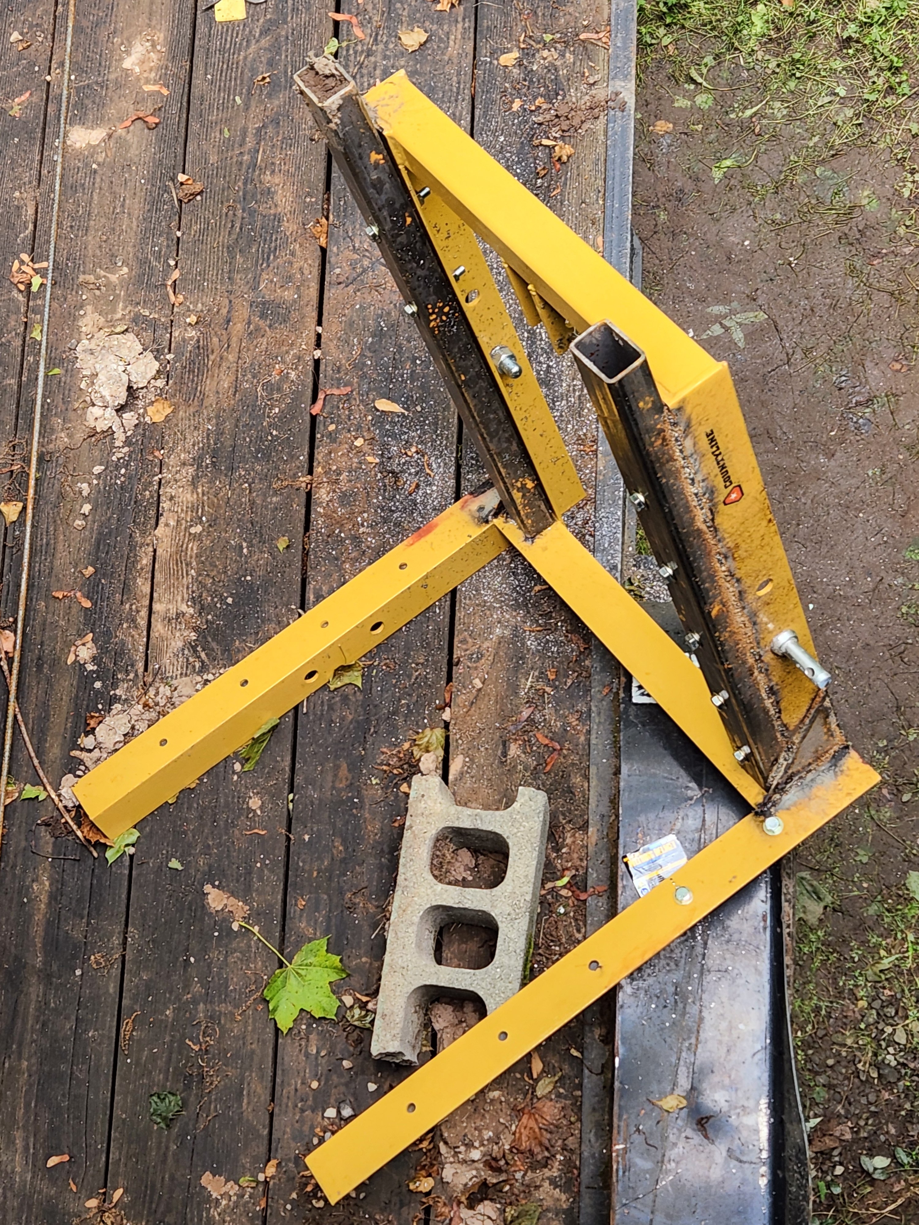

Warning: I'm not a professional welder. No production welding shop (or any welding shop) is going to hire me.
Started welding today. Second time in a long time. Flux core wire welding outside. Had the Lincoln 135 turned up all the way with the wire speed slow.
It's hot/humid outside and the sweat was dripping off of me. More work to do on this side but taking a break for now. I will definitely drill and bolt the mild steel with grade 8 bolts. I figure before I'm done it should be stronger than the back end of the tractor. Bolting it will give me peace of mind against my questionable welds.
Not to knock your welding, by any means, as I'm not the best welder in the world...
But there's really no need to make the long welds the entire length. Just 3-4 3 inch long welds that are strong enough to burn the brace material and frame together in a slower, beefier weld. Watch the metal as you are welding, you can see the metal blending, and put plenty of rod in with it.
I do structural repair work on my stuff, like this rotary cutter back axle that broke last summer. Added very thick angle iron after the repair weld, and braced it up. Stronger than new.
These welds are burnt deep, and have lots of metal in them. You just have to judge the thickness of you metal to weld, the rod, and amps on your machine.
You'll get better at it if you use it enough.
Your welds are better than mine by a long shot. Watch the Utube comments on just about any welding welding site and you'll get guys being super critical (sometimes rightfully so and sometimes not so much) of welds.
I am getting better, even in the short time I spent on this project.
   / Got my Carry All today. #26
A secret to welding?.... Watch the puddle!
You are right, Those welds suck! ;-)
Grade 8 is a waste. Grade 5 (three strikes) are far too good, even if only 1/4 inch.

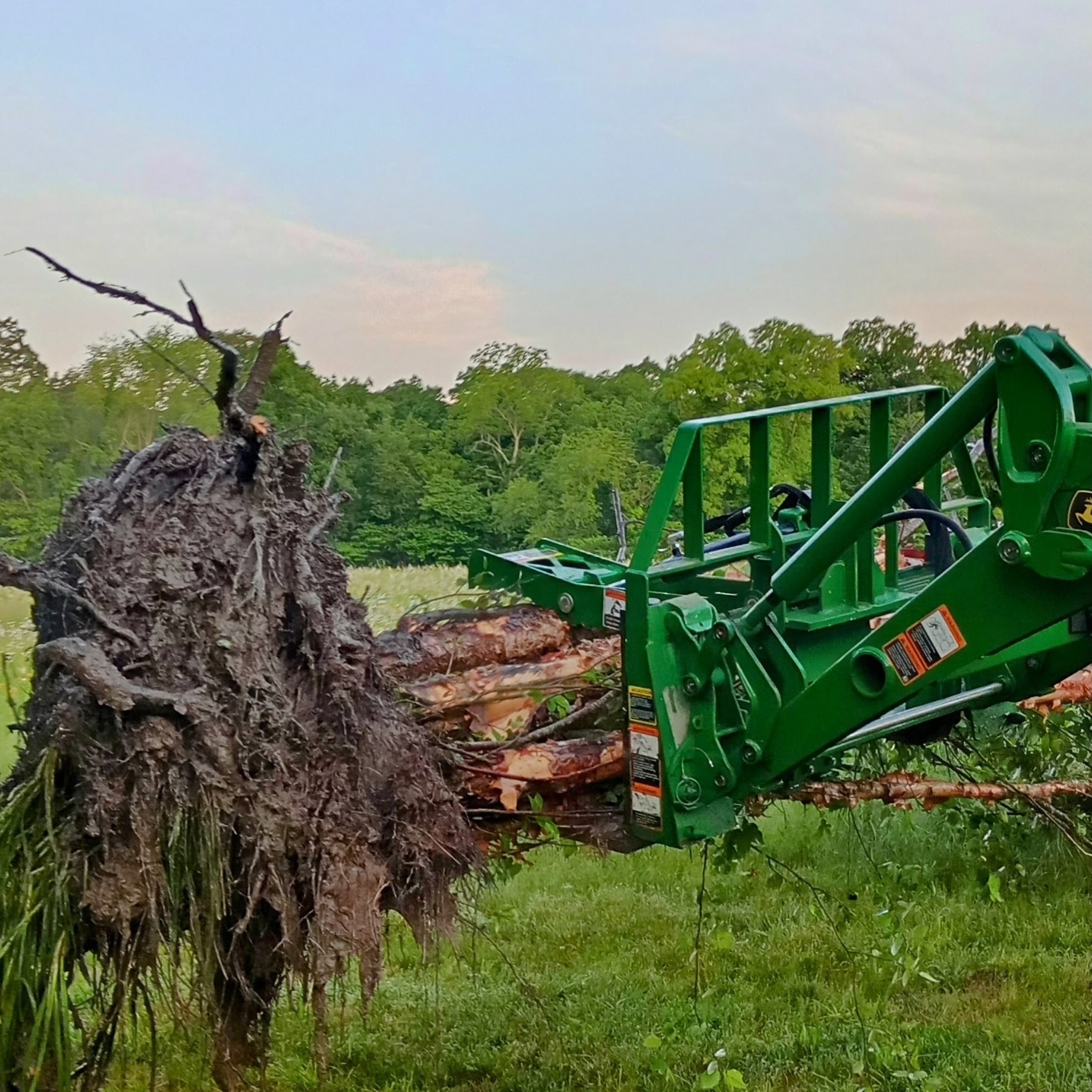

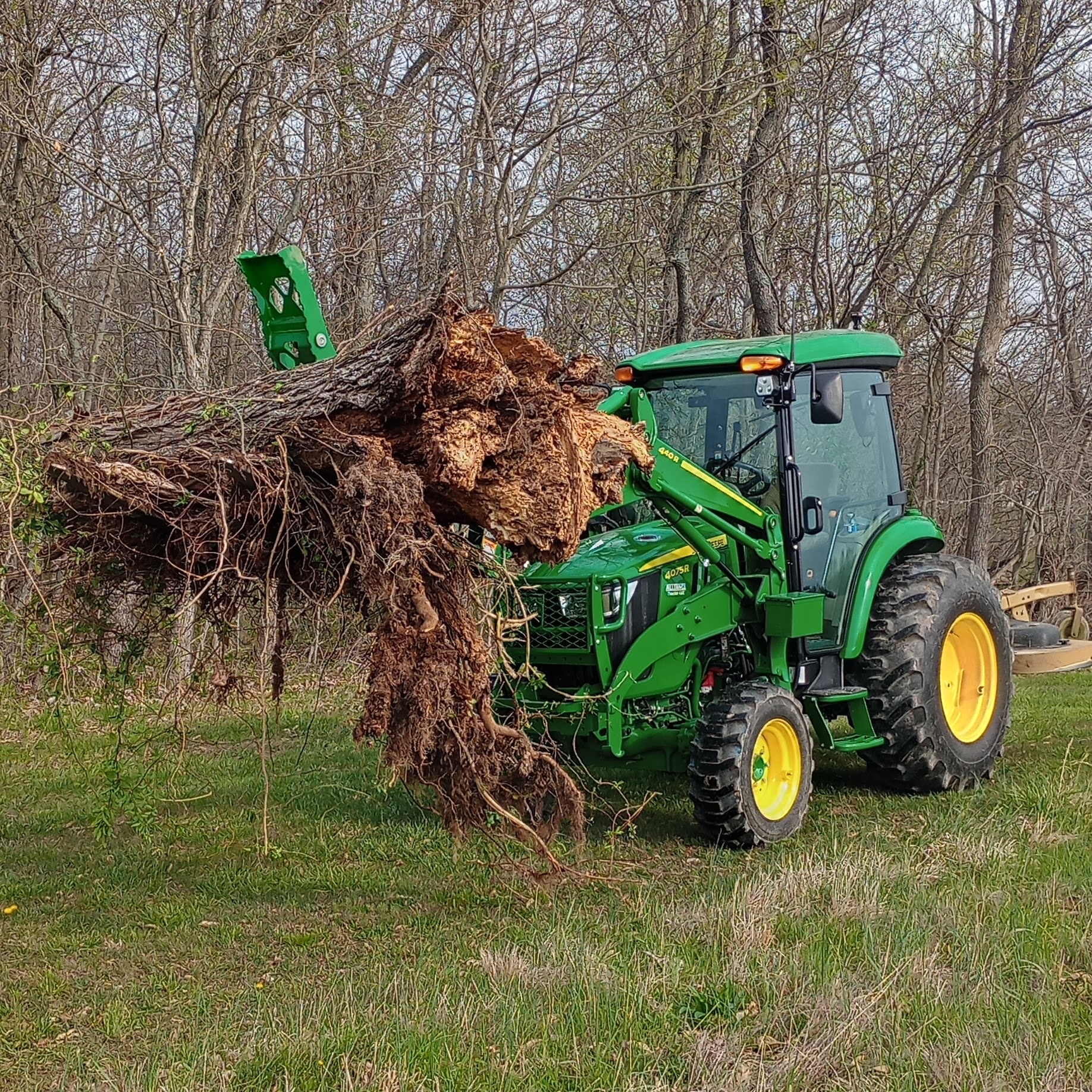

Pallet forks are one of my most used attachments. Add the frontier pallet fork grapple for the complete package. I fabricated mine to also be used on the draft arms for heavy loads, would not be without them

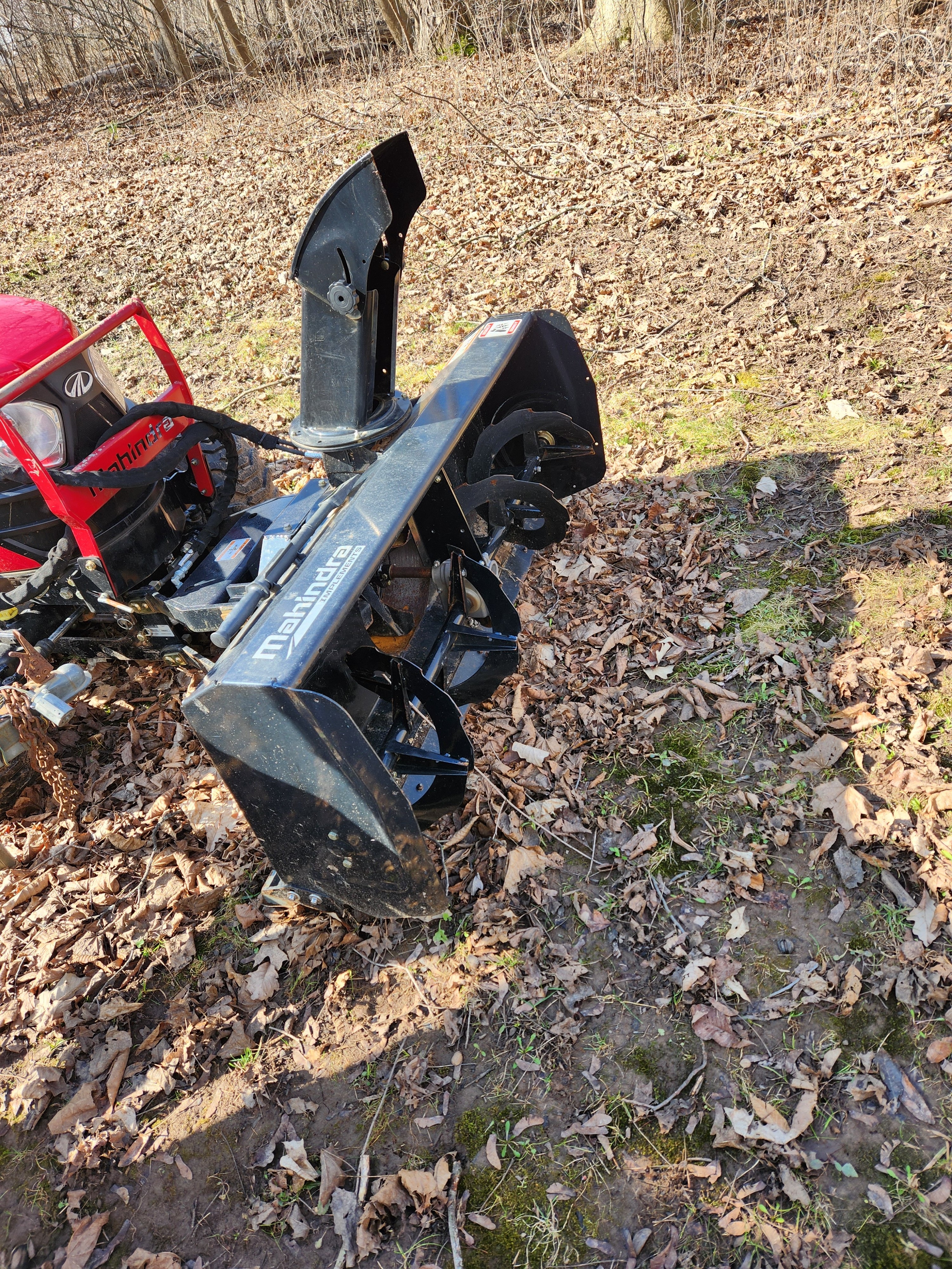

I might use that idea of a tote later on. I definitely want my forks on my carry all to be able to carry different items. I picked up four pallets (for free) and saw a good use for them on a utube channel. I also got two 55 gallon steel drums (10 bucks a piece) to carry water with for the main purpose of filling my plastic septic tank back up when it gets pumped. I know first hand that those plastic tanks will rise, when empty, with a heavy rain. I'm taking no chances. I drained my well filling up a very recent tank install. Had to use my truck, the steel drums, a cheap pump, an inverter/generator to get water from a lake to finish filling the tank back up. I can always use the 55 gallon drums as burning barrels as they age and either get new barrels or use your tote idea.
I also live at the end of a 1/2 mile single lane dirt road that is not maintained by the state of NY. Add to that a 200 foot driveway in Central NY where we get snow, ice etc. I burn coal as much as I can and will use garbage cans to reuse the burnt coal for traction. Burnt anthracite (fancy name for coal) is excellent for traction as it is sharp and about the size of a pea. I'll spread the Burnt coal on the areas of the road that need it. I've got a snow blower attachment for the front of my tractor (runs off my mid pto) in the winter combined with 4 wheel drive and chains on the rear tires so I should be good to go. Extra weight on the rear tires could help.
#39
Pic of my snow blower attachment in reference to previous post. One pass up the road and a pass back to the house and the road is clear.

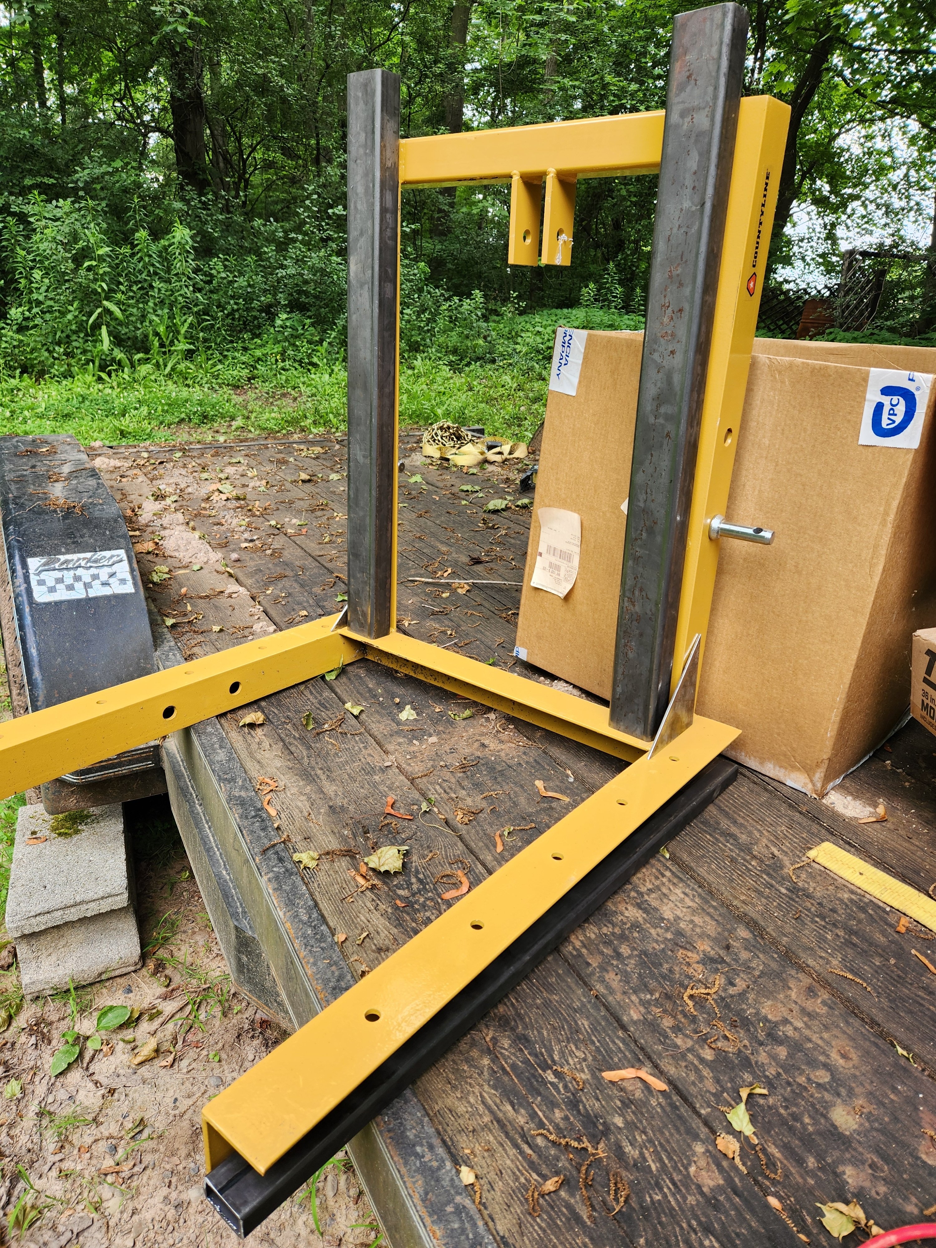

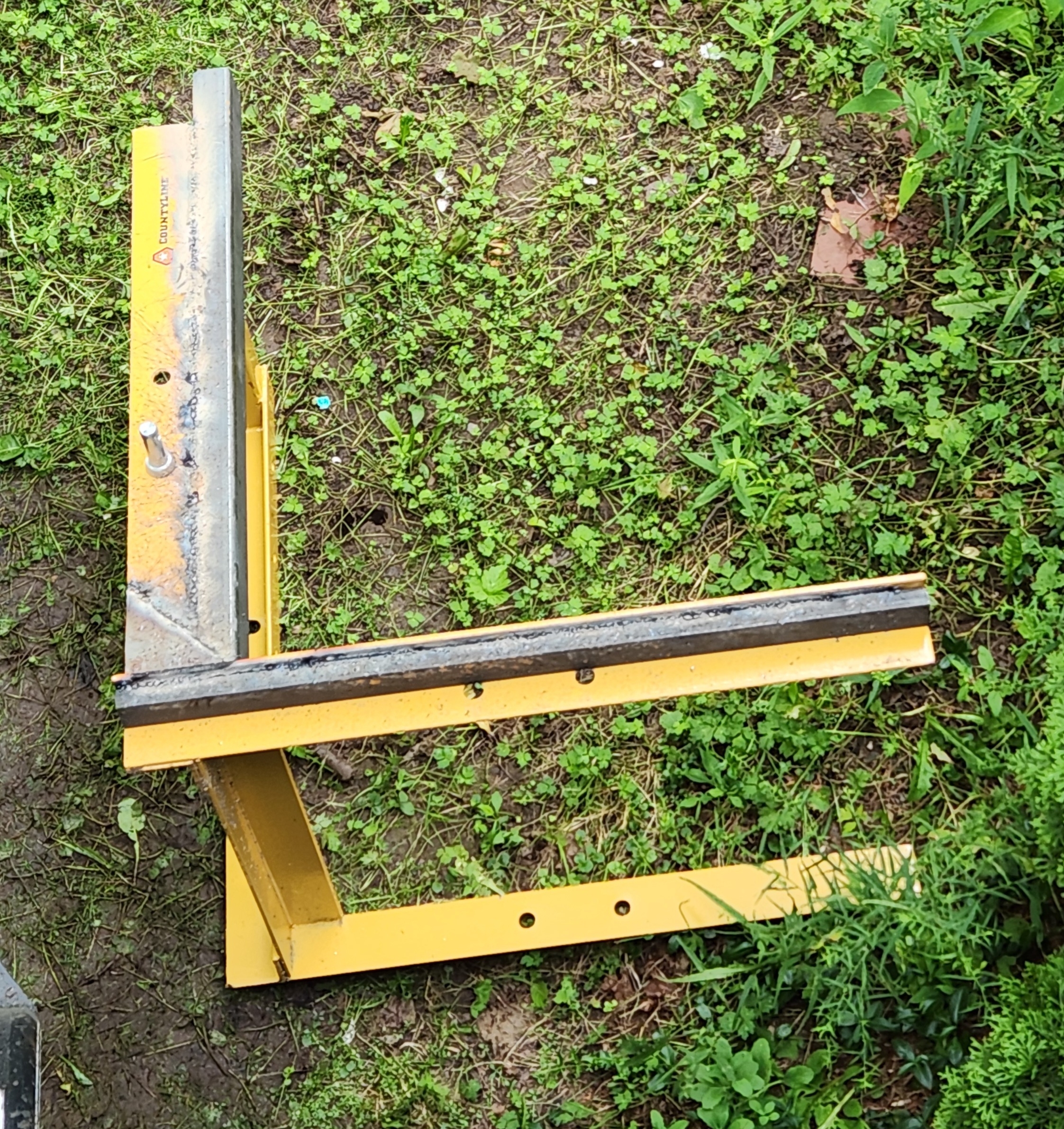

Also, not to beat a dead horse, but if I could run a cable from blue dot to blue dot connected with a turn buckle, that would really add strength. Probably increase the capacity way beyond my tractor's capability.
