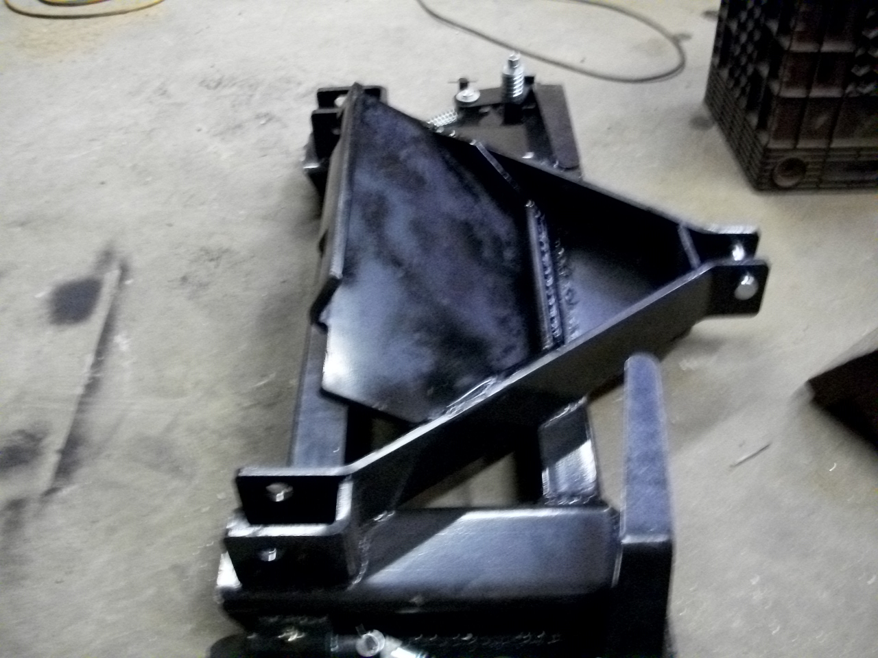

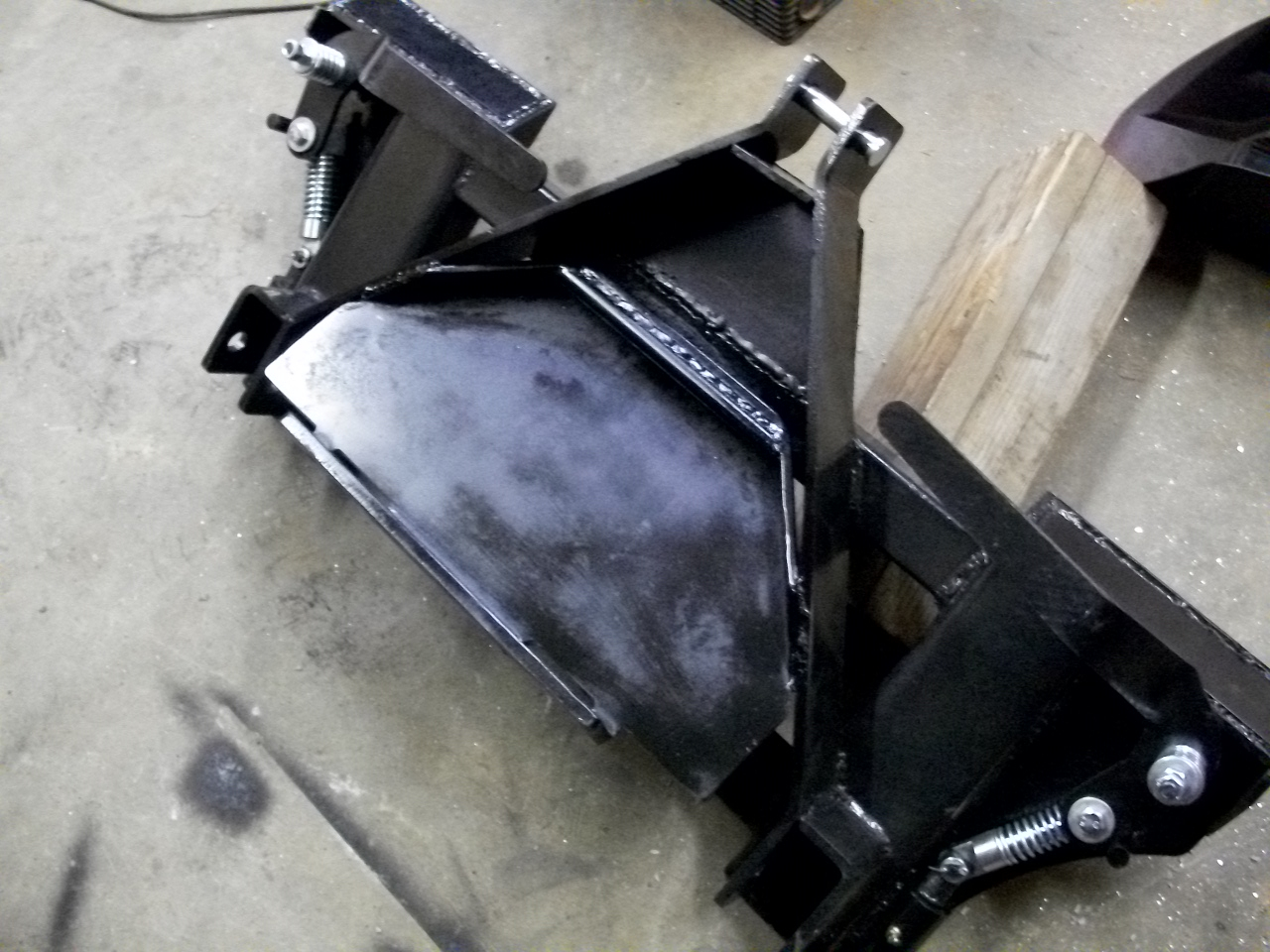

I ended up buying a 3pt hitch to SSQA and welded in the PT adpt plate. My hyd hoses got chaffed on the top A portion, so I cut that off.
The adapter is the best think you can have as it opens the world up to you for all skid steer attachments, not just forks.
I would recommend getting a good set of forks. How good? Not sure how to answer that, but a good fork has the weight stamped into the side. I believe fork capacity is rated at the mid point of the fork, not lifting at the tip. So take that into consideration especially if you might get fork extensions in the future to handle light bulky stuff.

That’s far superior to my original idea, lol. Like how the weight sits on the adapter plate as opposed to some welds on a fork frame. Obviously like the idea of being able to utilize other ssqa attachments as well.
I’d love to utilize the same idea with another PT weld on plate and 3 point implements. Any recommendations on adapters to what best may make that work as well? Would welding a plate to a 3pt quick hitch be my best bet?
