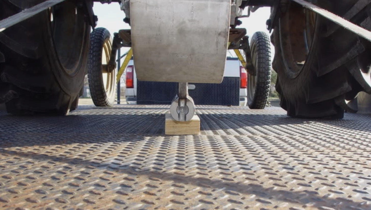

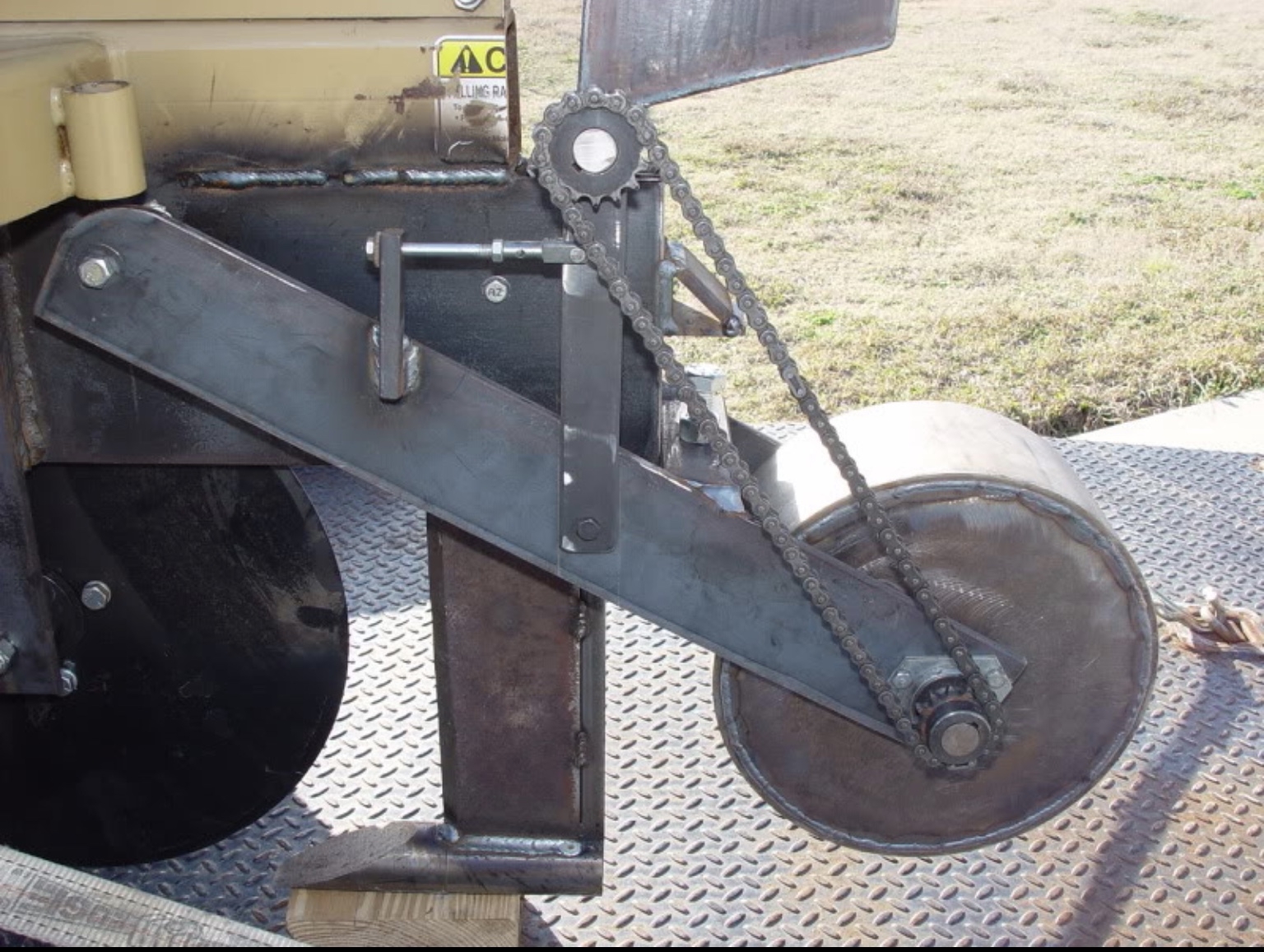

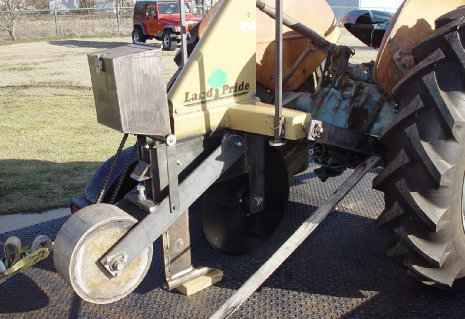

I am not sure on the size of the coulter now I would have to measure it but somewhere between 18-24" I would guess.
You can't see the lower 3/4" bolt in the plow, it is covered by the swing arm, but if the little top bolt shears it pivots on the bottom bolt until it hits a stop between the plates (before crashing the rear tube).

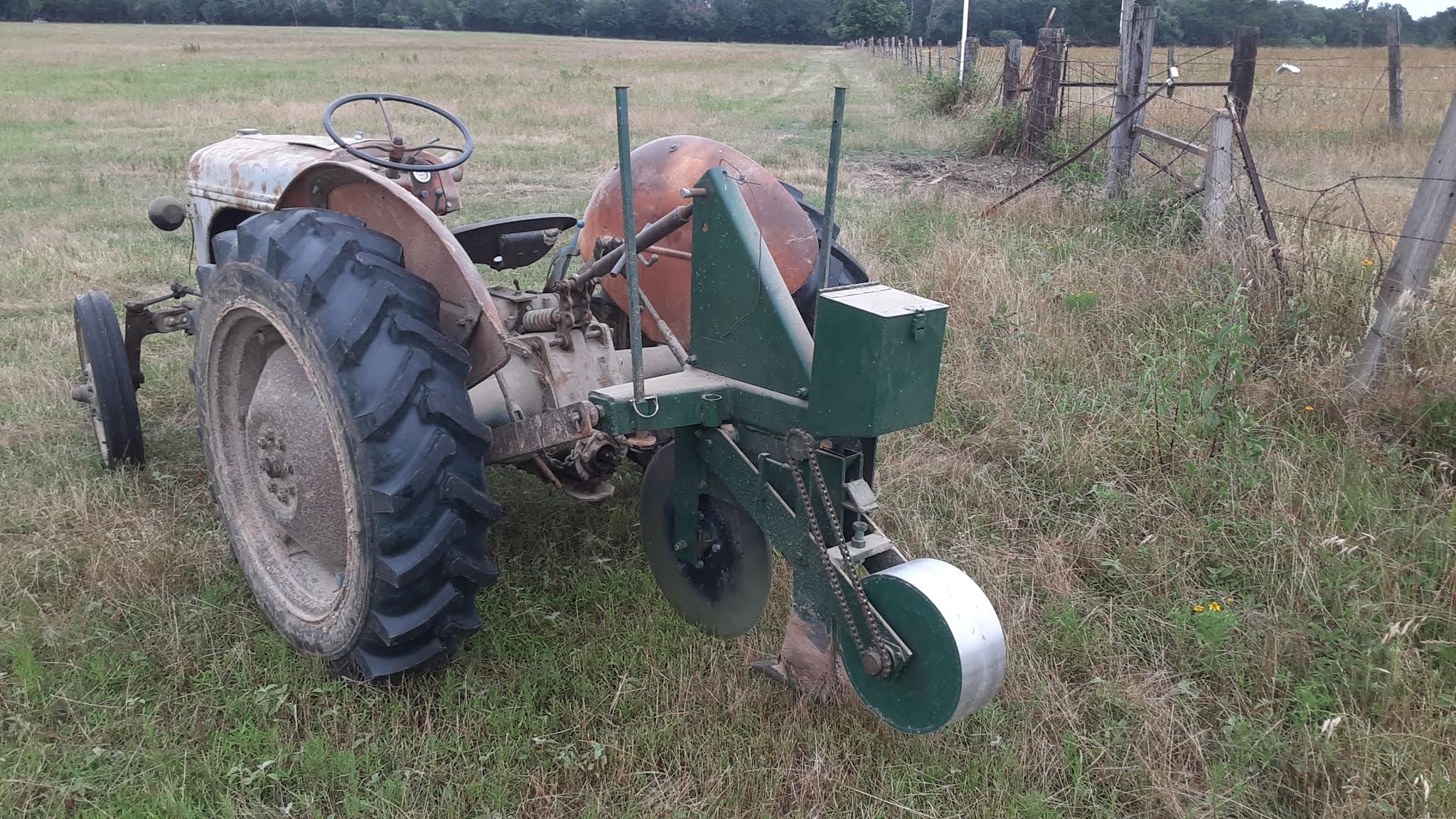

Had it out again the other day, the sand has done a little smoothing over the last decade.
Stainless on the drive wheel seems to have worked out too.
No sheared bolts but a ‘48 8N isn’t a power house either. If you operate one of these and do snag something, when you back up, you must clear the drop tube. Note: that piece of bailing wire in the hole right above the top link, on the 3 pt. If you don’t, dirt can pack the hole the seeds are suppose to drop through, into the tunnel.
