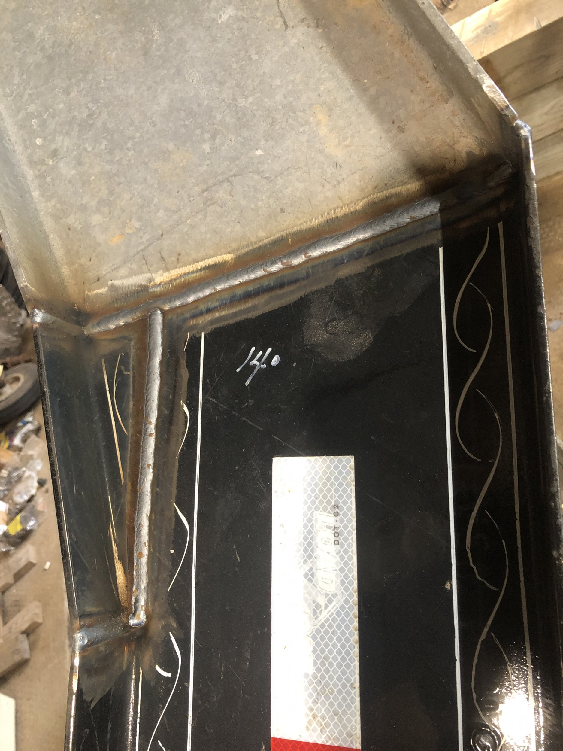

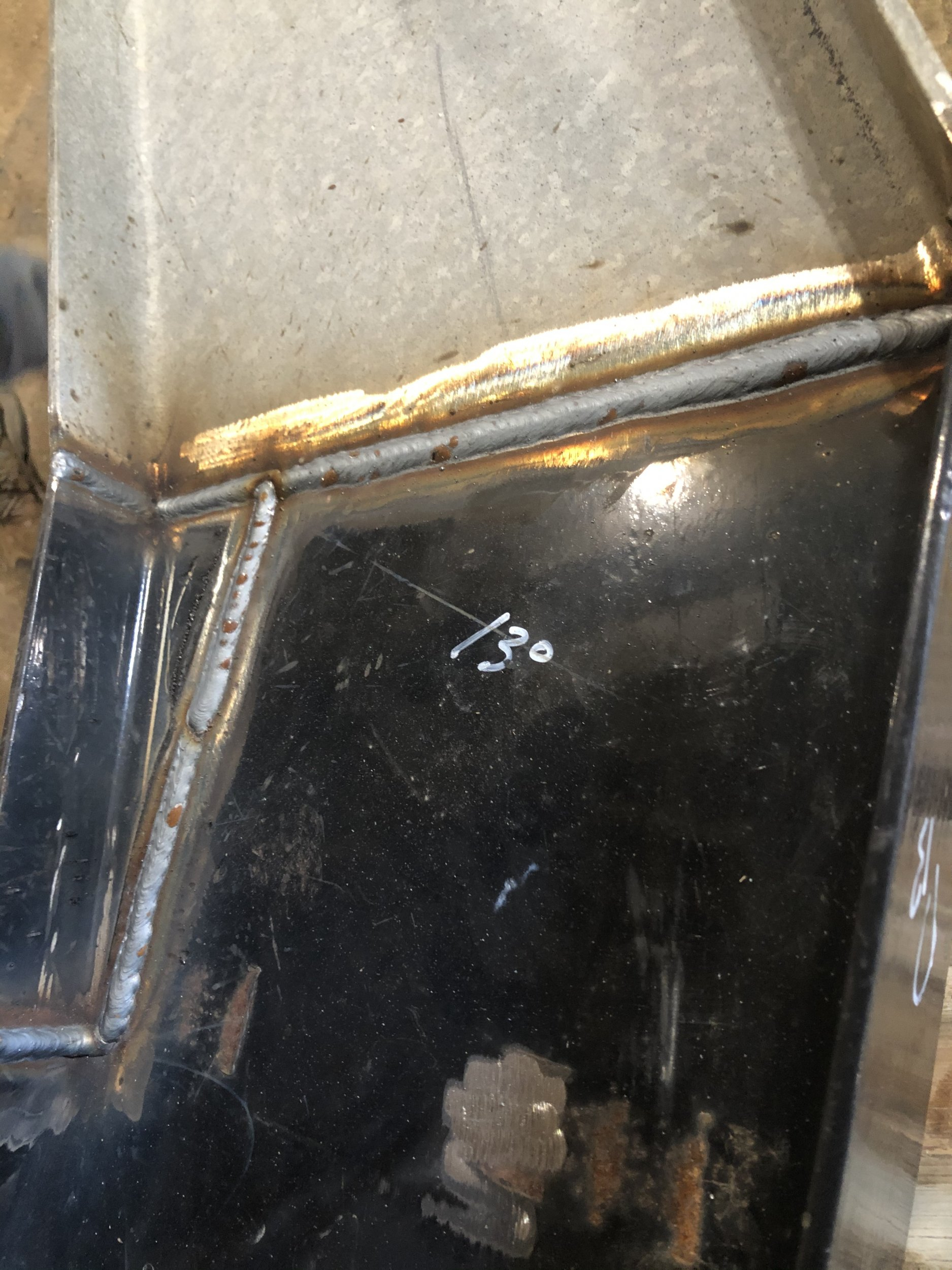

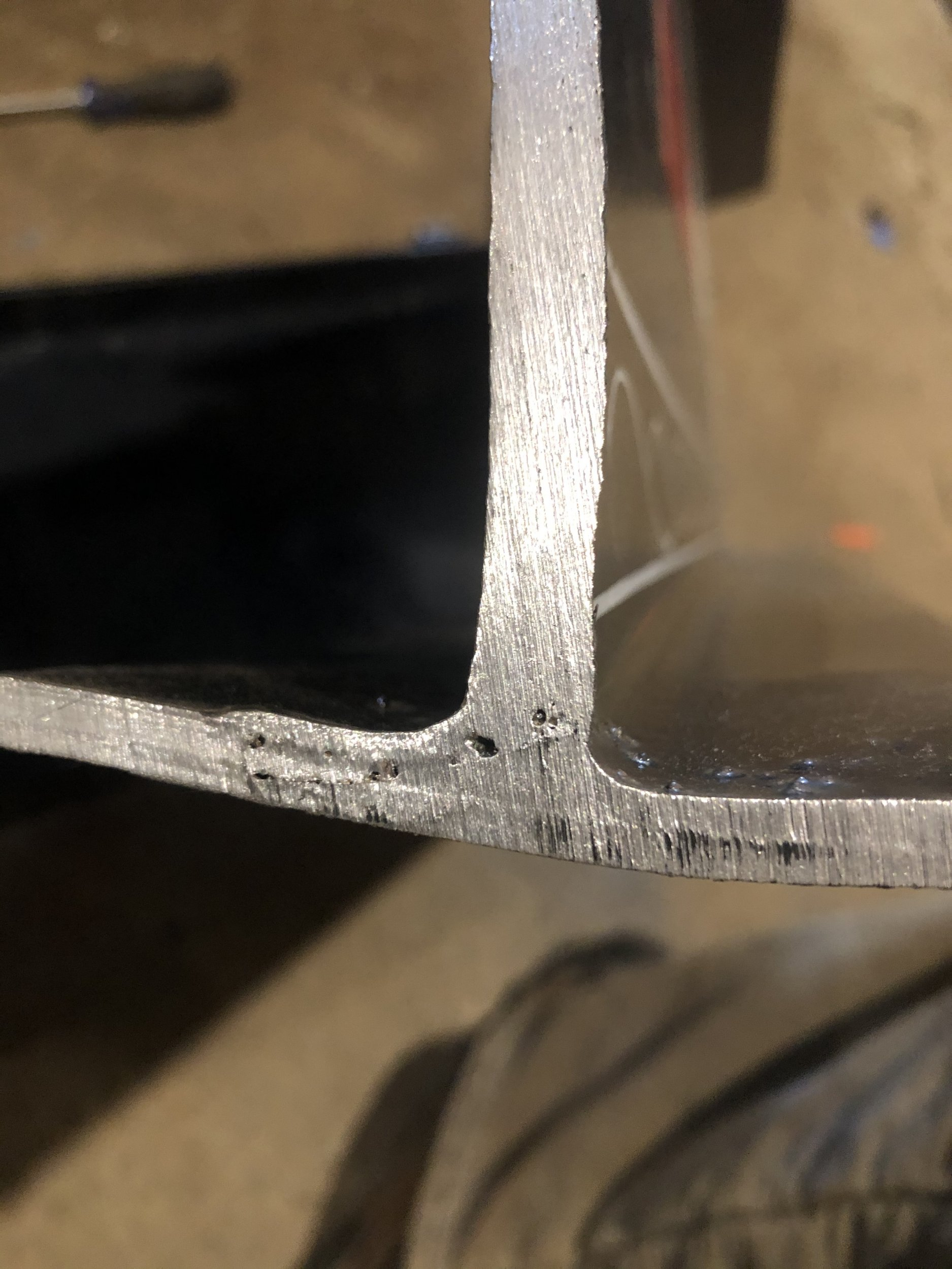

Put the existing head in the band saw so I could cut through the weld. Found some nice pockets of porosity.

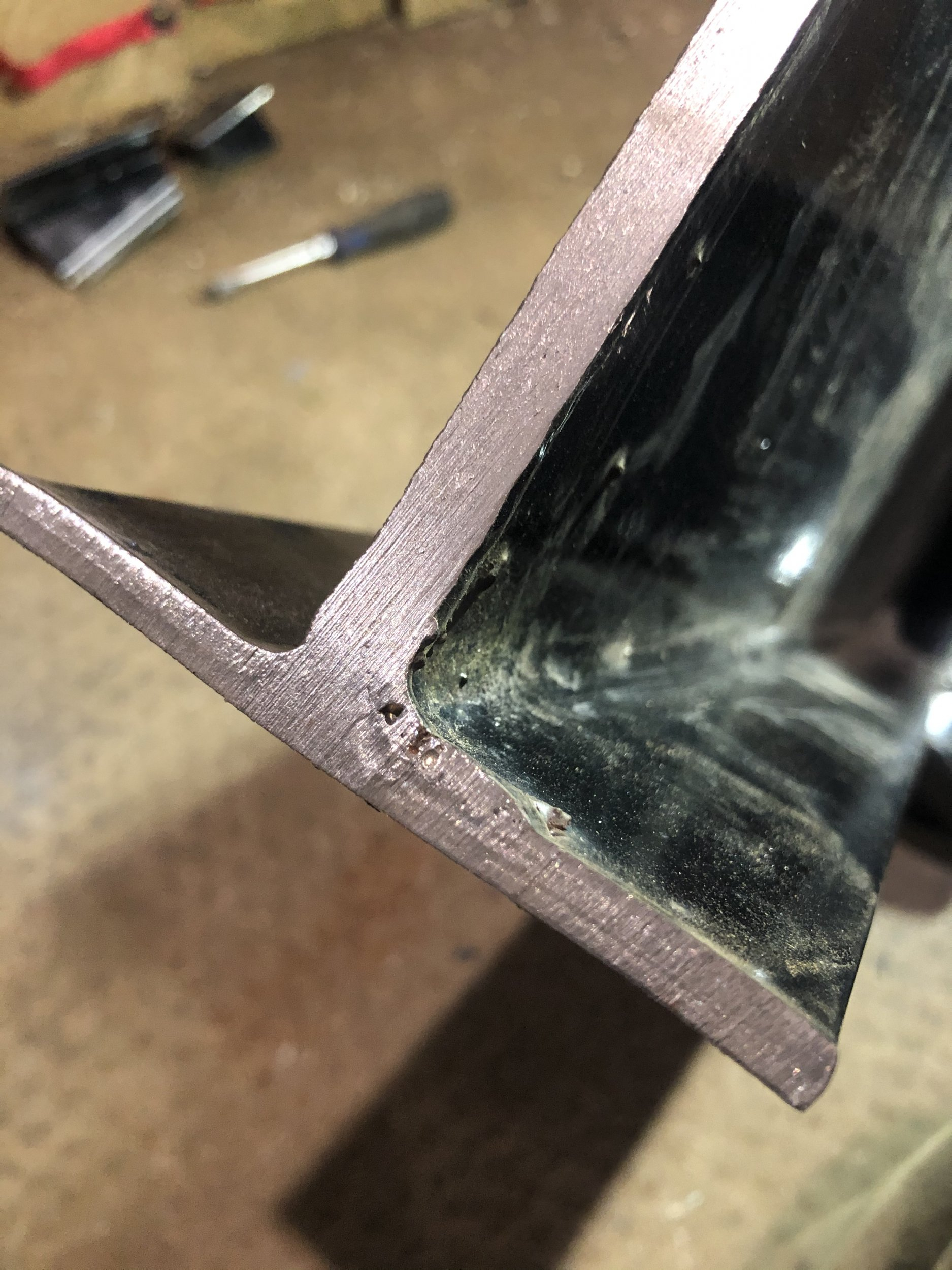

Of course, I screwed up the head beam size for some reason I bought a 12” beam when the existing one was a 10”. When I checked the manufactures website they clearly listed a 12” beam. When I compared the image to a heavier trailer I could see a difference in beam sizes. Their website lists the wrong size.

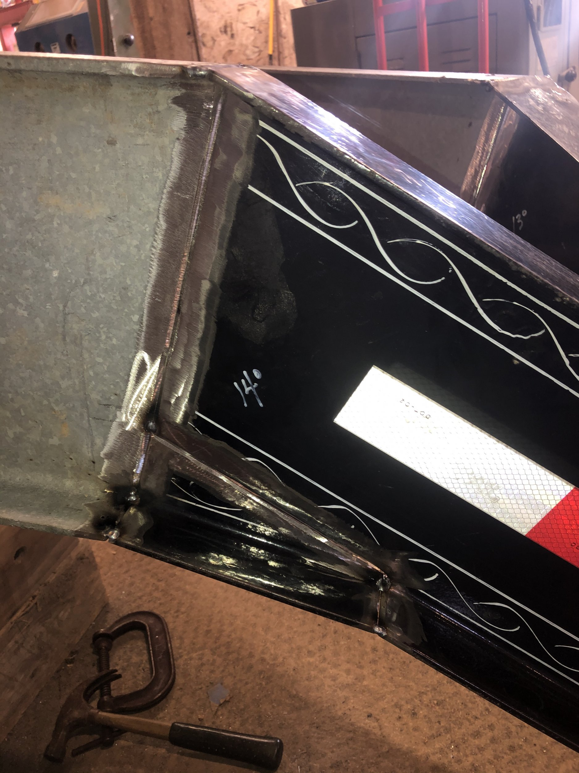

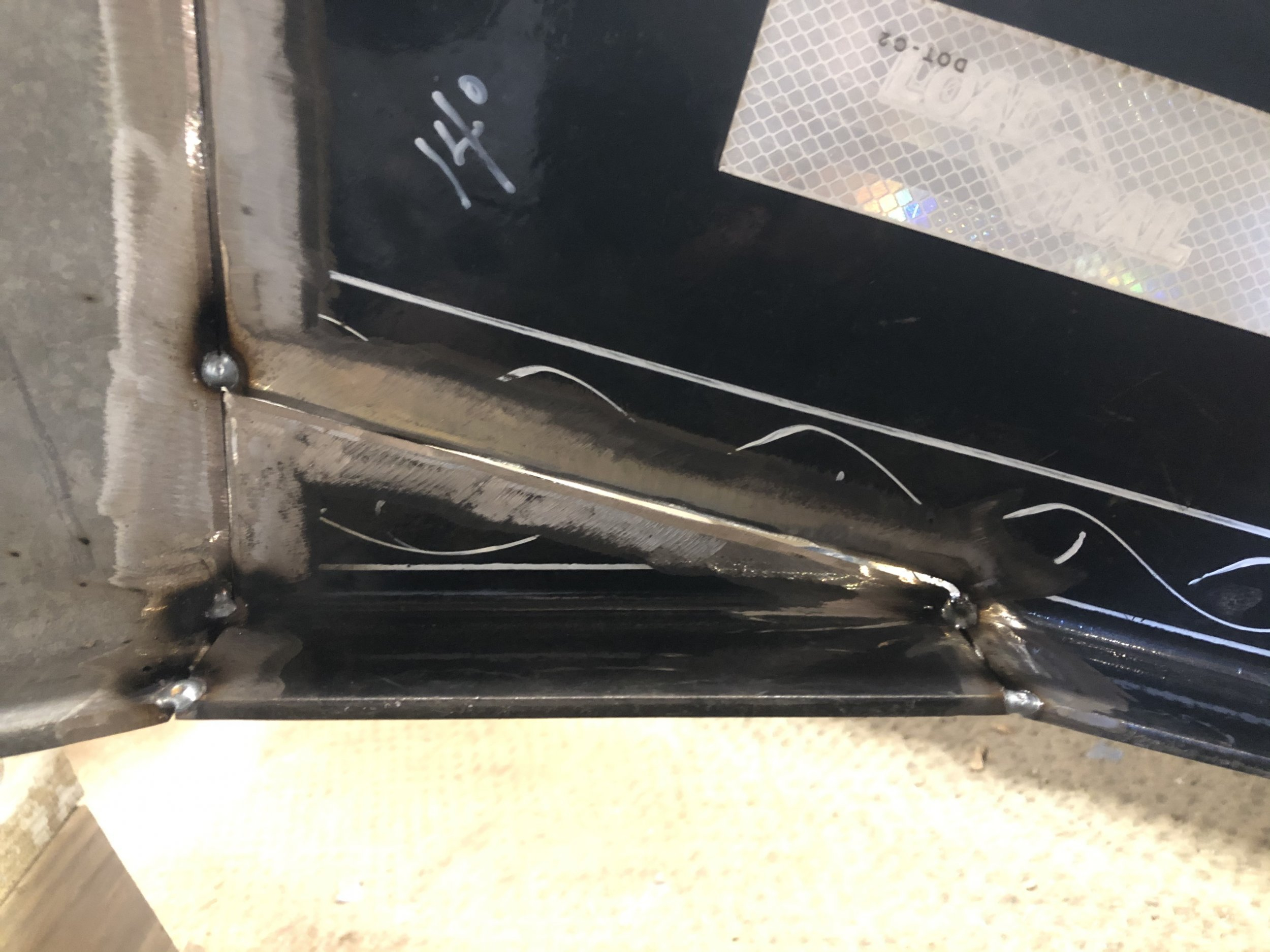

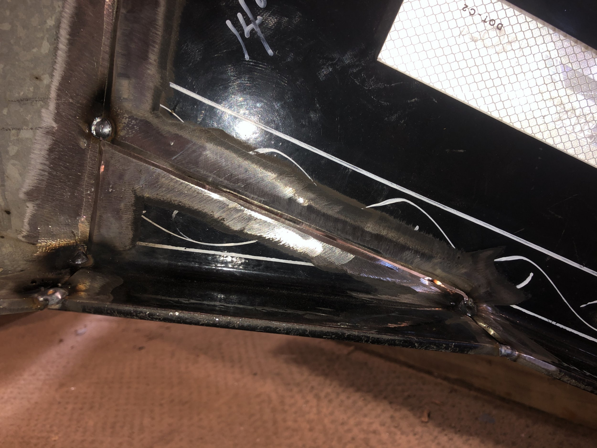

It’s interesting how so many manufacturers have an identical head design. One thing they all is a 3/16” gusset applied to the underside of the elbow joint. That gusset just happened to align with the bottom flange of the beam. I cut a piece of metal from the old beam and used it to replace the gusset. The portaband saw was indespensible on this project.
