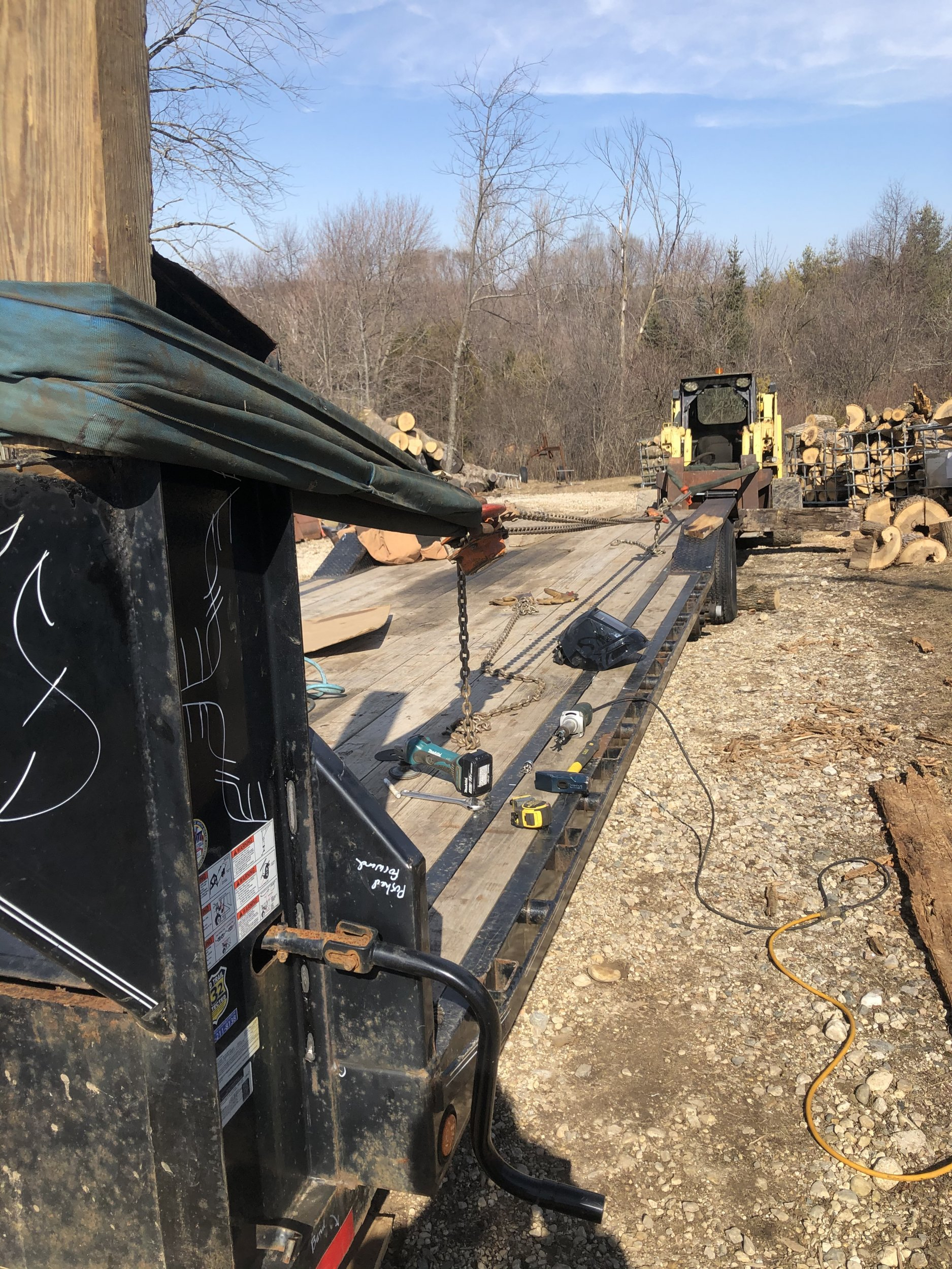

With the bed squared up, I now turned my attention to the gooseneck towers. The passenger side tower was pushed back while the drivers side tower was pulled forward. I reused the diamond pulling rig to pull the passenger side tower forward. The drivers side wasn’t as easy because there was nothing to attach to. My wife suggested I use the skidsteer as the anchor point and it worked wonderfully!

I'm impressed. Nice work so far. Looking forward to the rest of the repair build.

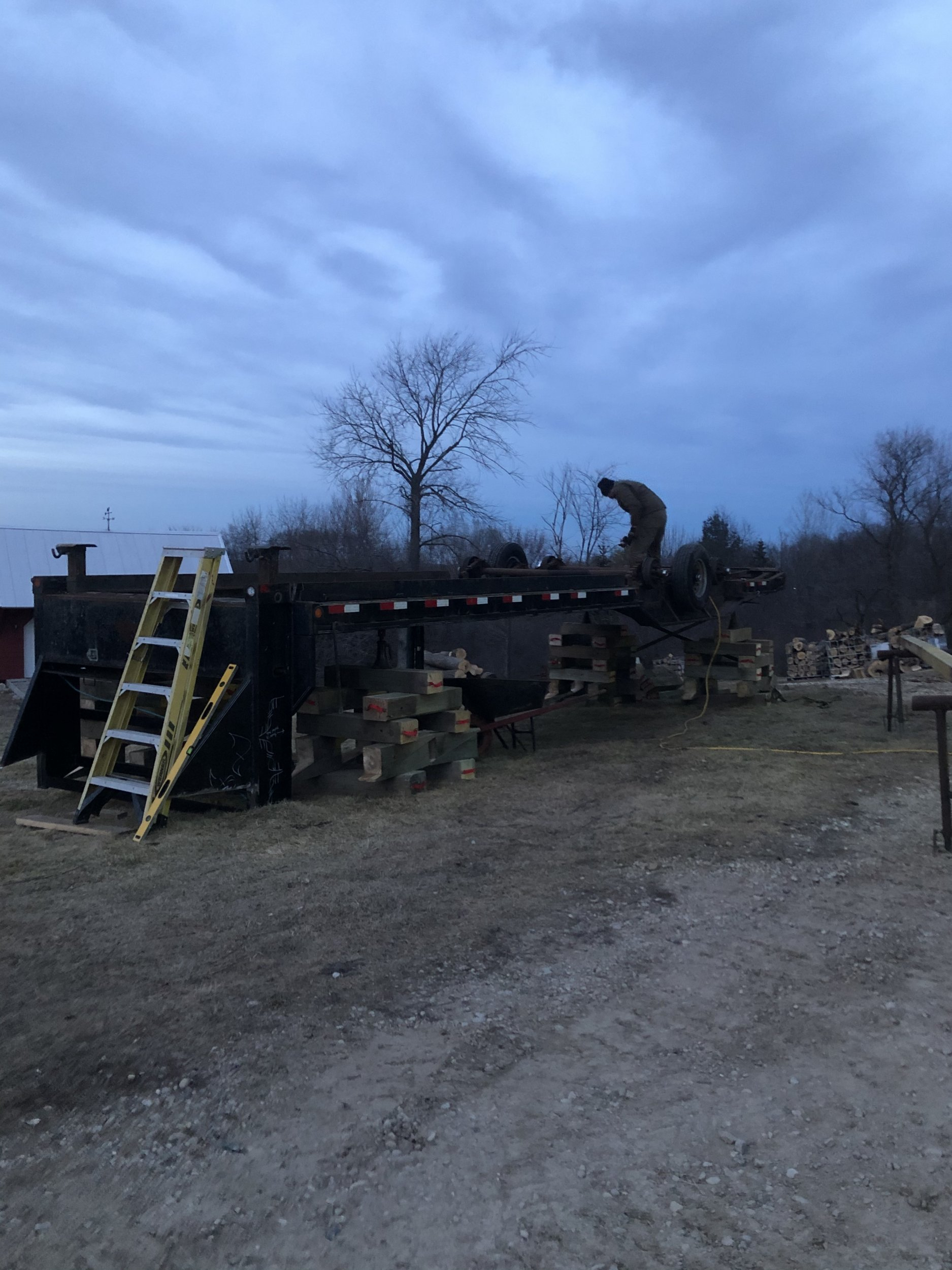

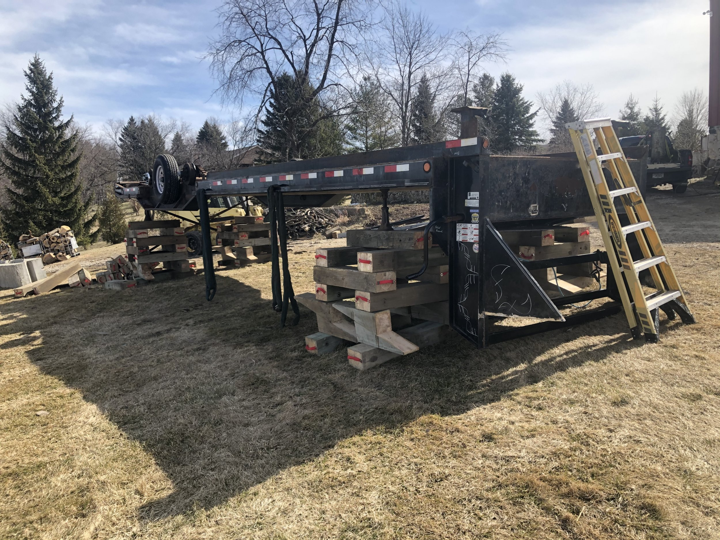

He was commercial and told me that he ate the cost so his rates wouldn’t go up. I have a 2015 GMC 2500 D-Max that I’ll be pulling it with. That truck isn’t rated for the trailers capacity, but ratings keep going up. Thanks for the complements guys!
Once we got the trailer flipped over, we built some cribbing towers under it. I then set a house jack under each corner and used them to get the trailer level. Doing this means I shouldn’t be introducing a permanent twist when the torque tubes are welded in.

With the trailer supported on the jacks, I found the tail end to be rather shaky. It just didn’t feel solid. My wife didn’t like walking down there and I was worried it might tip over. I put two ratchet straps on it, they helped, but it still was unnerving.
I knew from my research that trailers of this length were using a 6” sch 40 pipe for the torque tube. Pipe is ideal for controlling the twist because it’s torsionally stable. Unfortunately, I couldn’t fit a 6” pipe under the axles and I didn’t want to get into cutting the floor channels. I found some 1/4x4x4 tubes on Market Place that would fit under the axles, but the tubes were only 10’ lengths. They were used as guard rails in a factory so each tube had a stand and baseplate welded to it. The price was right so I bought all that he had. Instead of using a single pipe, I thought I’d use two tubes instead.
I spent a day torching off the legs and grinding the slag so the tubes would fit into the band saw. When it came to splicing the tubes, I decided to make the cuts at a 20 degree angle in the hope the splice would be stronger. I also cut the tubes so there wouldn’t be any splices across from each other.
