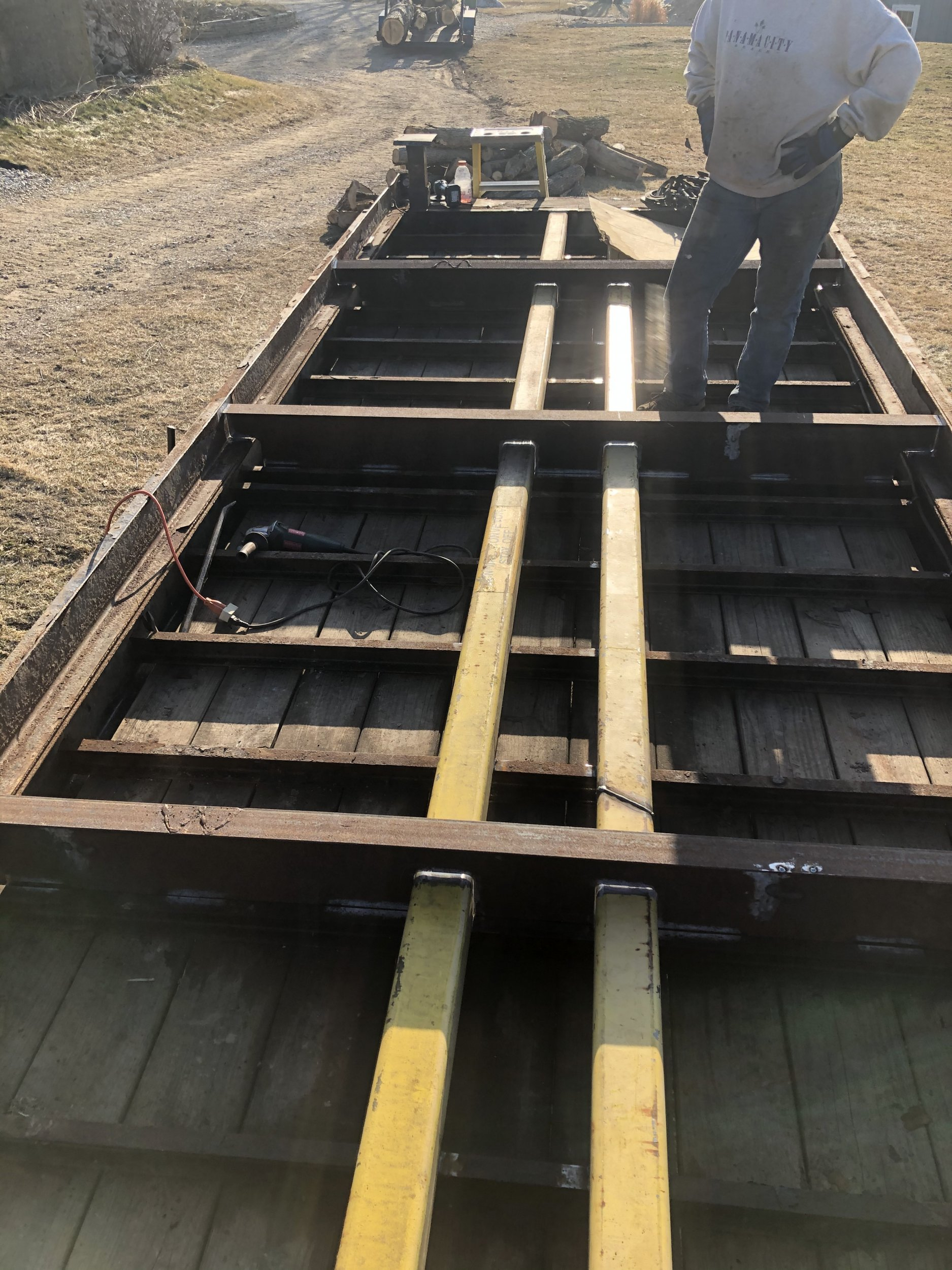

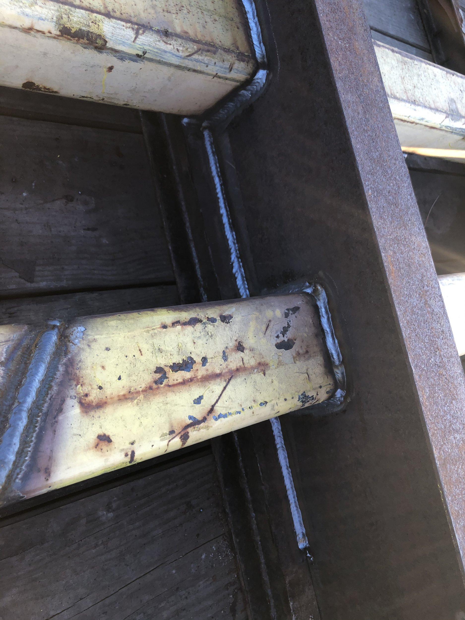

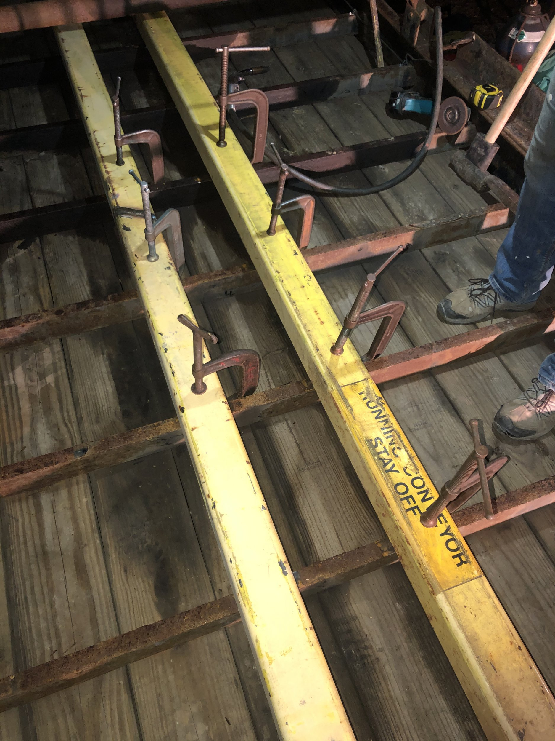

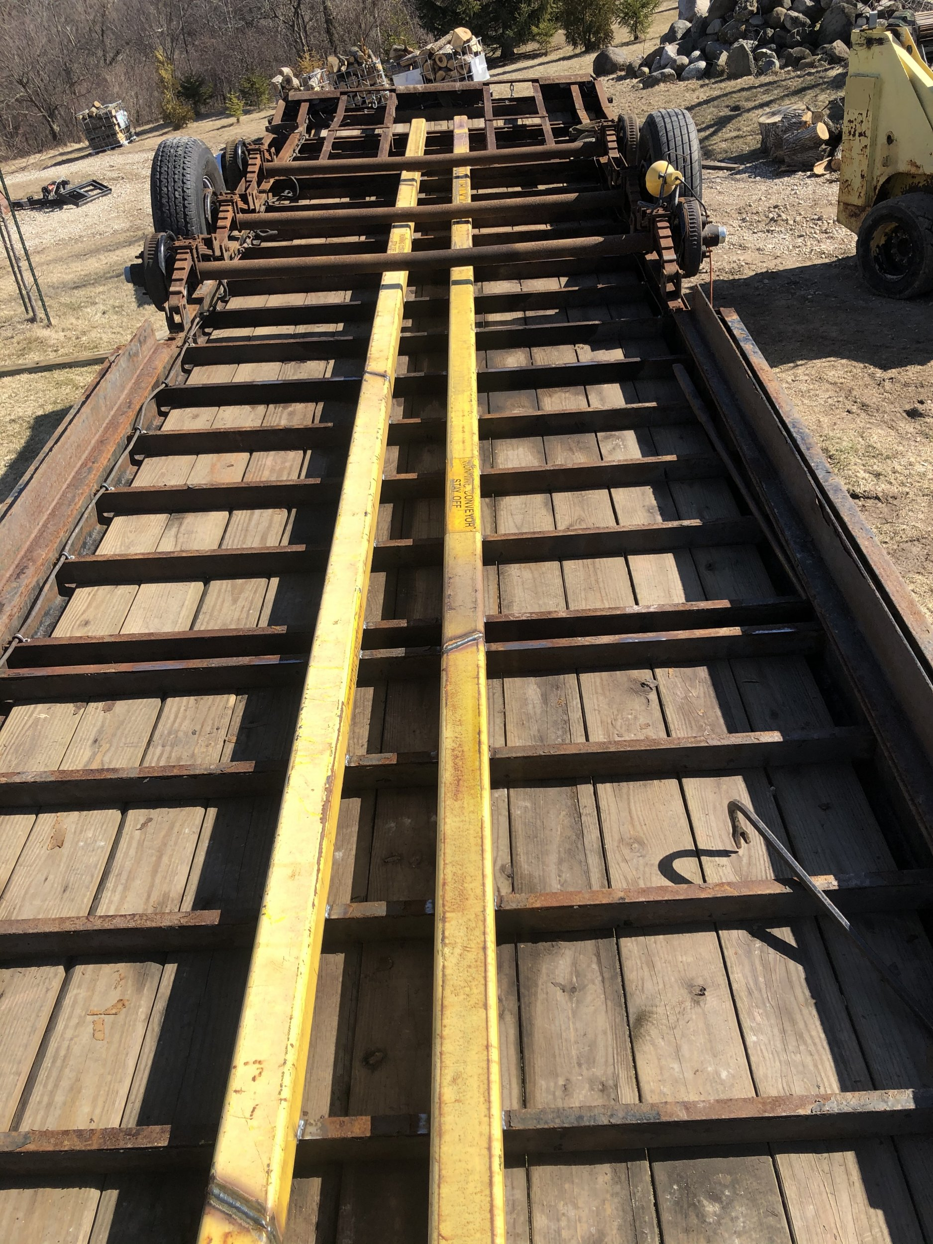

With the tubes spliced together we could now put them into the trailer. I know that manufactures were running the tubes to the center of the axles, but I thought I’d extend mine all the way back to the tail. We inserted both tubes at the same time and they went in without any problems. Only needed to lift up the center axle slightly to get them to fit.

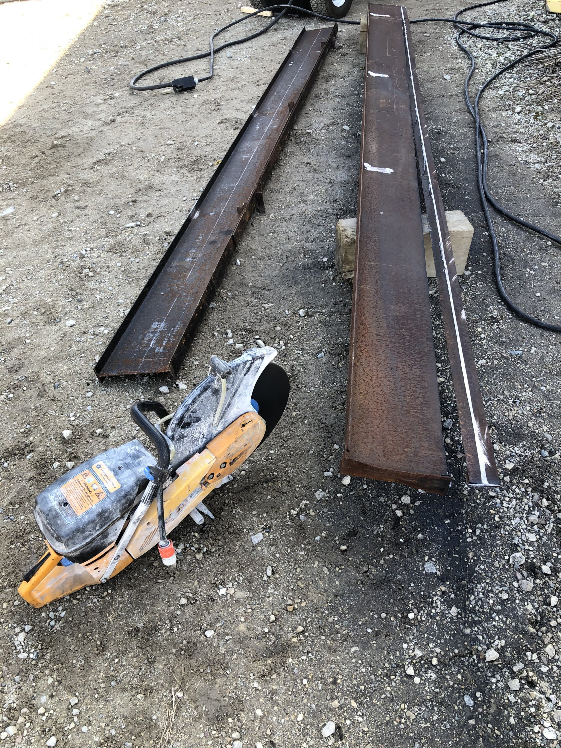

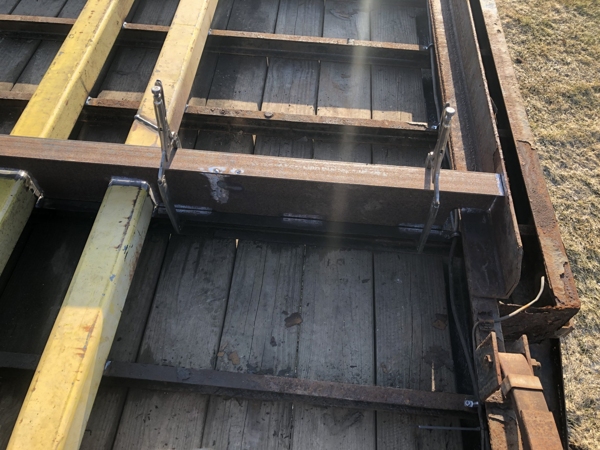

Got a few more updates for you guys. With the torque tubes welded in we could now add the torque arms. The goal is to transfer any twisting force from the trailer into the tubes. For the torque arms I used a 10” I beam salvaged from a mobile home. The beams are exceptionally light which is perfect for the application. I started by slicing each beam lengthwise to make it into a T. The T then got notched so it would fit over the tubes. The ends are also notched so the T will fit over the frame angle while providing clearance for the wiring. For as complex as these pieces were, I’m very happy with how they turned out.

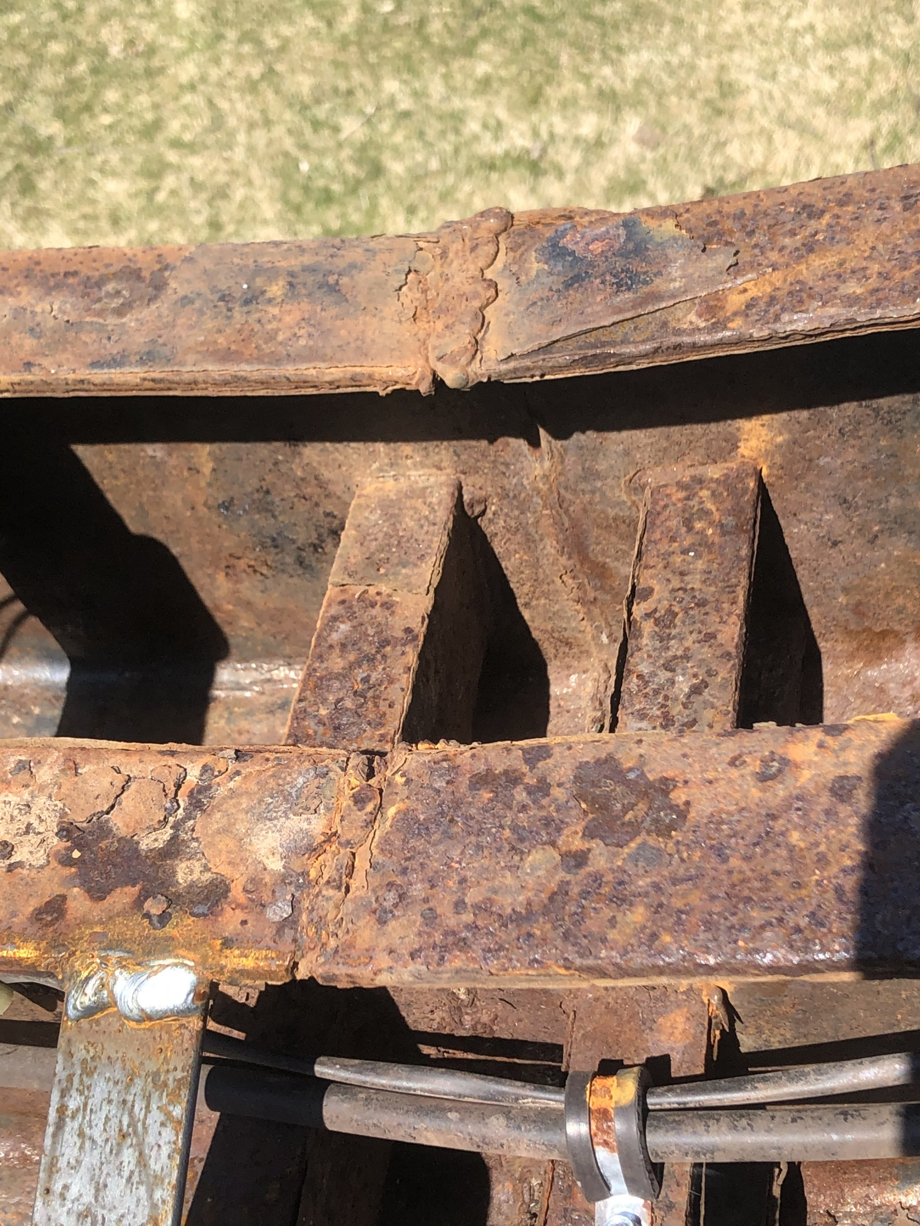

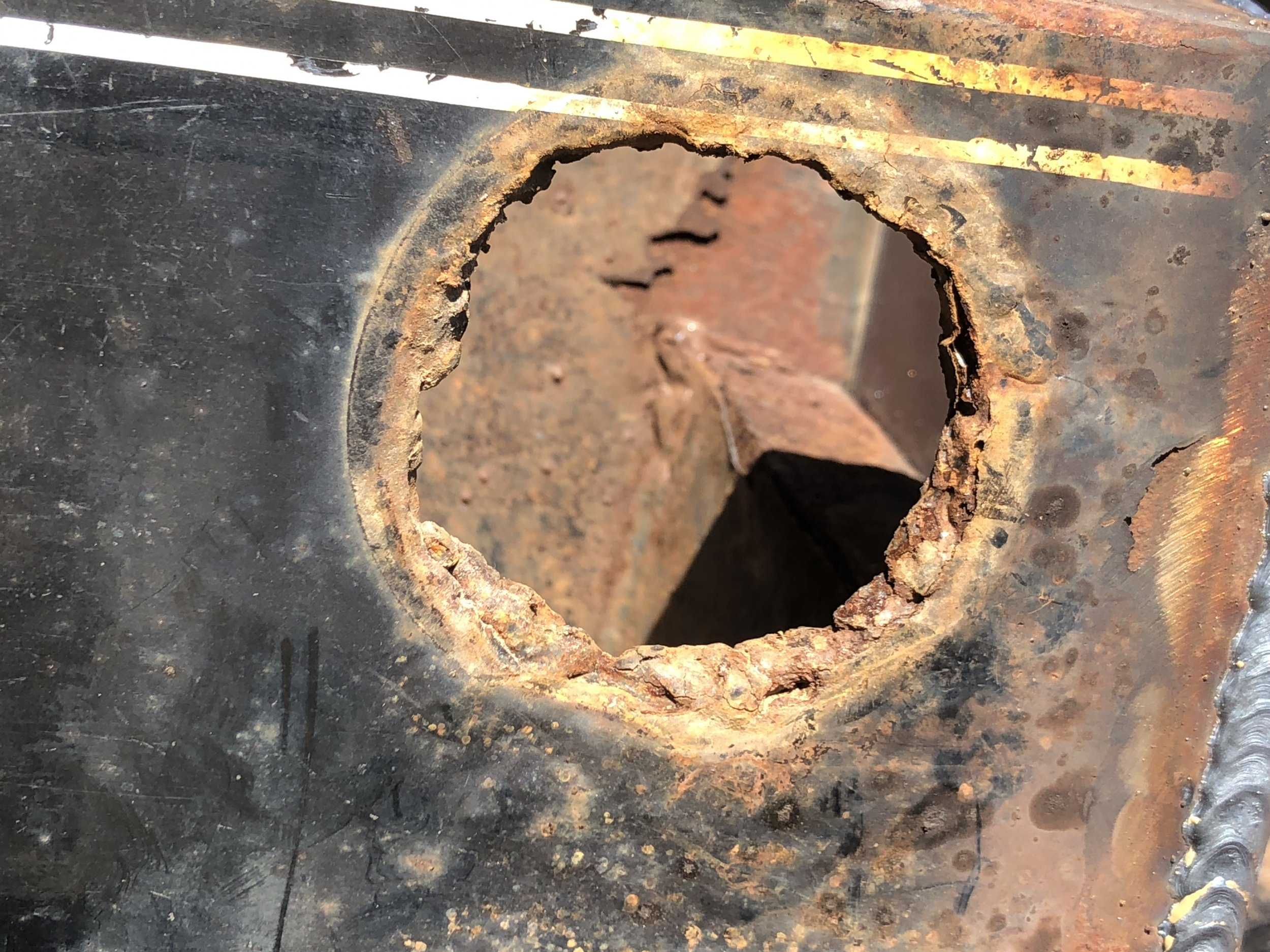

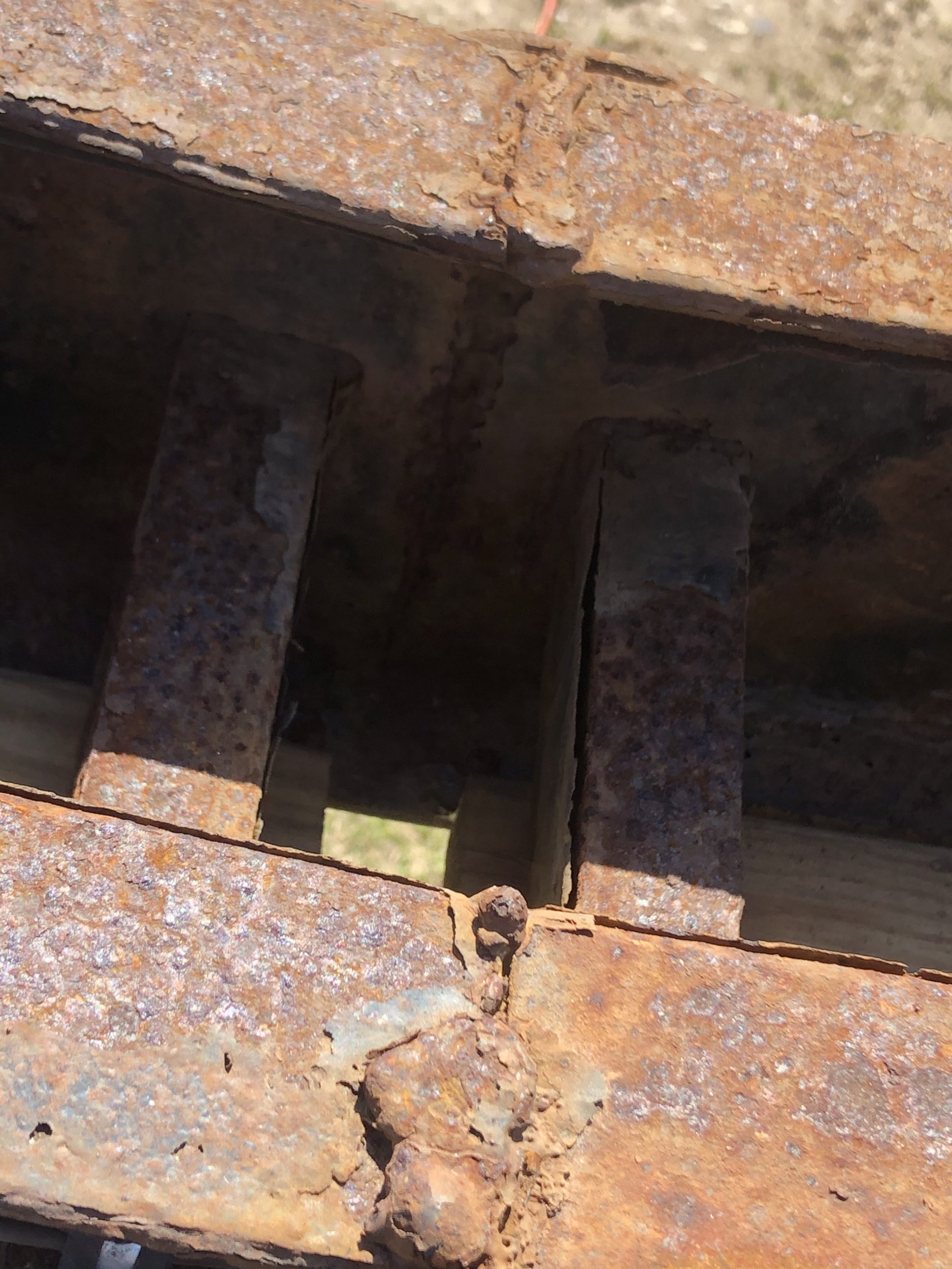

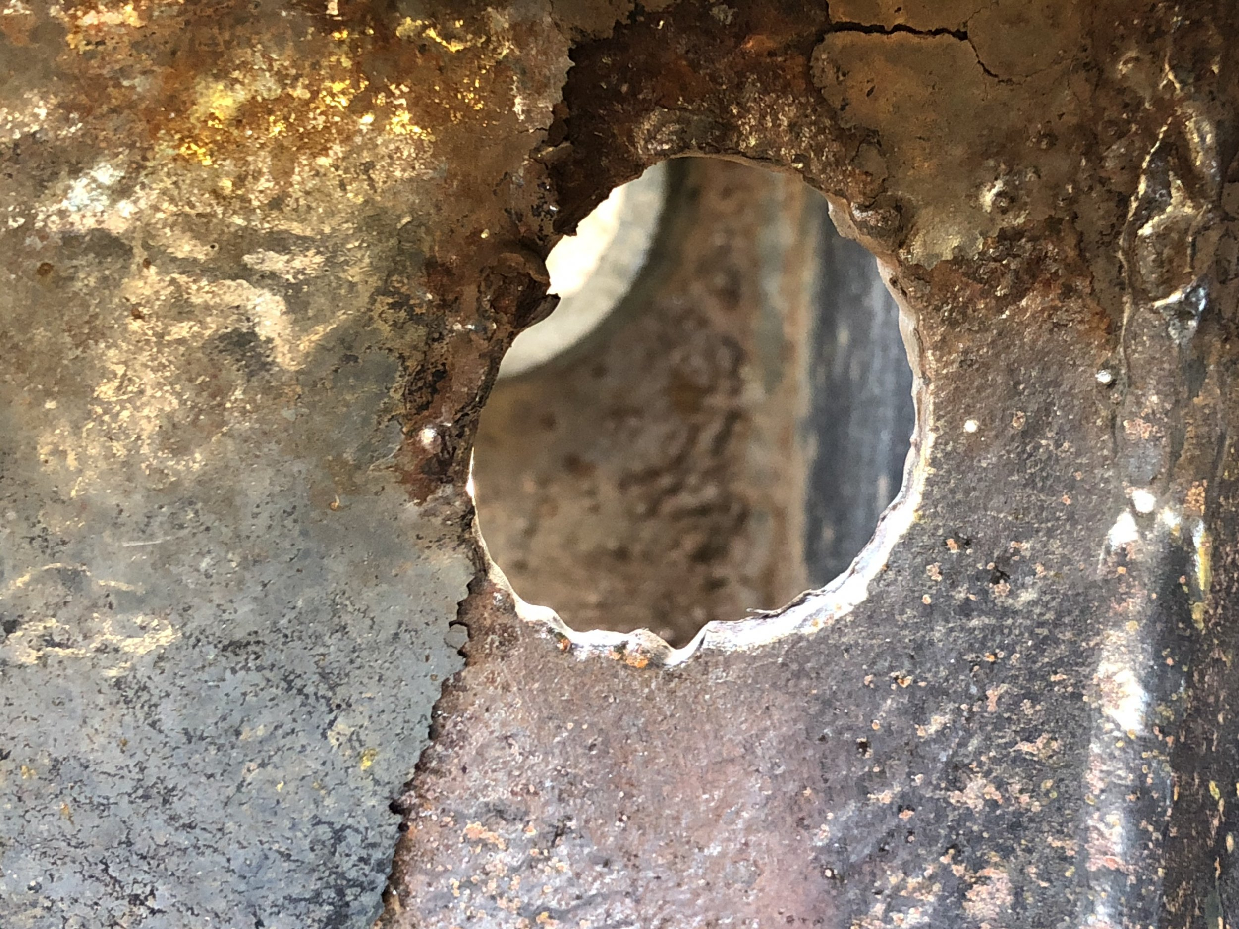

I mentioned in an earlier post about not being satisfied with the Load Trail build quality. What I’ve noticed is that there are several manufacturers vying to be the cheapest trailer out there. I guess they build what sells. Just wanted to let you know what you are buying.
Where the wiring passes through a structural member they torched in a hole and didn’t use a gromit.
The light holes are torched in as well. We popped a few of the lights out and broke one because the fit was so tight.
There appears to be two different weld qualities. The welds on the neck are very neat and professionally done. The welds under the deck were done as quickly as possible. Often there is porosity and the weld has a ropey look it.
if you are wondering about the rust... this trailer is 6 years old.

I don't think I saw where you mentioned the year the trailer was thrown together or not. Looking at the last pics you posted, the rust and condition makes me think there was little or no preparation for paint or general finish when the trailer was new. I cannot imagine running wires through torched holes in the frame and I sure would never put a product out with welds like those. You're doing well trying to bring it back to life. Shame the OEM didn't do better along with the original owner.
   / Gooseneck trailer repair project #29
The work you've done is impressive! The torched holes by the manufacturer is shocking to me. At least with modern lighting, it is easier to check details like that on newer trailers by popping out the grommets and lights for inspection. Between the torched holes and the sloppy welds that are hidden, you've definitely exposed their production plan... higher quality only in areas easily seen, and slop work where hidden.
