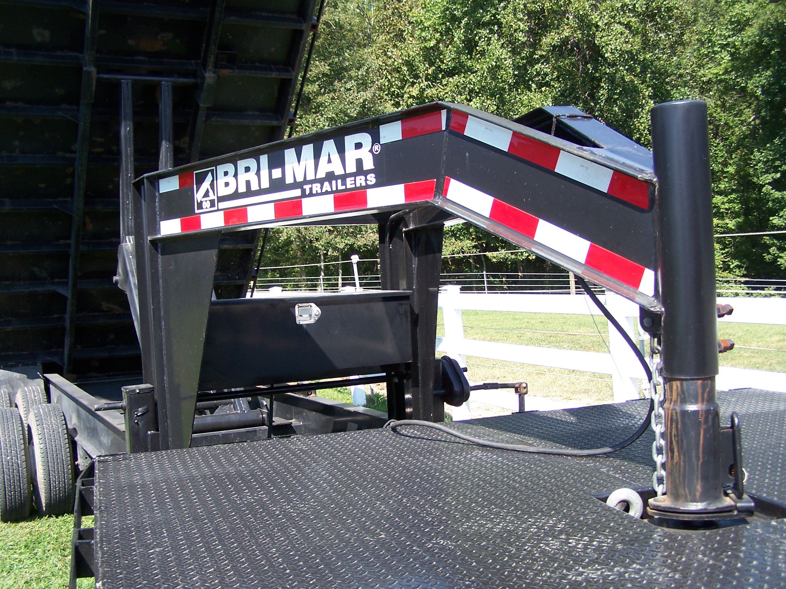

I used to have a 16' Bri-Mar tandem dually that I had bought used in 08'. Typical powder coat paint but metal work and welding top notch in my eyes anyway. It did not have ramps but what with the bed floor being maybe four feet off of the ground, it would have not been for the faint of heart to load a piece of equipment on. Not to mention some pretty stout ramps. It pulled and handled well with my 12v Dodge as long as I kept the fuel filter clean. Much better with my FL70, the bed of which you can see in the following photo.
