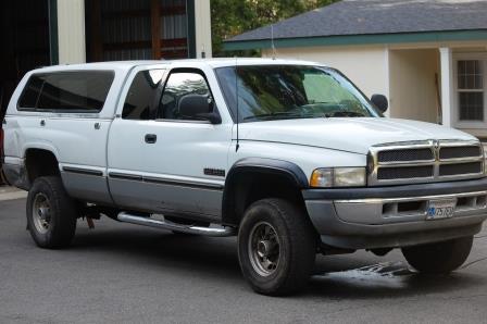

Well done. I showed it to my 24v '98 3/4 ton and it nodded yes and showed its Juice with Tude. DSC_0946.JPG
