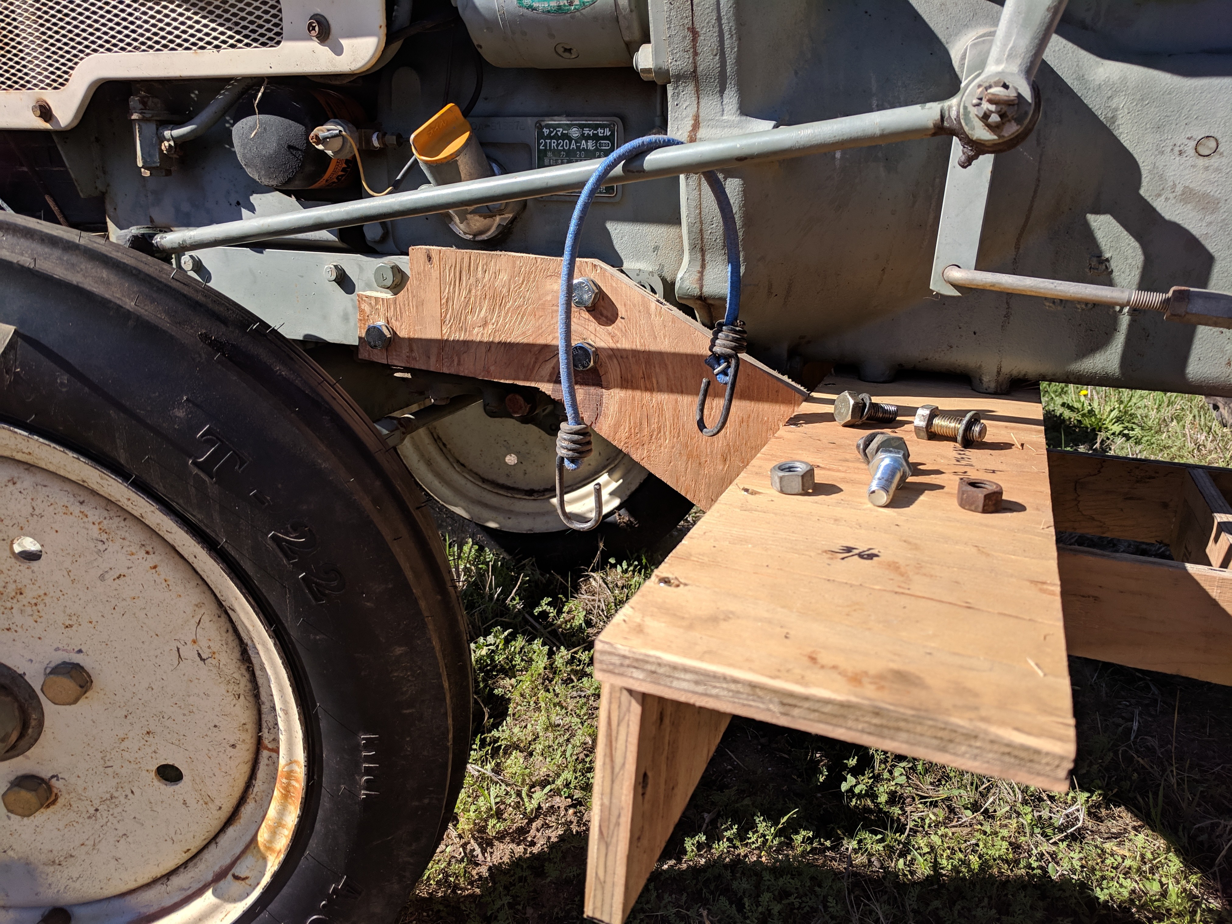

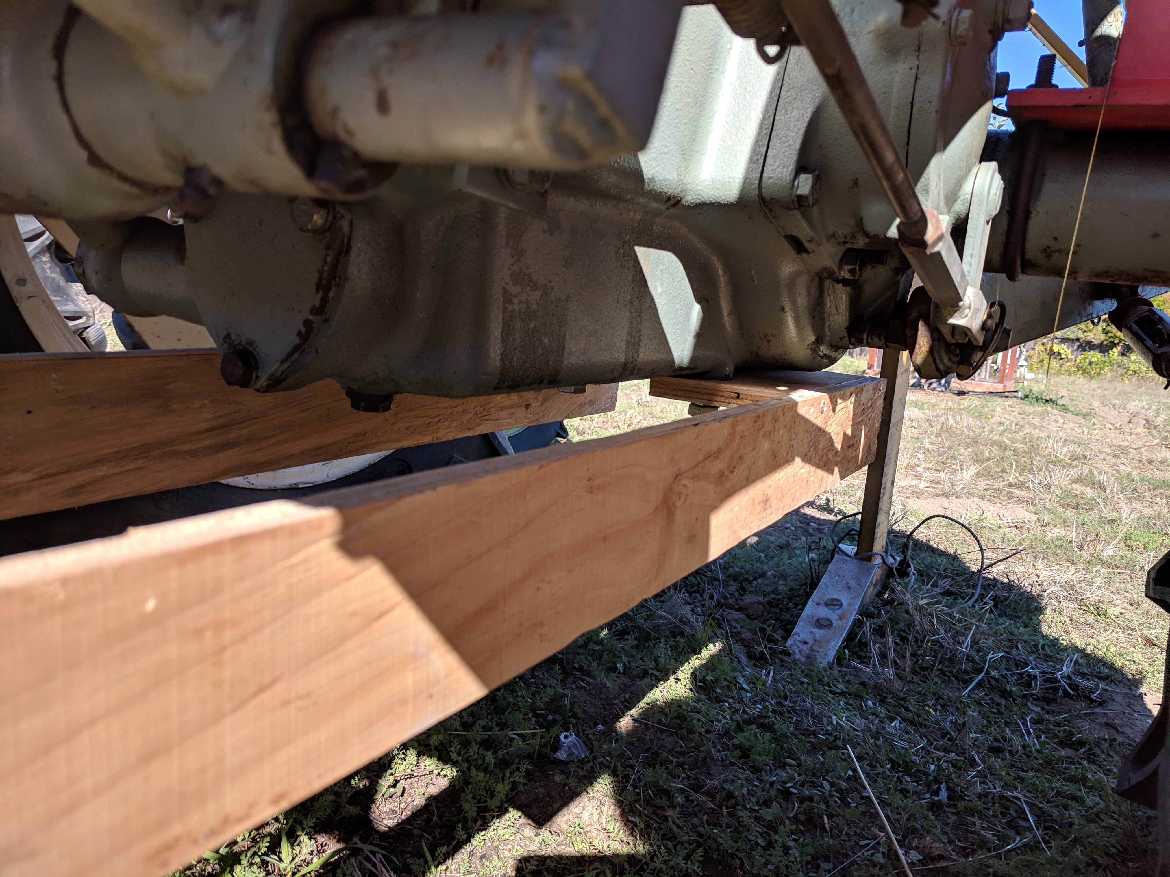

I have a YM2000 compact tractor, 14hp, I think. I have a FEL but it did not come with a sub frame for the FEL. I went to a welding shop and had them price it out for me. Its a pretty small. Main support is 6in L on 3/8" steel. The rear support is 3in wide, running 3ft to the rear.
The welder quoted me $800 to do this. I have attached photos of my plywood template.
Thoughts ?

I think you built a great wood mock up. I'd like to have seen you build the steel version too but hey, Is what it is. $800 and not your time. Seems good.
/ Good price for a welded sub frame ? #5
As a small fab shop owner I would say good price. Making those templates will save you money for sure as the fabricator has to do less thinking.

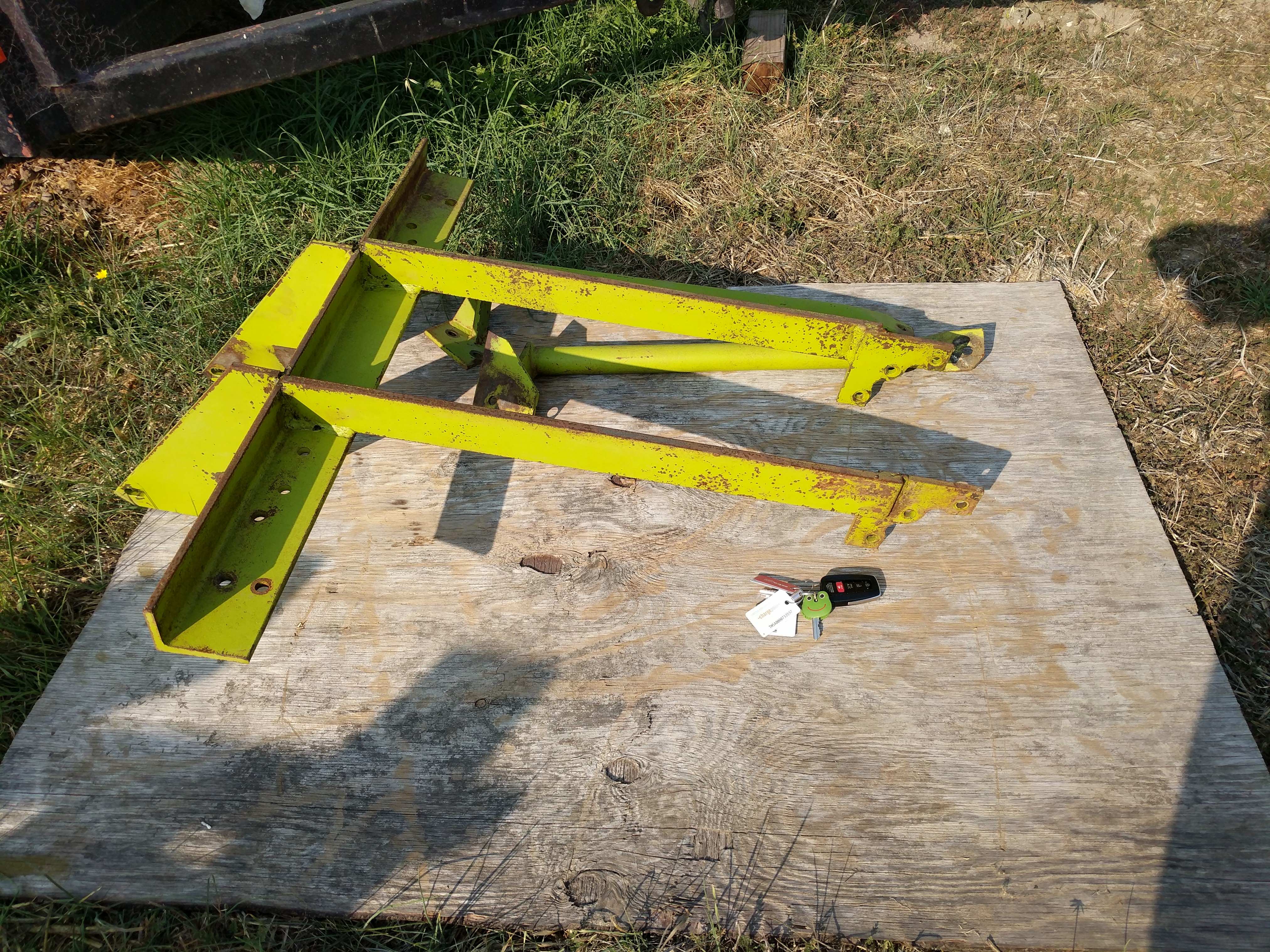

This is all they are making, just 1ft longer and wider using 3/8 iron.
Car keys used for scale

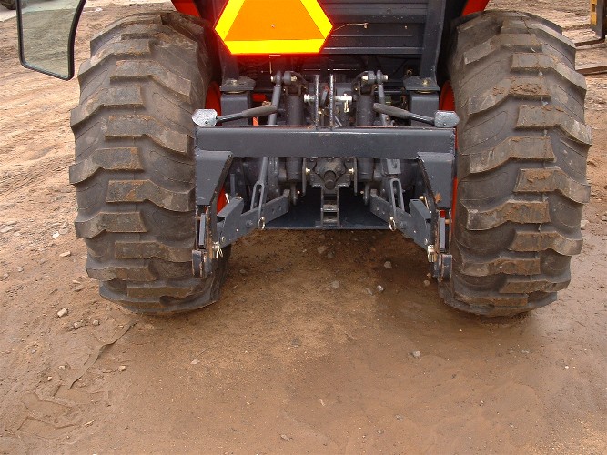

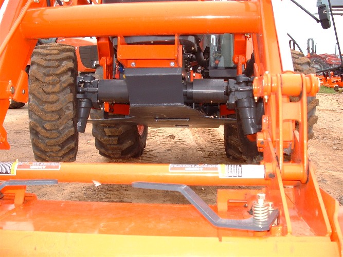

You know, something like that probably won't need really heavy metal. This is 3/8" I did a few years back. But you'd probably be fine with 1/4". Something like that though should cost between 800 to 1200.00 with materials. I know this is a belly pan, but it's not much different, other than I'd reinforce the frame with 2 x3x 3/16" square tubing. That's be enough for this size tractor.
