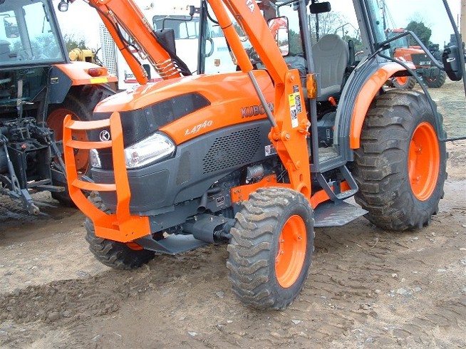

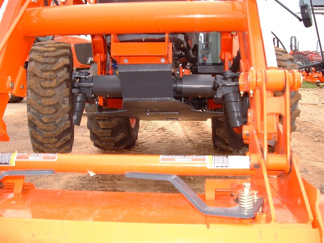

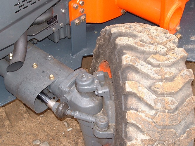

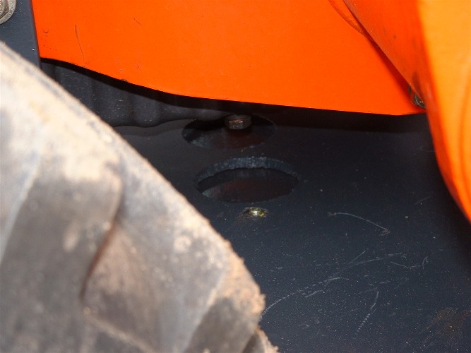

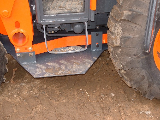

You know, something like that probably won't need really heavy metal. This is 3/8" I did a few years back. But you'd probably be fine with 1/4". Something like that though should cost between 800 to 1200.00 with materials. I know this is a belly pan, but it's not much different, other than I'd reinforce the frame with 2 x3x 3/16" square tubing. That's be enough for this size tractor.
