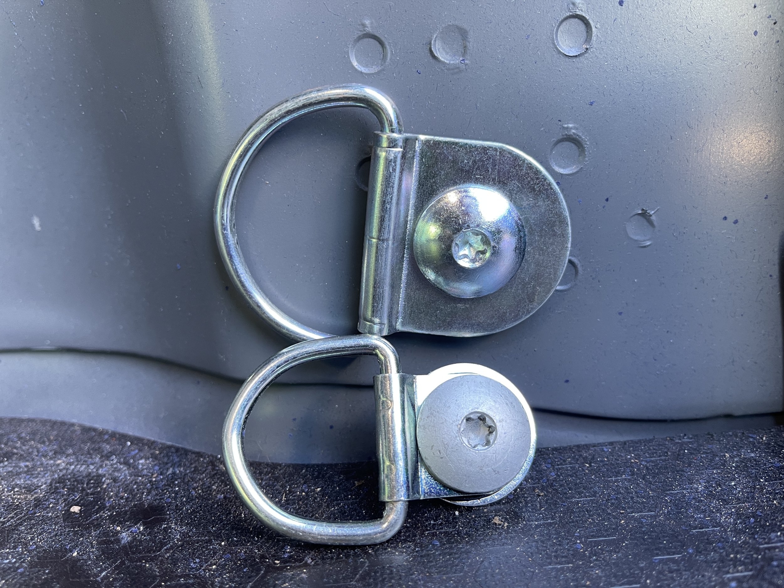

Here's a photo of the two types of anchors that RAM uses in the van. both use nut plates welded to underneath the sheetmetal for anchors.
I'm trying to mount a pair of the larger ones where I don't have access to the back side of the hole, so I'm trying to distribute the load over more holes using a steel plate on the outside of the sheet metal bulkhead. I'll try go post some photos of what I've got later today, OK?
How about tapping a thicker steel plate to accept the tie down and welding it in place, or perhaps use rib nuts if they will clear the obstruction above the fuel tank.
