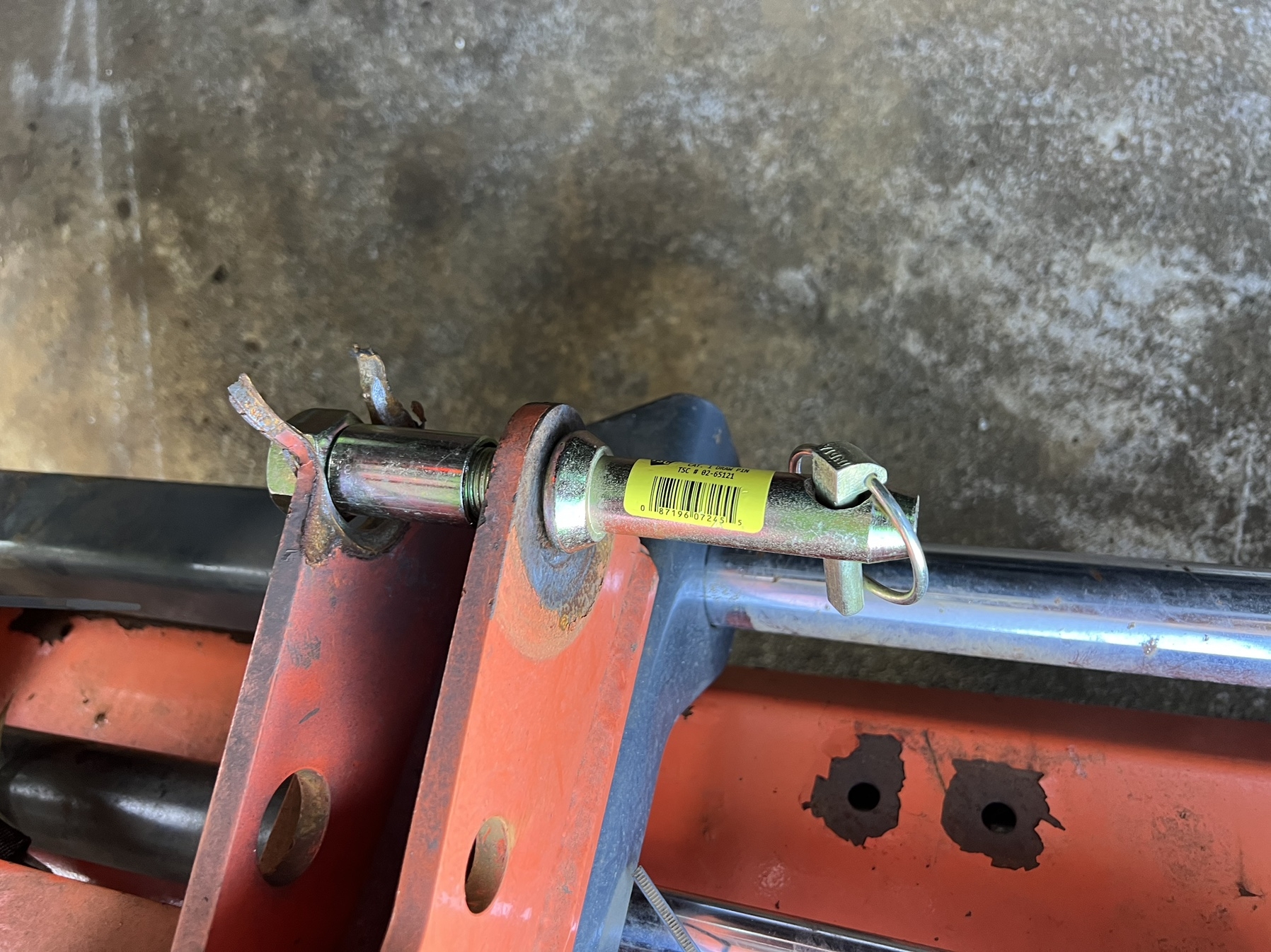

Flail back in service
While lift pins pointed outward was my preferred fix, it didn’t work. Could only attach if the extendable lift arms were fully extended
Pointing inward did but had to use a short bushing in the pin side hole as it was Cat2 size and a double washer due to non threaded portion.
Still wish the threaded portion about 1/2 “ longer. Will have to monitor nuts.
Will do a test mow after lunch.

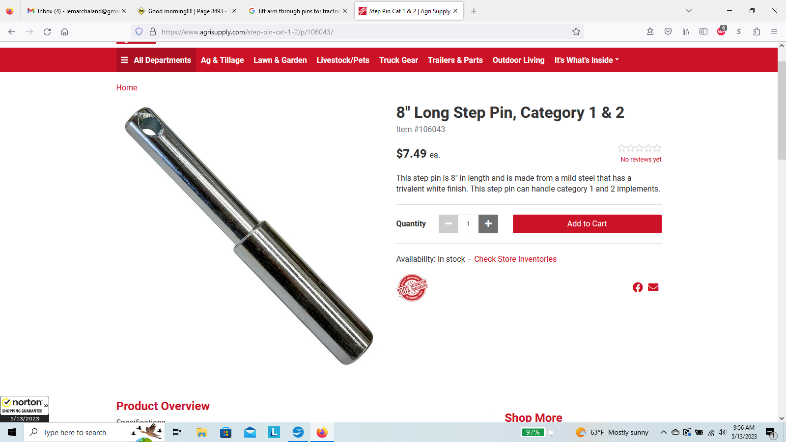

Looking at your pictures it seems to me that you mower was originally designed to use thru pins with the lift arm sandwiched between the side plates.
Have you considered getting a second plate and bolting it on outside of the torn out piece?
Some of the through pins are stepped for implements with two different hole sizes, some are just straight pins.
I think Lou is correct. Thanks Lou.
