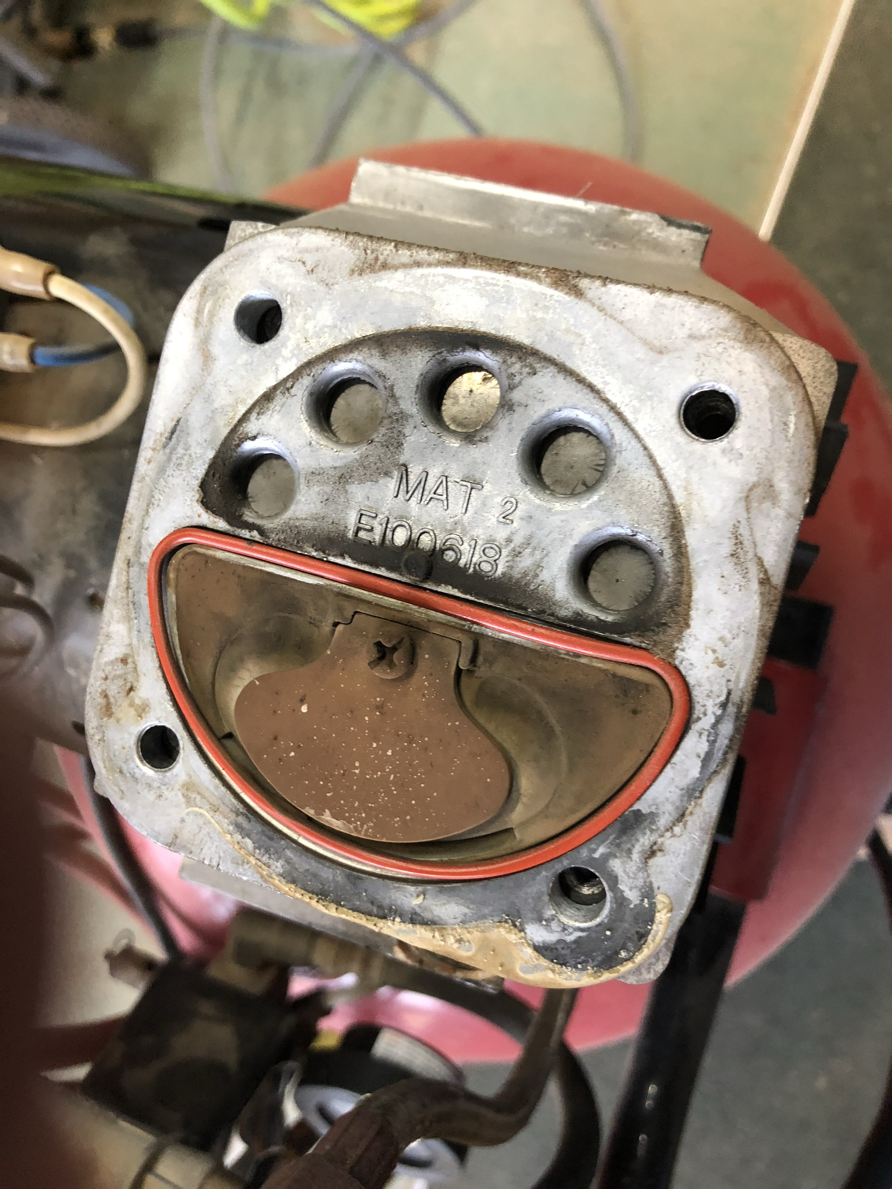

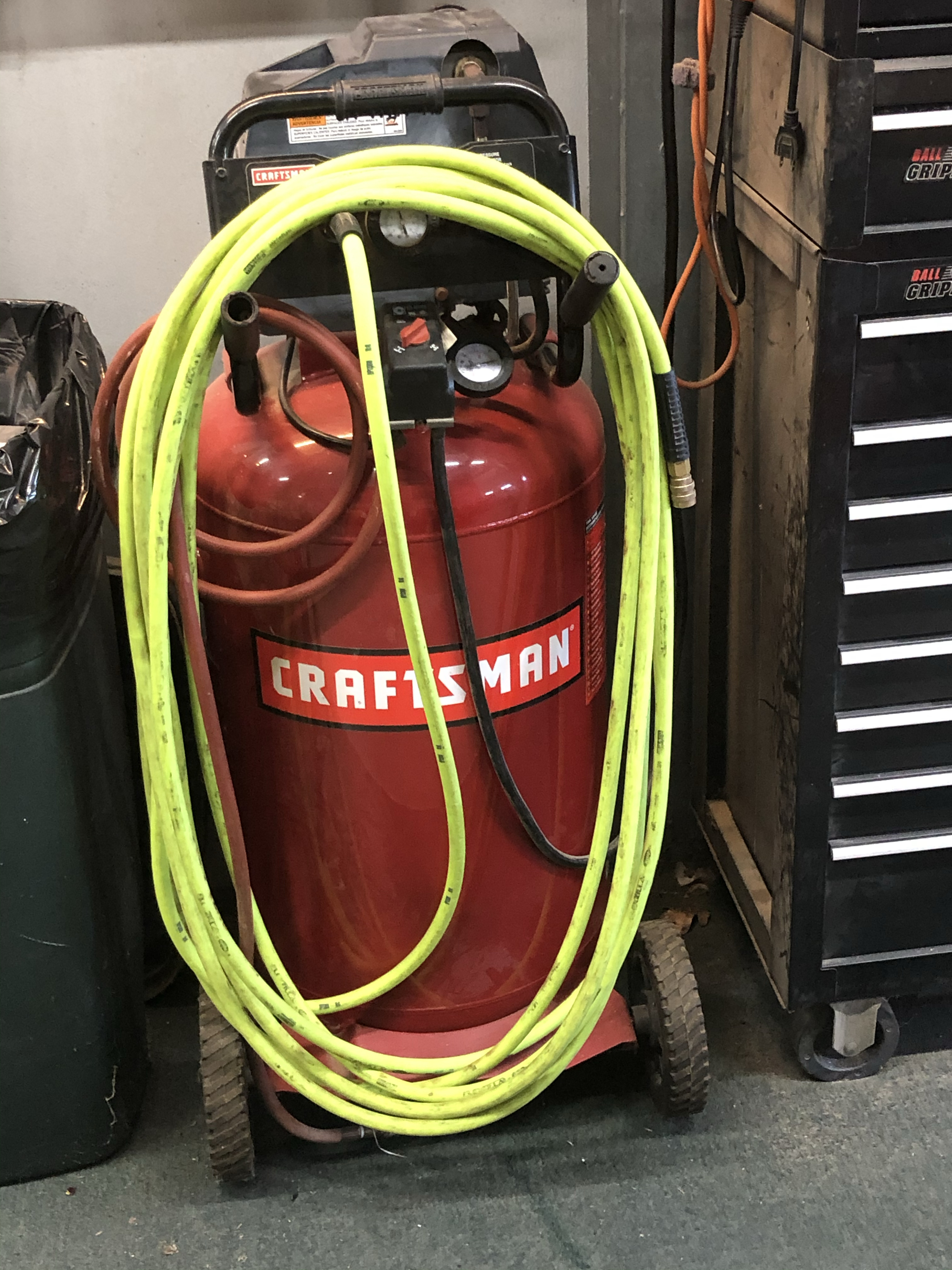

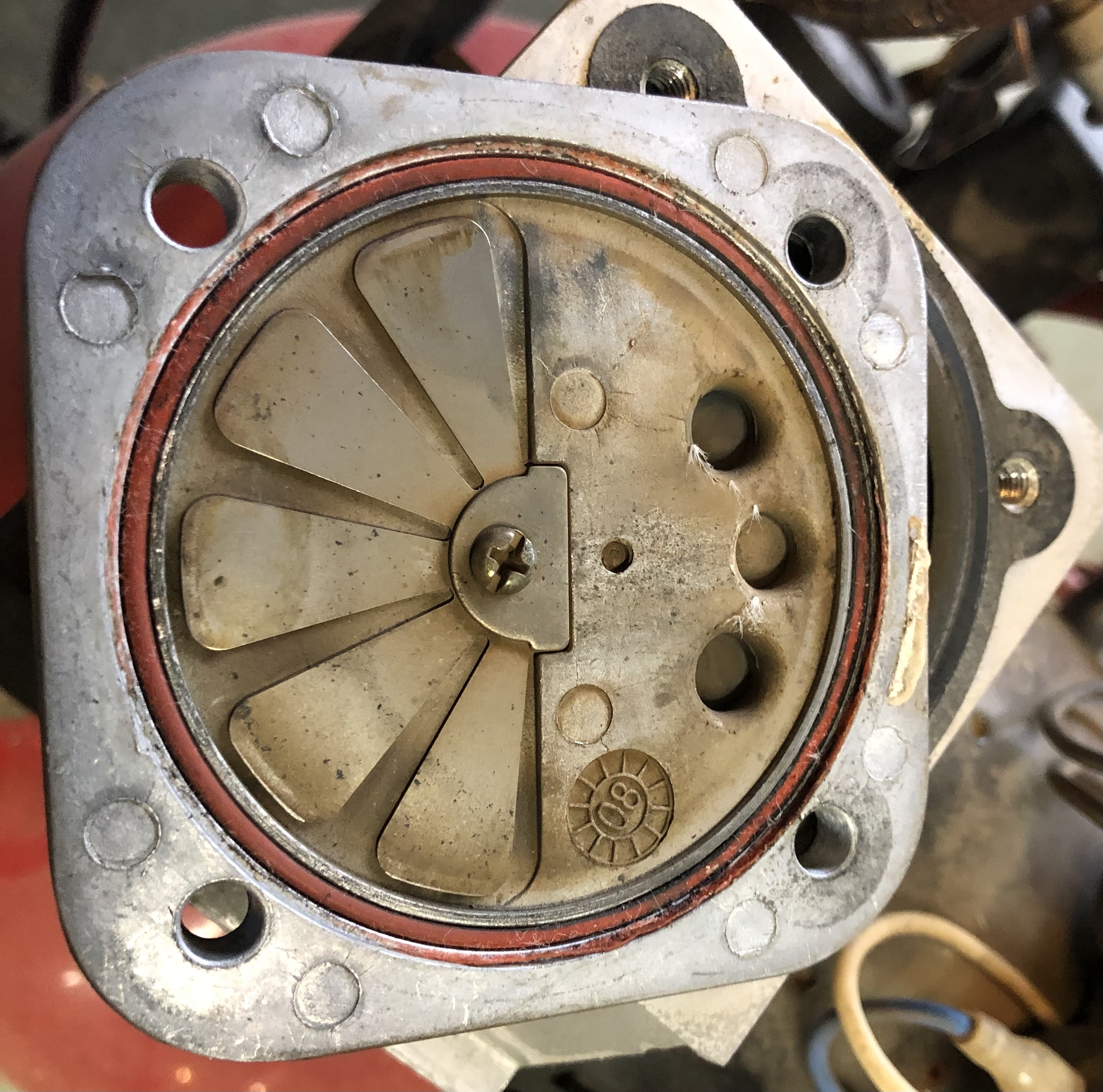

I spent yesterday morning in the big shop trouble shooting one of my air compressors .. a roughly 10 year old Craftsman "oil less".
It runs but will not build any pressure in the tank. I removed all the covers and the top of the head .. expecting to see damaged reeds on the valve plate.
The reeds look to be okay but .. I went online to partselect.com and ordered a new valve plate, the o-ring for bottom of the VP, the "D" o-ring for the top of the VP, and a piston o-ring JIC. They conformed my order but .. have not yet confirmed a ship date.
Perhaps the "Giddings Compressor Whisperer" will whisper some advise to me.

Compressor Central here, You need to look at the cylinder wall, and the piston ring or whatever it has for sealing. Some compressors you can buy a new drop in, thin wall cylinder/piston/lip seal. Your reeds look decent. Need more info.
