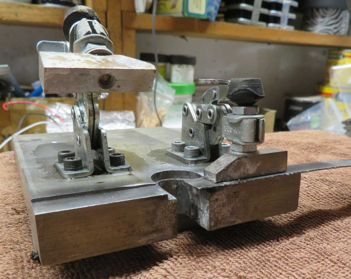

Thanks for the link. That痴 pretty much what I am doing. Except I have some 1/2 X 6 aluminum plate I am making it out of.
At long last, some photos:
One end of blade clamped:

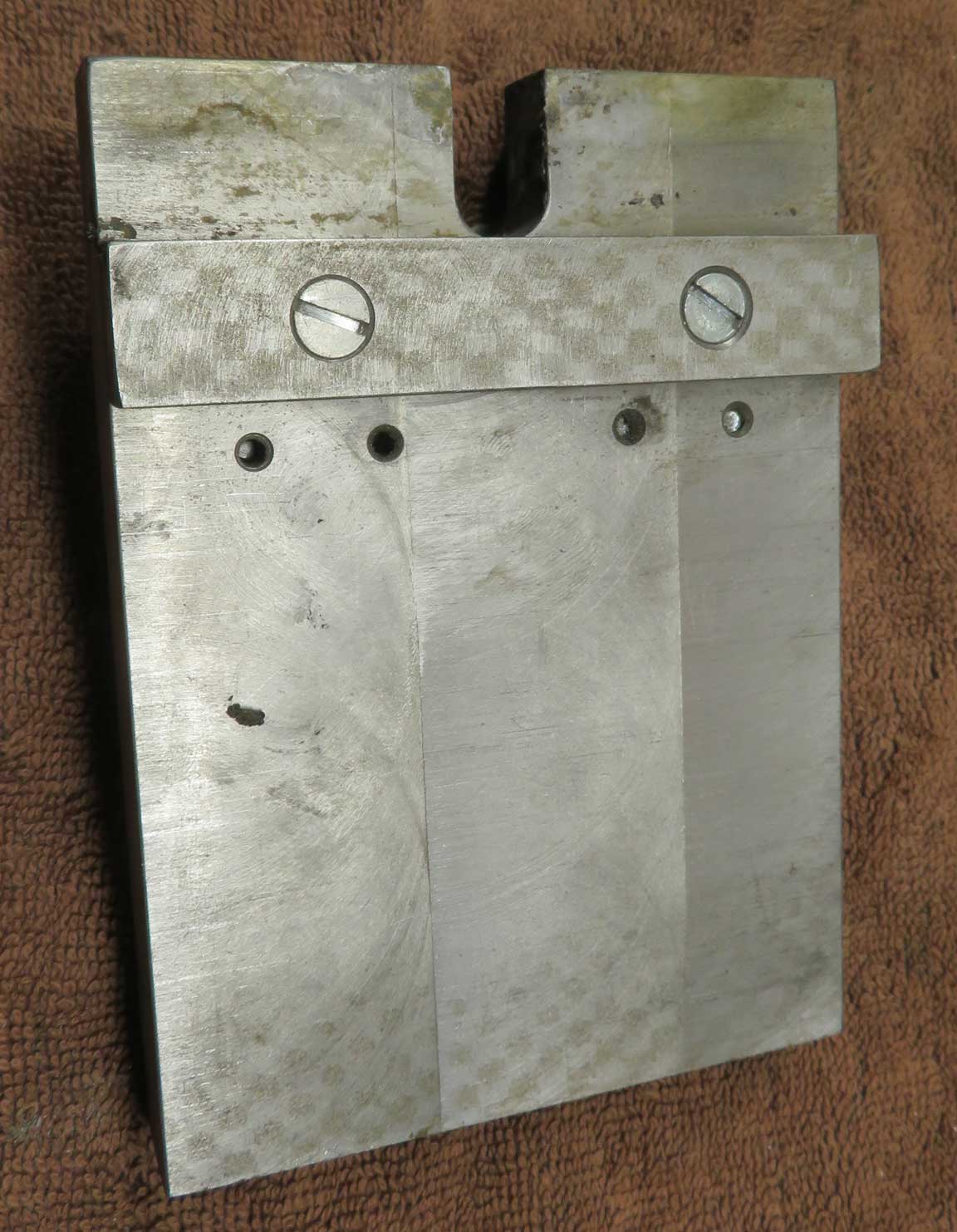

Slot used for grinding the bevel on the blade ends:
Tenon for positioning fixture on band saw table:

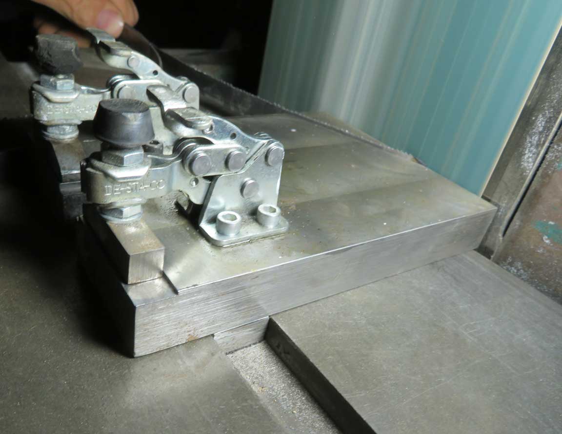

Grinding the bevel on the belt sander:

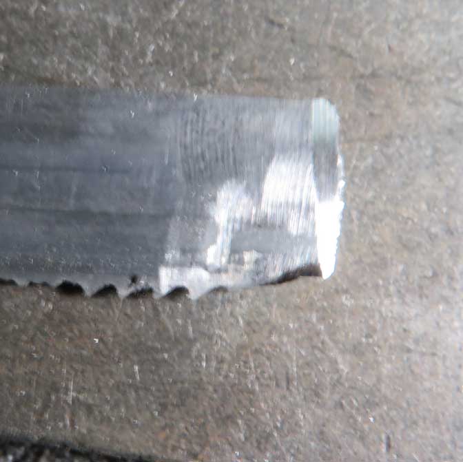

A very poor example of a bevel ground blade end:

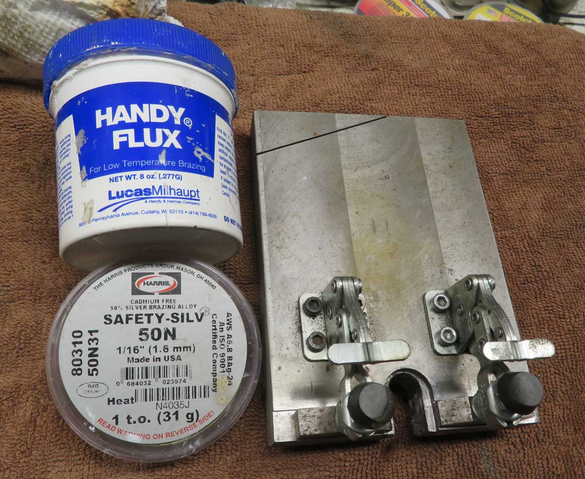

Flux, silver solder, and fixture:

RNG looks like a lot more work than the blade welders we had at work.

Thanks for bandsaw blade info RNG. No plans to do my own, but informative.
