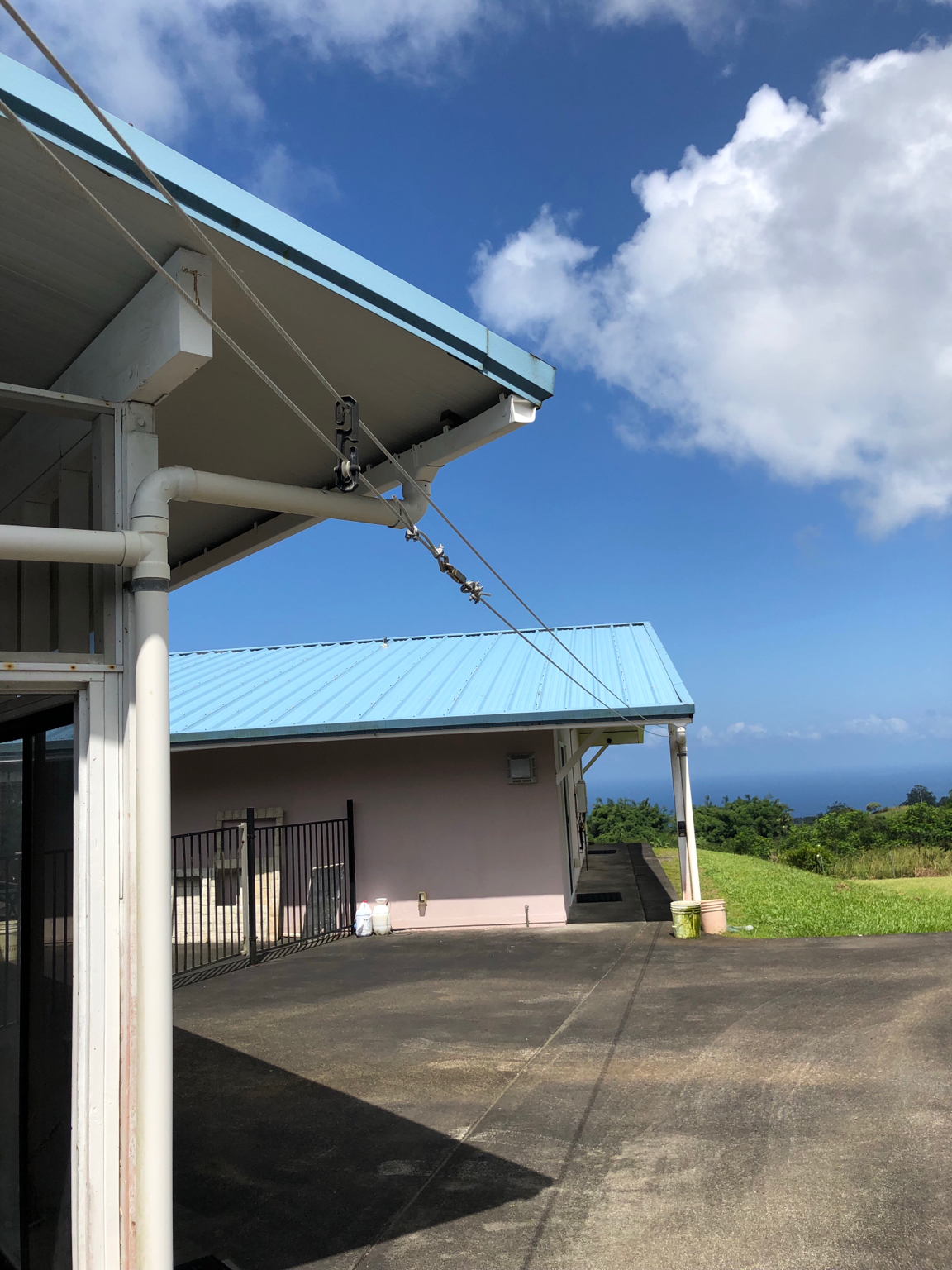

Have to replace the wife’s clothes line today, line broke yesterday. Somewhat anticipated event as it brought a couple months ago and I fixed by adjusting the line. I also bought new line, pulleys, and hardware in anticipation of today.

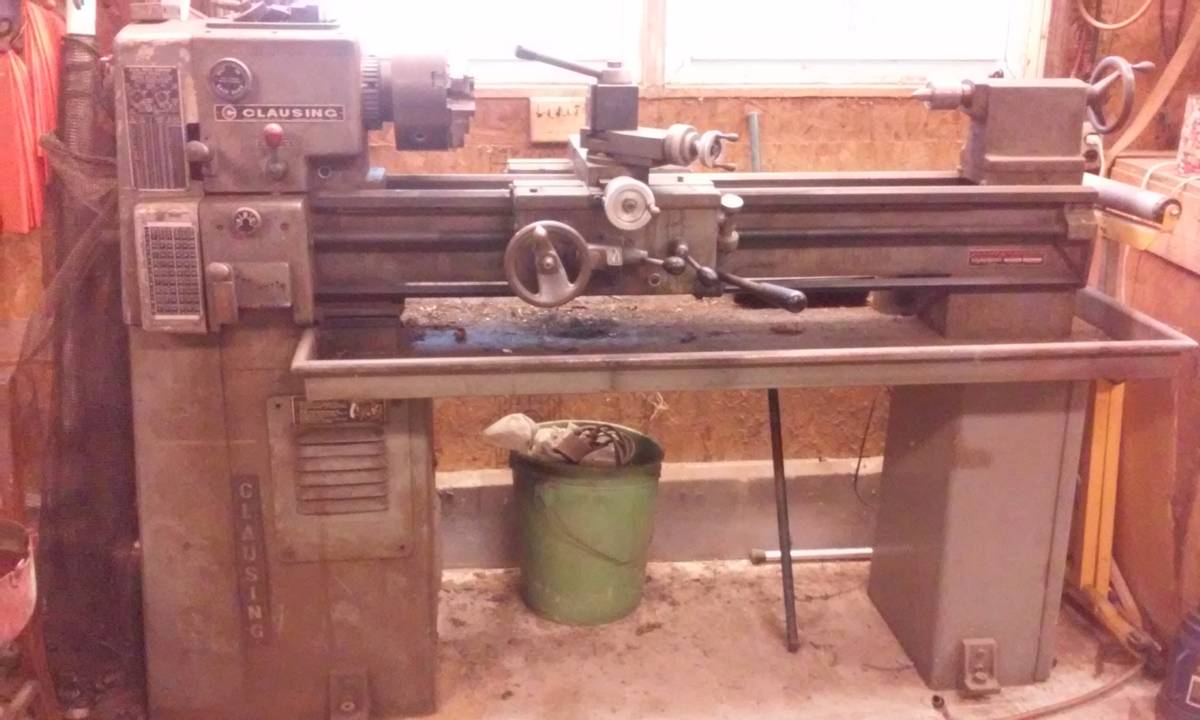

Kyle, found a clausing 12 x 36 about 2 1/2 hr away. Don't know how to link it but it is on Richmond Va Craigs List. It is located in Boydton Va. Any advice will be welcome. As close as I can tell it is a model 5914. Thanks Ed
/ Good morning!!!! #80,126
I'm not Kyle, and I didn't spend last night in a Holliday Inn Express, and I don't know much about the Clausing brand. Are they still in business, and can parts be purchased for this lathe? That's the number one question I ask about any potential Craig's List purchase. If the answer is NO, I keep looking.
12x36 is a good size, but it would be better if it had a removable gap in the bed to increase the swing. Can't tell looking at the picture, and there's no model number published, so it's hard to tell for sure.
Find out how the single phase conversion was made. How big is the motor, horsepower wise. Should be at least 2 HP on a machine that size.
Find out how the speed is changed. Is it through gearing, or is it a Variable Frequency Drive? It should have variable gearing regardless so you can cut threads, but a VFD is a convenient extra. If it's a gear change lathe, find out if they are changed by moving levers, or if you have to swap the individual gears in and out manually. If the latter, it's a messy and time consuming job.
It comes with a modern toolpost, which will be much more rigid than the old lantern types. Find out how many tool holders it comes with. You'll need at least three to take advantage of the quick change aspect of that post, and six would be better. They're not cheap if you have to buy them, so try to get them with the lathe. Cutter wise, replaceable inserts are inexpensive and last a long time. You'll need left and right cutters, a thread cutter, and a parting tool as a minimum. Bonus points for a boring bar holder and a knurling tool.
Does it come with a drill chuck for the tail stock? Again, expensive if you have to buy one. Extra points if it's keyless.
If you do go look at it, try to shake the chuck back and forth looking for runout on the spindle. If you have a dial indicator with a magnetic base, take it with you and measure the runout for yourself. You shouldn't feel ANY, and what you measure should be no more than 0.001".
Also test how much backlash is in the cross feed and compound. The less the better.
Does it have Digital Read Outs on the X and Y axis? It should at that price. You can deal with a lot of slop in the backlash with DROs, but with dials it's a PITA. Excessive backlash also compromises stiffness, and that means you have to take lighter cuts to avoid chatter.
Nice accessories are a milling attachment and a taper attachment. Ask about those.
I'd start by sending the seller an email to get the model number of the lathe, then do some research to find out how well they are supported. If the answers come back good, call and talk to them about the above questions. It could be you're dealing with an estate sale, and the seller won't know much about the machine. But if you end up talking to an old guy that's shutting down his shop, you might have just hit a gold mine of information and other goodies he's trying to get rid of. Try to get as many accessories and bar stock as you can; enough and it could be worth the asking price.
$.02, and good luck!

That lathe looks a lot like my Craftsman/Atlas. But newer. I was able to get parts for mine that is over 60 years from Clausing.

Thanks RNG, Good info. The guy is a retired gunsmith and is letting everything he has go with it. It has a VFD and a pulley with sides that move in and out to adjust the spindle speed. There is a gear box to adjust carriage and cross slide feeds. Yes the price is high but not for this area. Here a junk lathe the same size that looks like it was in most of the battles of WW2 for $1500. In talking to the guy the only thing I think I might need to buy is a face plate. If you see anything else I need to think about please let me know. Ed
It looks a bit over priced to me, depending on tooling. He didn't show any pictures other than the one. RNG summed it up well. Look for major wear on the ways just under where a part would be sticking out of the chuck. Grip the tool post tightly and give it a manly tug in both axes.
Being patient and buying tooling on ebay is the cheapest way to get tooled up.
Clausing is a great brand name. I like their Colchester versions. It looks like a good size and fit. When you are testing any lathe, run the all the gears, make sure the threading gears work. Parts is another story. Unless you buy late model Taiwan style lathes, it is a crap shoot on most older models. If a lathe is ran properly and not crashed, it is a rare day to need parts. I would say the electrics/switches would be the parts you might need.
Clausing is a great brand name. I like their It looks like a good size and fit. When you are testing any lathe, run the all the gears, make sure the threading gears work. Parts is another story. Unless you buy late model Taiwan style lathes, it is a crap shoot on most older models. If a lathe is ran properly and not crashed, it is a rare day to need parts. I would say the electrics/switches would be the parts you might need.
Thanks guys, planning to ride down and take a look Tuesday morning early. Be there by 8 am and home by 12am. I hope. Ed

While not a major project, a satisfying one to get done.
Upgrade to 1/4” vinyl coated SS cable and all SS hardware except the plastic pulleys. Should last at least my lifetime. The 1/8” vinyl coated non SS cable lasted 11 years. IMG_0827.JPG

Ed, you wanted advise. Well, if you drive for 2 hours, only to find the lathe is rubbish, remember the guy was a gunsmith and probably still has a few guns around, so be very polite. :D
David, that is a deluxe setup for a washing line :thumbsup:
That reminds me, I still need to tie a bright orange marker to our line. The one it replaced had only been up a couple of years and wouldn't have lasted any longer in SS - a friend drove his tractor into it - his loader won.
Upgrade to 1/4” vinyl coated SS cable and all SS hardware except the plastic pulleys. Should last at least my lifetime. The 1/8” vinyl coated non SS cable lasted 11 years. View attachment 566493
