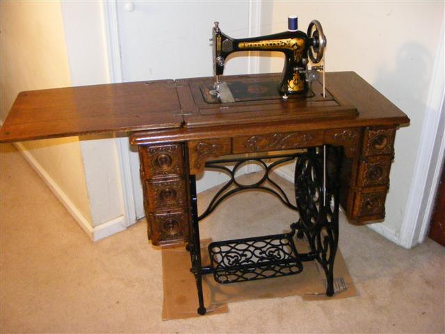

I think we've got three or four sewing machines here - including a Kenmore serger I bought for the woman, two from our respective mothers, and a very old Singer that was my Grandma's - pedal-operated originally, converted to electric ... still have the treadle stand for it ... looks like kinda like this:
attachment.php
... wife doesn't seem too inclined to use any of them :rolleyes:

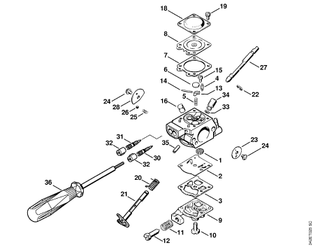

Similar thing happened to me when I rebuilt the carb on the old chainsaw, RS. Except mine was spitting back through the air cleaner. Turns out I'd left out one of the gaskets in the stack that is built up on one end of the carb. Found that out by closely (as in with a magnifying glass) looking at the diagram the dealer was kind enough to provide with the gasket kit. All the gaskets in the stack, and I think there were three of them, are the same size on the outside, but all have subtle differences on where holes are located to allow fuel to pass. Those darn holes have to be oriented properly, and the gaskets assembled in the correct order, or fuel goes everywhere it's not supposed to. And yes, I'd carefully disassembled the original, and taken photos, but I wasn't careful enough.
Might merit a look ... I still have the old gaskets/diaphragms, which are stuck together ... I guess it's possible that there could be something in the "sandwiches" that I missed ... but ...
I also have a PDF of the Walbro documentation for the carb (WT 45 A) - which includes a labeled, exploded-view ... problem is, that this particular carb comes in various versions, specific to the application it was going to be used on. So not everything listed in the diagram is applicable to the carb I have (for instance, the carb can come with a primer bulb ... or not ...)
Kinda the same deal with the rebuild kit (K10-WAT) ... lotsa "extra" stuff in there ... including gaskets and diaphragms. Probably fits more than one model.
The PDF does mention a small gauge (Walbro p/n 500-13) that is used to set the height of the lever that controls the needle ... that might worth exploring.
This an image of a carb off an FS40 ... which appears to be identical to the one I have:
428816-good-morning-2012-08-30_010604_fs40_carb-png
Based on the above image, I do have it assembled correctly, with the gaskets and diaphragms in the proper order/orientation, with nothing missing or extra.
I also remember taking the carb with me to the dealer, and it was a good thing I did. It turned out, at least in this case, that Stihl used two different carbs on the same saw, so the parts man avoided having to guess.
