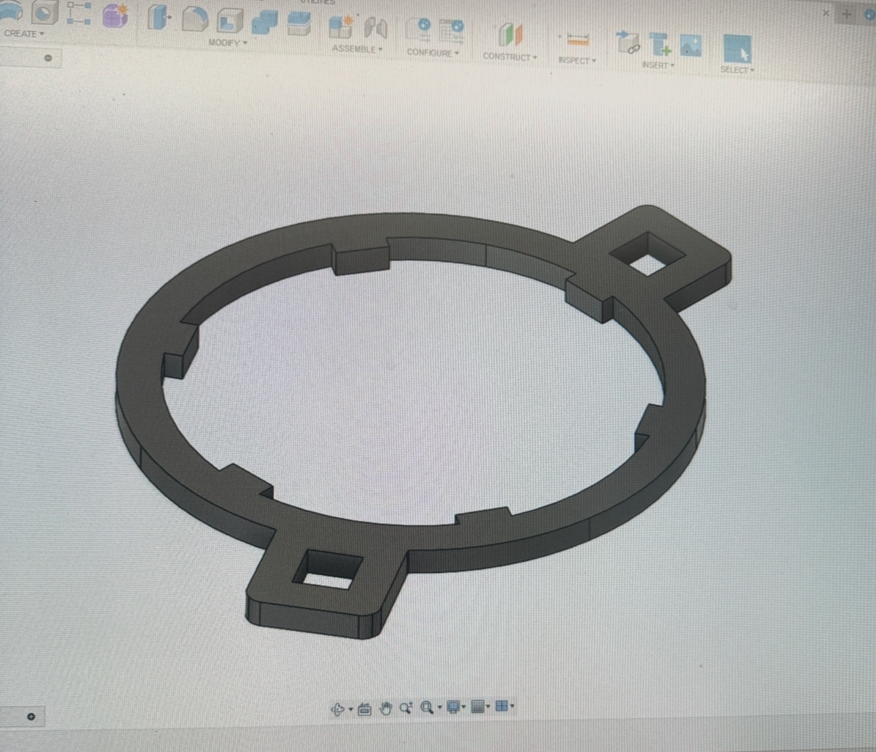

My RO has a unique flimsy plastic wrench that I have broken a couple of before I switched to using a strap wrench with a longer metal drive.
(y)

I modeled one and cut it out on the plasma table. Since then, I’ve made about a dozen of them for friends. The square openings fit a 1/2” drive ratchet or breaker bar.
(y)
I'd be happy to pony up for one of those if they are available ... ;)
