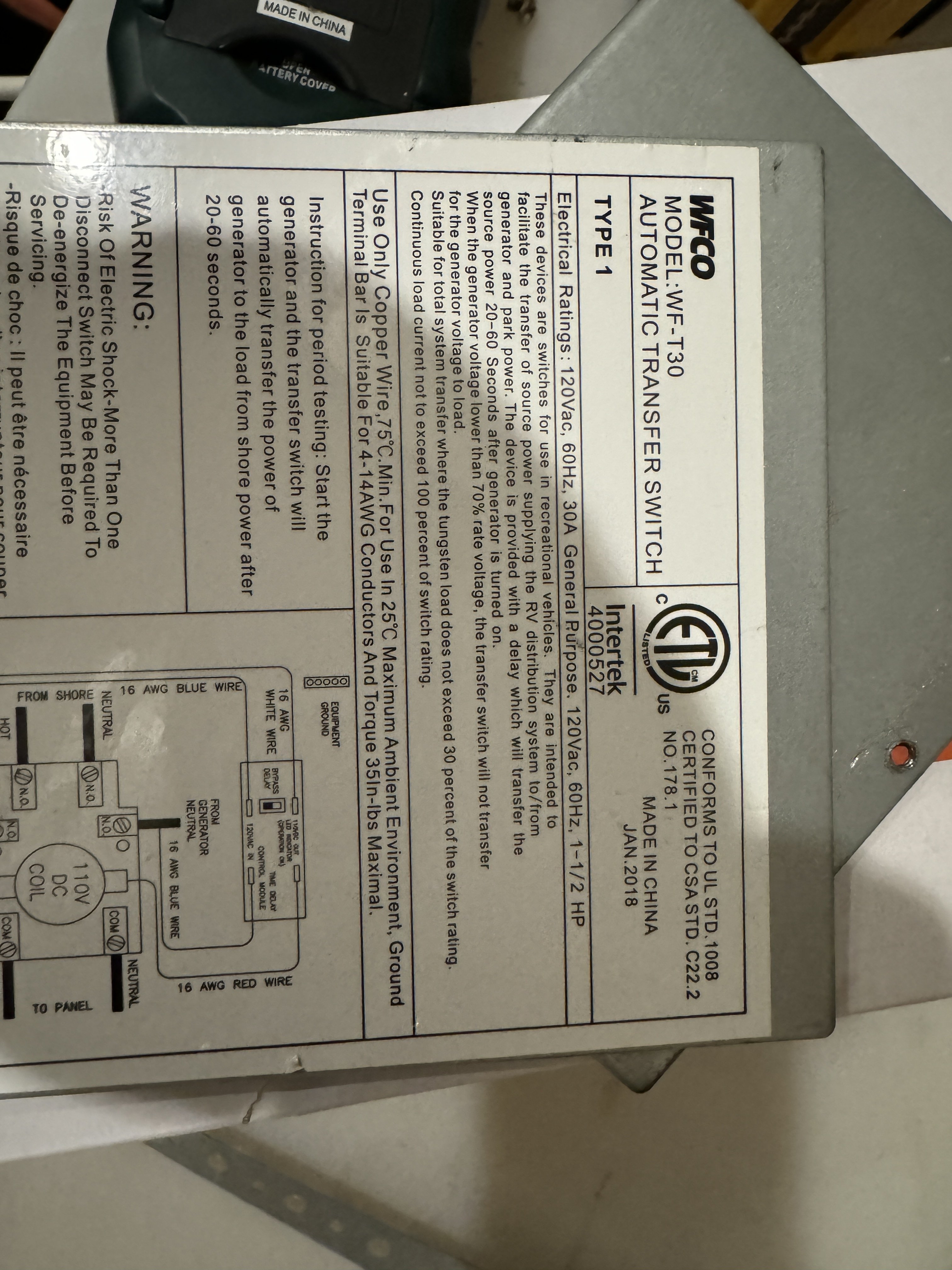

this is the transfer switch that someone incompetently installed.
Furrion makes one, thirty bucks more expensive, if I was buying a used rv, I think I would like to see a name brand.
One with a proper connection panel in the rear that doesn't require two wires butted together. When I saw that solid power cable wrapped with a lighter gauge of stranded, held together with a charred plastic twist nut, I just knew this totally failed the sniff test. Now if they had soldered it together, fine, and finish it nicely. This was a 2019 build, pre covid I think.
This switch may be fine, could have been installed properly to avoid this entirely. Instead I had a black charred mess under my bed.
that surely is not good. :rolleyes:
and for an ah-hah moment, remember when I said my campground breaker popped twice and I had to turn off the electric hot water heater?
when I turned on the hot water heater that new higher load did in what was left of those two loose wires touching each other, and a toaster was born.
don't understand why I didn't smell it. We did only after we opened the box. I guess sealed pretty well but usually that stink gets around
I'd like to find a US made automatic transfer switch, wonder if it even exists for this type of application. 30amp. would be better if choice of automatic and manual
maybe one of you EE's could recommend one

Drew, glad they found issue. Not fun sleeping on toaster.
