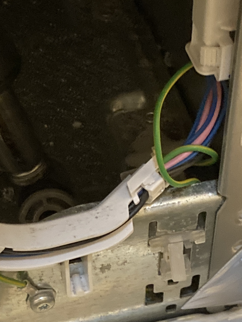

Tried to wash a load now the washer keeps tripping the breaker. Tried another plug, same thing. I did not touch anything electrical, a mystery.
Check to make sure the washer drum moves freely. Maybe something got stuck.
My son and his guitar picks always seem to find ways into cracks.

Thanks Ken, I found the problem. lower right in this pic is a safety switch which just missed the stop on the front lower panel. I must have been just a 1/16th" off when I put it on and it was not depressed (flat piece of metal at an angle by the switch is the front panel plate that is suppose to depress it). I put some duct tape on it and the washer is working fine now.
   / Good morning!!!! #160,653
Watch that Green/Yellow wire, looks like it is up against sharp metal.
Good find when the cost is only time !

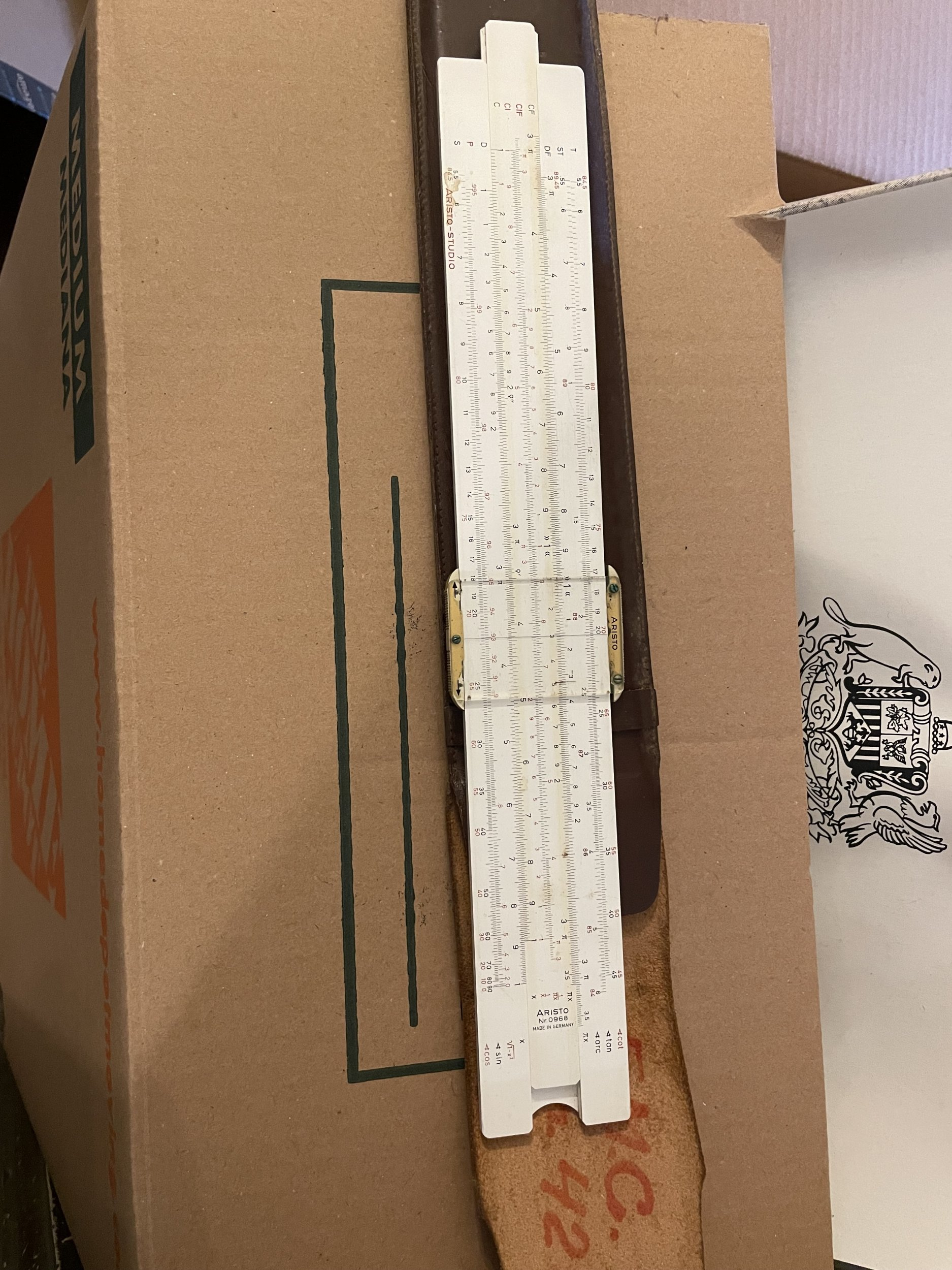

I found my old sliderule. I think I got it in 1962 and used it until 1968 or so when my company gave me a 1000 dollar HP calculator.That was a lot of money and I could not afford that.
