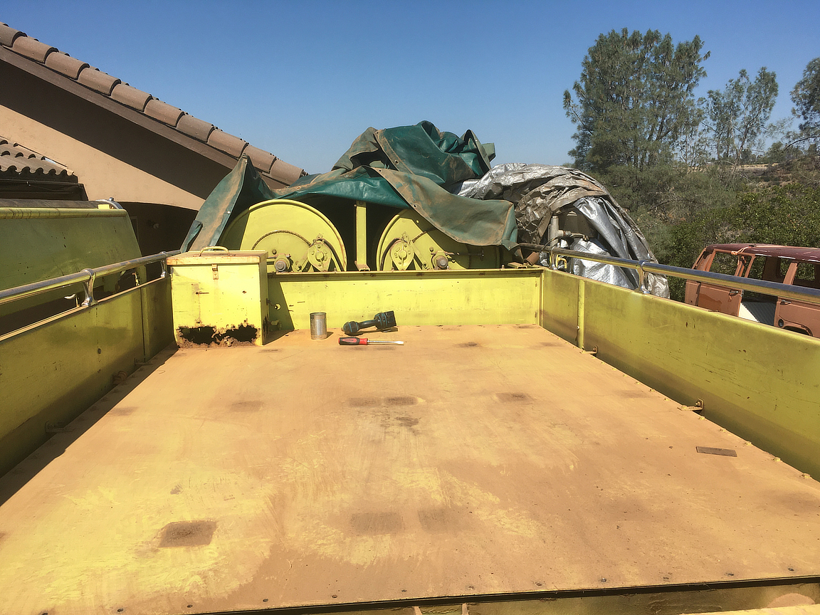

Here are a few shots of the work on the firetruck tank.
First, the lid to the tank with the oak decking removed and most of the bolts out.

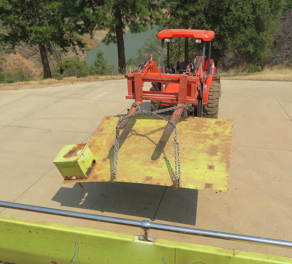

Broke it loose all the way around and propped it apart with small wooden blocks. Used C clamps to make chain hangers, slipped 'em over the forks, and upsie daisy...

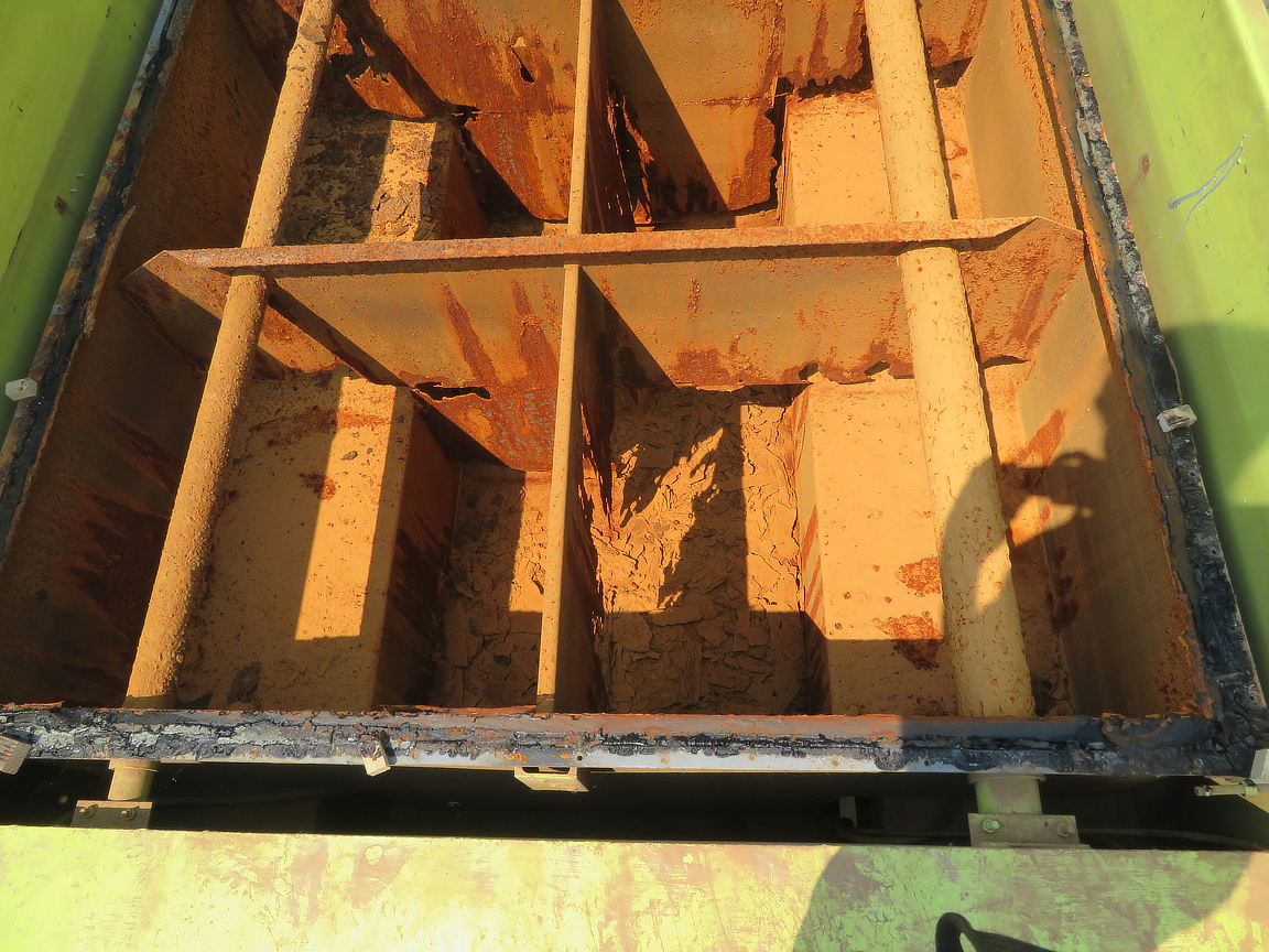

The tank is divided into six compartments by steel baffles, and big chunks of them had rusted out and deposited on the bottom. These are the two rearmost compartments.

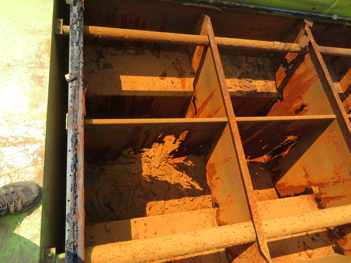

These are the front two, where the pump pickup is located. It's buried under about 6" of debris.
I got three five gallon buckets of rust out this morning before it got too hot to work. That cleared four of the compartments. I think tomorrow I'll cut out what's left of the baffles, and clear out the rest of what's on the bottom. Then the really nasty part: wire brushing all the surfaces down to bare metal in preparation for some sort of coating. I'll also need to weld in stiffeners that run crosswise across the tank to replace what the baffles once did. I don't care about sloshing because I don't intend to move the truck when it's got water in it. And if I can locate a draft hose, it won't be stored with water in it, either.

RNG nice work on getting the top off. I can see why you wanted to clean out bottom of tank.
