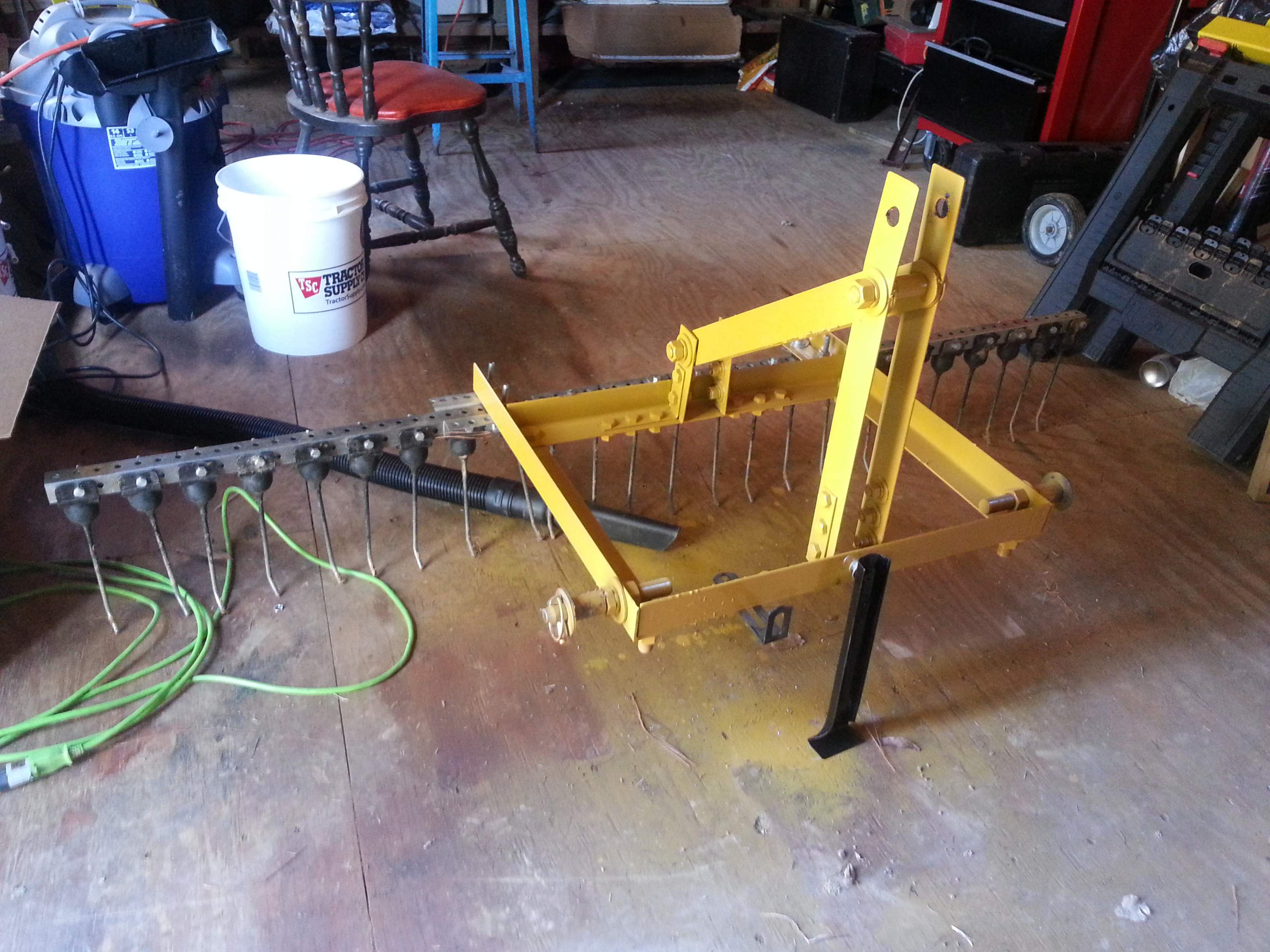

Here's a rough idea of what I meant - also, whenever I try to get TWO pieces of tubing to go into TWO separate sockets while welded to a third piece, if I'm lucky it only takes an 8 pound hammer to get 'em to cooperate - so I've taken to making ONE of the two as a "slipper tee" whenever possible - this gives just enough slop so it fits without giving you fits :D
If anyone didn't get that last part, I'll go take a pic of one of my current project parts to illustrate... Steve

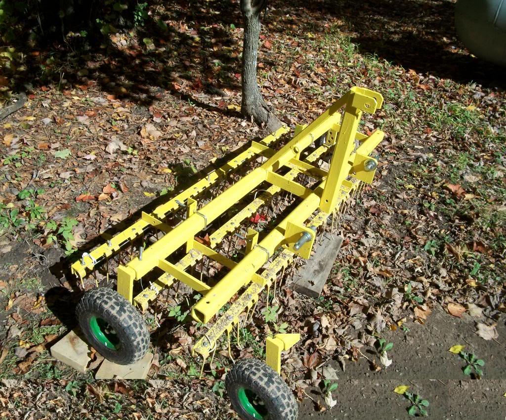

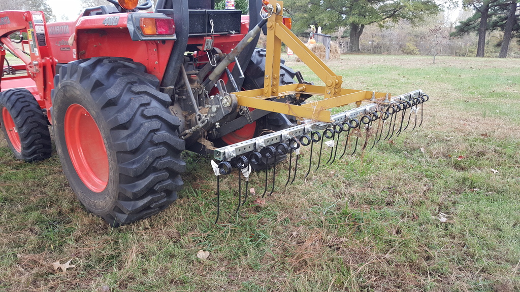

Finally got my 3-point hitch painted and a stand put on my rake.

   / Good landscape rake - cheap (Part 2 - Daver1963's attempt) #24
I have one I made that's similar, and found it does a great job of cleaning up debris. This should give you good service.

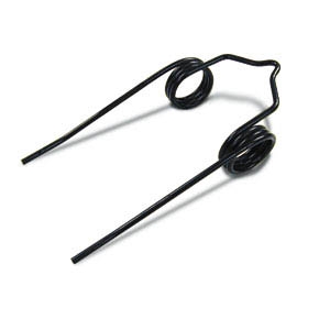

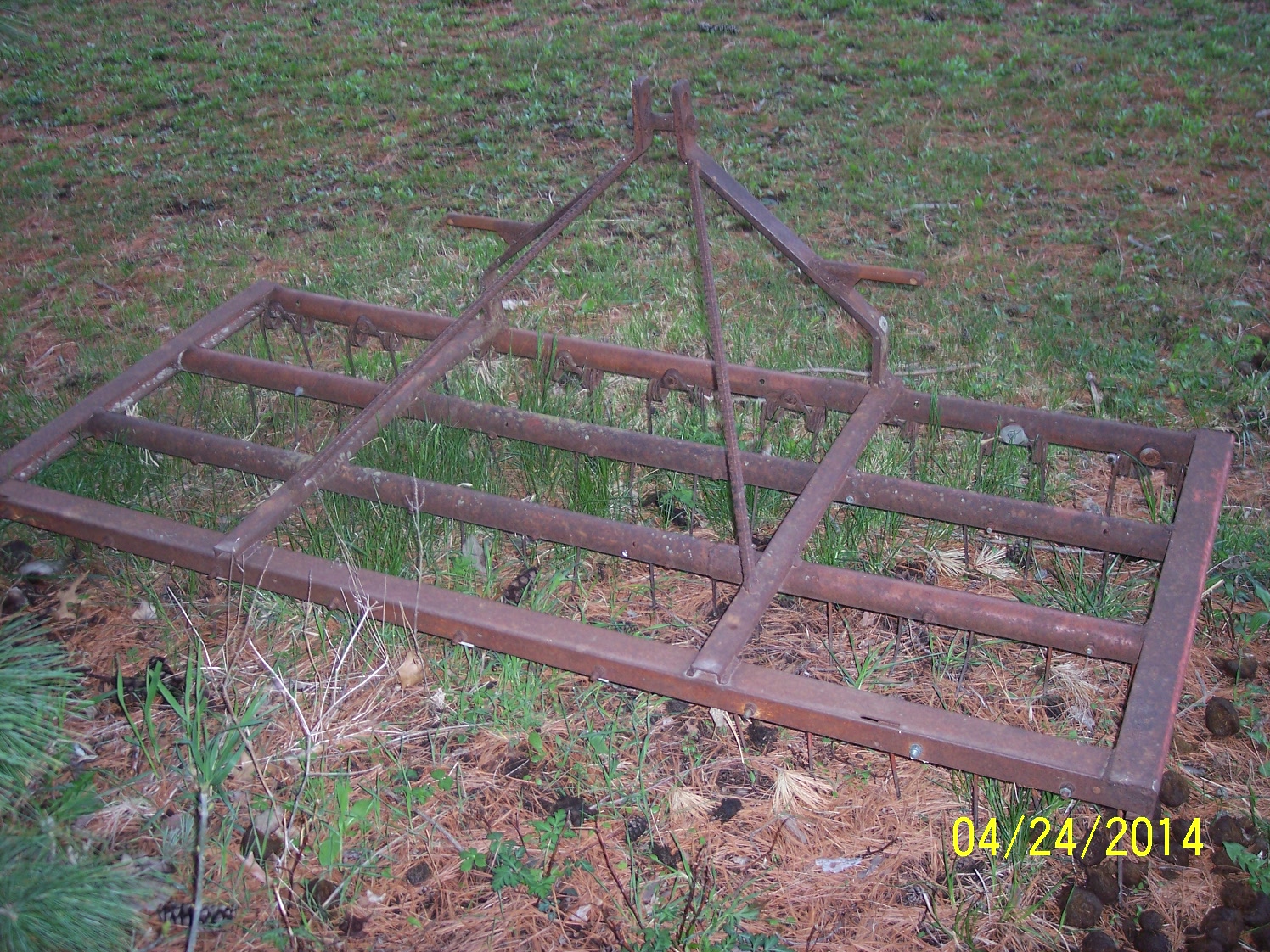

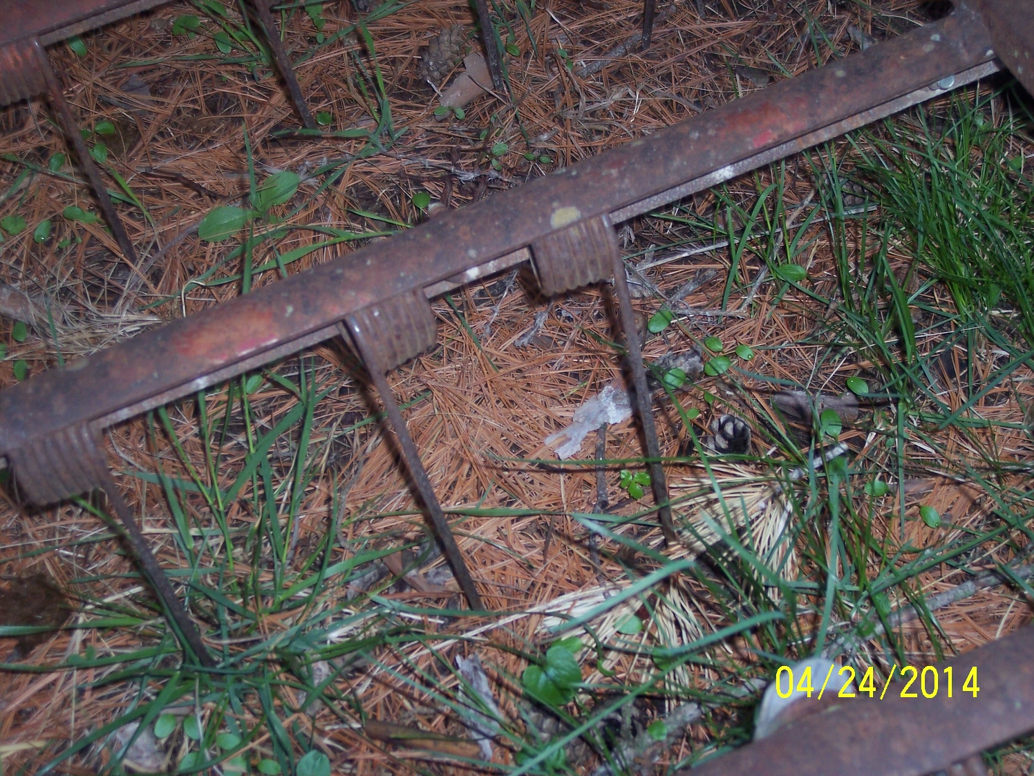

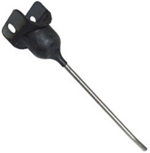

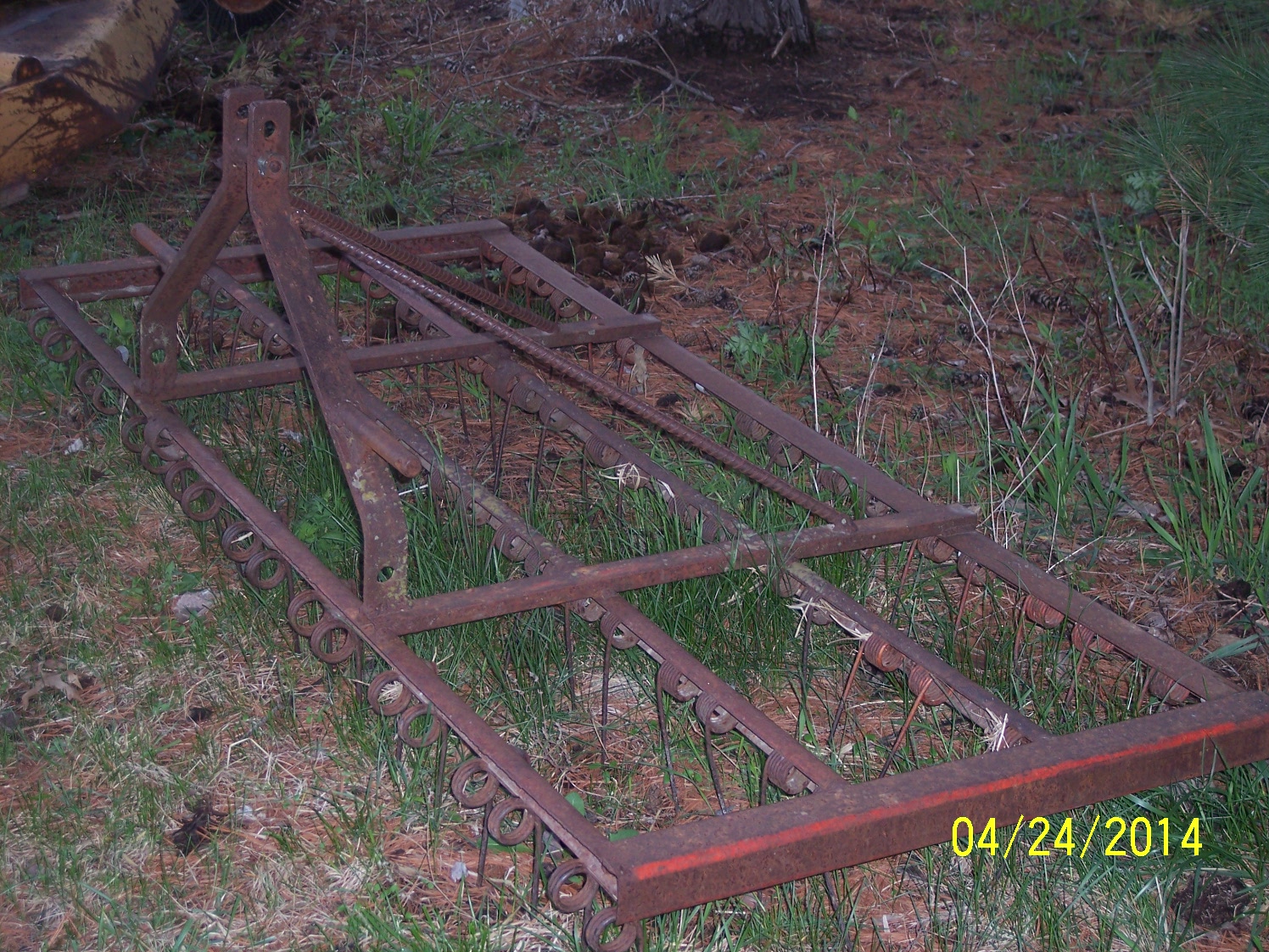

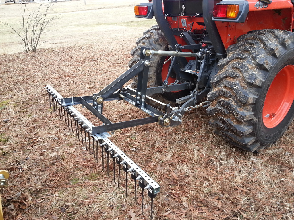

I decided that the single tines with the rubber between the cup and the tine was bending too much. I changed them out for the double tine rake teeth.
Went from this: 20140218_155847_zpshc6fvkqo.jpg
To this: 20151115_152227_zpsqyva95ye.jpg
I raked some today and it seems like it is doing better. Now I just need to fabricate something to attach to the front end loader to pick up the piles of pine needles better.
