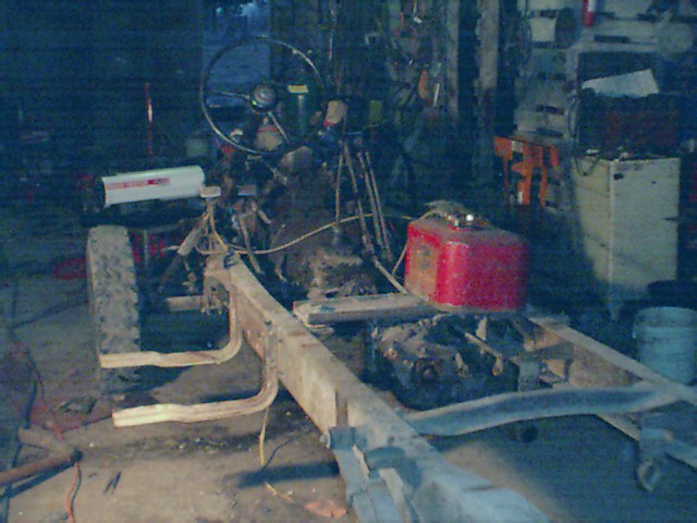

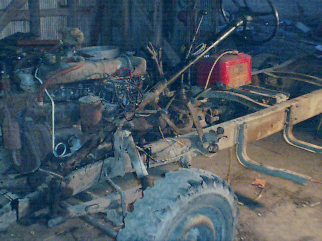

Well I scrapped the ford power plant idea because it was to wide.I got this IHC 3/4 ton 4x4 with good six cylinder ,4 speed and transfer case and axles. I have to shorten the frame and driveshaft.I hope the rear driveshaft will hold up ,it'll only be 20" long between U joints and it'll have to run in a pretty good angle. I drove it in standing on the frame and running off a boat gas tank. This is a 57 model and the axles are real heavy,especially the rear one.It has single wheels on it,but I have a set of dual wheels for the back when it is finished.

Heres another view.

</font><font color="blue" class="small">( I drove it in standing on the frame )</font>
Now then - THAT is what I would like to see a picture of... /forums/images/graemlins/shocked.gif
