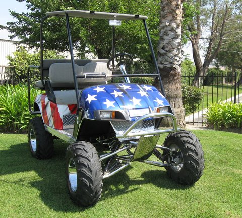

I had an EZGO RXV Electric 48 Volt cart. Added a 3-inch lift kit 10-inch wheels 22-inch ties. Great run-around cart. Sold it and purchased a used 2011 Gas EZGO RXV 14 HP Kawasaki engine that is indestructible if maintained. I prefer the gas model for my uses. It sips gas. 5 Gal tank lasts months. The Battery cart was a pain to keep plugged in all of the time. If you want your expensive lead acid batteries to last, do not go below 50 percent state of charge and plug it in after every use. Found a good chart that shows how long batteries last based on how far they are discharged (Charge cycles) a fully charges 12-volt battery should be 12.7 volts. So a 48V cart should be 50.8 volts when fully charged. If not you have a faulty battery. Probably someone hooked up a 12V accessory/lights to one of the batteries and it will only fully charge if you hook a 12V charger to it by itself. No need to disconnect from the pack. Some suggest if you have a 48V cart that if you replace batteries, go with 6 8Volt batteries for more range. Here is the gasser, looks the same as the electric one I sold a few years ago.
I'm not even going to try getting on that cart. :)

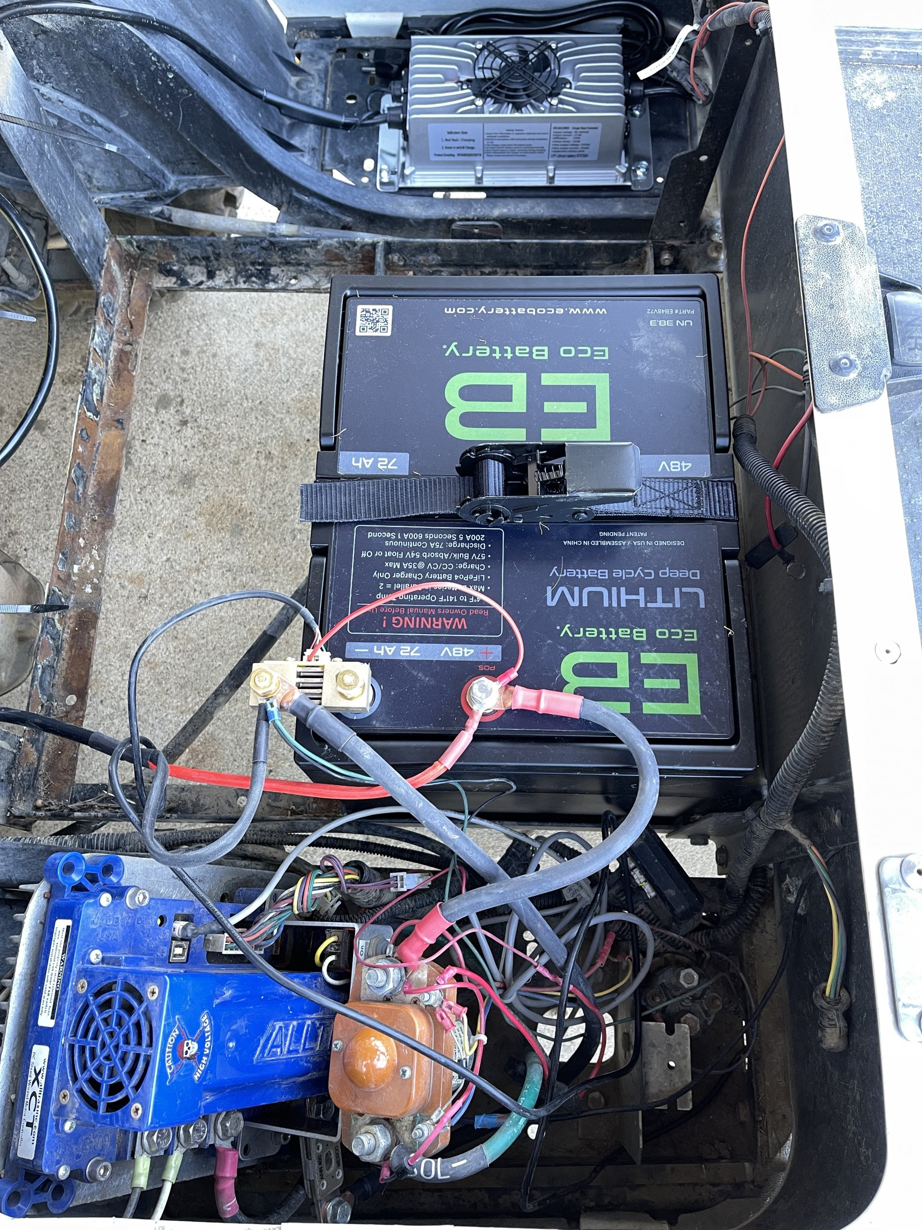

You are absolutely right about sticking with the big 3. These three have been producing carts for 30+ years. CC has an aluminum frame. That's good if you live in the rust belt. Personally I like Ezgo the best. Best ride, best throttle mechanism, easiest to work on. Currently we are running a couple of Ezgos. I just put a single lithium battery in one today. That makes 2 converted to a single lithium battery with on board charger.
Why you ask?
1st = no watering the batteries. I'm always too busy or forget to keep up with this like I should.
2nd = since the battery is sealed there is no mess and no corroded connections to keep after.
3rd = the warranty is 8-10 years Of course the cost is double+ but it sounds like we will get our money's worth of use from them.
4th = a little higher voltage like 51 or 56 volts versus 48 so that means more power and speed. Nothing crazy but I do like things zippy.
5th = 300 pounds. That's how much lead weight the cart lost = about 1/3 of the total cart weight
6th = longer runtime than wet cell batteries and quicker charging.
Here is a pic of the install today... and my helper Keegan
