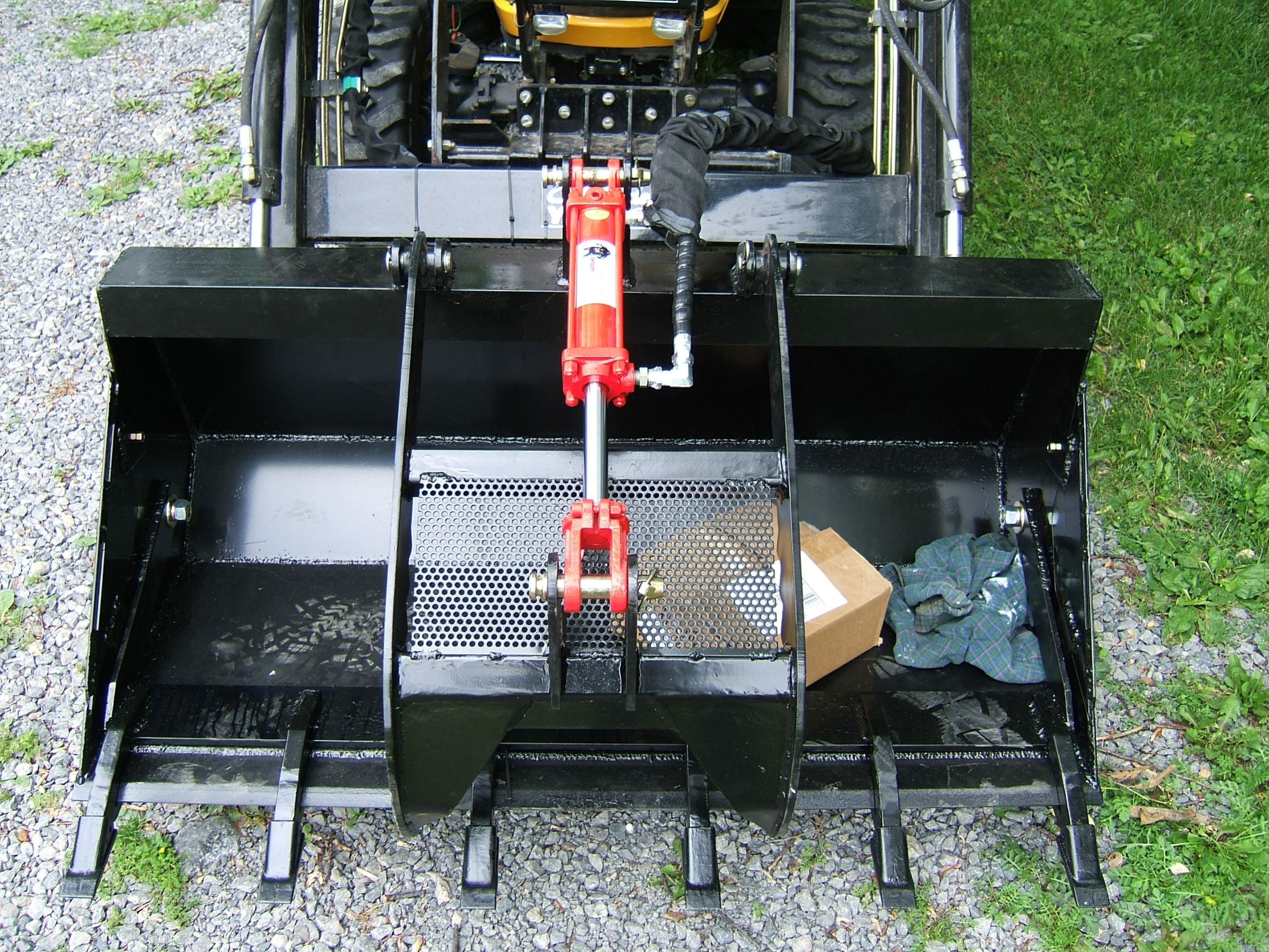

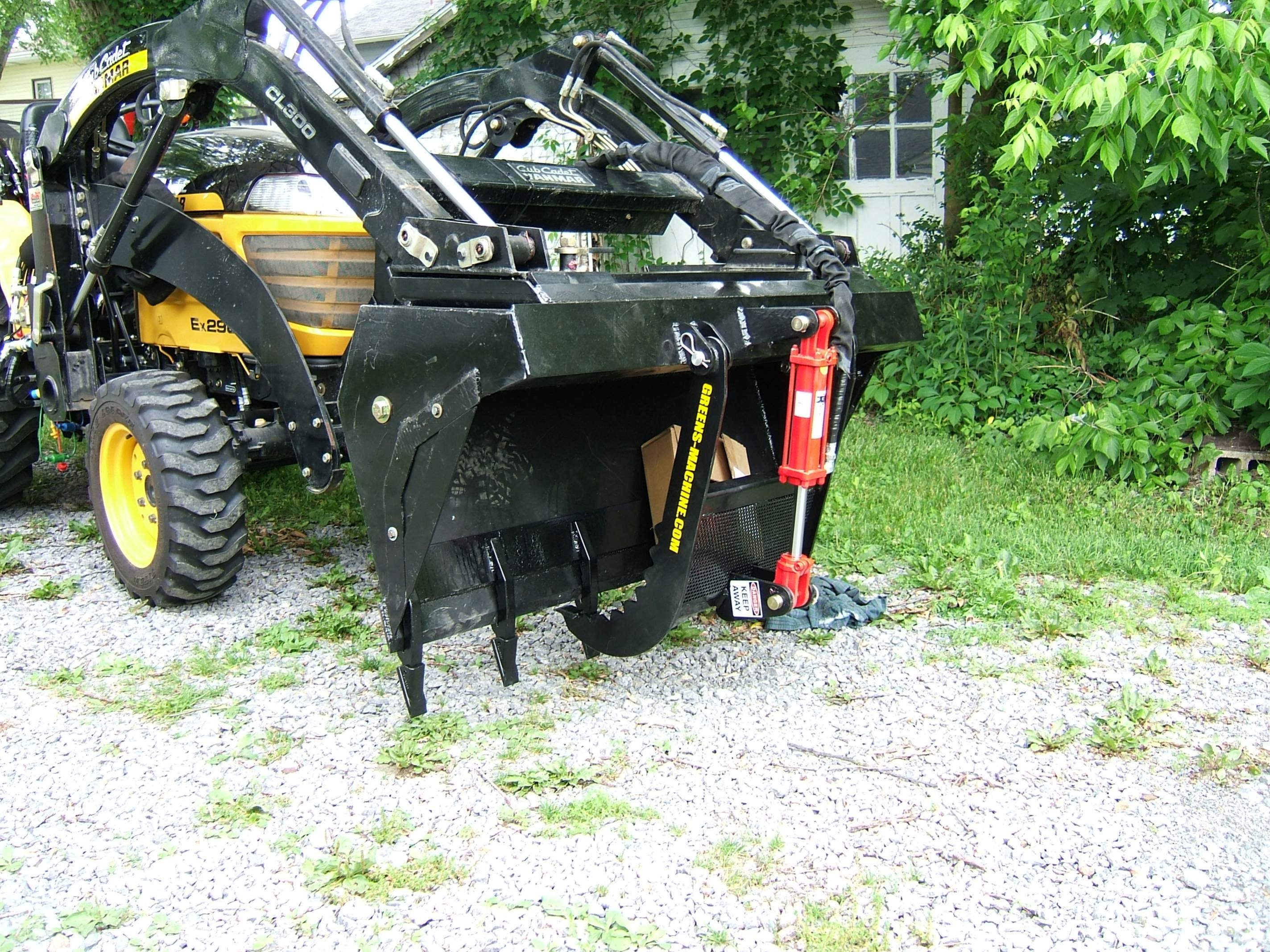

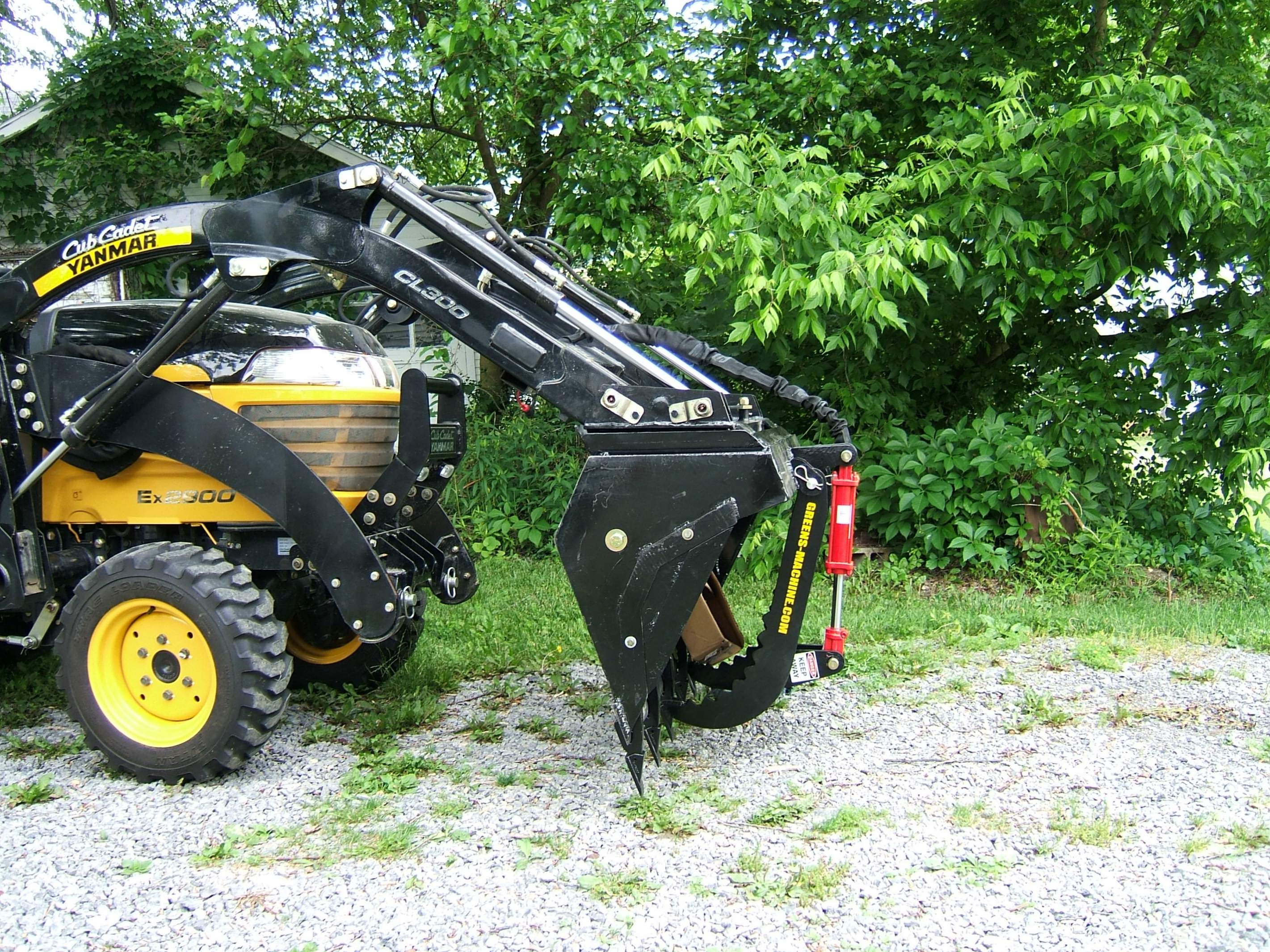

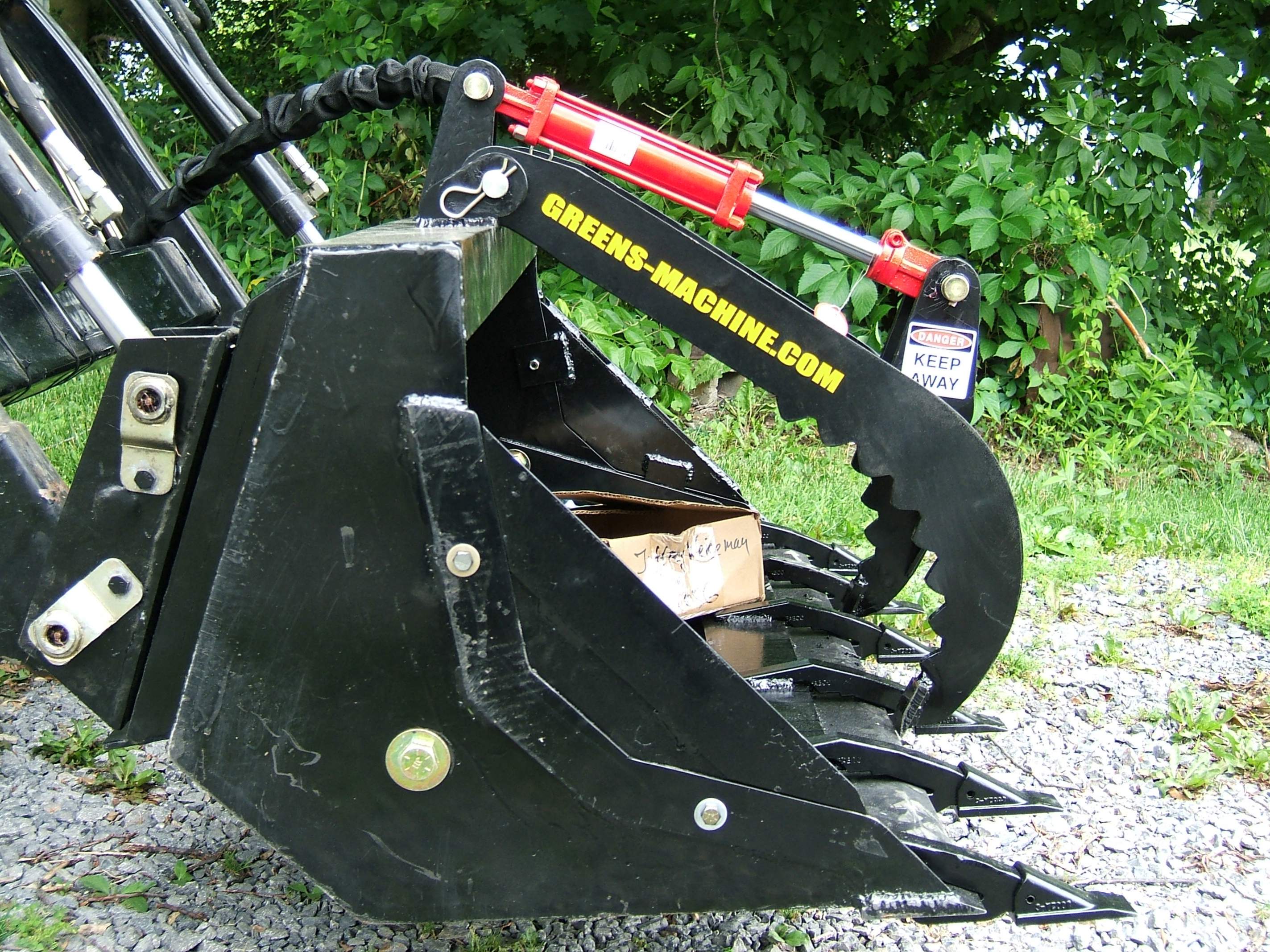

Nice looking machine, I think it looks like this;
8719
I added a grapple to my bucket, do a search for "GrappleOmatic' .
www.greensmachine.com sells the major components.
/ Going to build a Grapple Bucket! #4
Thanks Artisan, your BX "GrappleOmatic" build is awsome. That's exactly what I'm going for ultimatetly. Thanks for the link to the "Greensmachine" grapple. I originally thought about building a grapple for the bucket I'm building, but once I saw their grapples and calculating the cost of the materials I would need, it is definatley cheaper to buy from them, Thank You!

Keep monitoring my thread. Things are going to get interesting next week. I struggled with building a bucket like you are doing vs a root grapple setup because I liked your lower weight design. I ultimately went with my style as I am in need of a bucket to sort material and I figured I could add a grate to the bottom of my design for that purpose. I may even add a land leveler attachment to it like they have for skid steers. I could pin it off / on in just a few seconds and it would replace a land plane and material sorter. :)
Regarding the 1026r, it was the best tractor in its class by far. I should have got a mini ex instead of the backhoe though but it beats a shovel by a long shot!

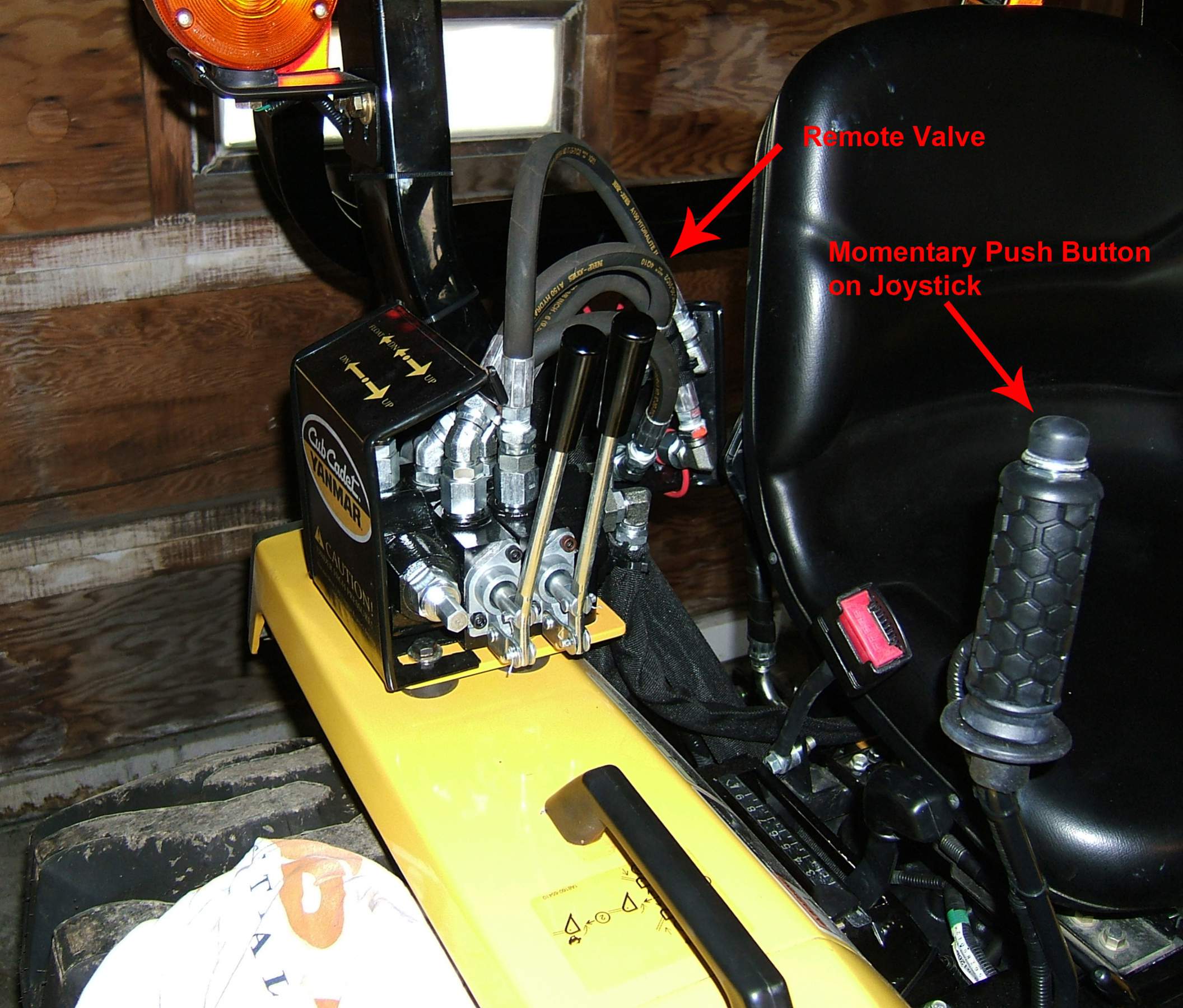

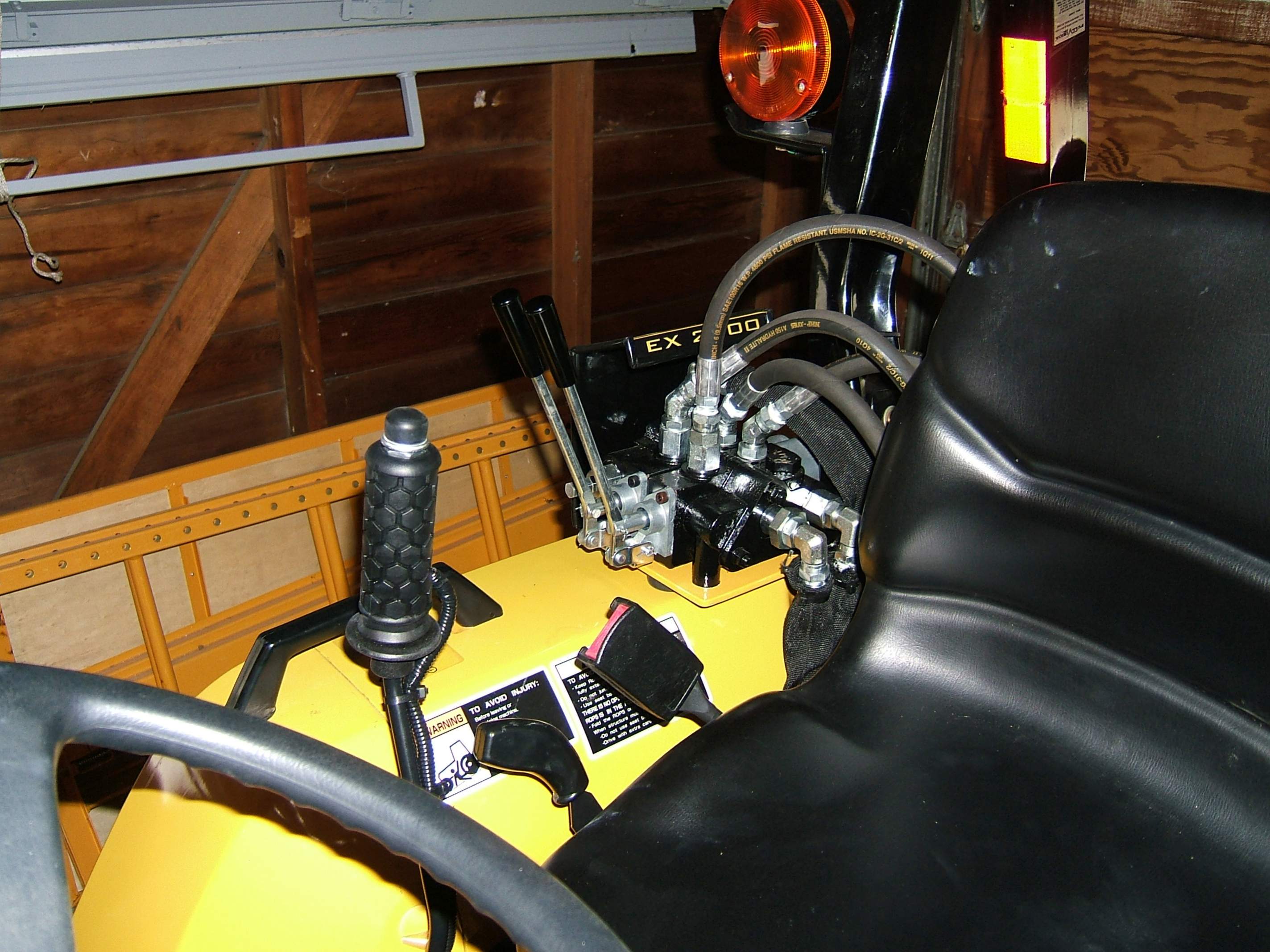

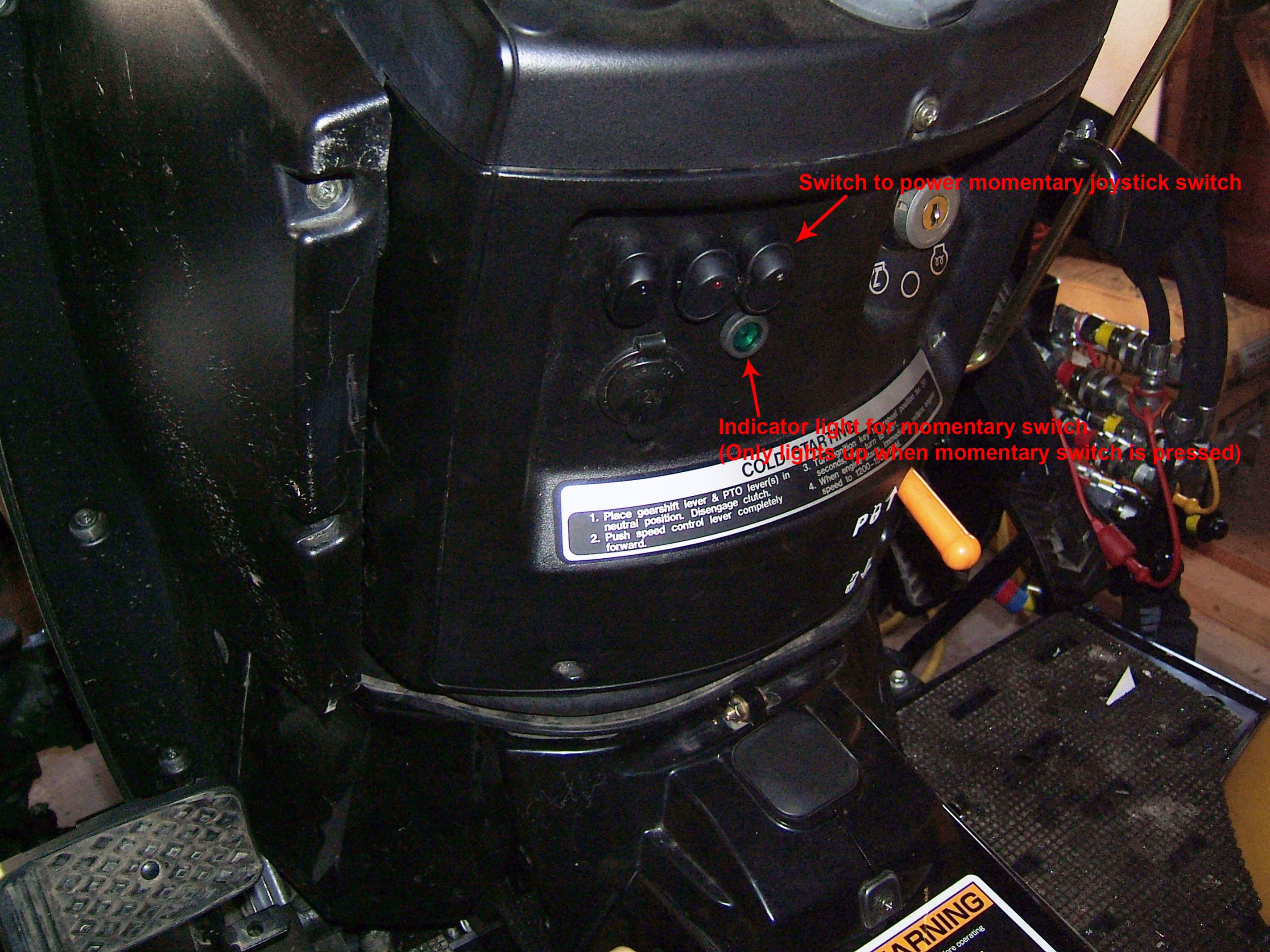

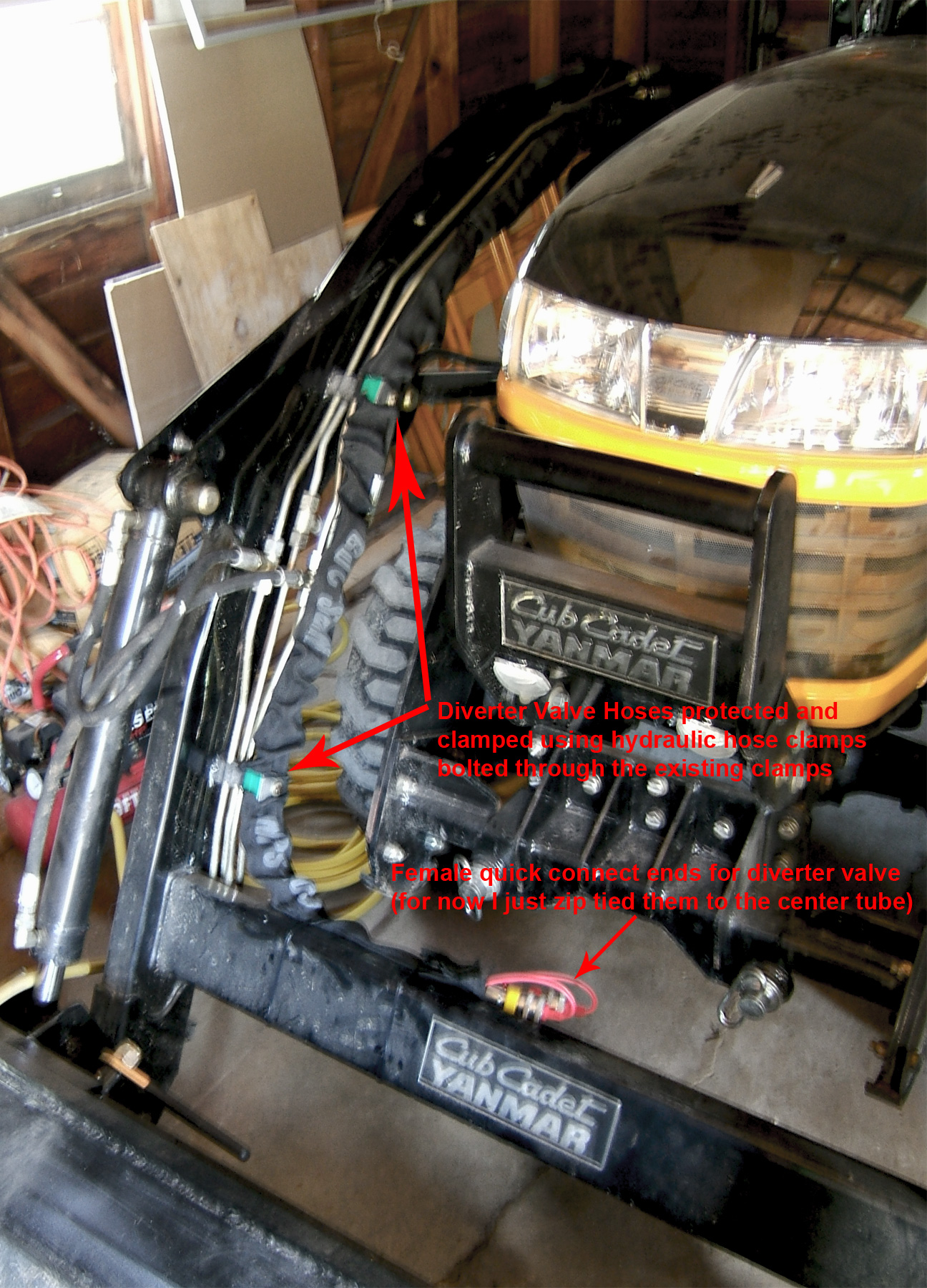

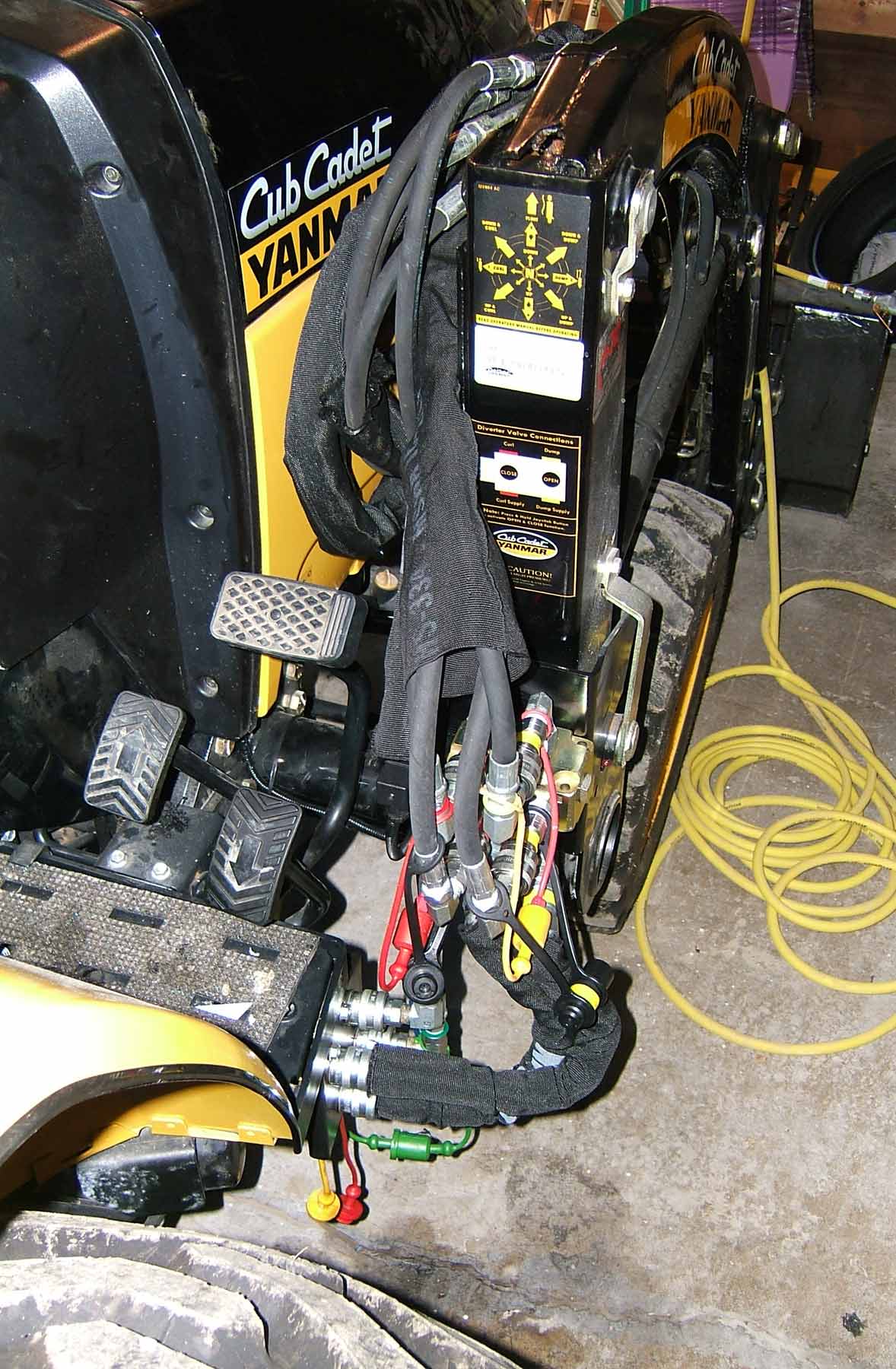

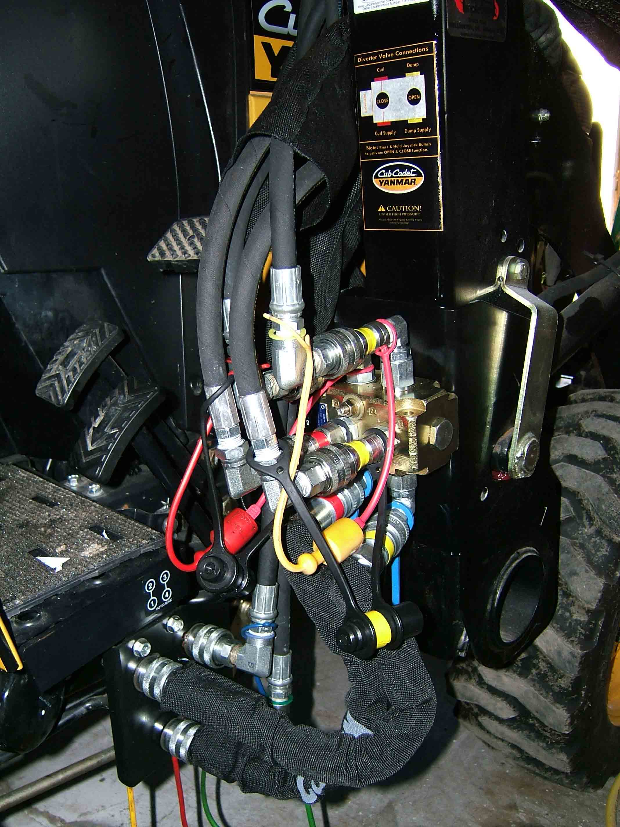

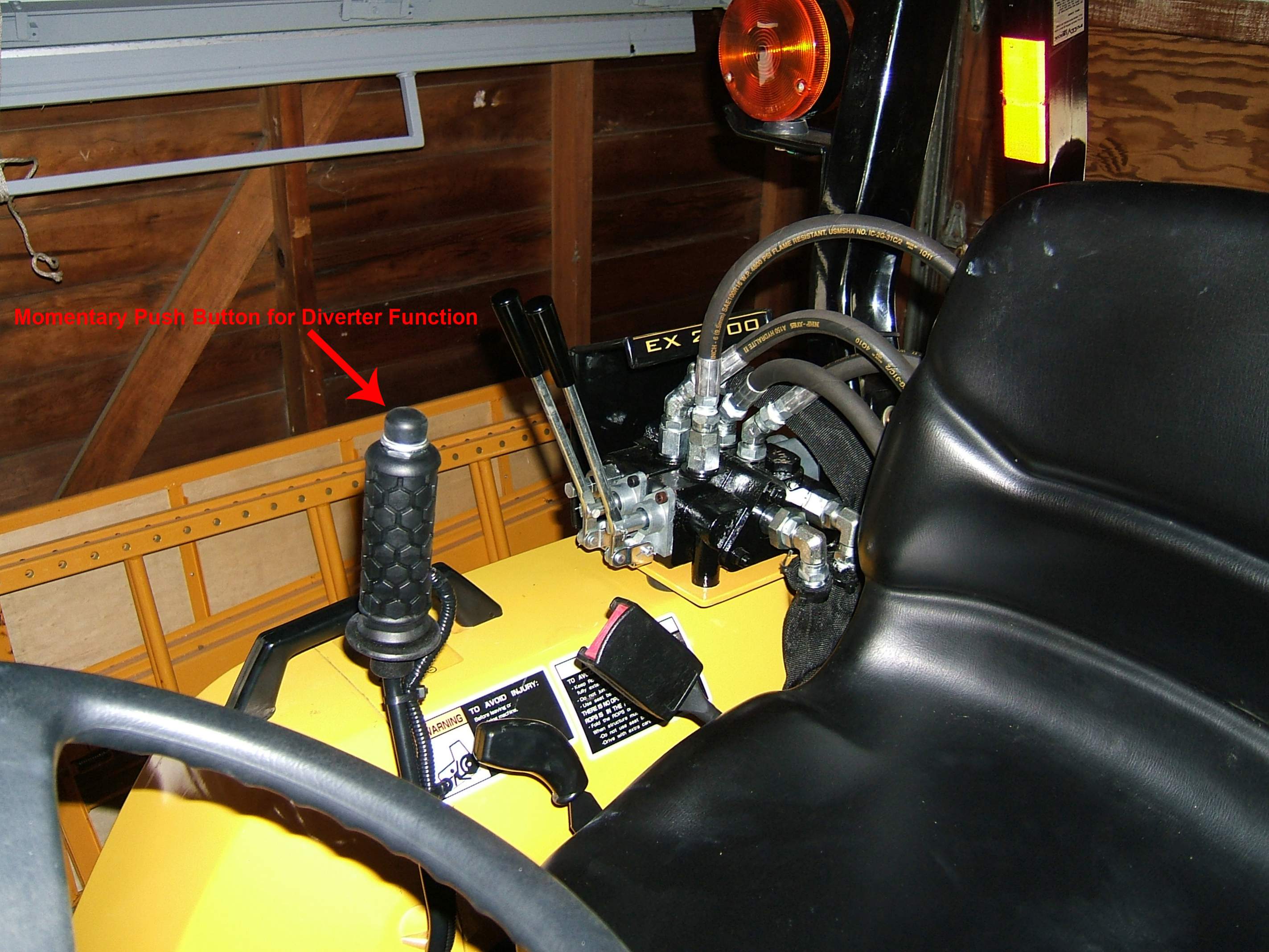

Here's some pic's of my diverter valve all setup on my Ex2900! :D
Diverter Valve.jpgDiverter Valve 2.jpgHose-Routing-and-Terminating.jpgJoystich View.jpgMomentary-Push-Button.jpgMomentary-Push-Button-and-Remote-Valve-View.jpgSwitch-Layout-for-Diverter.jpg

I am wondering if there is a reason you are using a diverter valve. My loader valve has a power beyond port that allowed me to add a valve to the circuit. The valve I bought from Surplus Center also has a power beyond port which runs to the 3PH.
#11
Thanks for the input Dana! The reason I chose to use the diverter valve is mostly convenience. I had previously installed two "remote" ports on my tractor and I used the power beyond port from the loader valve to power those (checkout pics). I thought about just using one of my remotes to power a grapple, but when I thought about it, trying to reach from FEL joystick and grabbing the Remote joystick, I thought could become cumbersome for me. So I just decided to put the diverter valve on and plumbed it through my Dump & Curl circuit with a momentary switch on the FEL joystick.

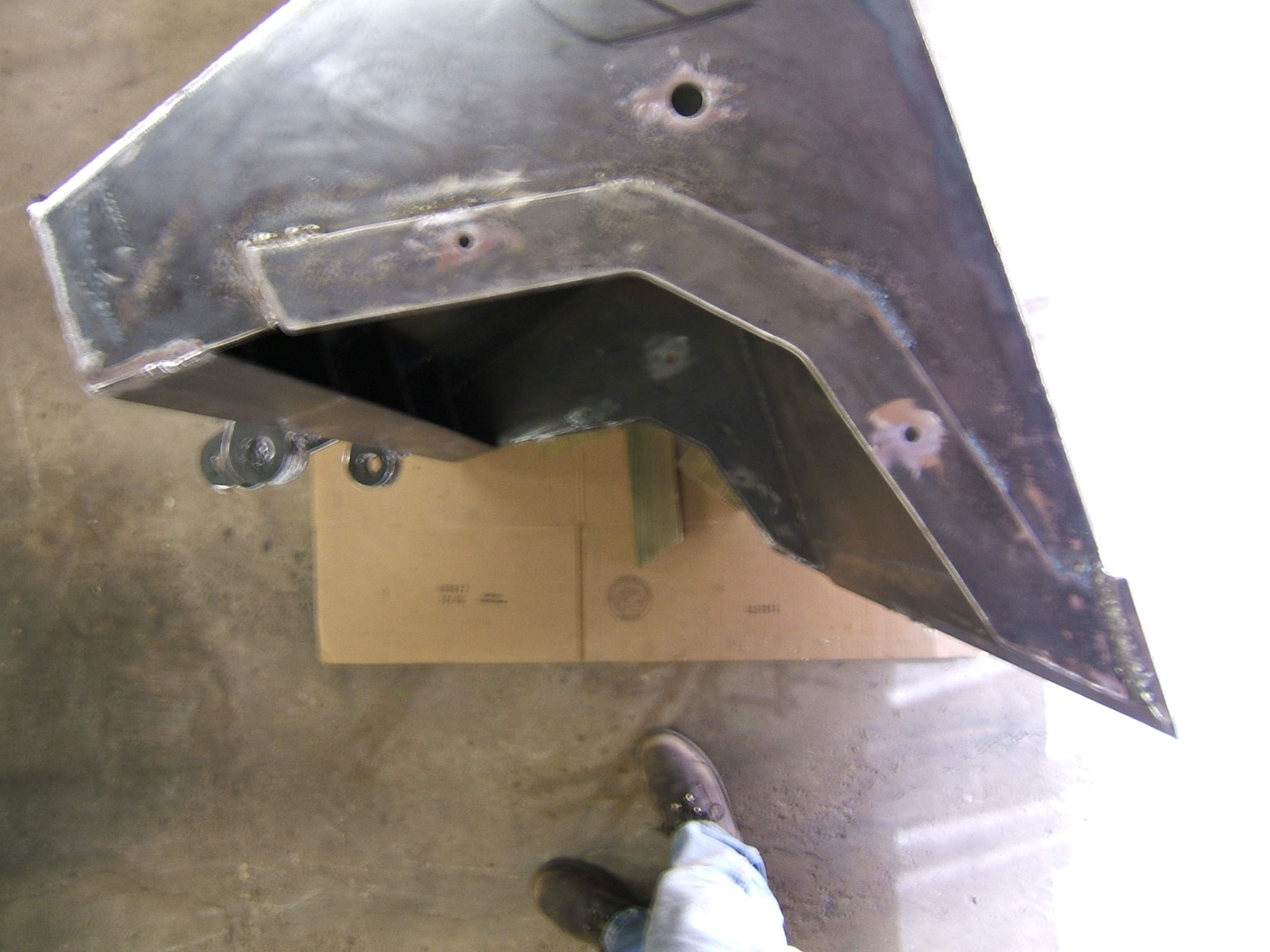

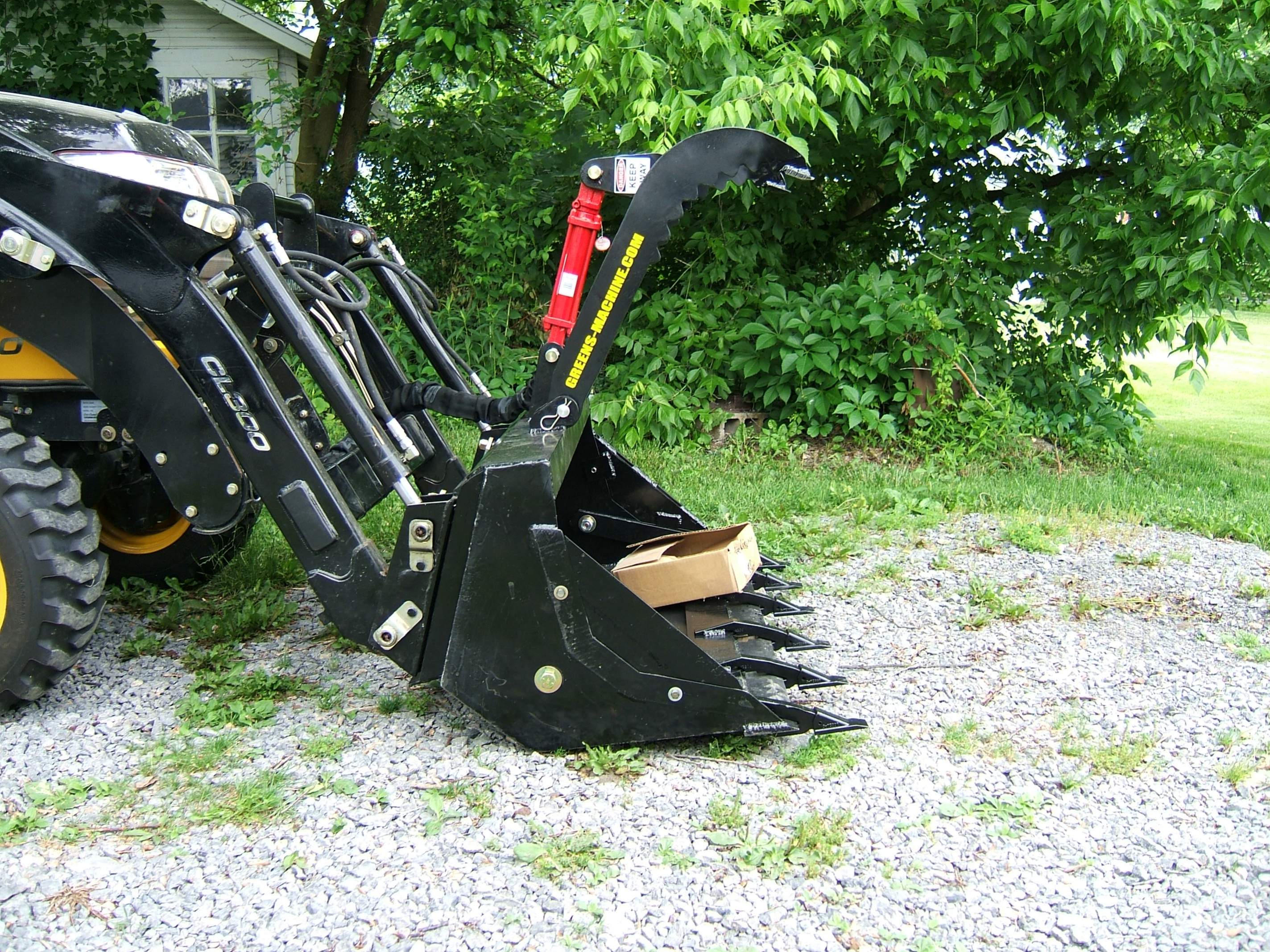

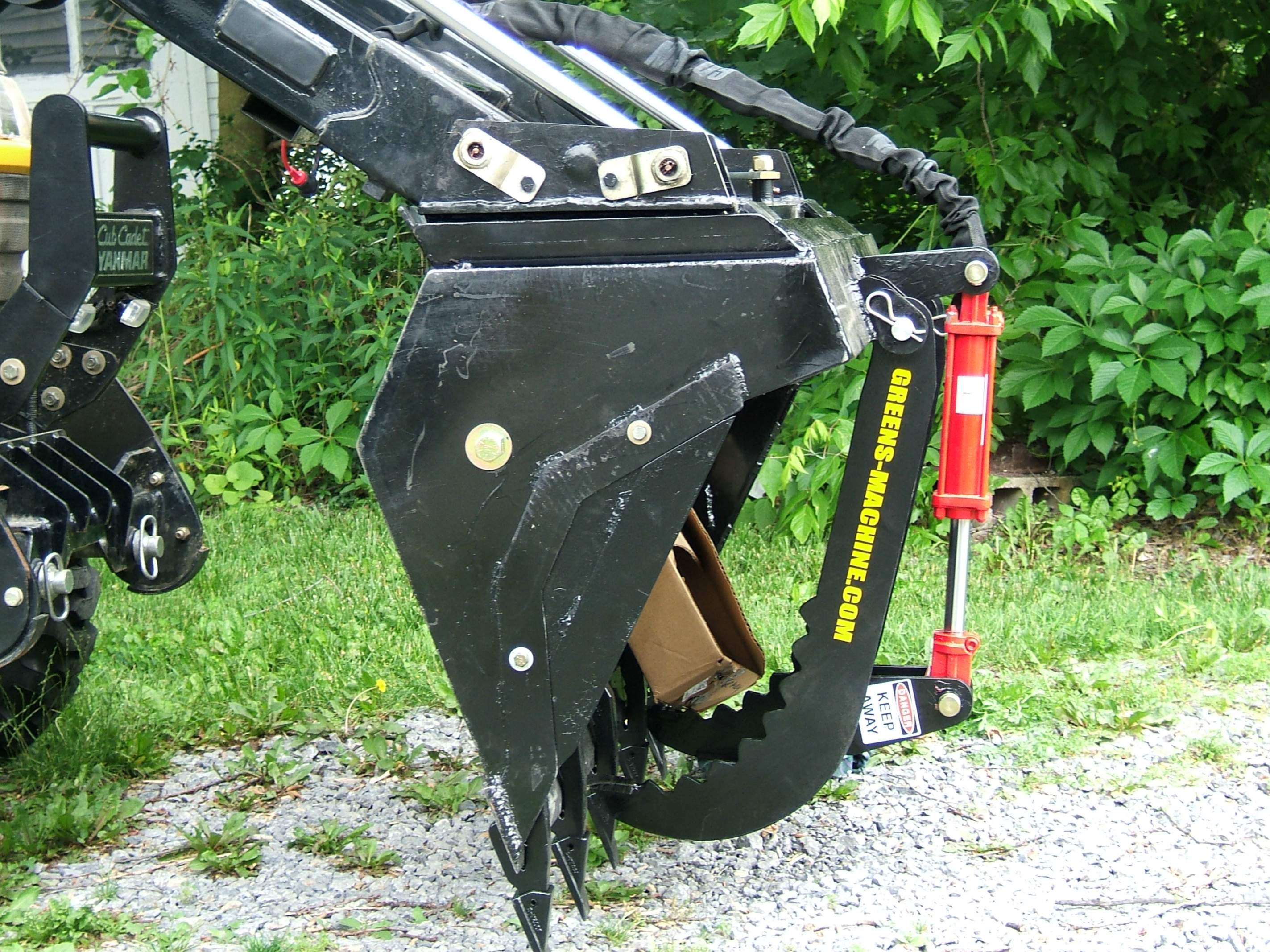

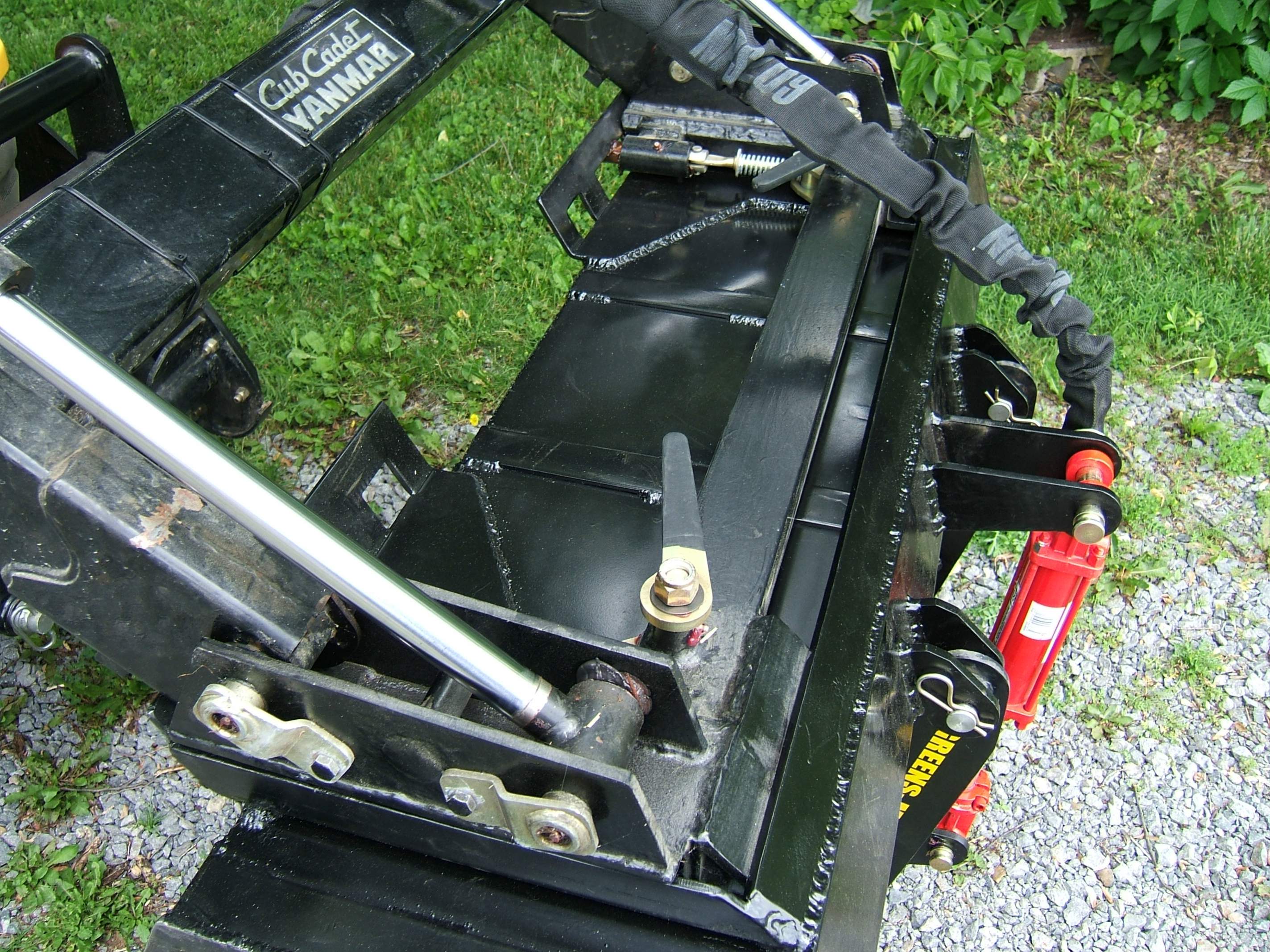

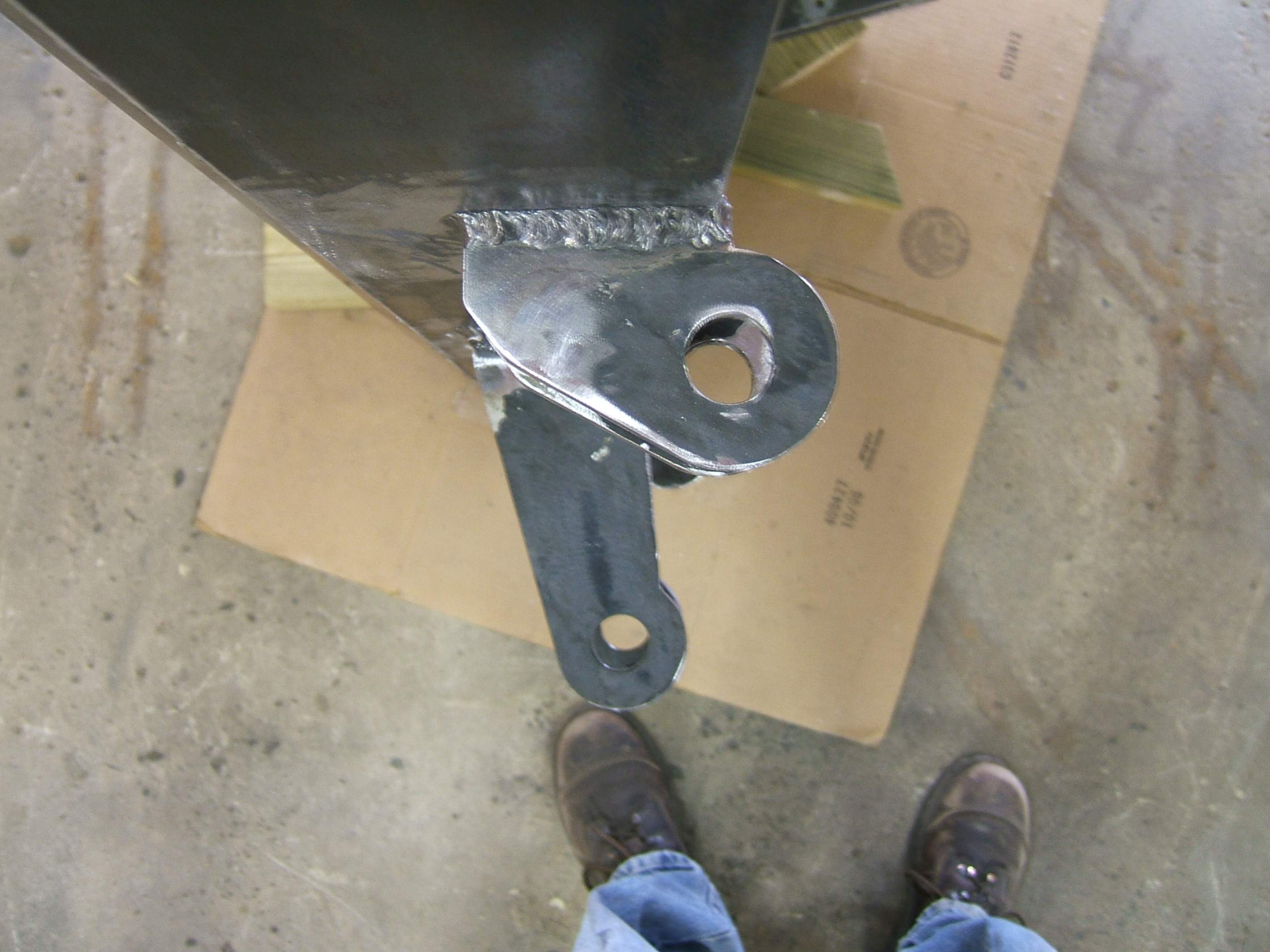

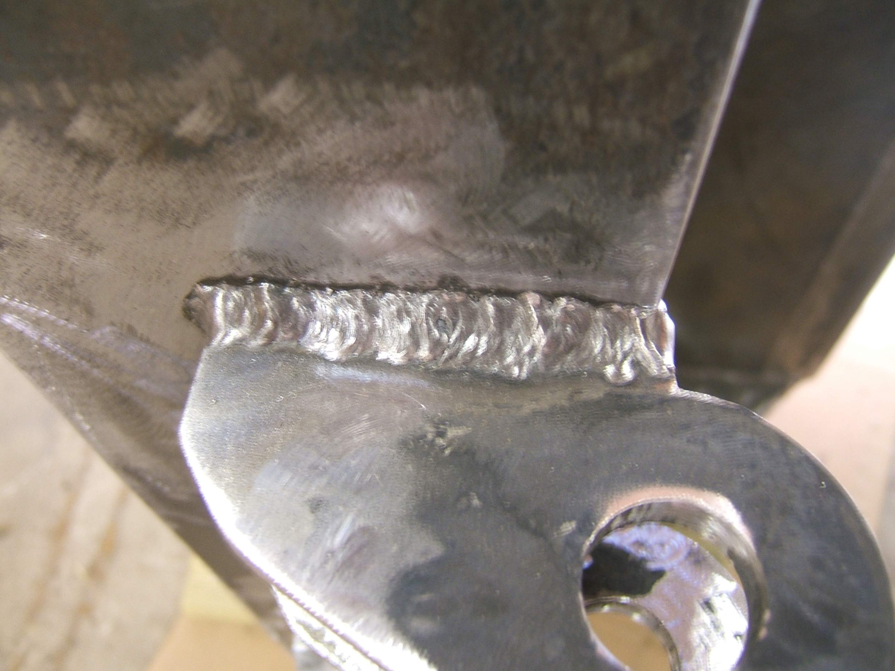

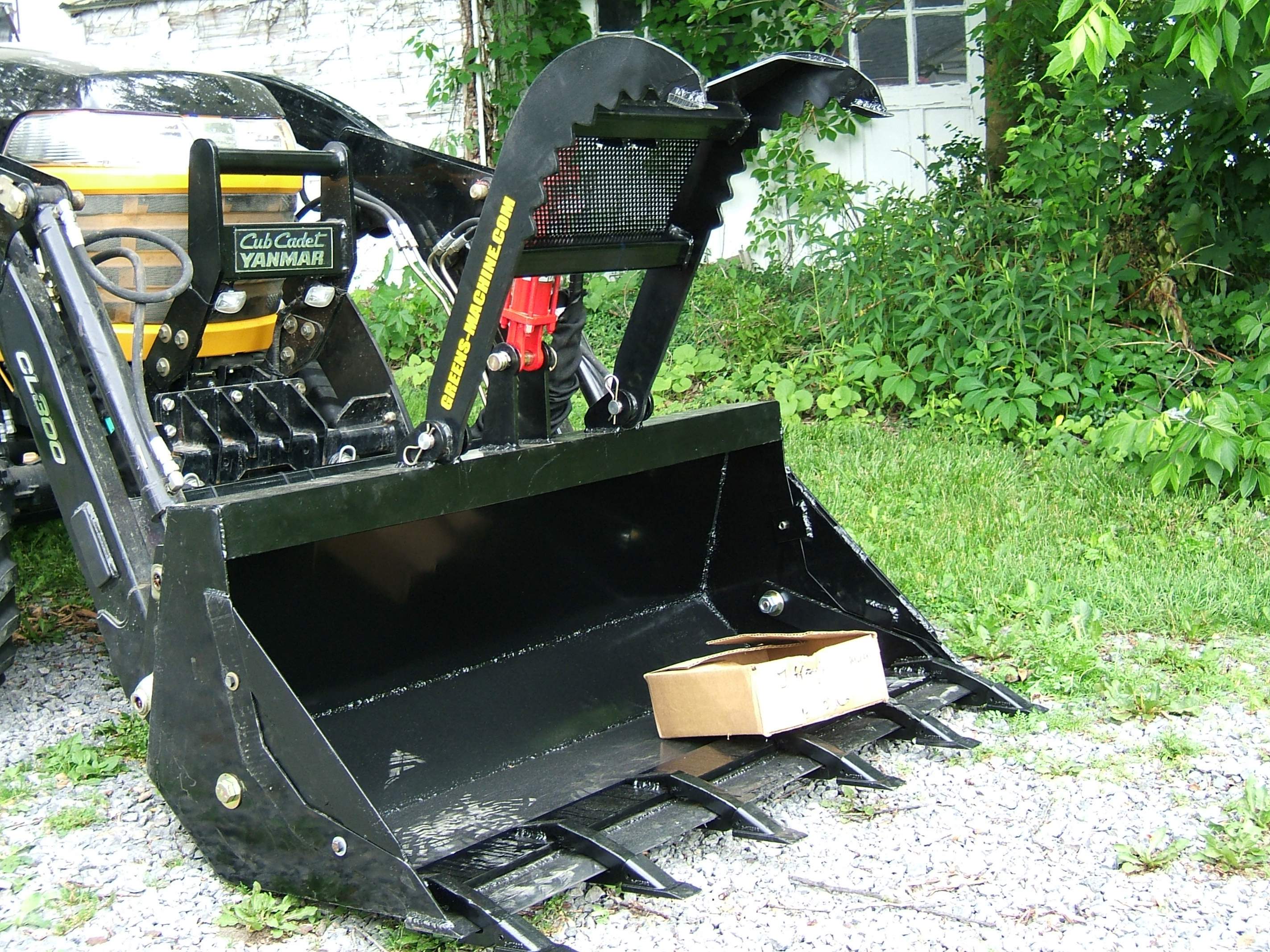

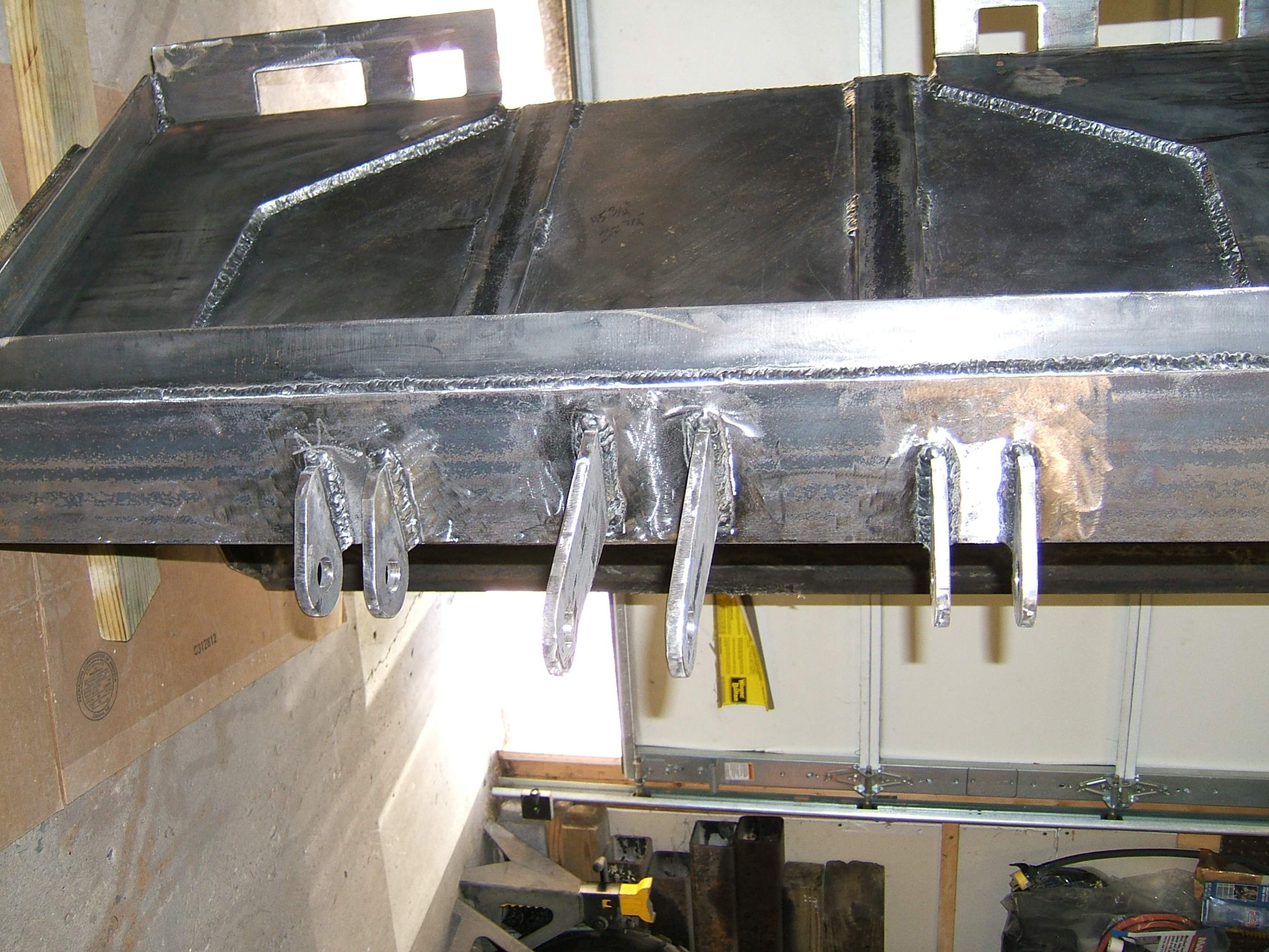

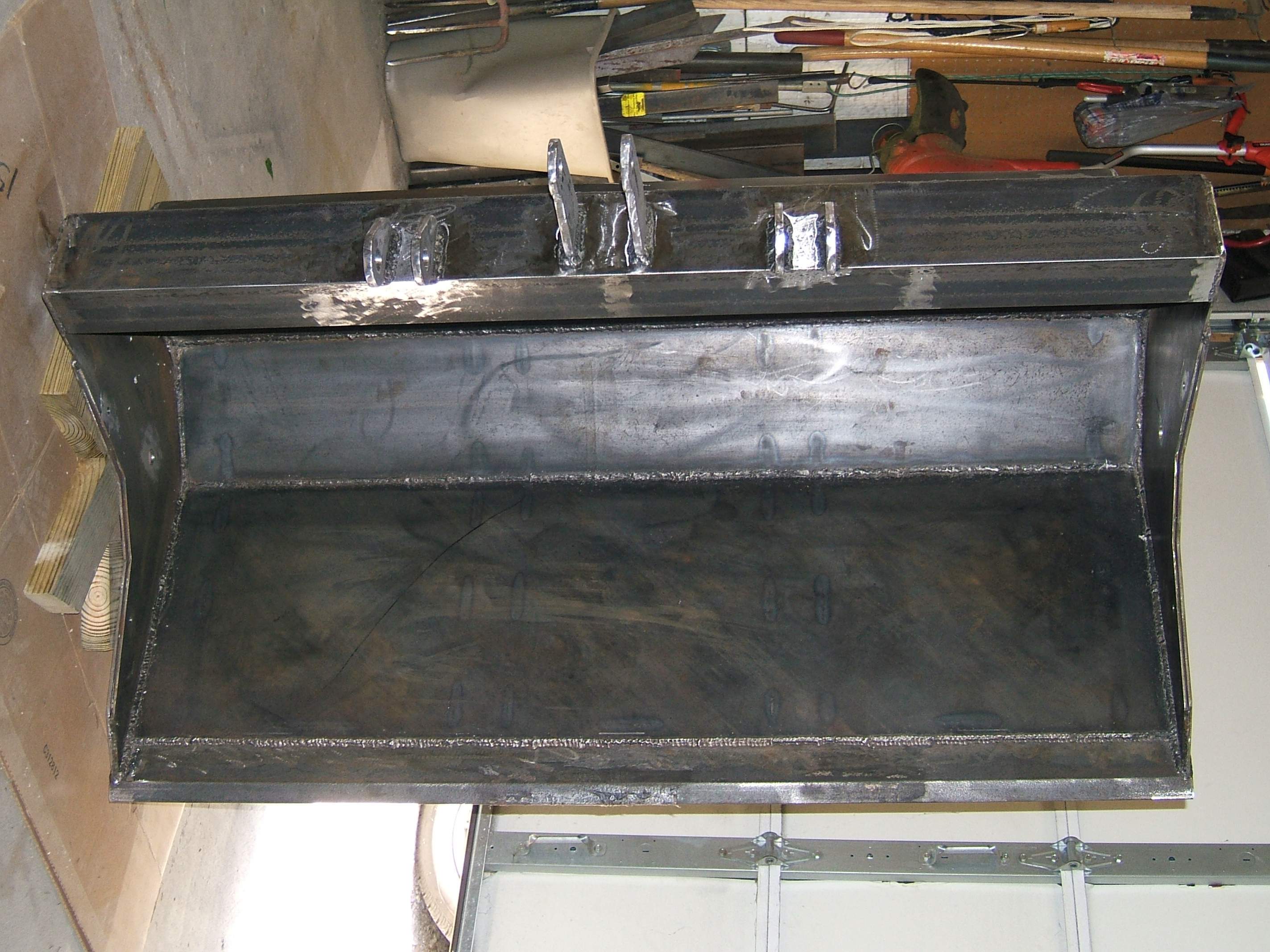

Sorry I haven't been able to post anything on here in awhile. I suffered a Brain Injury (TBI), that I'm still recovering from and I had to outsource some of my grapple bucket project to some friends, but here it is in all it's metallic glory! Very pleased with it!
Anti-Rotation Support Gussets.jpgBracket Weld Close-up.jpgBucket Interior.jpgGrapple Brackets.jpgSide Profile.jpgTop & Back Overview.jpg
#15

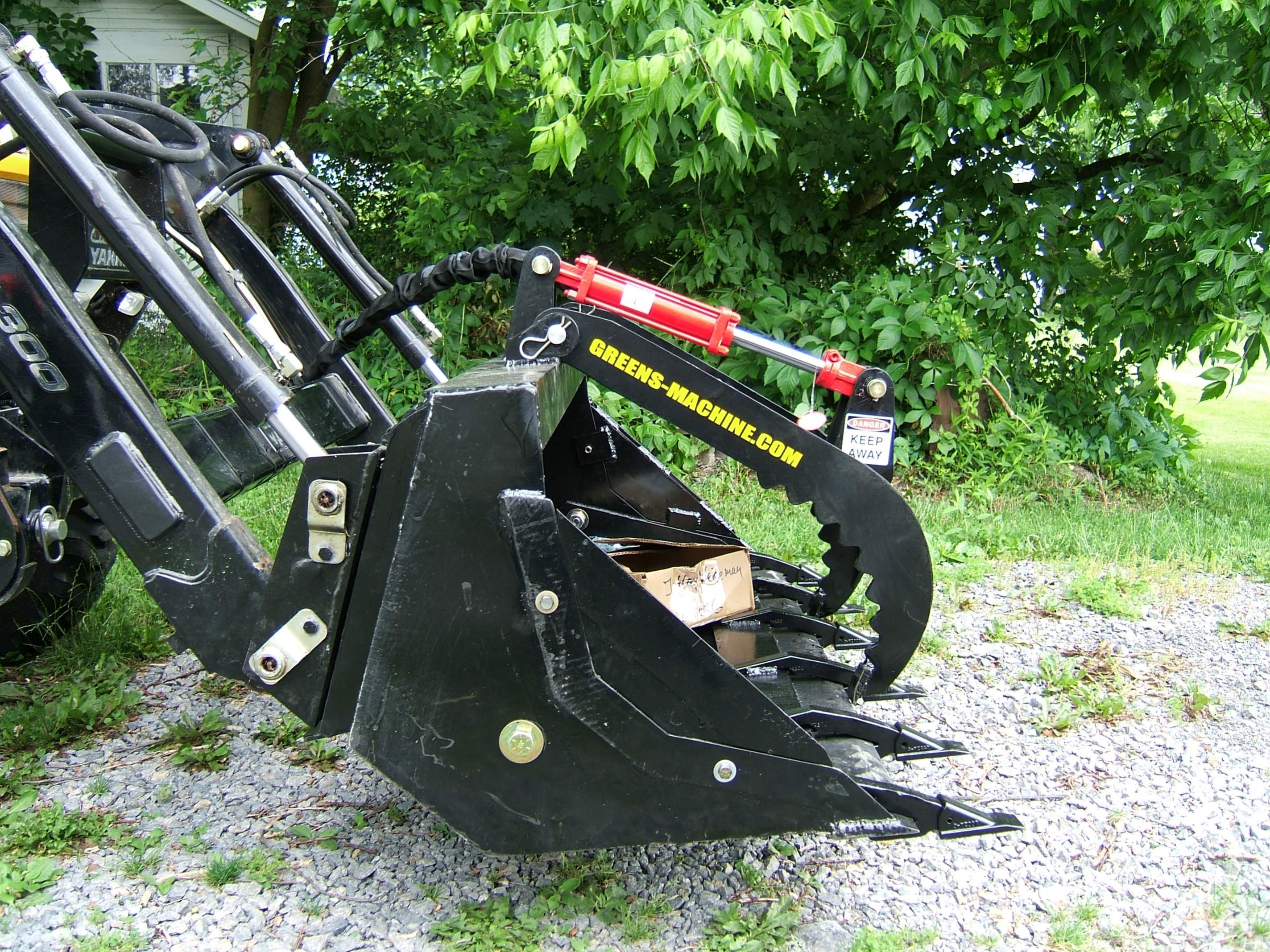

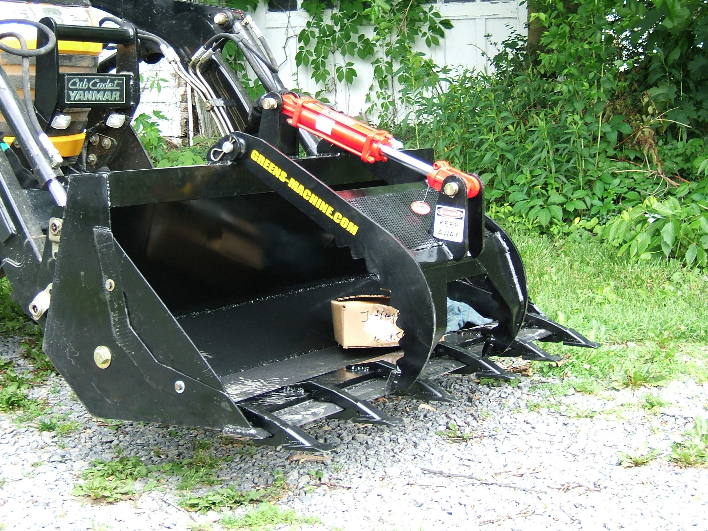

Here's some pretty pic's on tractor with tooth bar, side plates and grapple installed!
Angle View.jpgAngle View Open.jpgCurled View Open.jpgFinished Side.jpgFinished Side Closeup.jpgFron View.jpgQuick Attach View.jpgSide View Open.jpgTilt Angle.jpgTilt Angle 2.jpgTilt Angle Closeup.jpg
