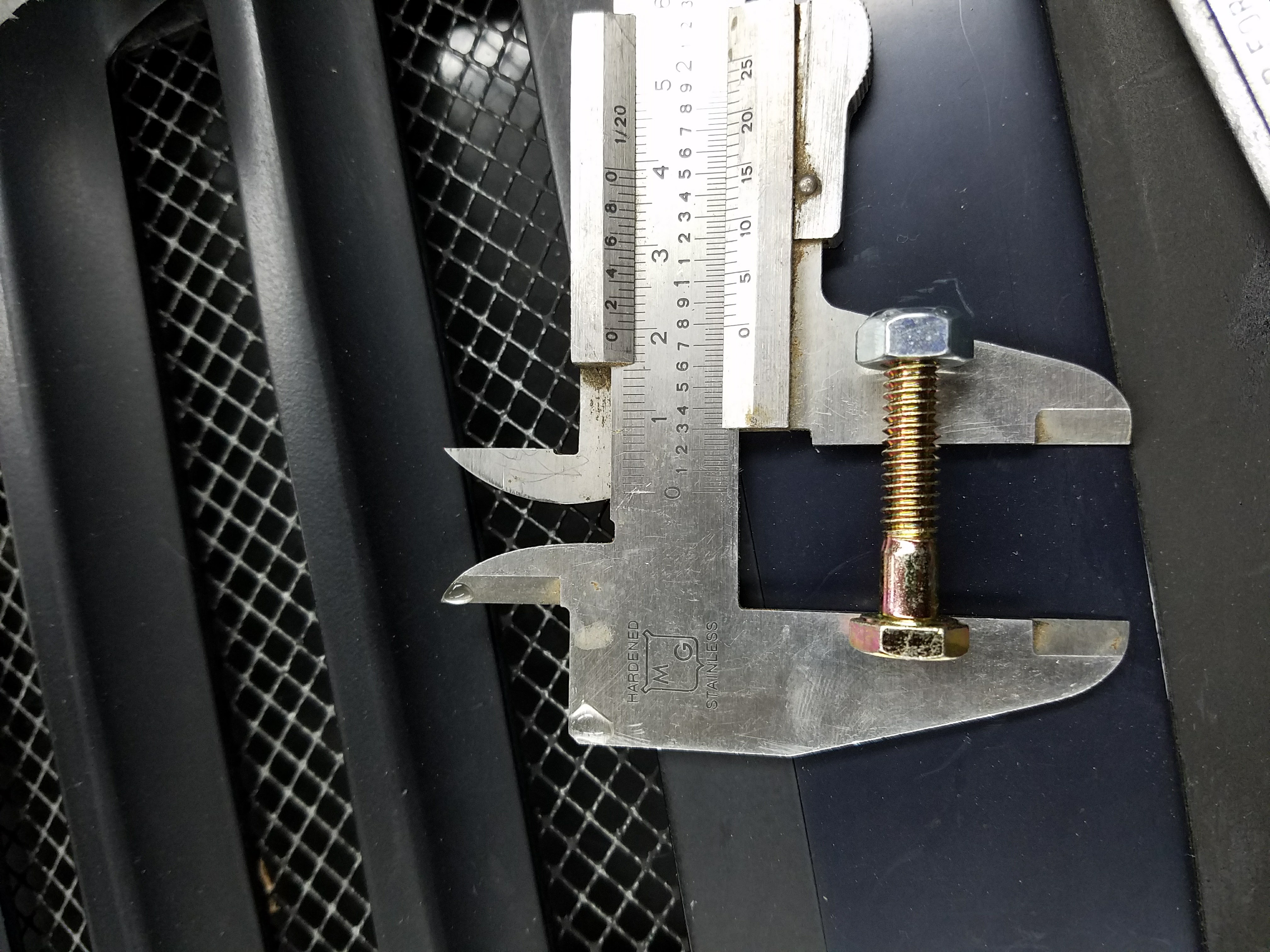

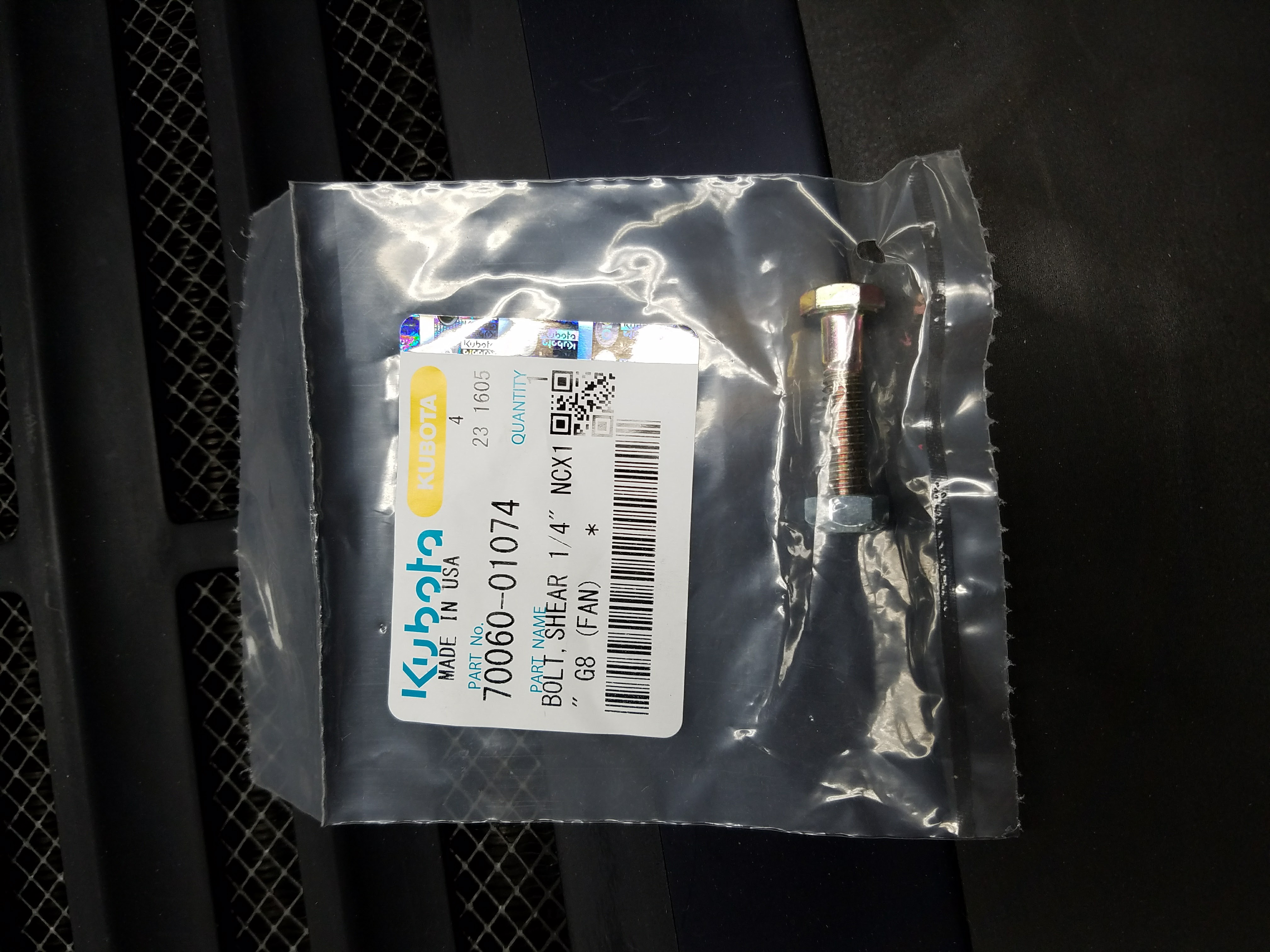

Yes, I have the updated shear bolt setup in mine:
Here is the bolt in the package from Kubota:

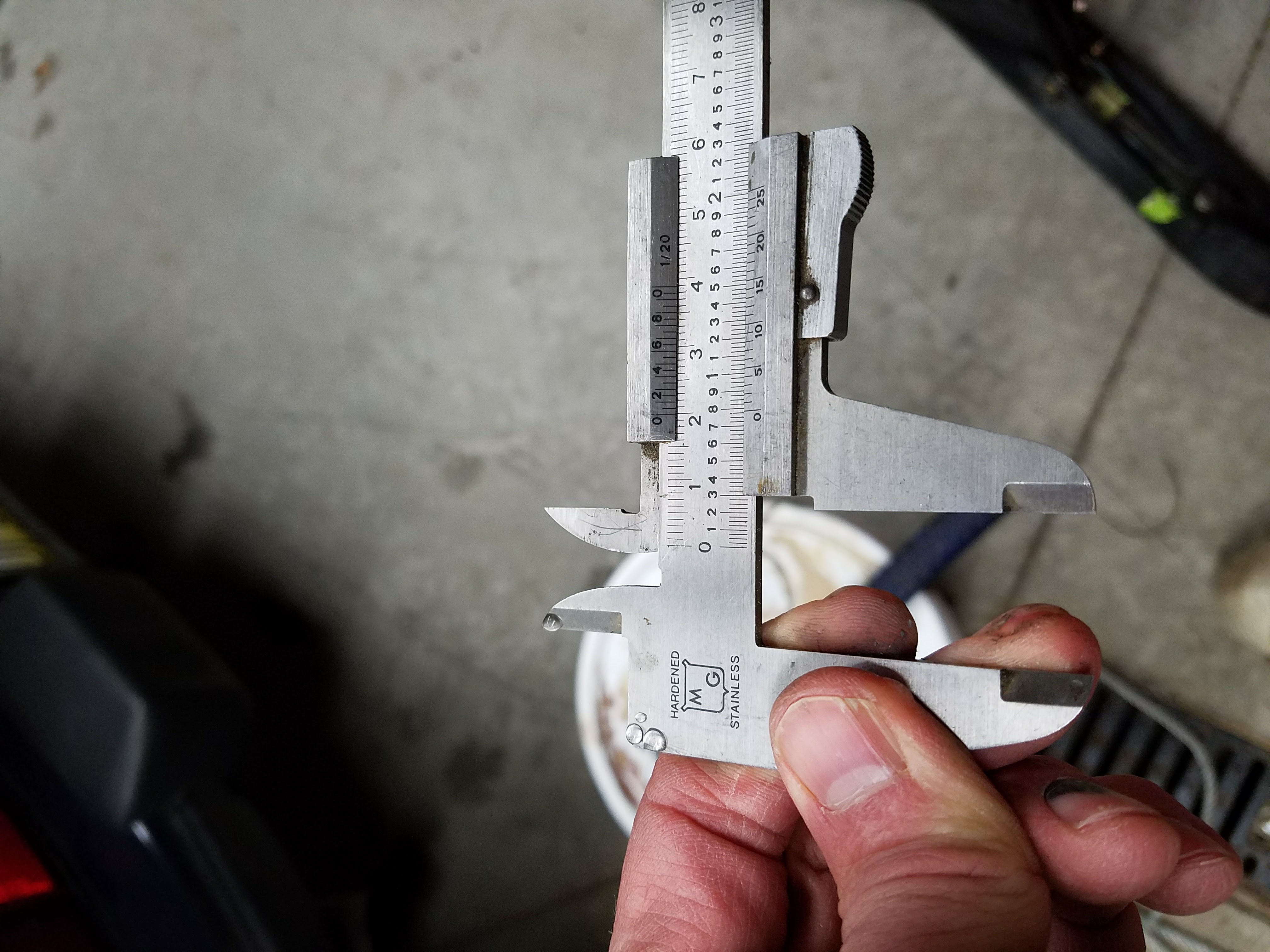

The total distance of the two flanges lined up is around 3/4". The thread on the bolt could be 1/4" shorter in my opinion.

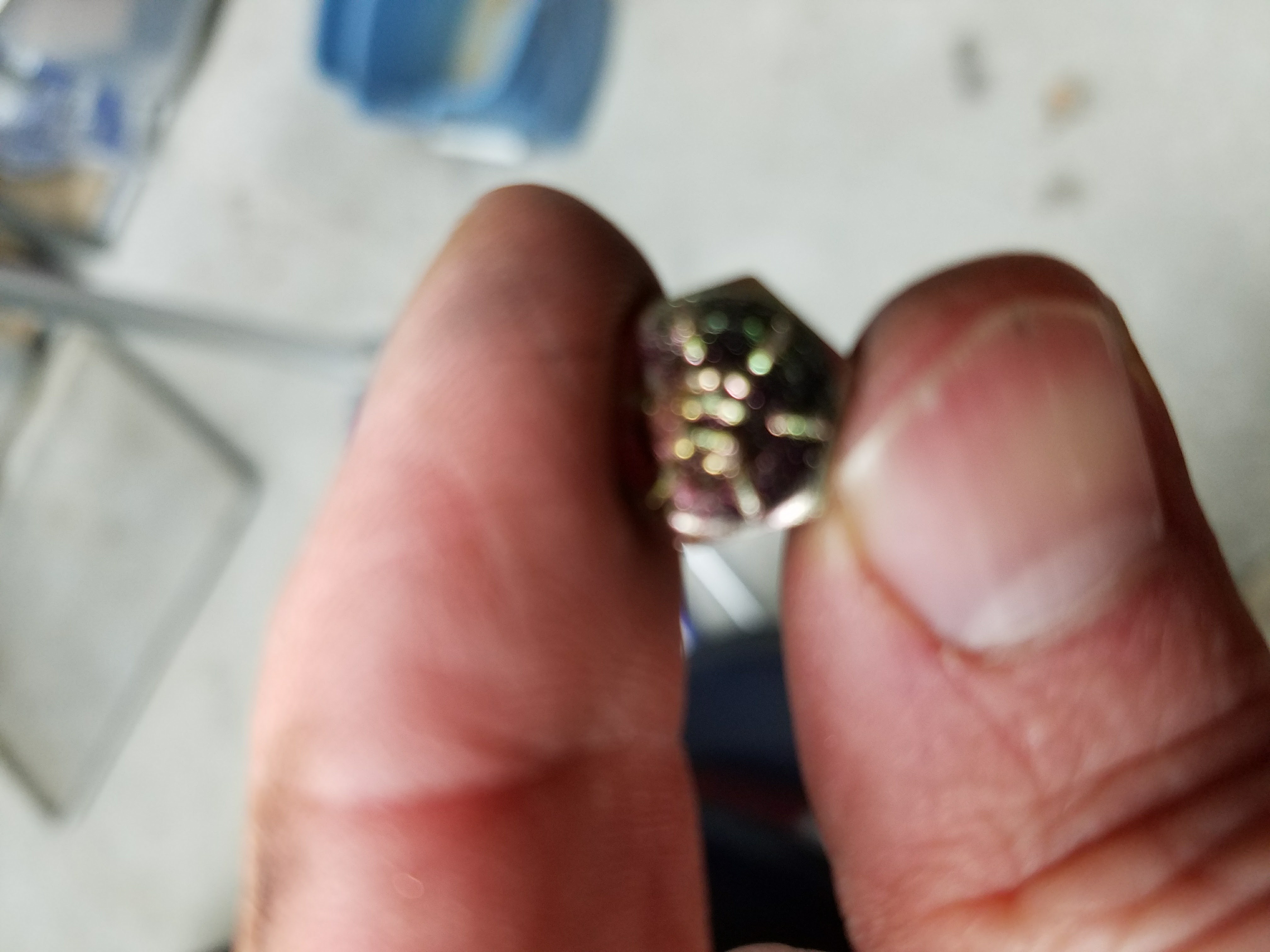

And here is the head of the bolt. This is a grade 8 bolt, right? Seems like no where to step up to other than to go to a 5/16".

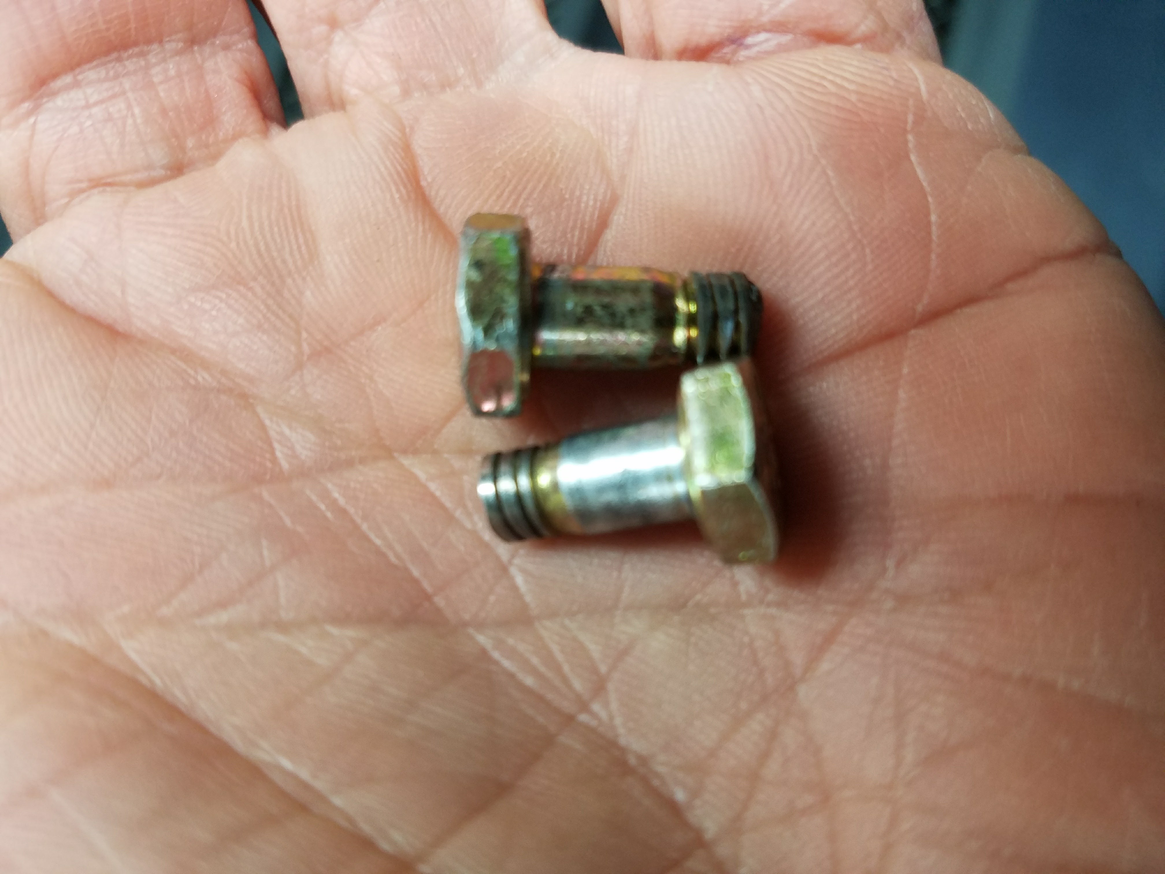

The last bolt I pulled out had a bit of a bend to it, even though it was only in there a short time. They seem to loosen up quickly. I assume that it is stretching the bolt.
I can get pretty good access to the two sides of the flange. It seems like a good, permanent solution would be to weld up the holes and redrill them, as they are a bit loose right now. I will try and find another grade 8 1/4" bolt with a longer flange (less threads). The JH label on bolt head indicates the Chinese manufacture. Maybe they are not really grade 8 or they have some manufacturing problem?

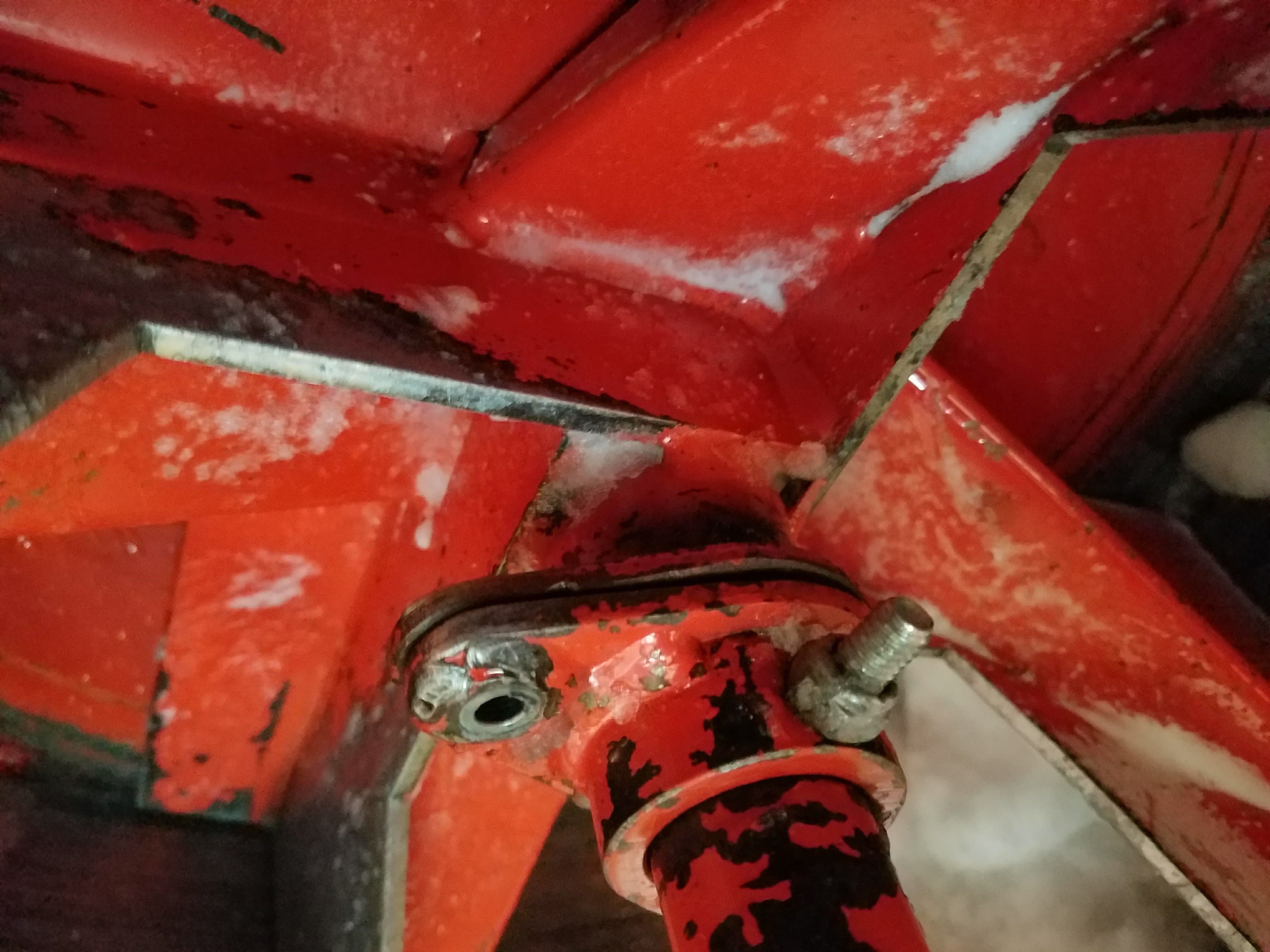

I have tried putting the bolt in both directions with no difference in time between shears. Here is a picture showing that it is shearing in the threaded area. I think the two tabs are the same basic thickness, so I think it shears at the same point whether it is put in from the front or the rear.

Wow, newest best style flange shear bolt design and the old problem.
Looking at your photo of the fan hub/flange area, there appears to be a gap. The two flanges do not appear to be flat so they are NOT like two pieces of window glass one on top of the other. .
Is this your observation? If there is a gap it would explain two things.
The first is why you are seeing some bending in the failed bolts, the second is why the shear bolt is failing in the threads not the smooth shank.
The two flanges should be acting like a good pair of scissors cutting paper. When the scissors are new and the two halves of the scissors are tight together, they easily slice through thick heavy paper. When the scissors get old and the two halves are not tight together, it is much harder or impossible to cut heavy paper.
If your flanges are bent or something is preventing them from pulling together over the complete face of the flange, this has to be corrected.
Can you remove the bolt through the fan shaft and pull the flange back so the flange on the fan hub can be photographed with the flat edge of your caliper against it to show just how flat it is?
Do the same photo procedure on the flange you pull back.
The bolt head you are asking it it is a grade 8 is indeed a grade 8. The difference between a chinese and a north american one would not be significant in this situation.
What is interesting is the Kubota package for the shear bolt which clearly show a grade 8 bolt. Previous packages of shear bolts with newly purchased blower of your style also clearly stated grade 5 for the auger and grade 2 for the fan. Why the big change by Kubota?
At this stage I am very hesitant to have you up the bolt diameter for fear of causing damage. Thinking quickly, the rotating fan has a lot of stored energy. When it is suddenly stopped that energy is going somewhere. If there was a bigger bolt connecting it to the shaft could that energy be traveling along the fan shaft to the gear box? I have not thought thru my argument enough to say this is a genuine concern but.... Also, deviating from the Kubota design when we are jusst starting to get their attention might just give them a reason to pass you by.

This may be the way the photo looks. There is no gap between the two flanges. Maybe it is the way they are rounded off at the edge, but them main material of the flanges comes together good, and when I torque the shear bolt they are pressed together tightly.
There is some extra room in the shear bolt hole. It is not a lot, but I would not say that the shear bolt is tight going into the hole. Initially this is not a problem, since there is no movement since the shear bolt is tight, but after even 15 minutes of operation the shear bolt is a bit loose, and will rock back and forth a bit when I move the fan. At this point when I move the fan there is some play between the two flanges. Since the shear bolt is held with a self locking nut, I am thinking that there is some stretch happening with the shear bolt when it is in operation.

In resume, no threads in the sheer zone is essential. Threads are like a pre determined partial cut and therefor a weak spot sure to sheer .
You want only solid bolt body in that zone.
The higher the bolt grade the cleaner the sheer or cut will be.

It looks like to me that the two plates are moving when the bolt is in place (oscillating). The damage to the bolt after short use is from the one of the two sheer plates repeatedly hitting it. If you put the bolt in and use a regular nut finger tight can you move the fan while keeping the shaft from turning? I would agree with the others to try a longer bolt so the sheering happens on the shoulder of the bolt, not the threads. I think I would use a regular nut and torque it down (I think 107 inch/pounds). Then use the stover (lock) nut to keep it from loosening up.
On my Kubota snow blower the holes are very tight. With the nut in place there is virtually no movement. My L2195 uses a 1 3/4 x 5/16" grade 5 sheer bolt on both the fan and auger. Both the fan and auger are set up identical to your fan. Without running the numbers I have to believe that a 5/16" grade 5 bolt can't have much more sheer strength than a 1/4" grade 8 bolt.
If your holes are worn out I'm not sure if you would be able to drill them out. Those plates could be hardened steel. But you could potentially step up to a 5/16" grade 5 sheer bolt. A quick look on the internet shows the 1/4" grade 8 bolt has an approx sheer strength of 4500lbs while a 5/16" sheer strength would be 5750. Ideally what would be best if you can drill the hole larger would be to get a grade 8 5/16 sheer bolt that has been necked down to sheer at a specific spot for a snow blower. But that would most likely require the use of washers to try to line up the sheer spot with the two plates.

I looked at the holes closer, and the back one was definitely elongated.
I filled it with my mig welder and redrilled it so that it is tight now. I also rebolted it with a new 1/4" grade 8 bolt with a longer shank so that the shear area is not where threads are. It looks like more snow this weekend, so I will try it out and see how it does. I also double bolted the shear bolt. Also the bolt that goes through the center shaft was damaged and gave it some play, so I changed this as well.

For sure you don't want any threads in the shearing area as a thread is like the start of a shear and as well threads will mangle the 'cutting edges' of the shear 'blades'.
Think like metal tin snips, a nick makes a messy cut.
