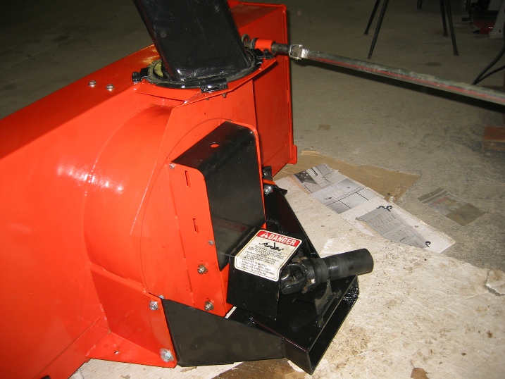

Here is a picture of a couple of the many sheared bolts:
More interestingly, here is one that was in the tractor for about 10 minutes:
You can see how it is already getting beat up. Looking at the tab where the shear bolt goes in, it is a bit loose, especially the back tab. I tried wrapping the bolt in some metal putty stuff that should harden and fill the gap. It seems like the correct solution would be to weld the hole and redrill it, but that seems like it would be hard to do without a lot of disassembly.
On another note, I pulled the drive shaft apart, and the shaft is not square, but slightly rectangular, so there is no way to assemble it where I would cause the phase problem previously mentioned.

Is this image of a new blower's fan shear bolt the same as you blower?
Do you have a venier caliper, even a plastic one from home depot.
The usefullness of the probe coming out is to measure the depth of a hole. In your case you are going to press the big end where the probe comes out against the area where the shear bolt goes in and extend the probe until it is just flush with the other side of the home.
Lock the caliper in that position with the small thumb screw.
Place the probe against the underside of the head of the shear bolt and take a photo which will show where the depth of the hole is on the shank area of the shear bolt.
Can you post a picture of the bolt in your second photo in place on the blower. Also measure the length of the bolt from the top of the head to the end of the threads at the tip.
The thread area is all deformed. The threads should be outside where the shearing action is to happen.
The threads are just to keep the smooth shank of the shear bolt in place until the time its protection is needed.
For the threads to get beat up near the un threaded shank tells me something is amiss with the amount of threads on the bolt shank.
Would you post a picture of the second photo bolt in place be certain to get a shot of the head of the bolt.
If as I suspect, when the second bolt is in place, there is no smooth shank just at the edge of the shear bolt hole, then I think you need a longer bolt or a bolt where the shank is smooth for a greater distance.
Where do these bolts come from? A Kubota part # or a general supplier of bolts and nuts. There is a length of bolt where the amount of thread is suddenly reduced compared to the lower size.
I think it is 1-1/2" has fewer threads than 1-1/4".
Looking forward to seeing the requested pictures as I think it will explain a lot.
Dave M7040

Yes, I have the updated shear bolt setup in mine:
Here is the bolt in the package from Kubota:
The total distance of the two flanges lined up is around 3/4". The thread on the bolt could be 1/4" shorter in my opinion.
And here is the head of the bolt. This is a grade 8 bolt, right? Seems like no where to step up to other than to go to a 5/16".
The last bolt I pulled out had a bit of a bend to it, even though it was only in there a short time. They seem to loosen up quickly. I assume that it is stretching the bolt.
I can get pretty good access to the two sides of the flange. It seems like a good, permanent solution would be to weld up the holes and redrill them, as they are a bit loose right now. I will try and find another grade 8 1/4" bolt with a longer flange (less threads). The JH label on bolt head indicates the Chinese manufacture. Maybe they are not really grade 8 or they have some manufacturing problem?
