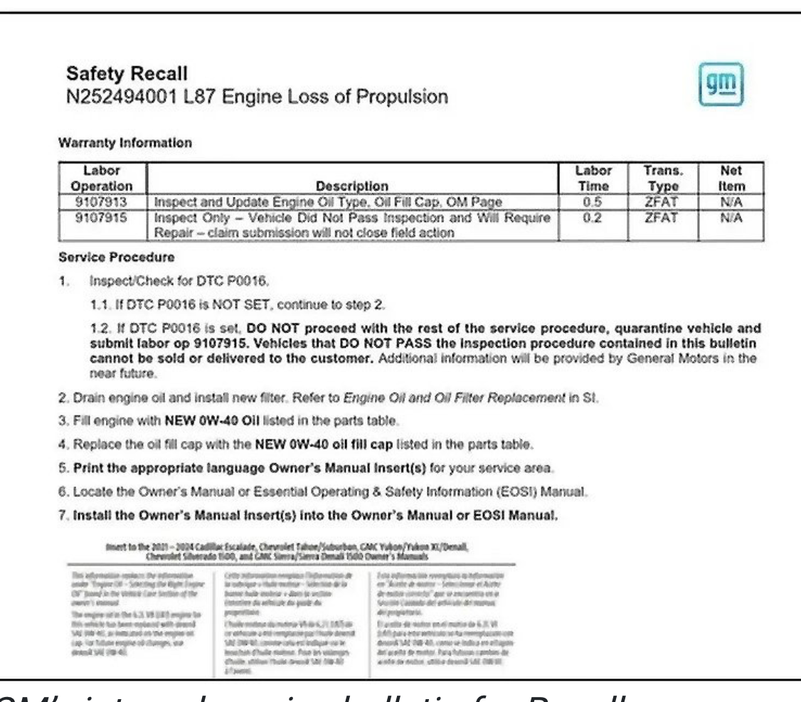

Here is the test procedure to see if you get an new engine or an oil change. It must be using the knock sensor to pick up issues with the crank bearings.
I think that’s one of three different tests used, depending on your serial number. Some others get a simple check for a code:
I wouldn’t want to have mine judged by either method.
