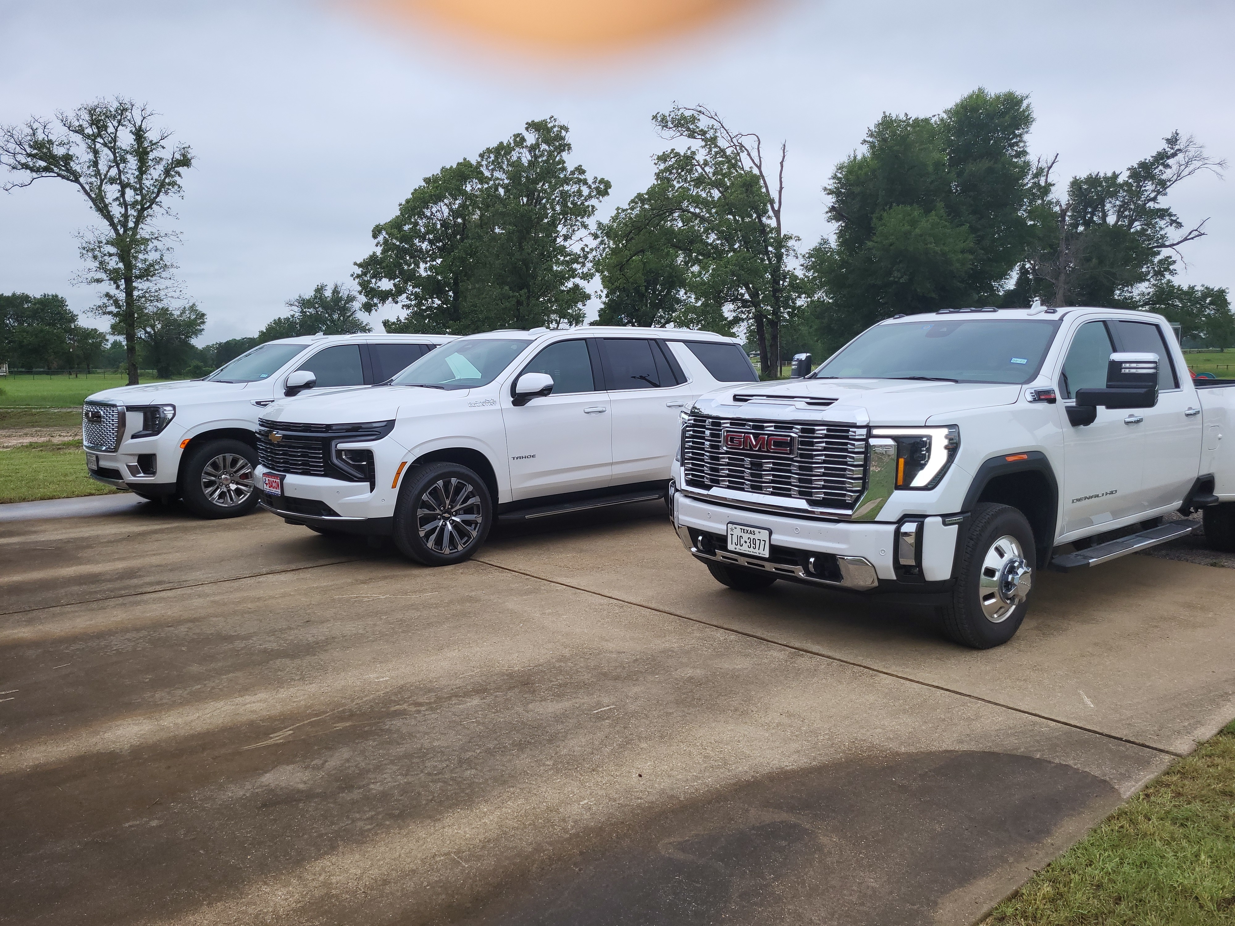

No complaints here. I have a 6.6 Duramax and a 3.0 Duramax, both 2024 models GMCs. The 2025 Tahoe with a 6.2L is after the problem years.

Go for it. The wife's 2025 Tahoe High Country is really nice. If they had had one with the 3.0 Duramax we would have gotten it but went with the 6.2L instead. I have 16,000 miles on my 2024 Yukon Denali with the 3.0 Duramax. It shows a combined mileage of 24 mpg. On the highway I routinely get 30 mpg or better. The best on the DIC is 38 mpg over a 25-mile stretch, 34 mpg over 50 miles.
