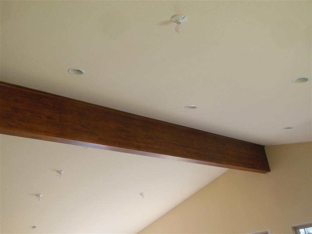

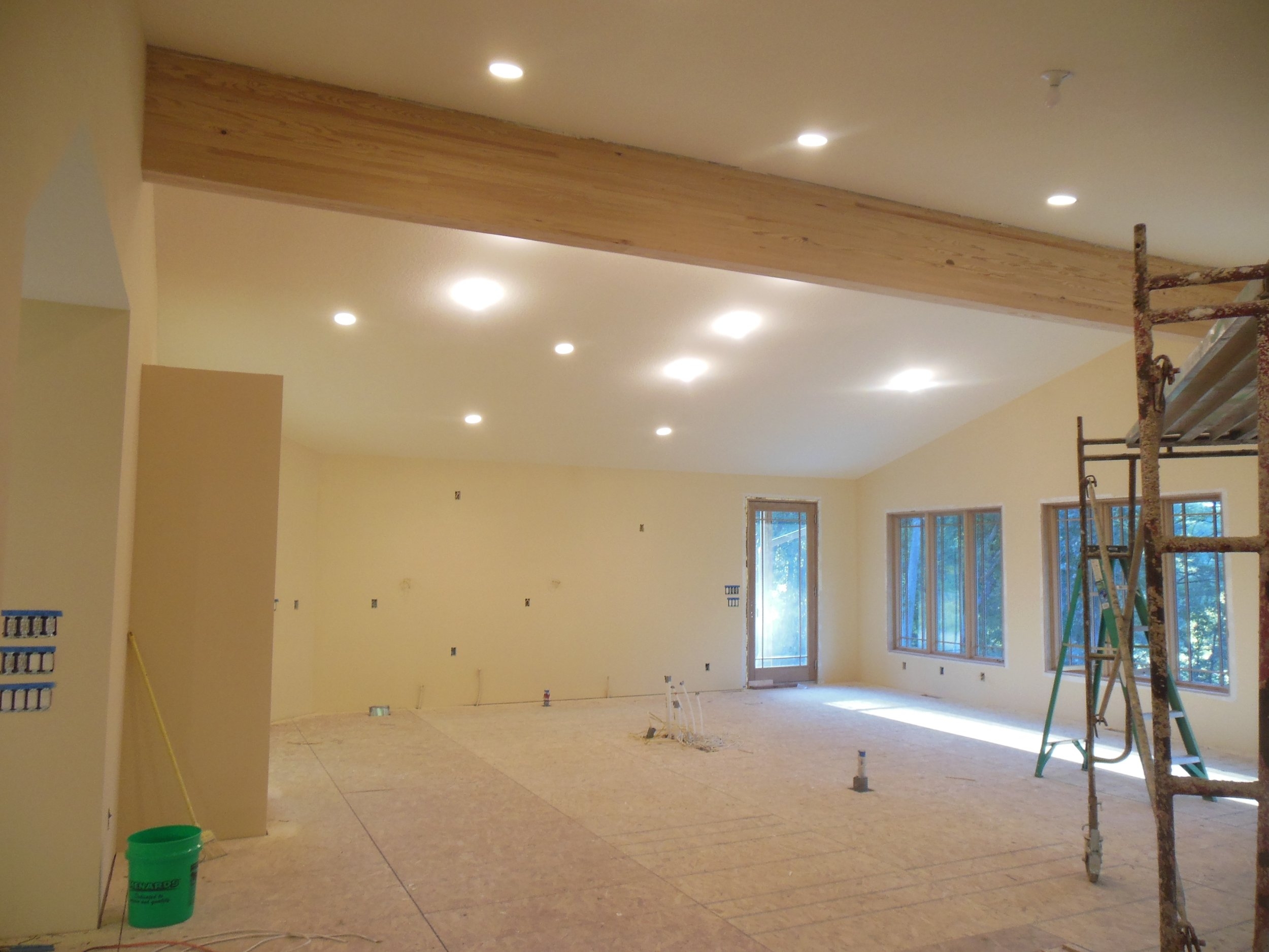

Here is my glulam beam. Before finishing and after
View attachment 813447View attachment 813448
A beam will have differnet compression/tension points depending on where the load is. You can't unphysics that. The beam will act very different depending on if the load is on the center or the two sides.
In a very basic sense, without any concern given to loading, yes...tension on the bottom and compression on top.

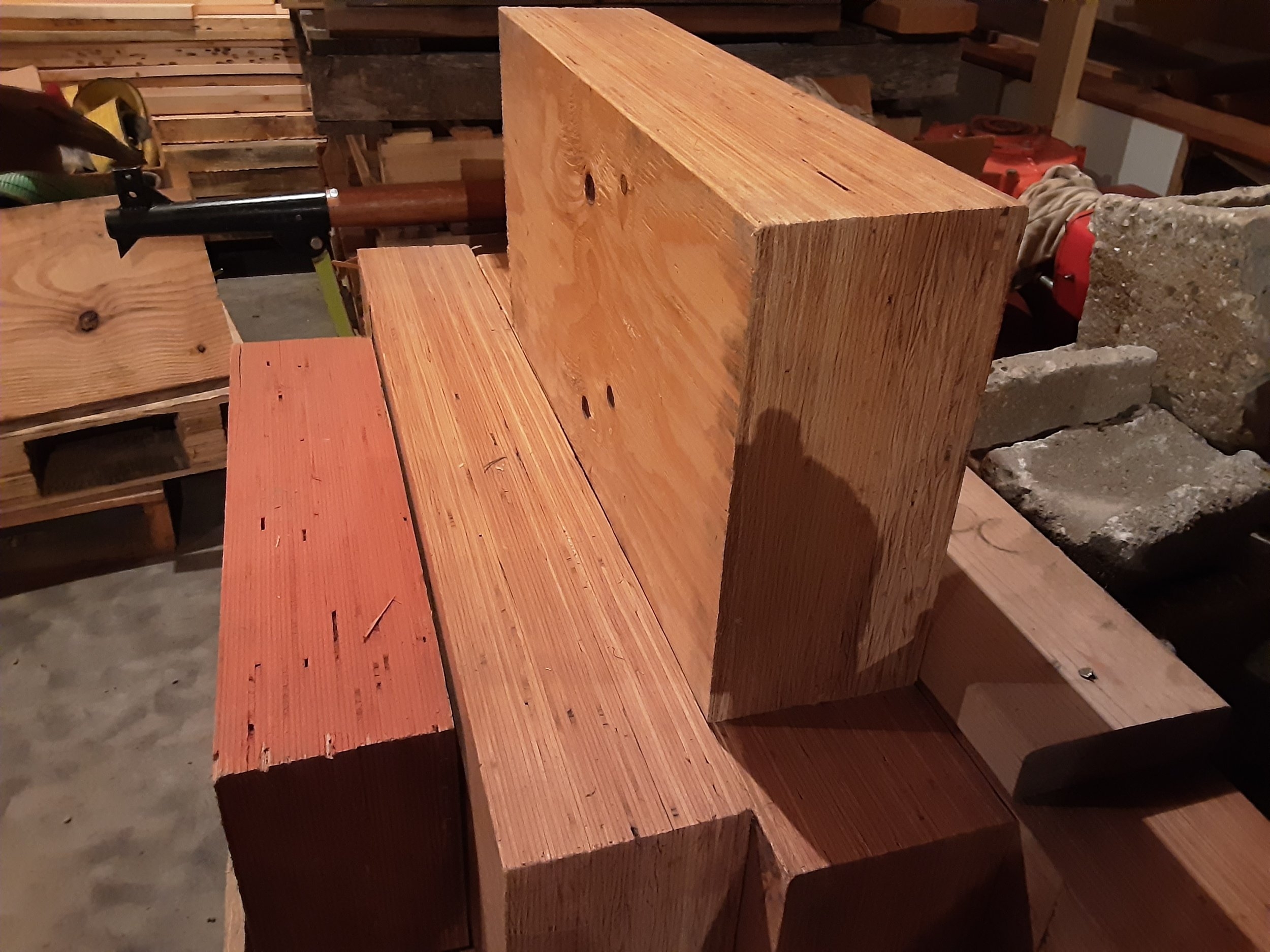

If you are talking about glulam beams that are basically plywood veneers stacked and glued, those are stronger than glulam 2bys. More glue, reduced impacted of wood imperfections. However, and it is not trivial, they weigh considerably more. That can make them less attractive for long spans because of their own weight, but the engineering choice will factor in what the load is like and it may be effective.
I would comment that there are a bunch of different composite wood beam products, and they have similar, but not identical properties. A great deal will depend on what is readily available where you intend to build. (Importing a beam from the Netherlands isn't going to be cheap in Nevada...)

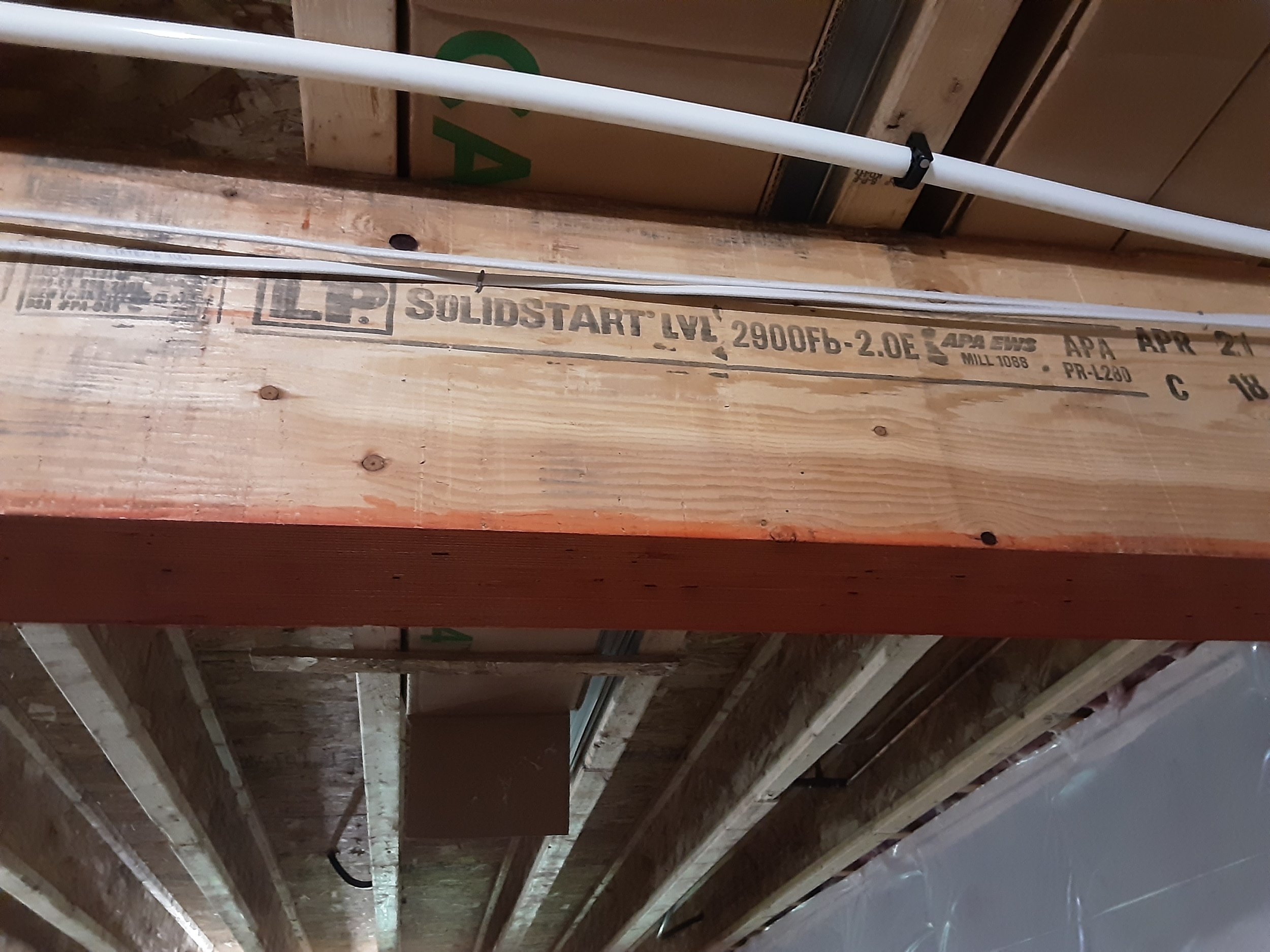

@ponytug, clarification. Floor joists are engineered I joists from a v4eetical OSB with flnges of 2x material. Those are held up by a 5.5" wide x 11.75" tall LVL. That LVL is made of 11.75" vertical strips of plywood, not OSB (my mistake on earlier post). My question is the OP's glulam or my LVL for the same dimensions stronger?View attachment 813688View attachment 813689
I am gonna say in this case....the LVL is probably stronger.
Two "numbers" basically define the strength of the beam. Thats the modulus of elasticity and the Fiber stress when bending.
Both of these numbers are usually given for engineered wood products. In your case, its stamped right on the beam. Fb (fiber bend stress) is 2900psi. And the modulus of elasticity is 2.0e....(2 million psi)
In laymans terms......the "E" value (modulus of elasticity) is basically how "stiff" the board is. How much it will bend (or resist bending) with a given load applied. The higher the number, the "stiffer" the board.
Fb is how much stress the extreme fibers can withstand. So when a beam has a load applied, and it deflects....you are stressing the extreme fibers. (bottom of beam fibers are trying to rip apart). Similar to tensile strength in steel.
Higher numbers are also stronger.
So lets say two beams....both with the same Fb of 2900.....means those extreme fibers can withstand the same stress. But one beam is 2.0e and the other is 1.8e......the 2.0 can handle higher load. Because it is stiffer and will deflect LESS....and LESS deflection is LESS stress on the fibers.
ALSO.....lets say you have two beams and they are both 2.0e......but one has a 2900Fb and the other is 2500Fb......again...the 2900Fb will be stronger because they are allowing for more stress....and more load.
The trick is when comparing two beams....lets say a one is a 2.0e with a 2500Fb and the other is a 1.8e with 2900Fb.
Gotta take things on a case by case basis and there is always more than one way to skin a cat. Design, headroom, cost, availability, etc are all deciding factors. Your beam being a 2.0e and 2900Fb is near the top of wood strength for engineered lumber. Dont see numbers much higher than that. But do see 1.8e and 1.9e stuff and 2700-2750Fb beams. Would obviously be weaker. Dont mean they wouldnt work though.....maybe go up to the next size (depth). Or maybe go down a size but add a ply (make it thicker).
Designs and engineers usually spec the minimum allowable. And due to above reasons....you can always go stronger (which dont always mean bigger). Plenty of charts and load tables out there for LVL's and Glulams.
But like LVL's.....gluelams can come in different specs. But most commonly 1.8e or 1.9e and 2400Fb....which makes them weaker than most LVL's of equal size.
